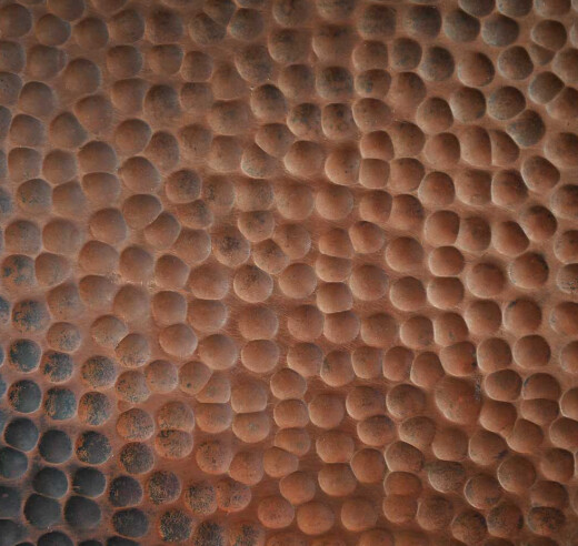

So, I’m trying to figure out if it is even possible to do something like this with CC basic in the Texture Toolpaths. Ultimately, I’m looking for a hammered metal look, but I found this on Etsy and like it.
A more regular look vs. the variableness of the texture is fine as well. Here is a pic of what I’m trying to accomplish with it. I’ll probably be going with more of a black base with some “rust” highlights to give it a slightly aged, almost cast iron look.
Anything that even comes CLOSE to this would be great. Thoughts?

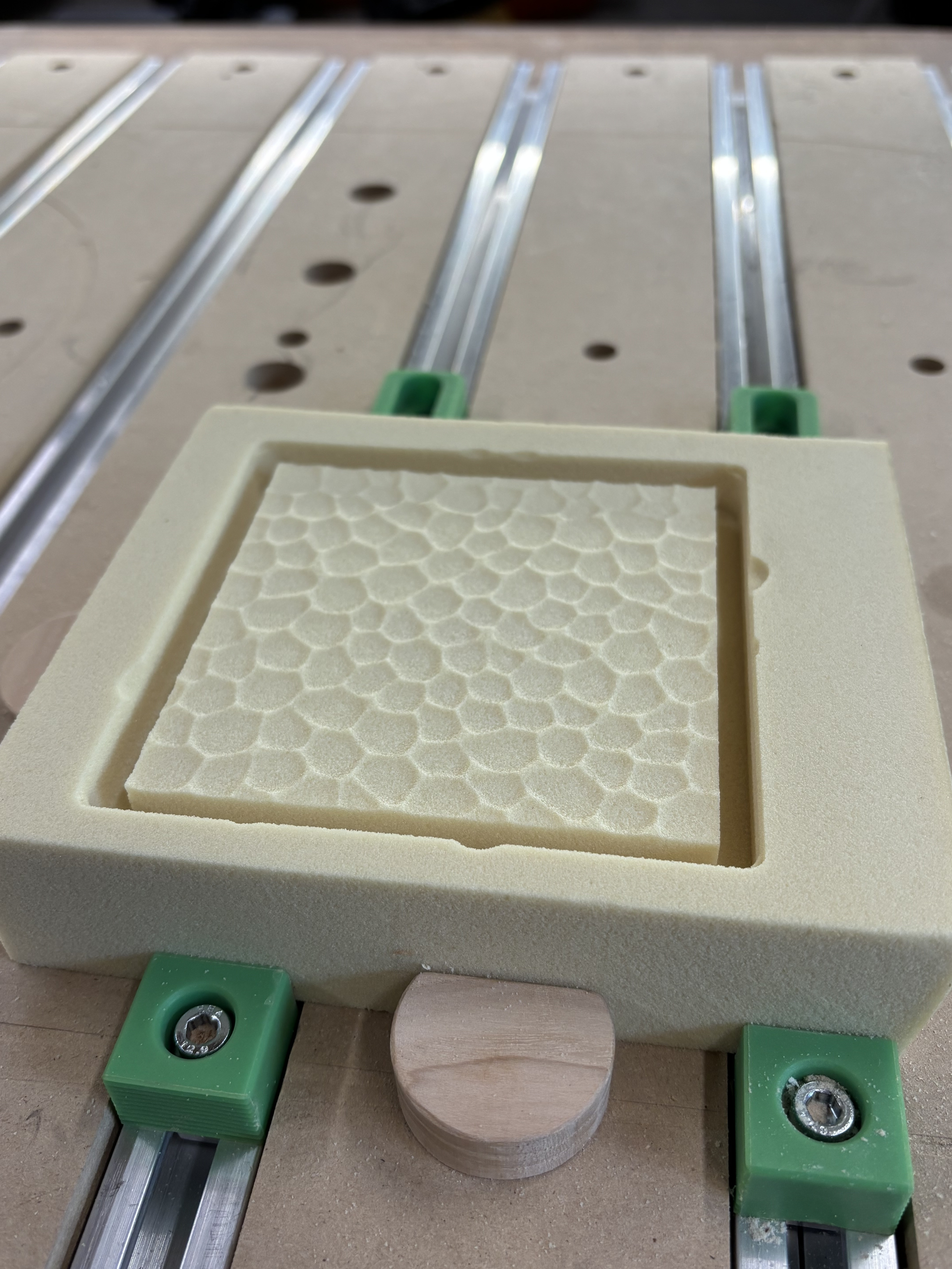

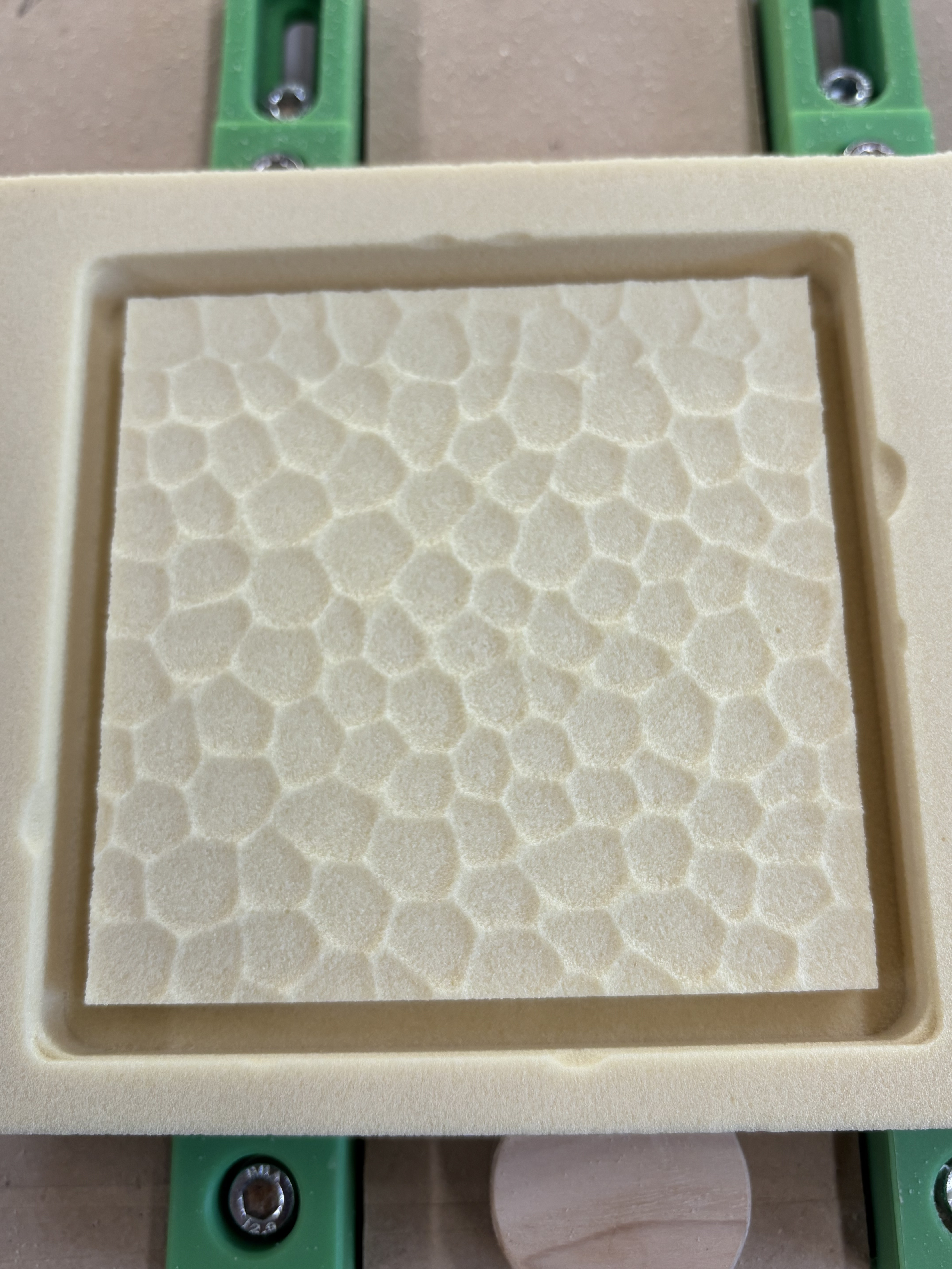

Here’s my first attempt.
I’m building a sheet. Individually built bubbles at first, each warped. Spacing was a little too close and now I’m going to rebuild it deeper. I’m doing this fire a sample for my largest sign to date (38"x60")

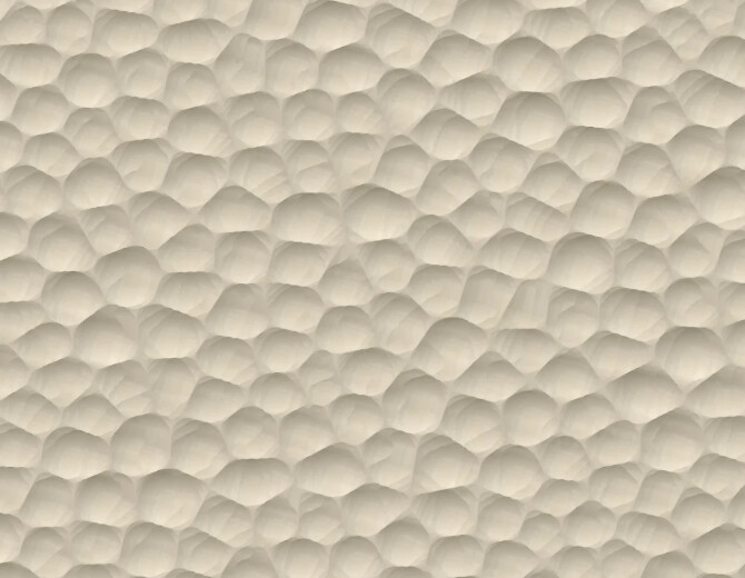

If you look up “image generator bubbles repeating” you should be able to find a texture that can be merged on all sides to repeat correctly.
I had run across a website that did this … hmmmm…
Bubble texture is a good keyword for this.

Well that looks wayyyy better than what I came up with!
