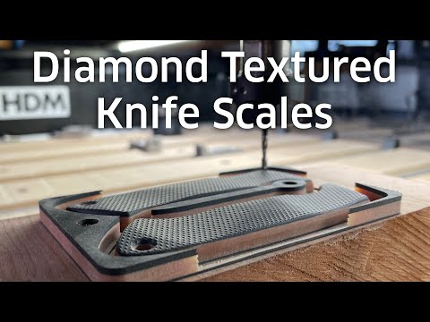

Hey folks, just wanted to make a thread for any discussion about our latest project video. In this video, we go over how we designed a set of custom knife scales for a knife blank we bought online. We start by digitizing the knife with a flatbed scanner. Then we reverse-engineer its shape and design a comfortable handle shape. And finally we machine the scales out using the Shapeoko HDM and a sheet of Richlite.
The end result was honestly better than I expected, and I’d be happy to hear your thoughts/suggestions.

How does it feel in hand? Even with you skimming the back to reduce thickness, still seemed chonky…at least visually.
Yeah, I was surprised it wasn’t a two-sided flip job w/ the first pass removing a black layer from one side and some of the thickness (yes, that feels like a waste of material — I wish this stuff came in half thicknesses w/ only one black paper side, and that we stocked more colours).
It was two sided, I shaved 1mm off the inside.
@SLCJedi I think it’s pretty comfortable as is, but I totally get that thinner might be better. I was trying to save a tiny sliver of black on the inside face, but I might do one last revision where I axe that bit completely and go for a slimmer overall profile. Do some A-B testing to see which I ultimately prefer. Would also let me revisit and perhaps try yet another texturing variation…

Definitely possible, but not without a bit more refinement of the overall shape. There’s still a couple places where the profile is off by 0.1-0.2mm. I’d have to temporarily attach the handles, sand things down perfect, then polish and either anodize or powder coat. I do wonder if the thermal expansion difference would make them unsuitable to attach with epoxy in the long run though.
I used pretty much the exact same method(2d printer scanner) to make some custom purpleheart scales for my wifes Boker AK1. I was surprised how easy and very little refinement was needed to get a perfect fit.
To me, the scales looked quite beefy. But if it is comfy that’s all that matters in the end. I defintely prefer the radial pattern from an asthetics standpoint.
