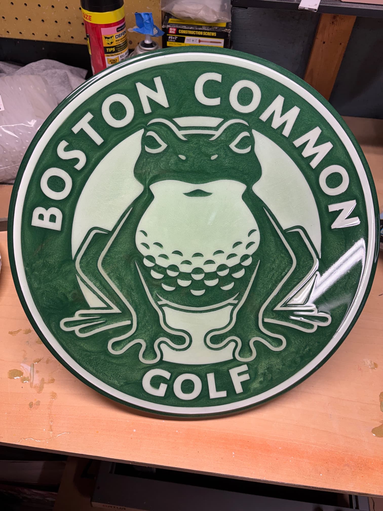

First project on my XXL Pro

What was your workflow to get to the final sign? Any paint ? Or epoxy, carve, epoxy etc? I like that and it may be within my skill set. Thank you.
Advanced V Carve #102 clearing #302 v bit. MDF (3/4). Raised portion painted white, epoxy with some shiny mica powder added. The raised surface was supposed to stay white but the resin I had was old and to thick to get into small openings, so I just filled and flood coated the entire sign. Definitely give it a try.
