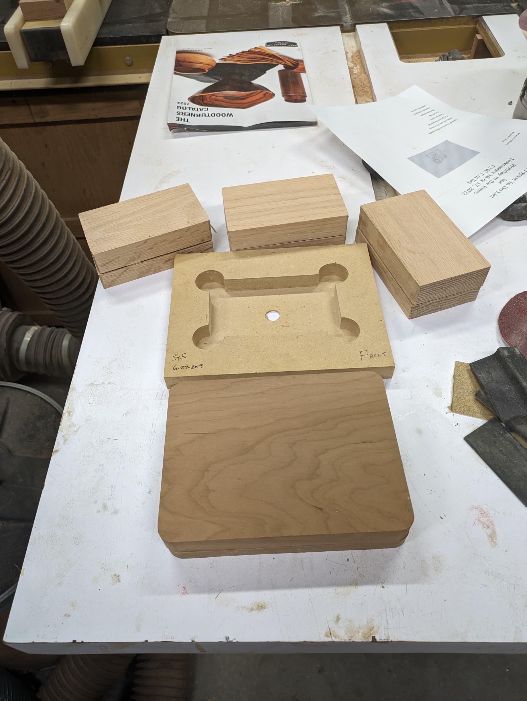

I have 3 trinket boxes to carve and paint and one 5x7" box.
This is for the 5x7 box

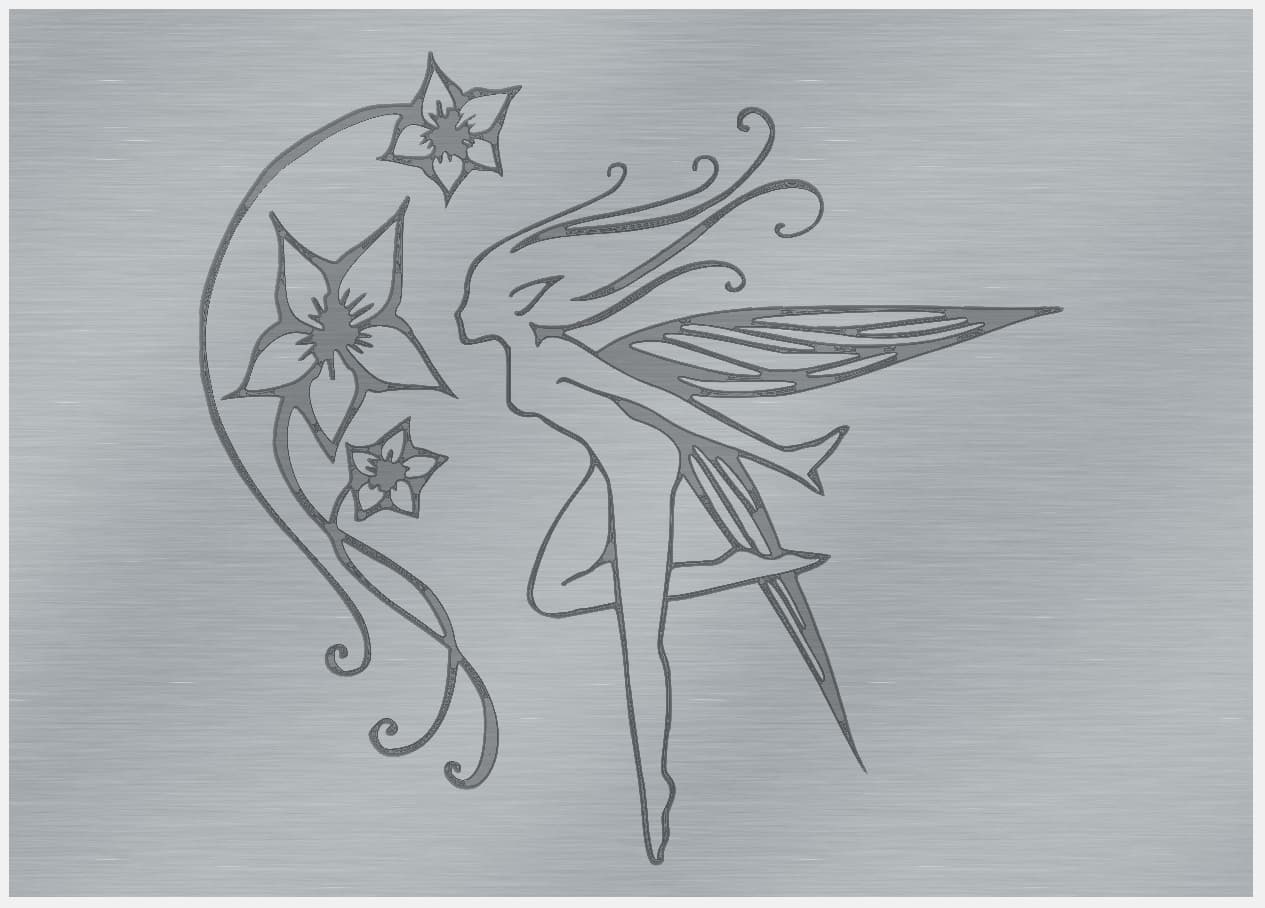

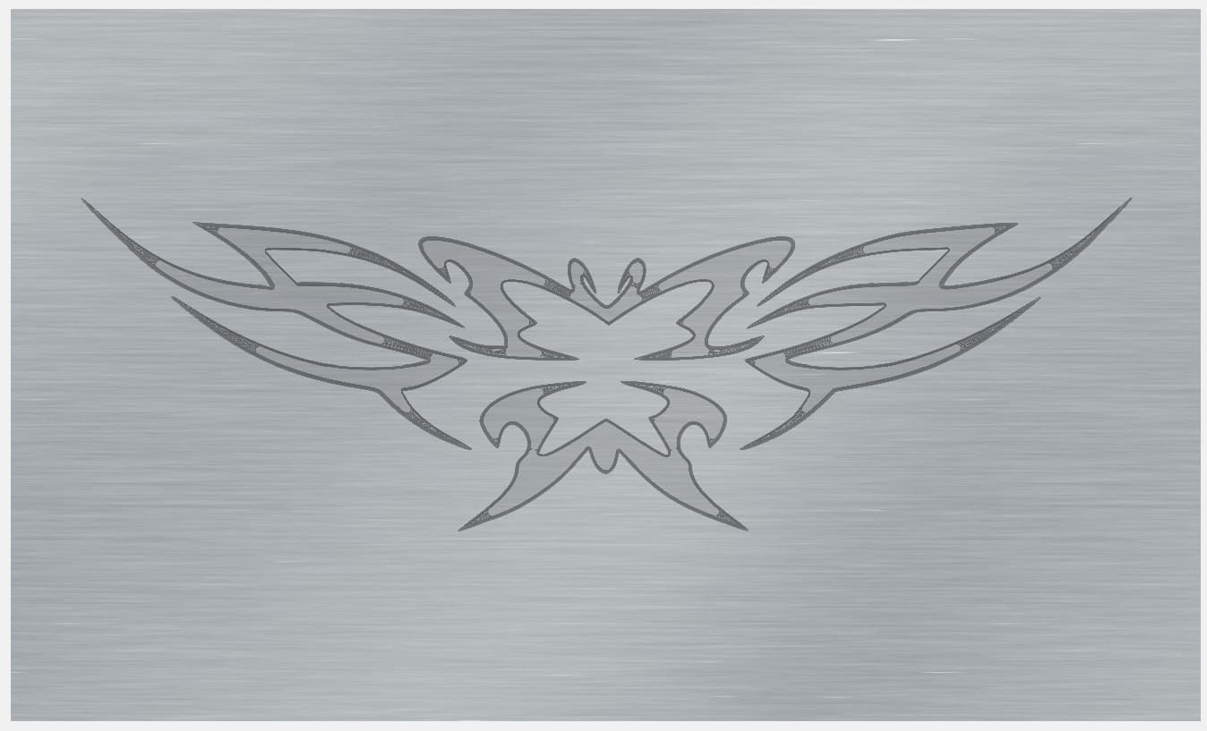

Here are the simulations for the other 3 boxes

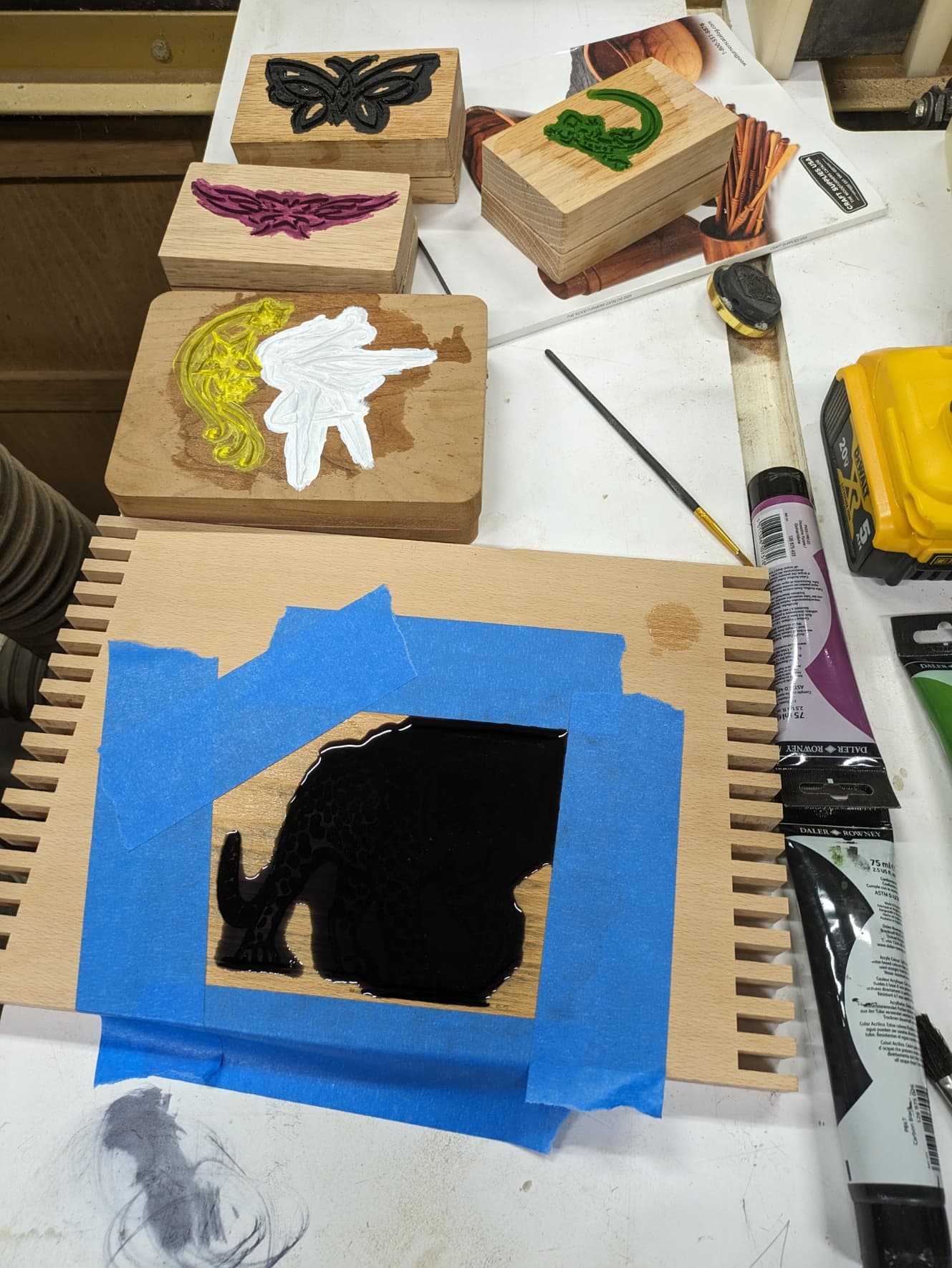

Alls well that ends well. I got the Jaguar finished and the black epoxy poured. The other 4 boxes are carved and painted. The trinket and 5x7 box are too small to run through my Jet Drum Sander so I just painted them. The Fairy was painted white and the flower yellow. I got two coats of each color on that box. The other 3 got painted as well. The tribal butterfly was painted purple and the other butterfly was painted black. The Lizard is painted green. All got two coats of paint. In the morning I will see if any of them need an additional coat of paint when thoroughly dry. By tomorrow night I will be able to sand off the Jaguar.
Here is a picture of my work for today. I used dewaxed shellac on all the carvings and then painted and/or epoxied. The dewaxed (Zinsser Universal Sanding Sealer) keeps the paint and epoxy from soaking in to the surrounding grain preventing a halo effect.

This morning got 3 of the boxes sanded. The 5x7 box I had to put on a 3rd layer of yellow paint so it is still too wet to sand. The epoxy filled jaguar is technically dry but I will wait until late this afternoon to sand off the excess.

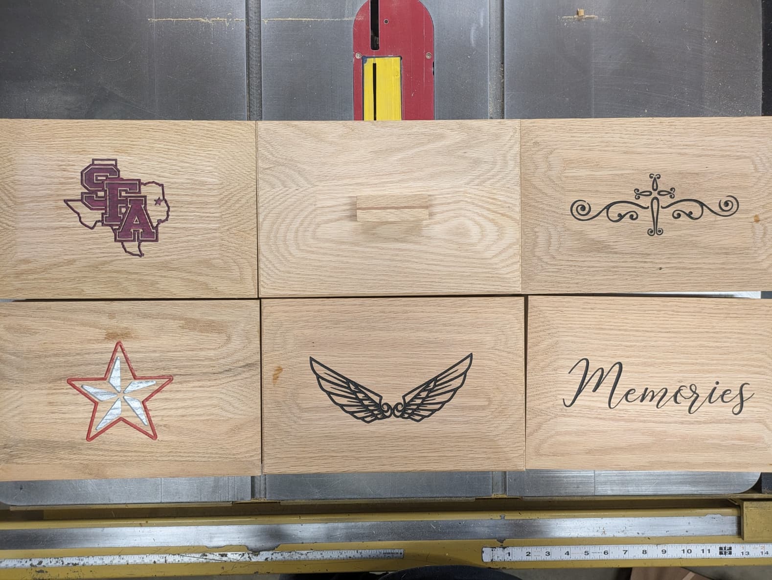

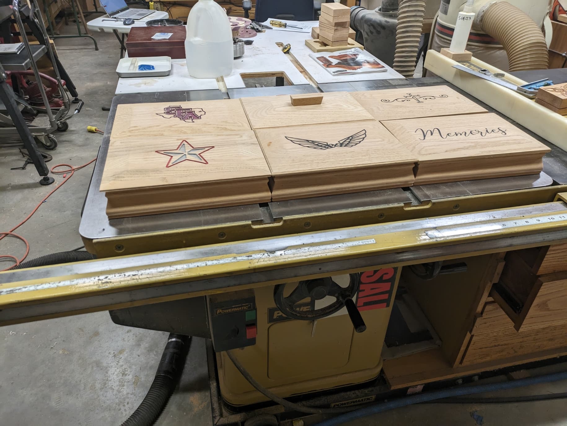

These are the keepsake boxes. They are 12 x 8 and will hold a Hallmark type card. The lids were cut on the Shapeoko. A couple of the lids had to be repainted. They are all complete with bottoms and lids and sanded to 120. I need to finish sand them to 180 or 220 and will spray a finish in mass with the jewelry boxes. My Earlex HVLP sprayer takes a long time to clean up so I only use it when the project is big enough to justify the time to clean it up. I spray Minmax Polyurethane satin. The insides of my jewelry boxes and the keep sake boxes get a lemon scented wax from Craft Supply USA. The reason is the polyurethane stinks forever in a closed box.
Here are the lids from above. The one on the top row center has a handle on it.

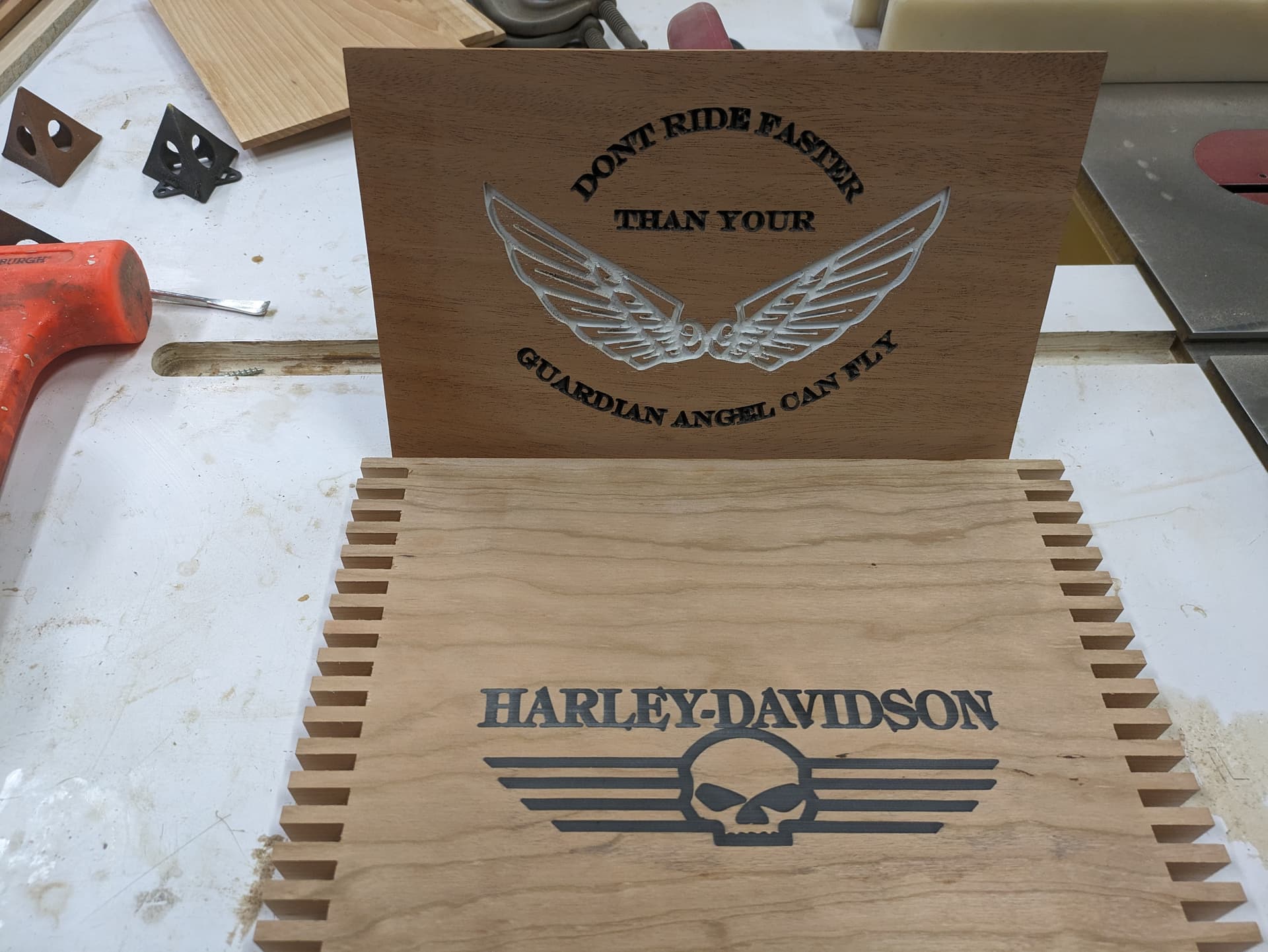

Can you tell me more about this process? Do you brush this on before the carve or after or both? I have tried spray on lacquer and not been happy with the results. It always seems to leave a shadow after sanding. I thought i was melting and smearing the epoxy in the sanding .
After carving I brush Zinsser universal sanding sealer with an acid brush in the carving. I apply with a rag on flat parts. I put 2 coats on. It dries in about 15 minutes. I spray with an air brush or use a 1/4 x 1/4 masters brush. Key is getting corners of carve painted so I don’t have to touch up paint after sanding.
The lettering was painted with brush and wings air brushed.
I used painters tape to cover lettering before air brushing. This is mahagoney and is quite pourus. I got no halo around anything.
The Harley carve is epoxy filled and use shellac like painting to keep dye from penetrating wood.
