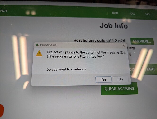

The dreaded depth error
Why is happening? It is a common occurrence that I see about 25% of the time I use my machine. If it is a small number I usually just press on.
I follow the same process each time. I initialize the machine, clamp down the work piece probe the BitZero and use the BitSetter. The entire purpose of BitSetter plus BitZero is to prevent this type of thig from happening. I don’t need advice on how to fix this one instance. I need a method to prevent it from happening in the first place.
This is a warning as noted at:
Usually it is caused by a mismatch between job setup:
and how origin is set relative to the stock:
I find that opening the .c2d file up and drawing a box which matches the specified dimensions (draw up the cut in profile if need be) or moving the machine to the origin and then using a tape measure to measure out the dimension(s) in question will make clear where things aren’t lining up.
That said, the solution is two-fold:
  • to chuck up the shortest tool you plan on using, position the spindle so that it is over the aluminum T-track, move the Z-axis down as low as the machine can go, then adjust the spindle so that that tool will just barely touch the surface of the T-track
  • when loading/starting a job, always have the longest tool which will be used installed when CM evaluates the travel distance
A permanent fix would be to only use tooling of a consistent length with depth collars and to never deviate from that tooling offset length
The problem with the Z bounds check is that it cannot really know for sure if there will be a crash until the tool change happens and the true offset is found.
The warning is usually accurate if all of the tools have a similar length to the tool currently in the spindle. If you have a mix of tool lengths, it’s less reliable.
Because of that, the Z bounds check will be removed in the next release. Feel free to skip it.

The bounds check is a relatively new feature. The Z check will be redone in a different way in a future release. The future version will not be based on the current code, so the existing Z check can be eliminated now. The X and Y checks are solid.
Correct, and there’s no problem with any of that. There’s a problem with the implementation of the Z bounds check that leads to false positives.
Only pay attention to it if the first but in your job is already in the spindle and has already been measured. Otherwise the difference in length (stick out really) from the bit currently measured and the first in the job leads to misleading info in the error.
