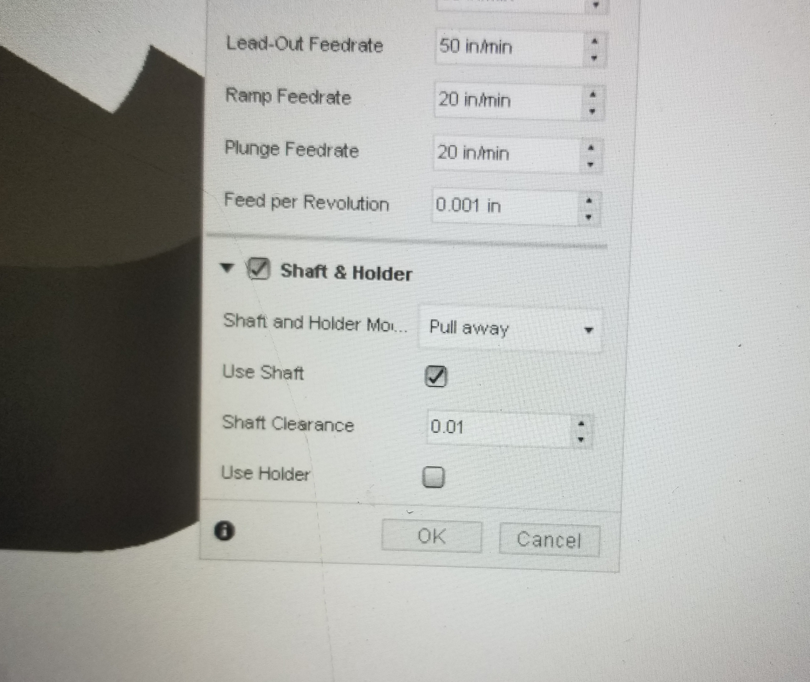

One option is using a single flute like the cd3 one and programming the cam to step away from the wall for shank clearance after the cut gets deeper than flute length. Easy to do in fusion, give it at least 10 thou. Then come in with your long three/two flute and run a contour finishing pass on the walls.

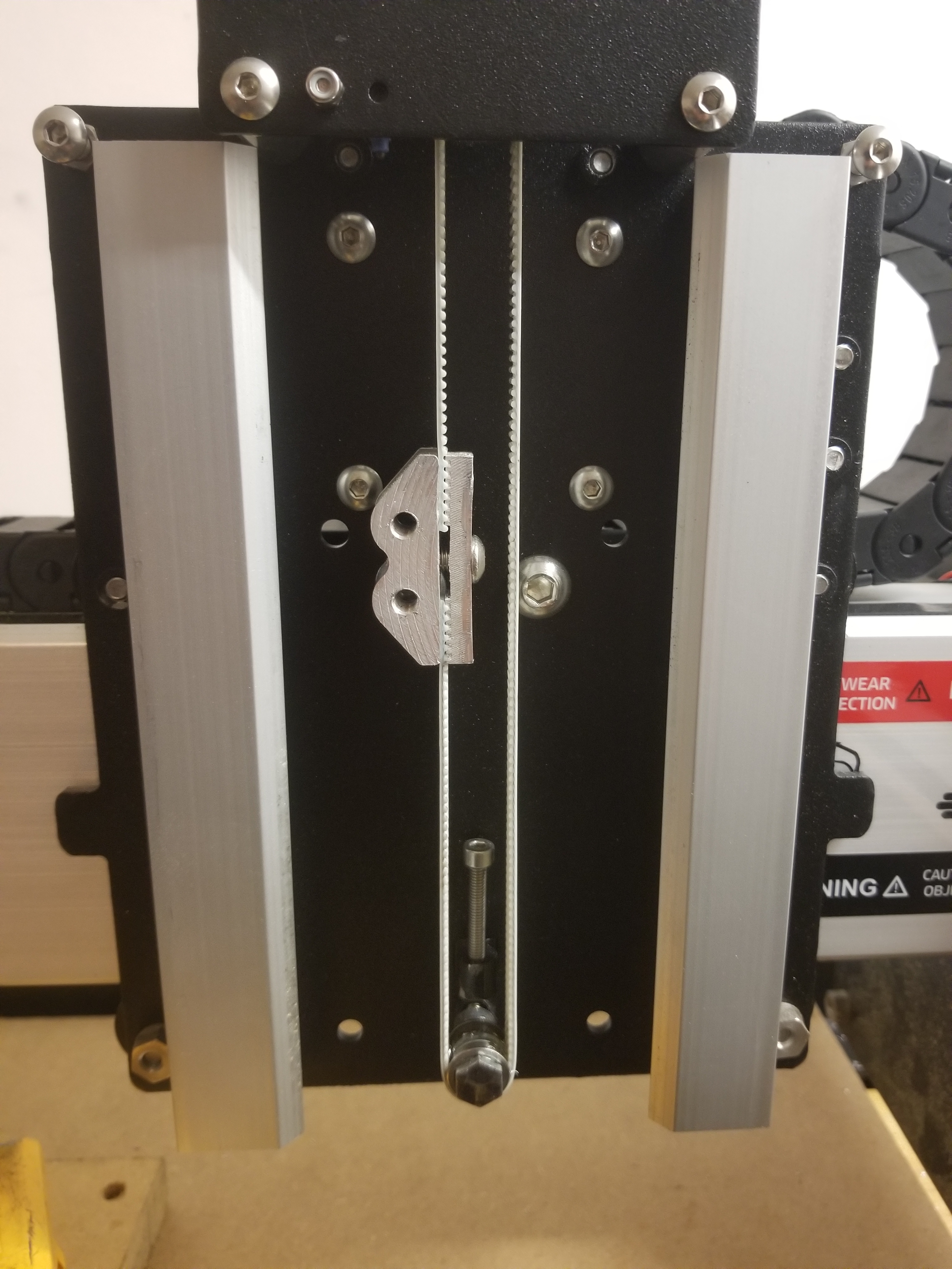

I’ll put money on your three flute chip evacuation leading to a skipping Z belt. The stock Z belt is 6mm and can slip pretty easily when stuff loads up. I threw together a 9mm belt conversion that seems pretty beefy.

Also, definitely interested in the 9mm belt conversion. I’d go right to an HDZ, but it looks like the distributor has been long on getting the plates in. Can you point me towards that?
Fusion is easy, just go into your adaptive toolpath and in the Tool tab you’ll see “shaft and holder” option. See attached photo for setup. Usually I’ll only use shaft enabled unless pockets get deeper than the collet nut…super fun lol. Make sure your tool is programmed in your Library exactly*
Also attached a photo of the conversation. Its very simple and only needs little mods. Haven’t really had the time to finish cleaning up the design but it’s a working prototype. Needs upper 9mm pulley. 9mm open length belt, lower puller spacers and the two machined parts. Lower bolt head and rear of the Z plate need to be clearanced a bit.
HDZ is definitely worth it and the Z plus seems to be up there as well if you don’t mind reduced travel.
