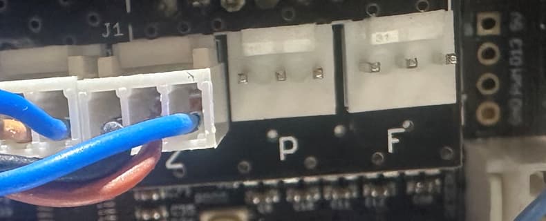

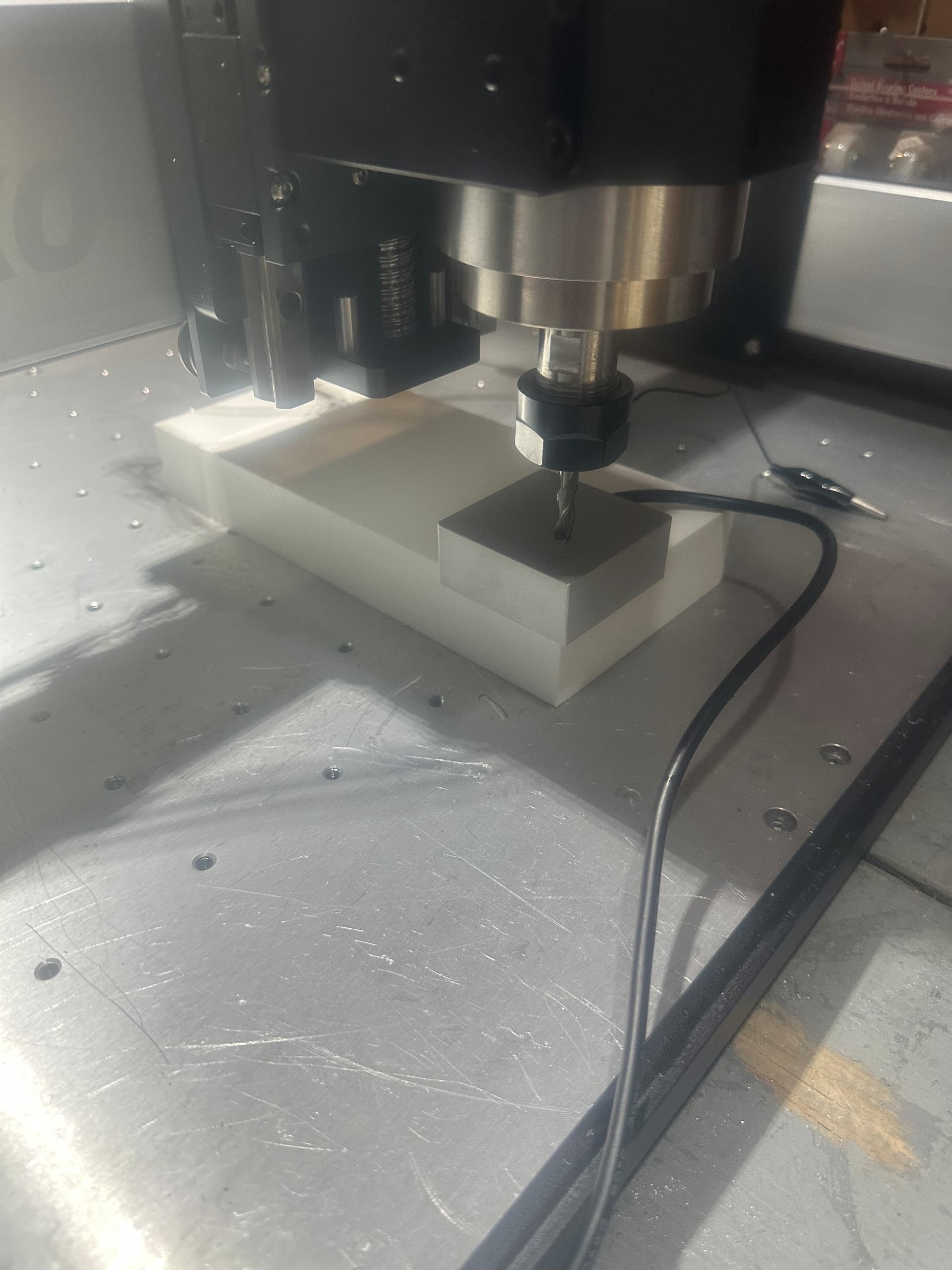

I am in the process of upgrading my S3 standard to the HDZ which required me to upgrade the control board to support the proximity sensors which use 3 pin connectors.

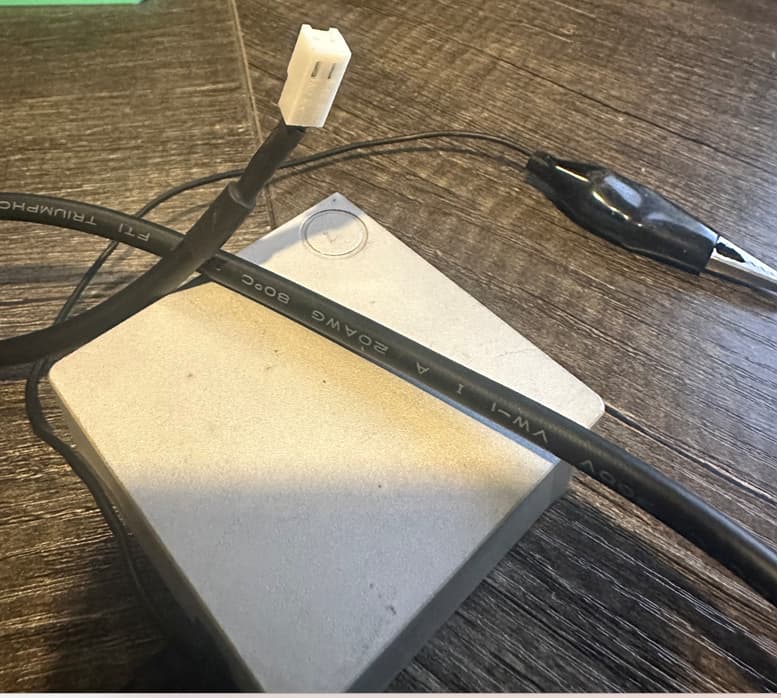

My third party probe has a two pins connector.
I wondering if anyone managed to re-use such probe with the 3 pin connector.
Base on the wire colors of the proximity sensor it seem that the layout is
ground | +5V | signal
The colors are misleading. Black is Signal, Blue is Ground.
You’ll need to change your connector.
They’re was a thread here about it.

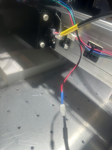

Thank you Neil, I will build an extension and report back.
The old two wires third party probe works perfectly with the latest carbide3d controller 3 wires connector.

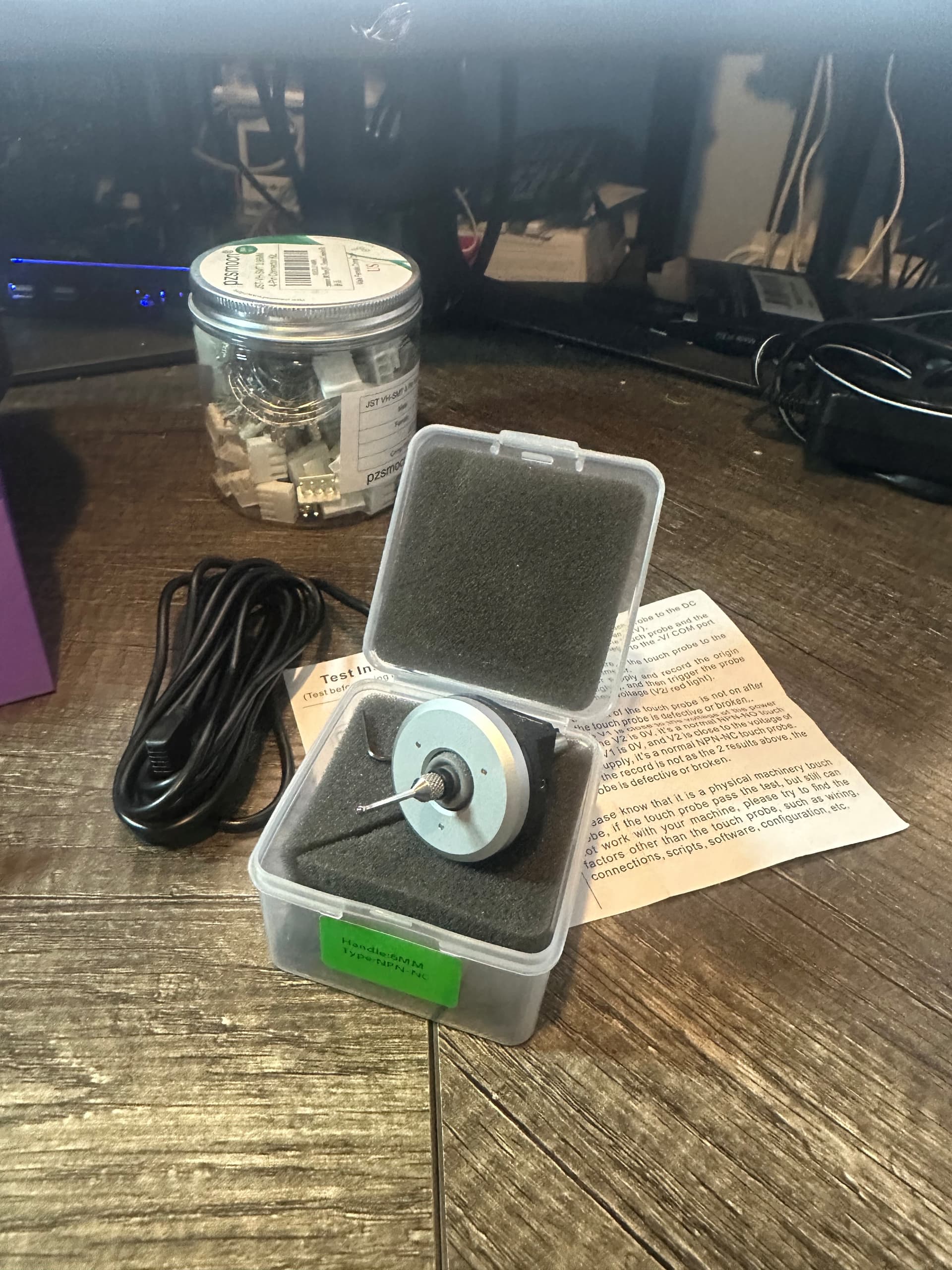

I installed the probe splitter because i want to try a needle style probe
