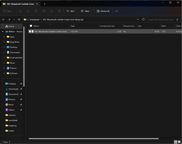

I want to take this file.
IDC-Woodcraft-Carbide-Create-Tool-Library.zip (5.2 KB)
Which I believe to be in the correct format for Carbide Create by the title and import it into CC7 with minimal work on my part. I want very much not to have to manually enter data as I am notorious for misspelling or missing a comma or something like along those lines.
Ideally it could be a separate library all together.
I find no way to import external library or CSV file into CC7.
Open up the .zip archive:
Launch Carbide Create and choose About:
click “Open Data Directory”:
go into the Carbide Create directory:
go into the Tools directory:
Drag the .csv file into this folder:
quit and relaunch Carbide Create:
The file does not show unless you select all machines, but it is there.
