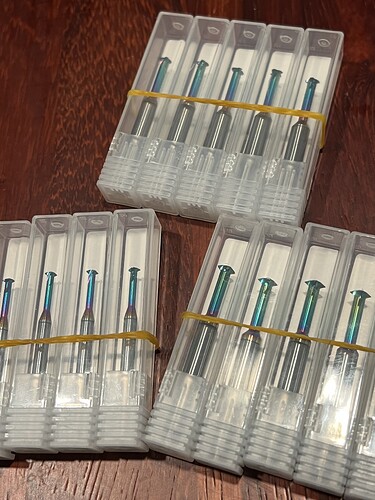

I wouldn’t be opposed to buying a couple DLC-coated threadmills for 10-32/M5x.08 off you, @HeuristicBishop …
In my defense, they were only sold in 5 packs at the time and the 5 pack was about the same price as a single tool from online carbide…that and I bought the wrong size the first time :melting_face:
I certainly don’t need 5 of each, I’ll shoot you a DM to figure out shipping and such :beers:

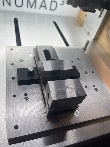

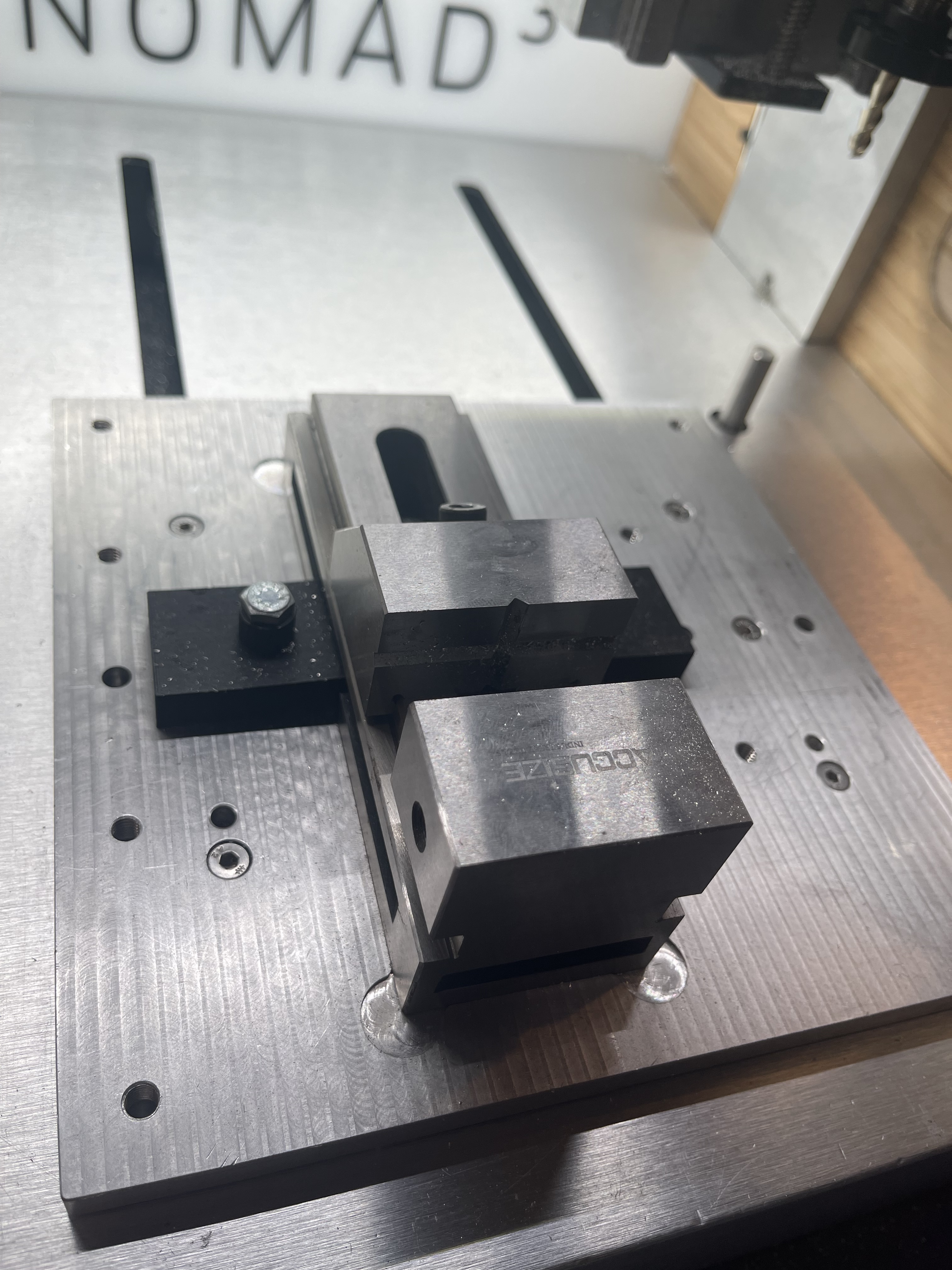

I milled an indexing pocket in my bed and added this nice toolmakers vice. Then I voided my warranty by rebuilding my spindle because my bearings were crunchy. I used cheap 608 skateboard bearings because sourcing high quality ACB’s in that size was an exercise in futility. Light “adjusted by feel” preload on the bearings and they seem to be doing great for aluminum and brass for the last 20 or so hours of use. The runout as measured a few mm down the shank of a 1/8 endmill is somewhere around +- 3 thousandth. That’s kinda high but expected for cheap skateboard bearings lol. While I was in there I geared it down to run about 2.4x lower rpm. So now my range is like 6-10k instead of 10-24k.
Why am I posting this in a thread about tooling? Because now I can run my nomad 3, happily, with 1/4” endmills in 6061.
