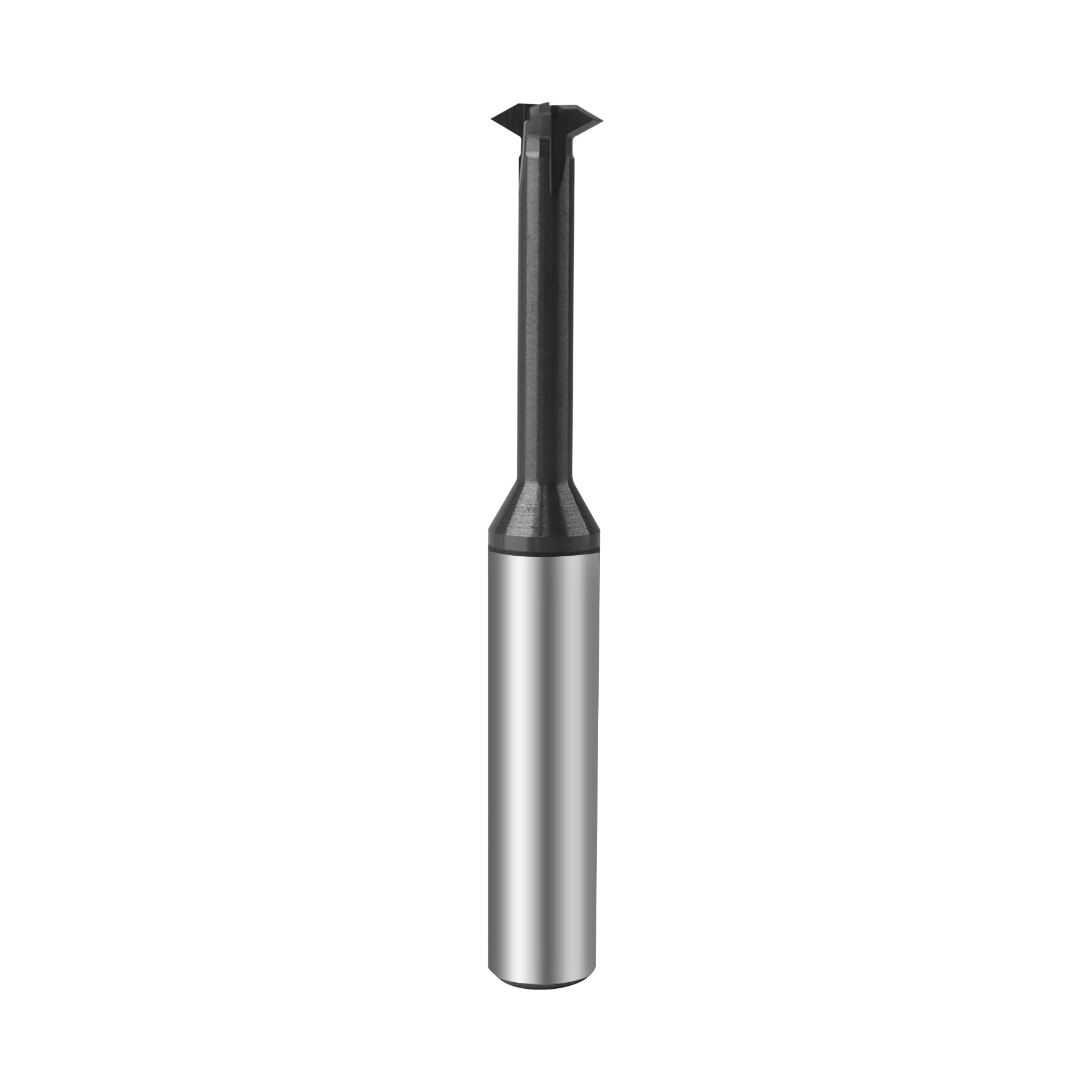

Single form is threadmilling one tooth at a time instead of milling the whole depth of the hole in one pass.
A standard threadmill will have a specific size - e.g. a 10-32 threadmill will have 3-15 teeth, and they will each be spaced exactly 1/32" apart. You can threadmill 3/32" - 15/32" of hole depth in one revolution as a result, but you can only machine a 32TPI thread with this sort of tool. Oh, and it takes more torque.
A single form threadmill is just one tooth. Therefore, by adjusting the NC code, I can use my #10 single form threadmill to cut a 10-32, a 10-24, or a 10-28.75 thread. Really any pitch I please (within a few limitations I’ll cover later). If you do a variety of parts (or are only doing one-offs and prototypes), this flexibility means you need a tiny fraction of the number of tools, and can have a backup or two of each tool without breaking the bank. Awesome.

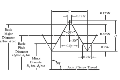

Let’s say I overcompensate on my “minimum hole size” above, and say “I’ll get a teeny-tiny threadmill so it fits in every hole from a #2-56 up through a 3/4”-10." Yes, it will fit - but I have now limited my threadmill to having a maximum diameter of 0.0667" (the minor diameter of a #2-56 hole). This means by “tooth” can be no bigger than 0.0333" tall (assuming my tool shoulder is 0.001" thick) - so I’m unable to reach the root of any thread with a pitch greater than 30TPI.
(Variable H in this graphic.)

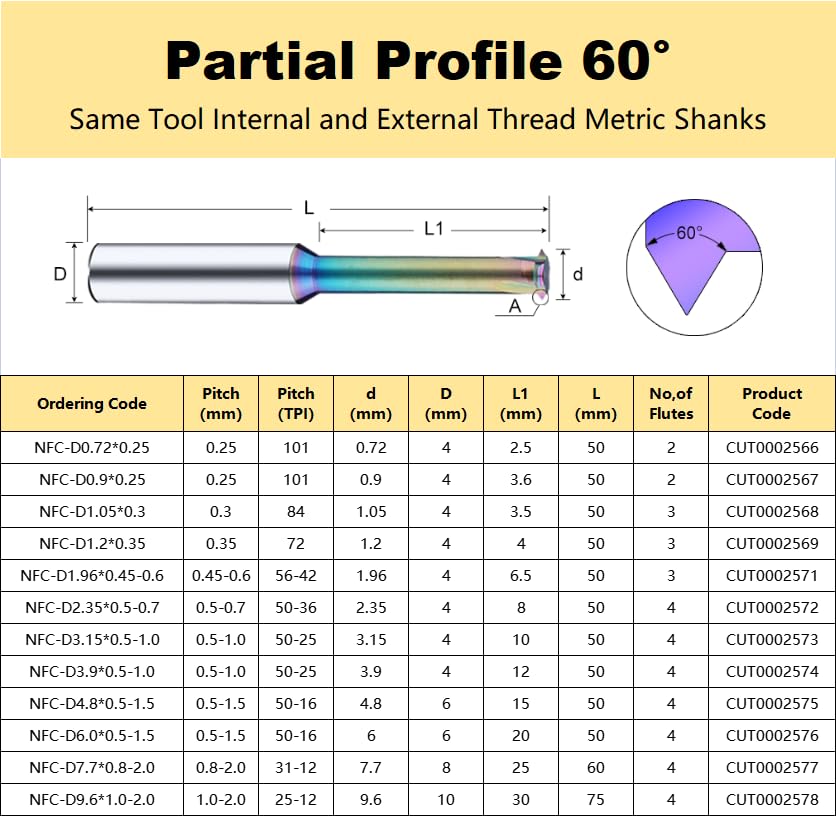

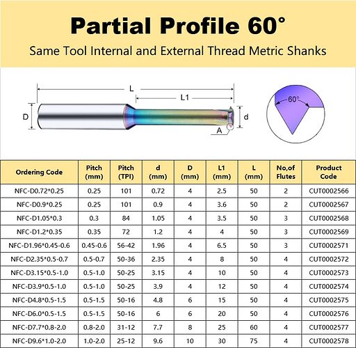

So there is a tradeoff - small threadmills can only cut small pitches. Bigger threadmills can cut bigger pitches, but can’t fit in small holes. And at some point, as the thread gets bigger, the thread crest/ root gets bigger (0.125P and 0.25P in the diagram above), so you’ll get some sloppy, incomplete threads. (Which you could chase with a hand tap in a pinch.) As a result, most threadmills will come with a data card that shows both minimum and maximum pitch allowable. Like this one.
Shoulder Length - Simple stuff. How deep is your threaded hole? Make sure L1 (in the above table) is at least that deep, or the threadmill shaft will bump into the top threads.
Overall Length - How big is the machine; how much Z-travel do you have? I’ve had to cut a few threadmills to length (stick it in a collet, spin it in a lathe, grind it to make a weak spot, then crack it off. Yikes. Wear a mask.)

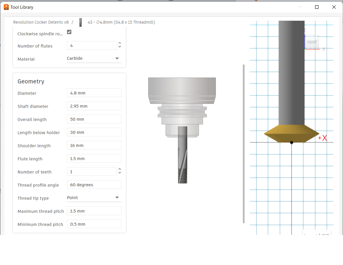

This will depend heavily on your CAM software, but select a tool, then there are two key variables.
I selected a threadmill of appropriate size, and put in the data for my tool library. It shows a multi-form by default, but when I tell it “1 tooth” the CAD drawing to the right updates. Notice there is a minimum and maximum pitch field (so it warns me if I’m using that #2-56 for a 1/2"-13 thread), as well as shoulder length and all that stuff. You can do ACME and trapezoidal and Whitworth threadmills too, but they have different point geometries (and are harder to find).

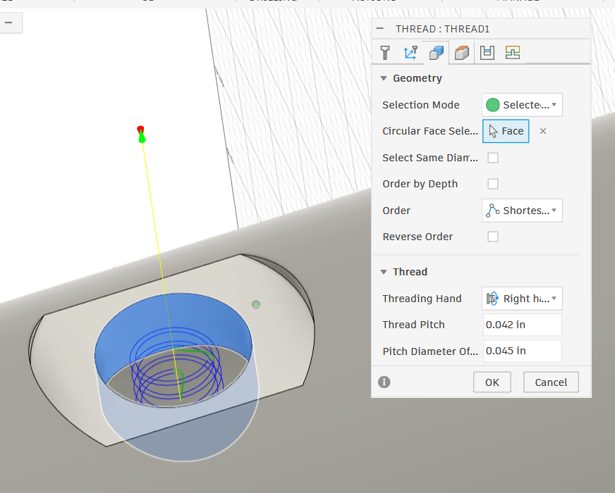

Once I have my threadmill selected, time to program the toolpath with my two big variables:
Pitch
Offset
Pitch is the distance the threadmill will travel axially per revolution. (For a 3/8"-24 thread, this is 1"/24, or 0.04167".)
Offset is the distance the tool will plunge radially from the modeled minor diameter. This is a function of your thread height. (For a 3/8"-24 thread, it is 0.375" - 0.330" = 0.045" because Fusion does it in diameter, not radius.)

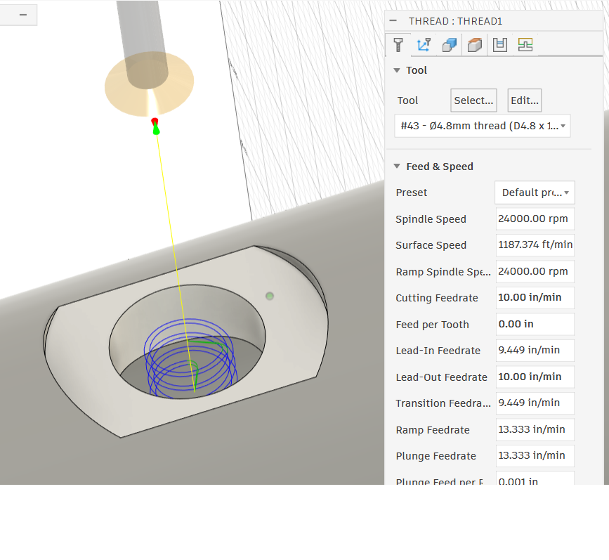

I select a hole (modeled at my minor diameter and bored to size in a previous operation), then tell it I’m threading. I pick conservative speeds and feeds with light cuts because the narrow neck on these tools makes them flexible and fragile. I should probably slow it down as I’m making more powder than chips but no problems yet, and I’m trying to get a really smooth finish.
Then I input my thread data - the pitch and offset.

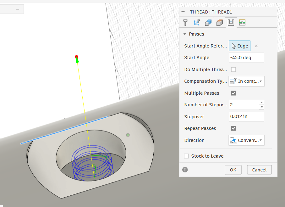

Then I fine-tune. On this part, I’m trying to cut a blind thread to install a spring-loaded ball stop in the wall of a tube, as far in as possible without raising a burr at the end of the thread. I want to have a small lead-out, and have the thread stop not on the centerline of the tube, but perpendicular to it, where there’s a little more “meat”. This lets me cut about 0.020" deeper than if I had it stopping at the shallow portion parallel to the tube centerline. So, I told the thread to start at an angle (45 degrees in this point) that gives me my preferred lead out location. Yeah, pretty cool that I know exactly how the thread will be “clocked”. Can’t really do that with a hand tap (which tends to start wherever it wants to). I also decide to do a couple light passes, and repeat them, so the flanks of my threads are nice and smooth. I do a conventional cut direction - which is top-down on a threadmilling operation. You can do a climb cut and start at the bottom and cut up and out, but that seems weird and scary.
