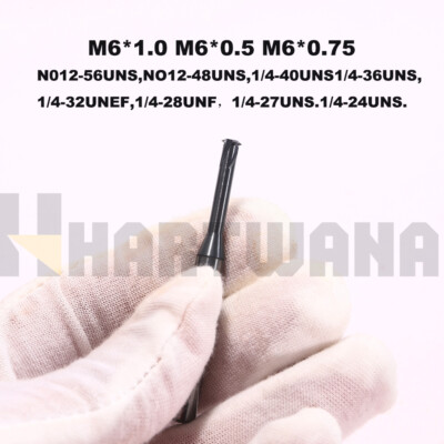

***This post has been editted i have added a photo showing a correct thread mill. ***

Please provide a link to the tool which you are considering buying which includes all the details of the geometry, as well as your rough estimate on initial feeds and speeds to use and we’ll try to put this together this evening.
M6X1.0 D4.85X20XD6X60X4T SINGLE PITCH THREAD MILL TiALN COATED For 60 Degrees
For machining internal threads.
Processing pitch range
M61.0,M60.5,M6*0.75
N012-56UNS,NO12-48UNS,1/4-40UNS1/4-36UNS,1/4-32UNEF,1/4-28UNF,1/4-27UNS.1/4-24UNS.
Threaded cutter 4.85mm in diameter.
Machining length20mm.
Shank diameter 6mm.
High performance solid carbide.
WALTER 5 axis grinding.
High-end surface plating finish.
Suitable for carbon steel, stainless steel, cast iron, heat treated steel. Alloy steels.
