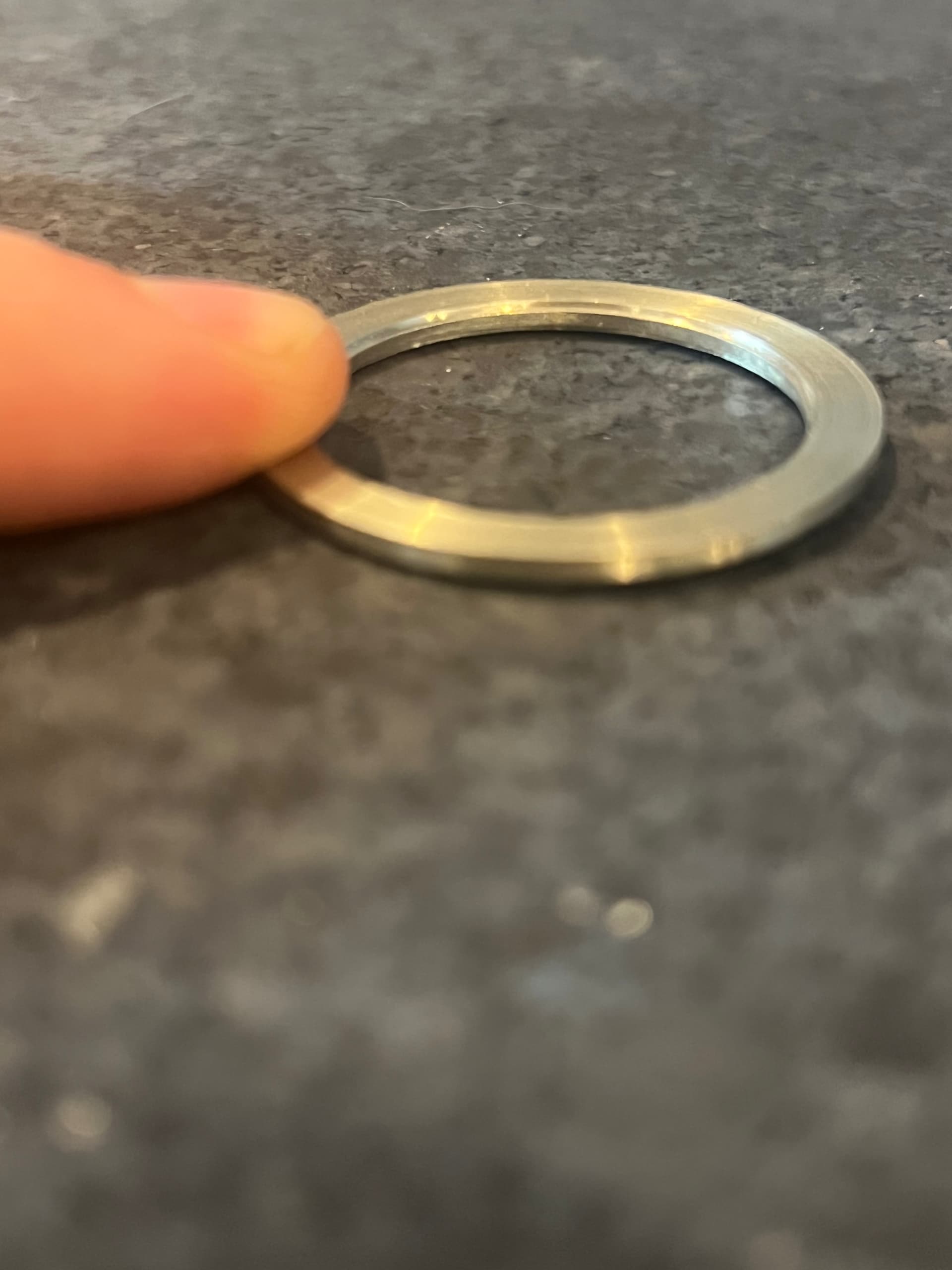

Relieving the corners on the edges of the rings needs to be less aggressive. The rings have a touch of wiggle when pressed on the very edges and I’m not a fan of that feel.
This photo is exaggerated without the slots to constrain the motion but it gets the point across. The ring lifts slight on off axis pressing:

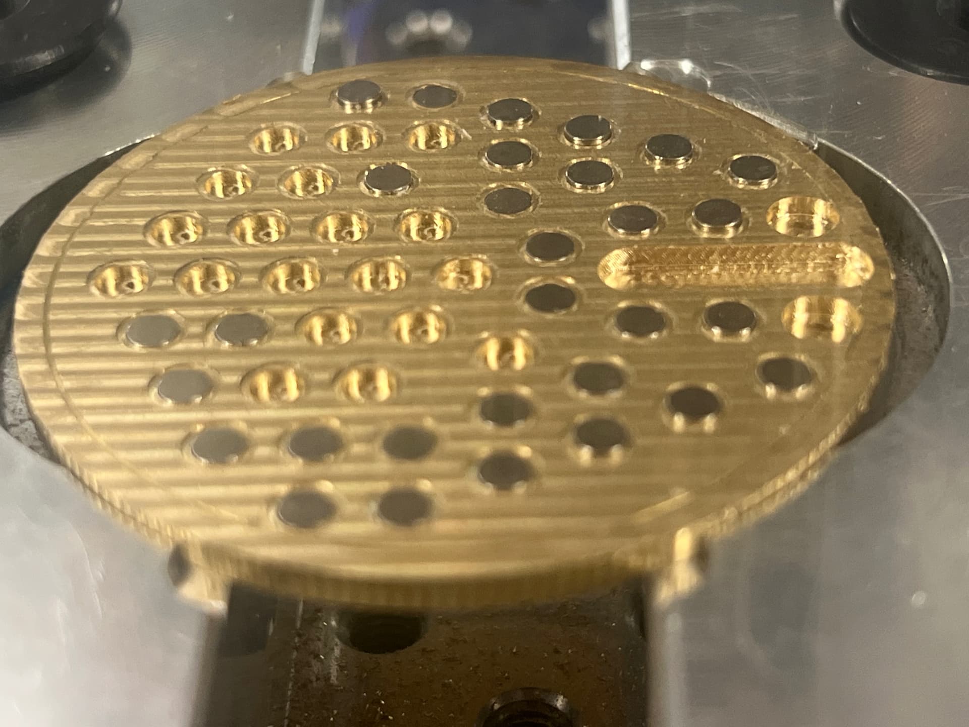

On tolerancing the magnet press fits, I decided to try a simple press fit in the off chance it worked. It went surprisingly well. Too well. I still don’t trust it :stuck_out_tongue_winking_eye:
I started with a hole bang on 3mm and no tolerancing at all.This fit like a hot dog in a hallway.
From there I made a bed of holes, increasing stock to leave in increments of .005mm.
I assumed this tolerancing would be too small to be repeatable so once I got a range that seemed to work, I replicated them 4 times each to see how consistent the fit was.
Every hole worked exactly as expected with very similar fits and feel when press fitting compared to the first test. I don’t know how accurate the holes are but giving credit where credit is due, the nomad 3 is surprisingly repeatable :ok_hand:
As a reminder, I am using 3mm by 1mm magnets, as standard in the tabletop gaming scene. This means they are dirt cheap compared to most other small sizes.
On the batch I received, a stock to leave of .07mm creates a very slight press fit which can be pushed in with just my fingertip.
The force increases as expected until a stock to leave of .105mm which requires a press and feels dangerously close to shattering the magnet. I really want to set up a little force gauge for documenting this kind of thing properly someday. :person_shrugging:
I counterbored the holes by offsetting the diameter by 0.5mm and giving it a depth of just 0.15mm. Enough to give it a sleek look and absorb some material being pushed up around the press. I also added 0.3mm to the depth of the magnet bores so the magnets can be pushed just below the surface if necessary.
Here is a photo of the test bed:
(There’s a method to the madness, I promise…just don’t ask me to explain it :upside_down_face: )
I chose a stock to leave of 0.08mm for the test, figuring this is a good midpoint between the loosest and tightest holes, it would give the best chance to work with any variation of the magnet diameters.

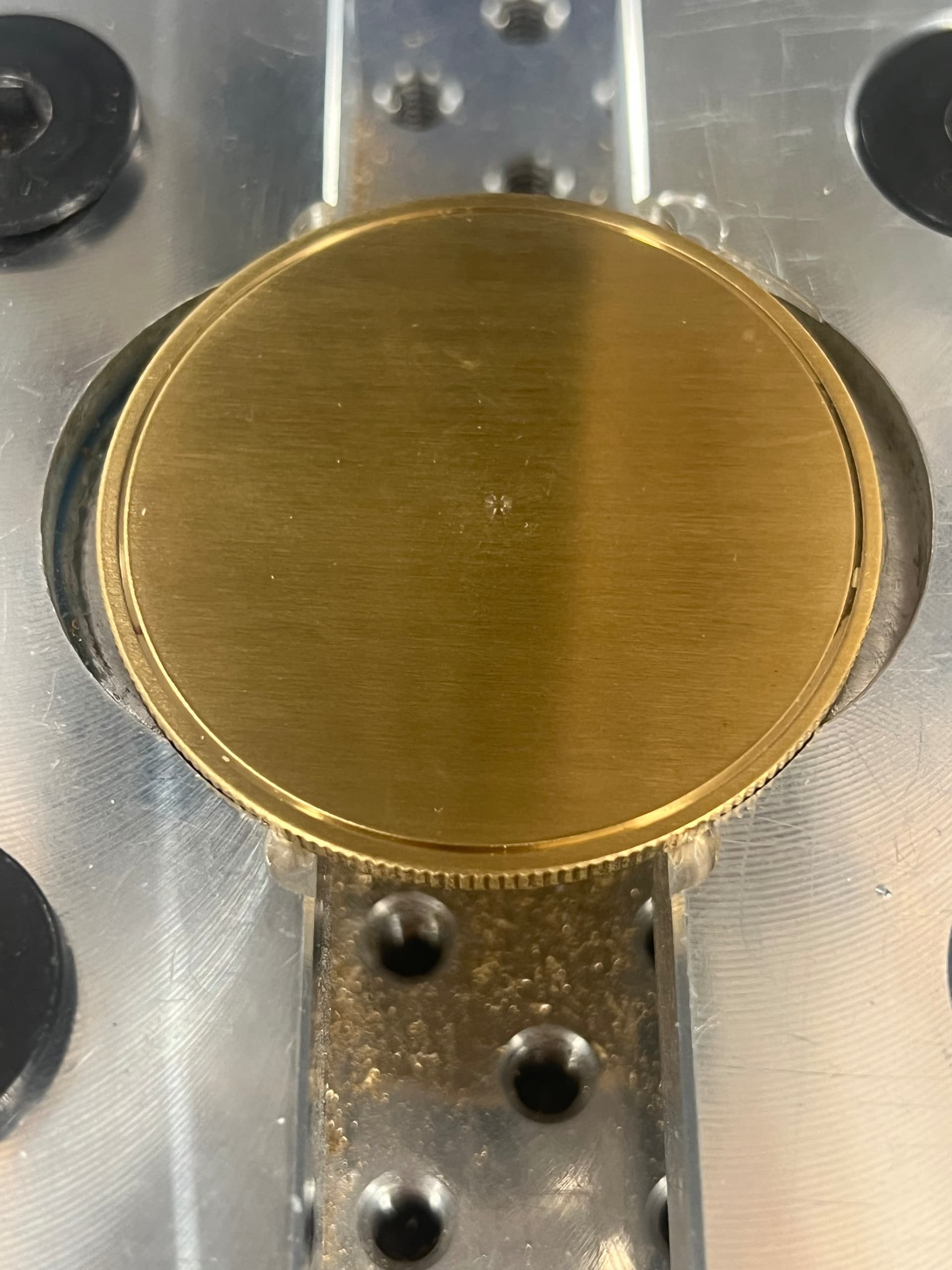

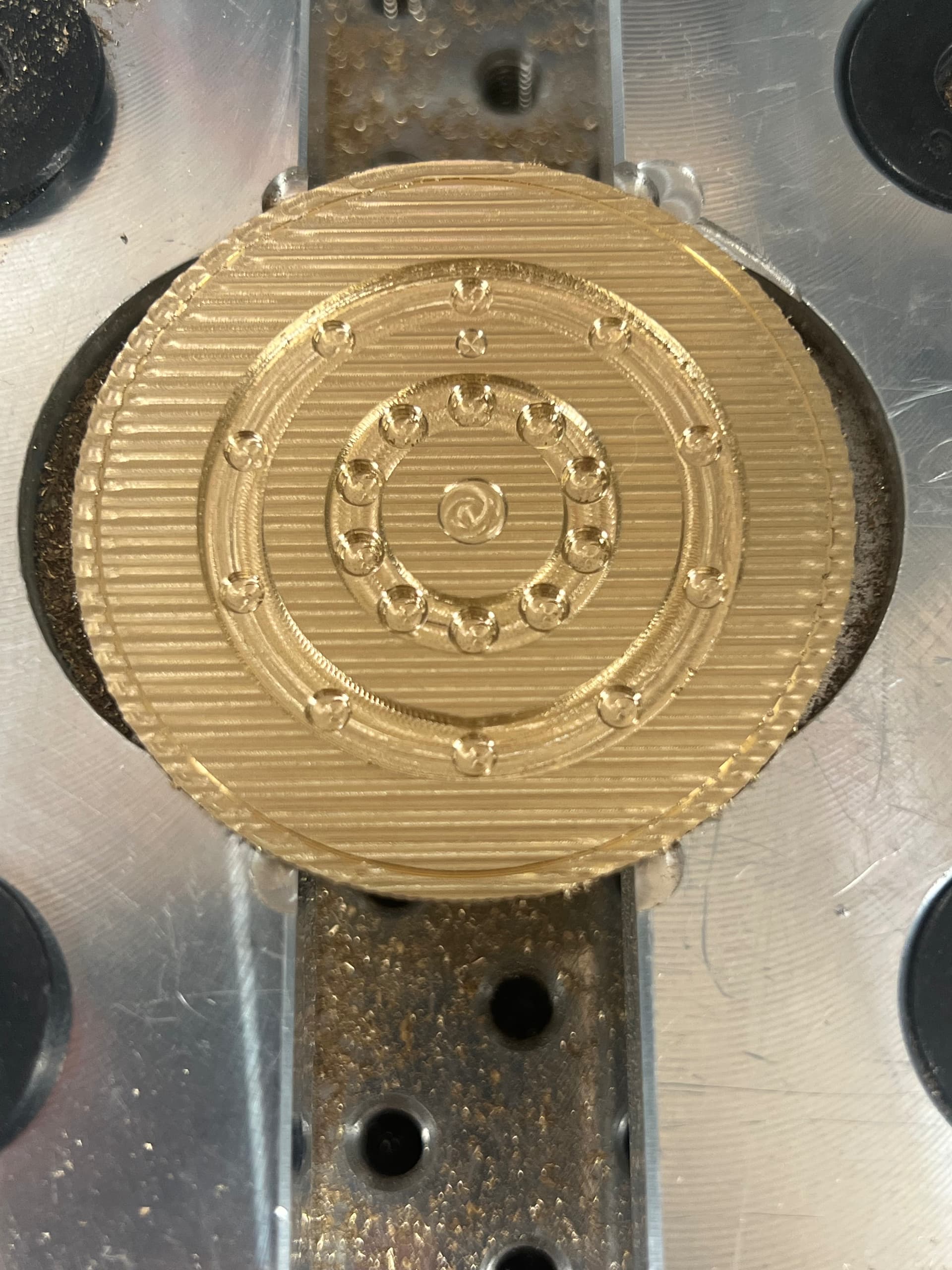

This entire coin took something like 4 minutes:
Before:
After:
Some really important notes on feeds and speeds for small bores, you have to apply a correction factor or you’ll be feeding way too fast. This brought my “ideal” feedrate down from ~70in/min to ~20in/min. [1]
I’m still not really confident that I’m doing any of this correctly but the machine didn’t seem to mind at all given a 0.3mm depth of cut.

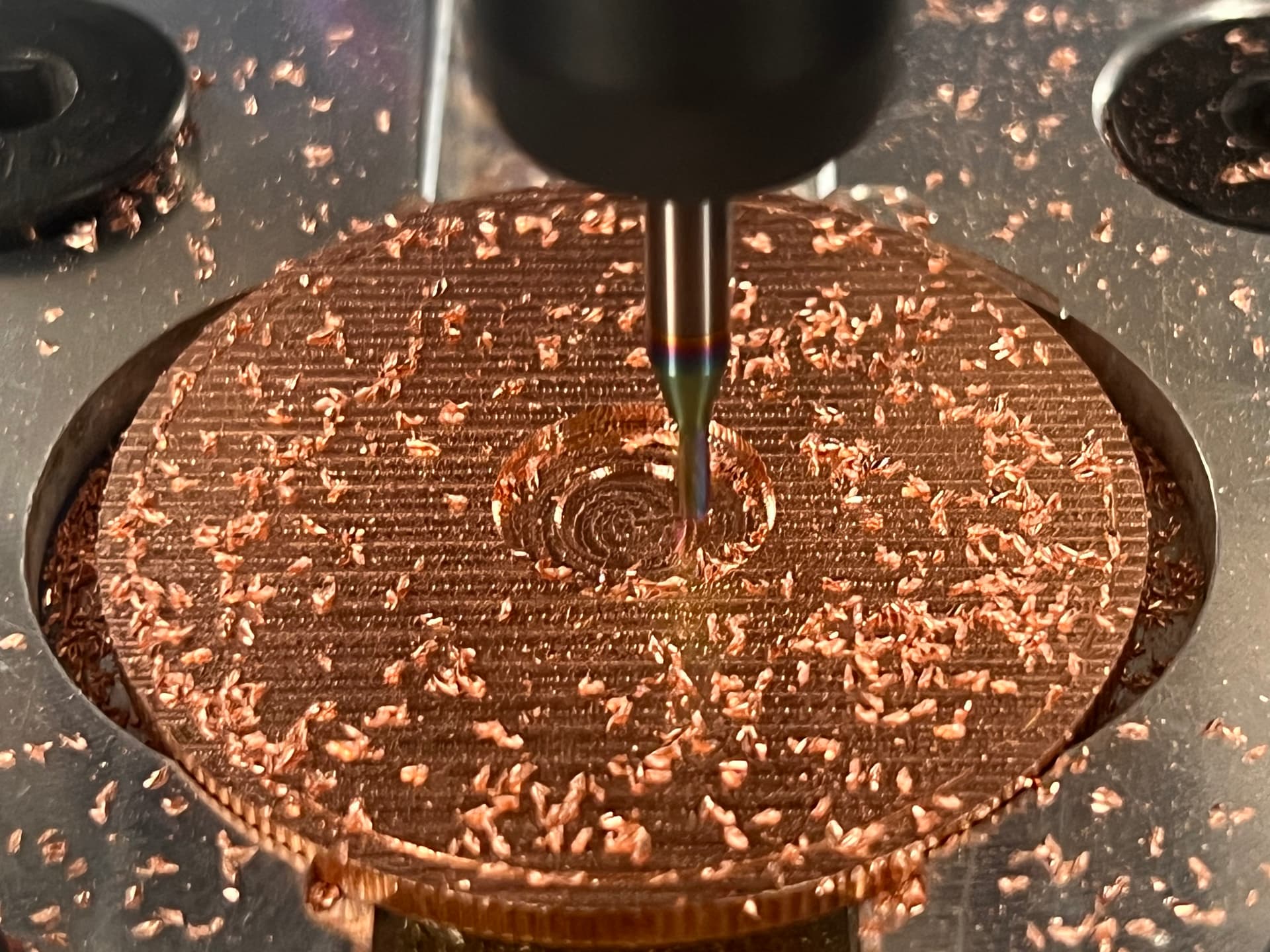

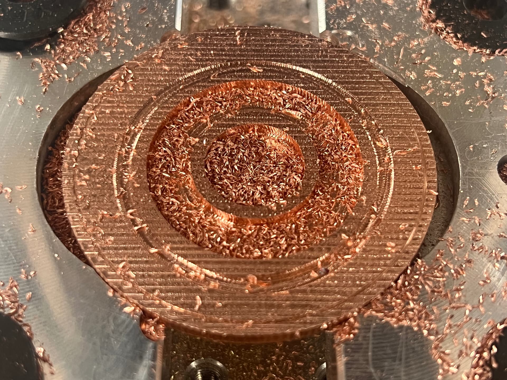

With this new found confidence, I went head first into machining a quick copper press attachment for pushing the magnets in gently and evenly. I think this is nearly pure copper which has historically been my nemesis. That said, another look at the Harvey chipload recommendations for copper provided a fantastic starting point:
Look at those chips! For a nomad this was pretty startling…clearly I’m doing something wrong :thinking:

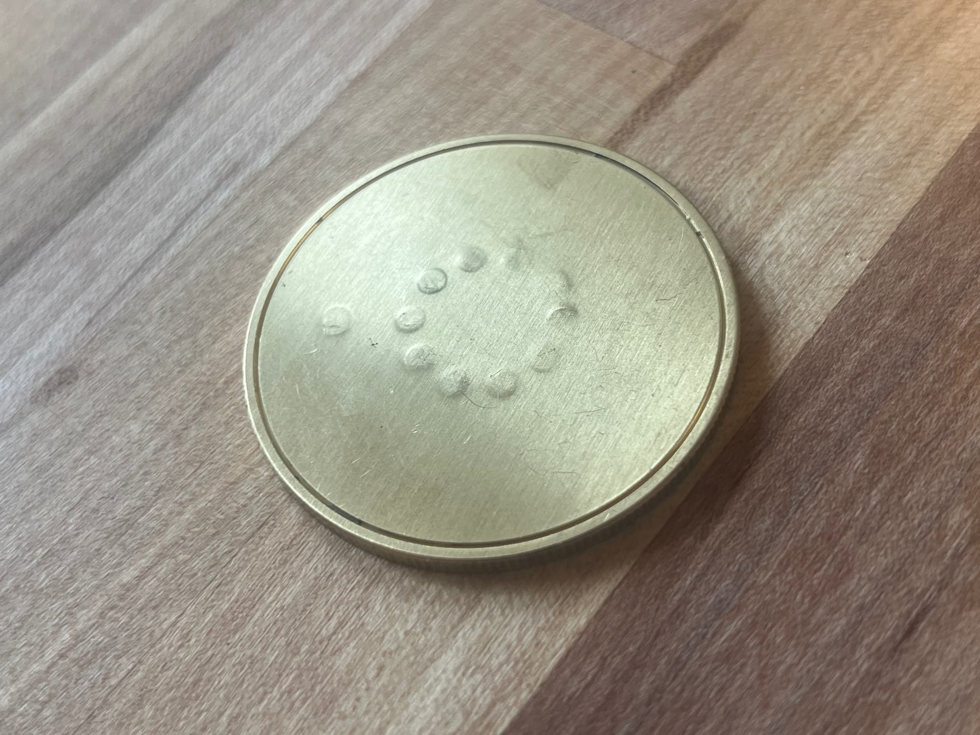

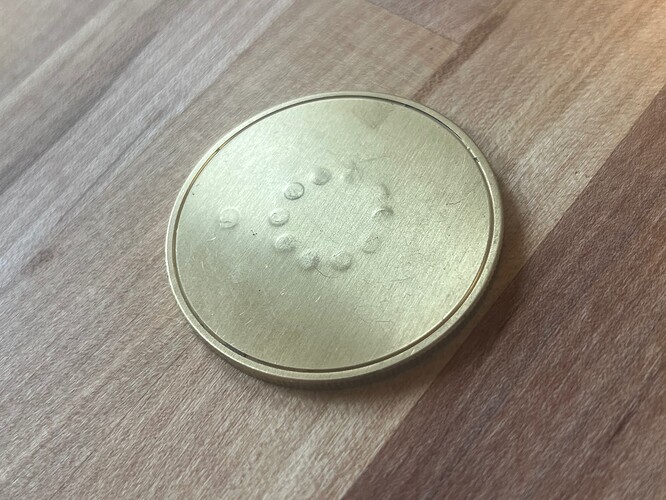

I did the press fit testing at the top of a freshly faces piece of brass. Notably, this is not where the magnets will sit in the final product. I probably should have tested the fits in the bottom of a slot to get a better idea of the press fit in the context of the product.
Care to guess why this matters before I show the issue?
Here is the backside of the full test with about half of the magnets pressed in :person_facepalming:
I have a soft requirement to use off the shelf coin blanks so I can’t just beef things up. That said, the 3mm magnets probably hold too strong anyways. We can go smaller and thinner to give more material on the bottom of the slots while also making the rings a bit easier to spin.

Oh, the copper pusher. Right…so I snapped the end mill off in it :person_shrugging:
Copper is still a pain, still my nemesis, and I still need to dial in the recipes.
That said, historically when I’ve worked with copper it has always been a little warm to the touch after working. This was cold to the touch and the sound was ok until it suddenly snapped.
I interpret that as:
  1. I’ve always erred on the side of too high an rpm, essentially trading more rubbing for a lesser chance to “grab” the end mill.
  2. These feeds and speeds are closer to “ideal” than I’ve ever run before. I was only cutting at 12,000rpm which, I imagine, puts it in a less than ideal place on the motors power curve. Going forward I’ll trend towards the higher ends of the rpms and maybe that’ll buy me some more wiggle room.

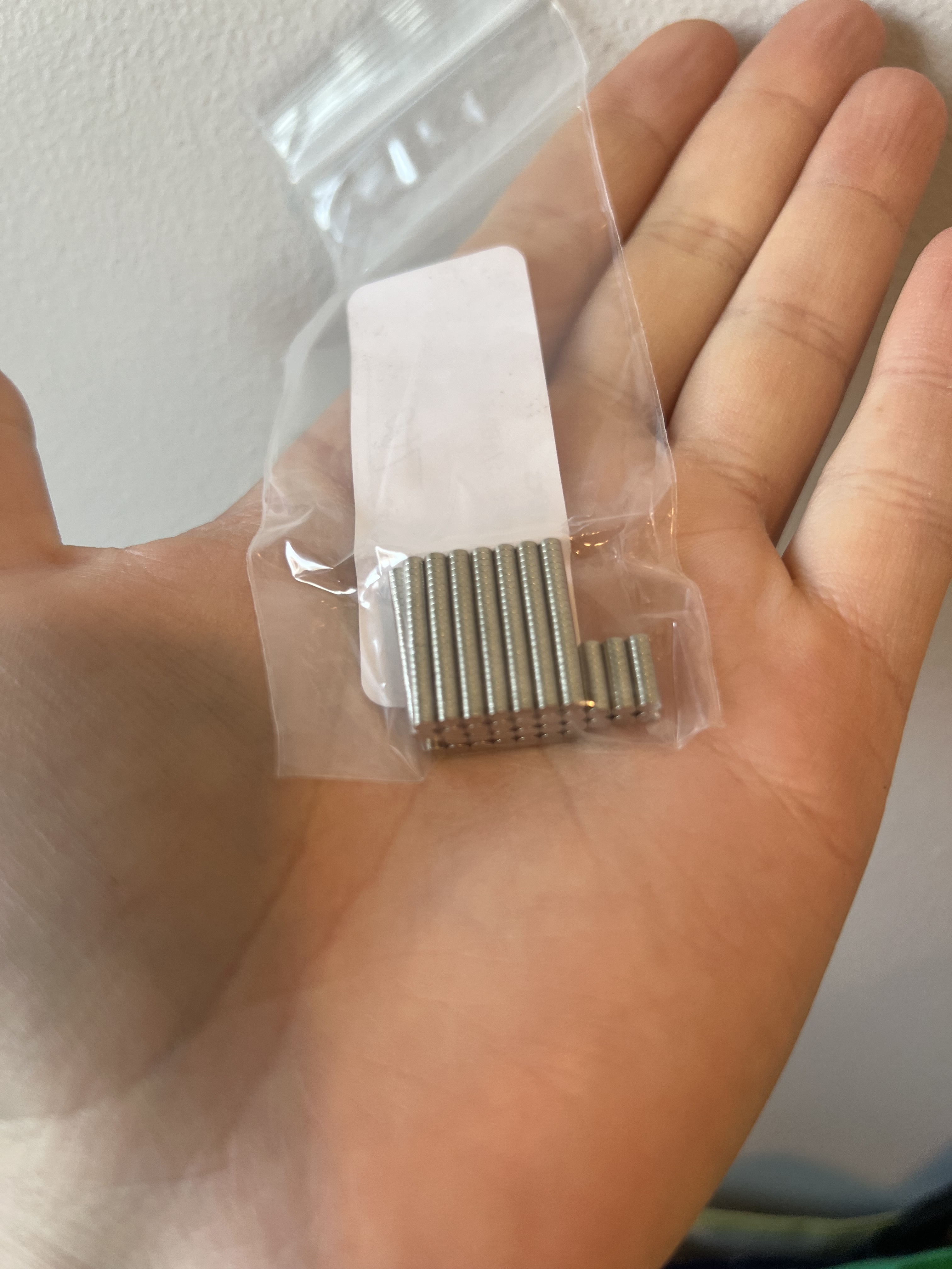

New magnets arrived. This is what 760(!) 1/10” x 1/32” magnets looks like.
These should be an absolute joy to work with…if I say that enough times, maybe it’ll be true :upside_down_face:
