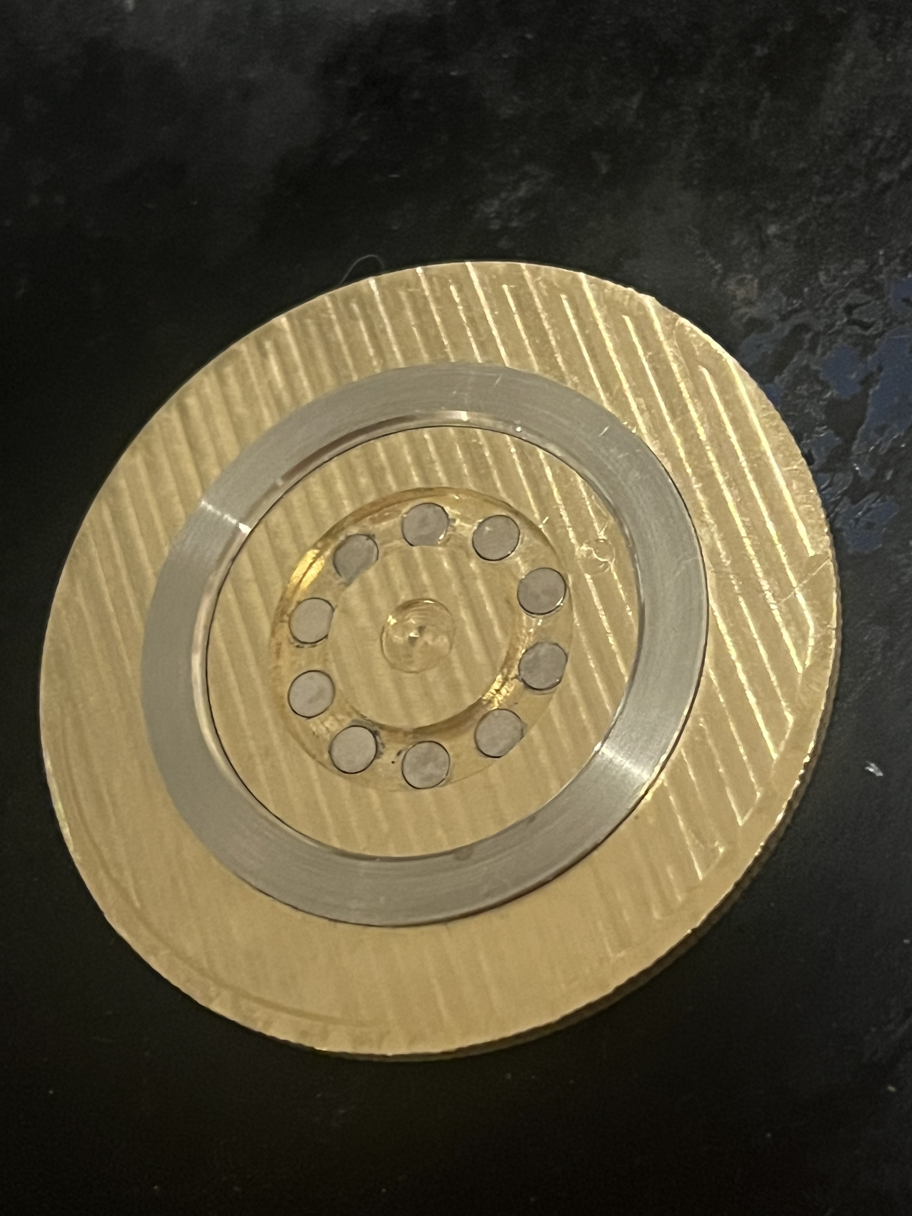

The coins are roughly 51mmX3mm. An often overlooked issue with these large coin blocks is that they are lathe cut, this leaves a slight dome that can throw off z height measurements.
So I’ll be facing these coins which I’ve never done before.

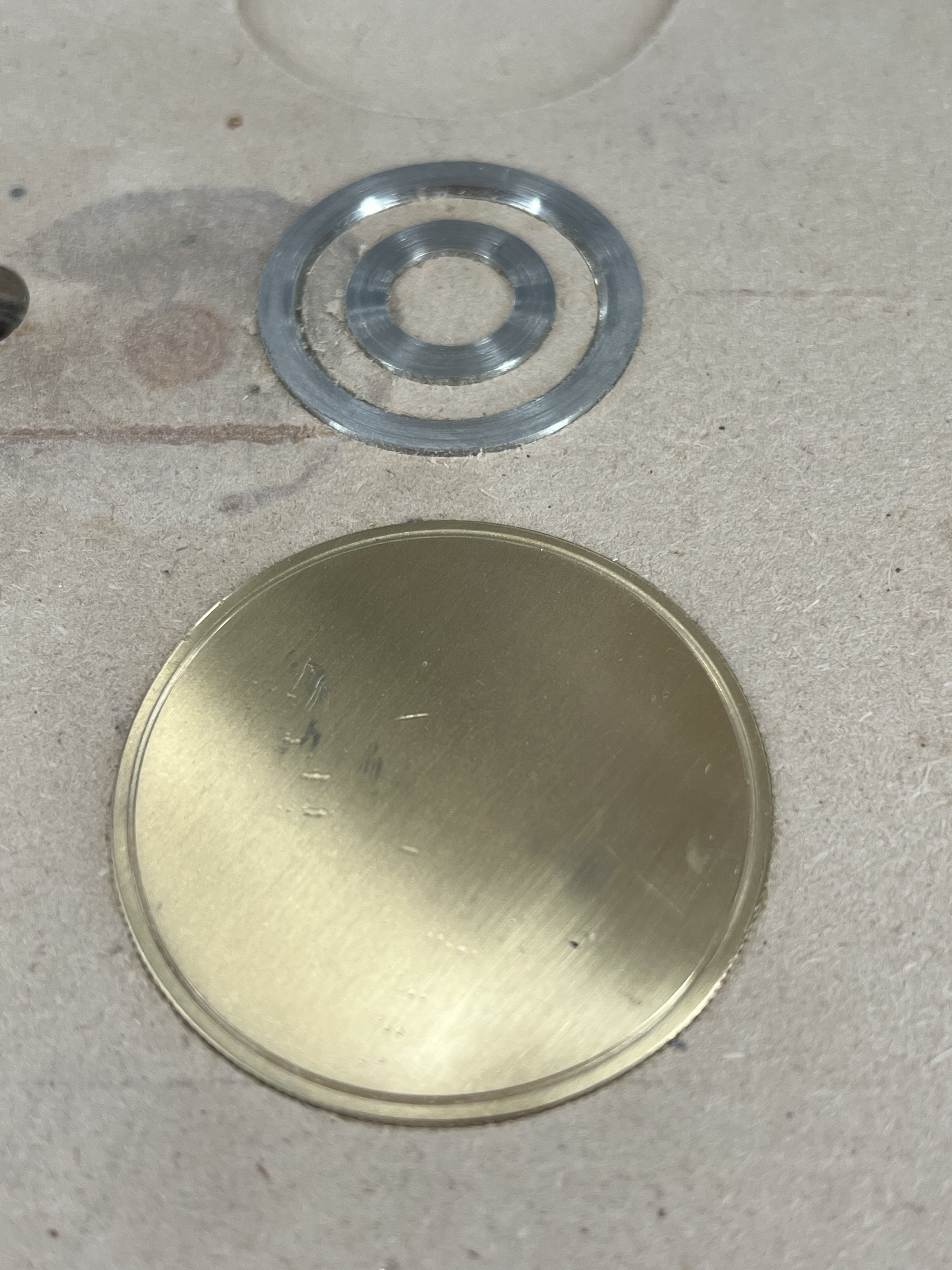

I found my previous cut rings, that will save a bit of time!
I’m genuinely surprised at just how tightly a snug fit in mdf can do. Time to do a light facing path on the coin and an a bit more material removal on the rings. (They need to go from ~3mm to about 1.75mm)

Oh well, time to take .25mm off of the faces of these boyos.
Those are just the pockets for the mdf so the tolerances are not terribly important, cutting paper after all :slightly_smiling_face:

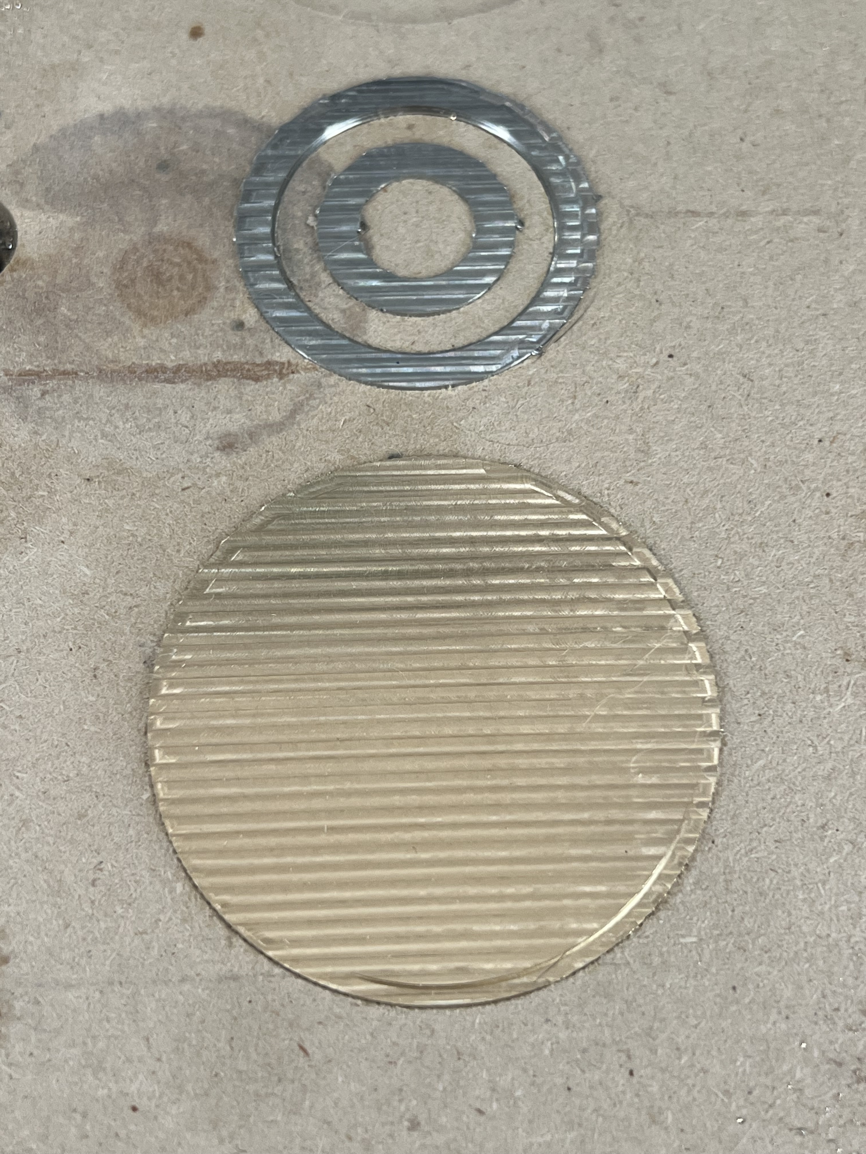

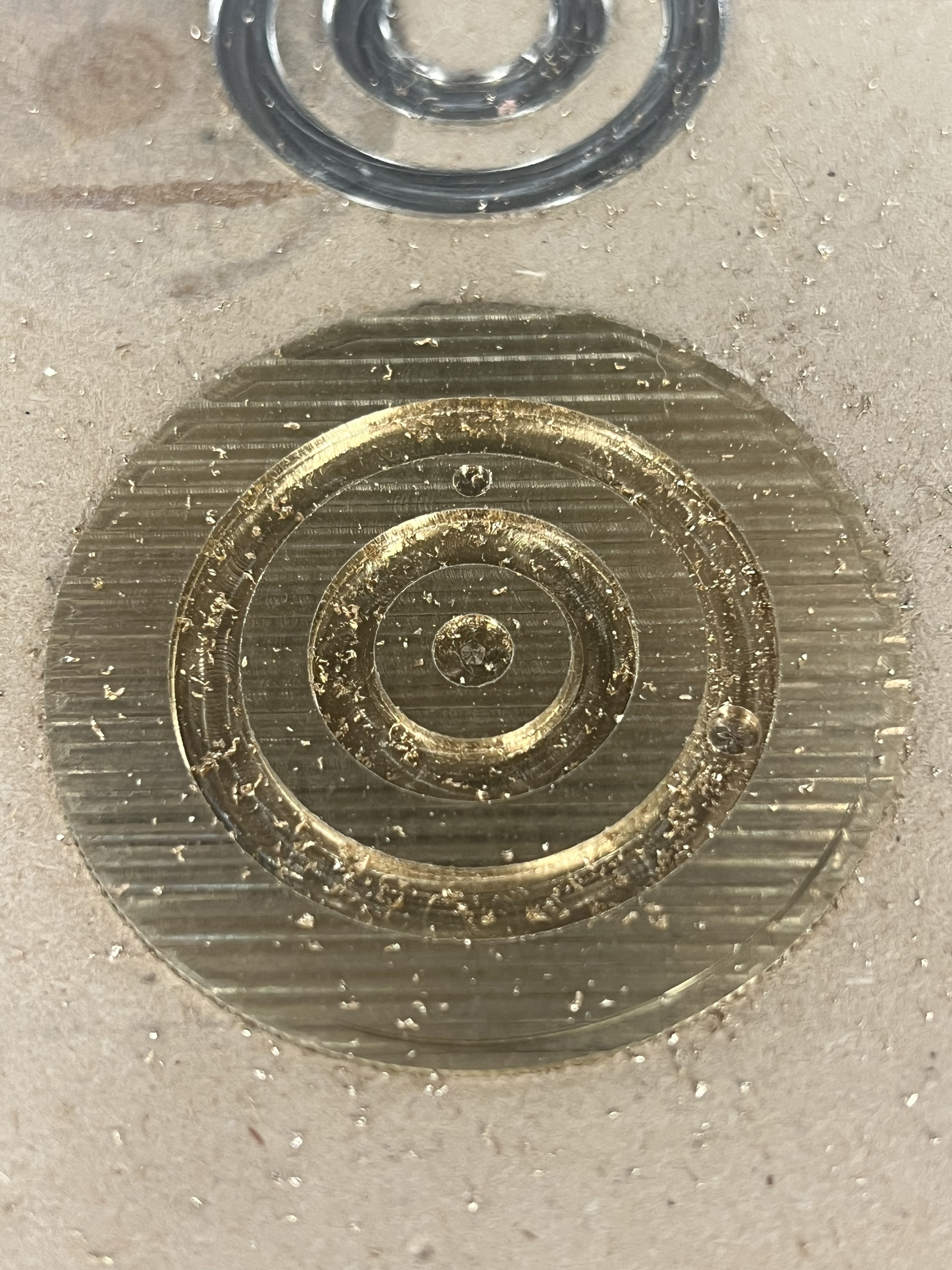

Facing went well enough. You can still see remnants of the outer groove originally cut into the blank to frame it but that’s not a problem, it’ll get cut away at the end regardless.

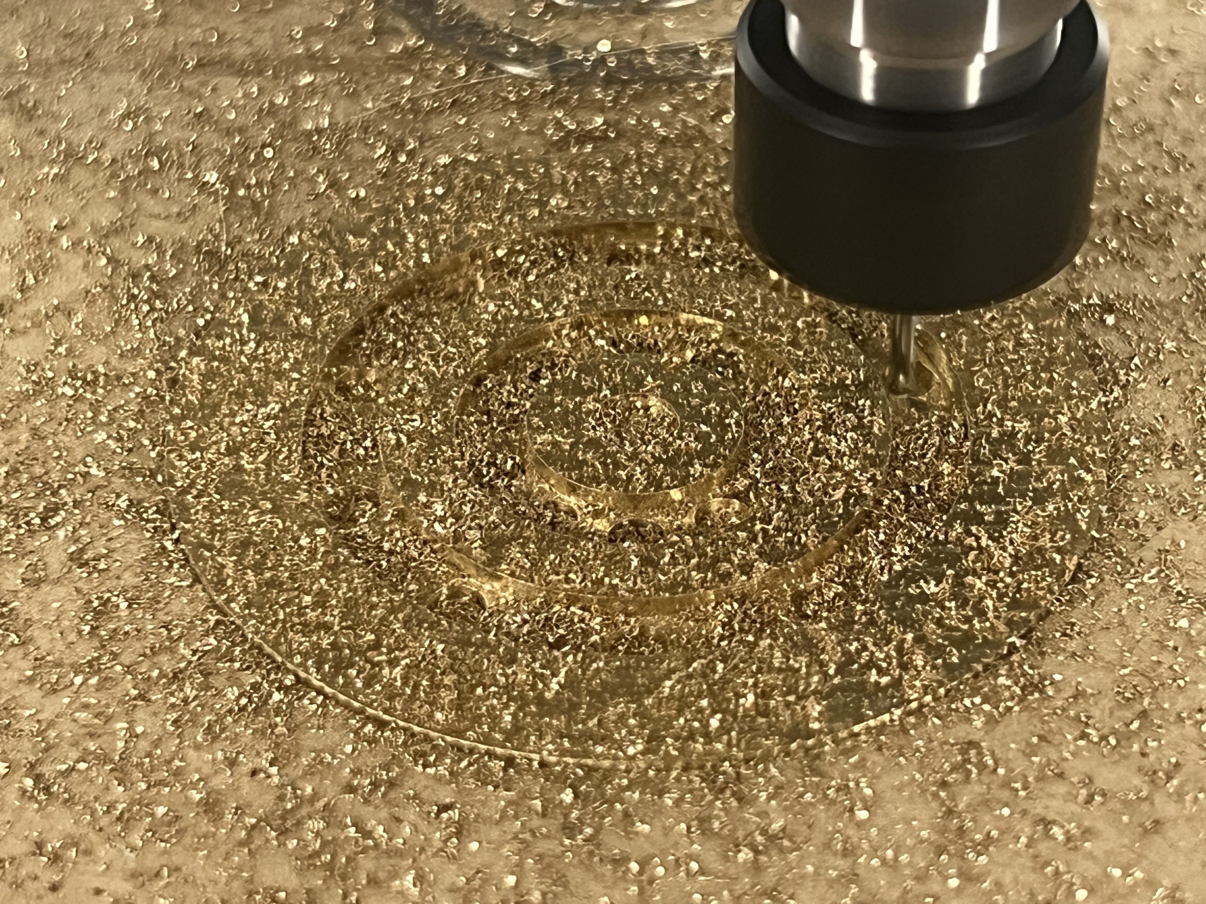

Currently removing the rings material and slotting the brass coin.
Again just going with nice and safe carbide create defaults. Breaking a tool will waste a whole bunch more time than just taking a few extra minutes (which I’m using to develop the design anyway :slightly_smiling_face: )
Sometimes being aggressive is just a false economy…but it sure isn’t as fun as pushing those limits :stuck_out_tongue_winking_eye:

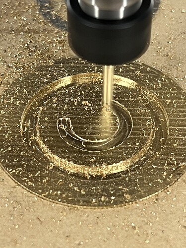

Going great so far:
Forgot to mention, using a 102z 1/8” single flute.
Now to down some quick dinner in the 6 minutes remaining on this operation :sweat_smile:
Well when you’re right, you’re right Soup…the results need a bit of cleanup. We’ll pull an audible and sneak in some contours and a spring pass.
Also didn’t take the time to back off feeds for the slightly harder nickel based silver coin…which is pretty obvious in this comparison but it’s still well within the machines limits. Little nomad is ~humming along just fine so there’s no reason to adjust at this point.
Dinner was, coincidentally, soup :slightly_smiling_face:
also worth noting these are the defaults for aluminum, not brass or nickel-ish. So I should have probably backed off by 15% to get a really clean cut on the brass and another 10% on top of that for the nickel-ish…The lesson is to save some custom presets so I don’t need to think about it next time and it’s still ~correct for the material :sweat_smile:

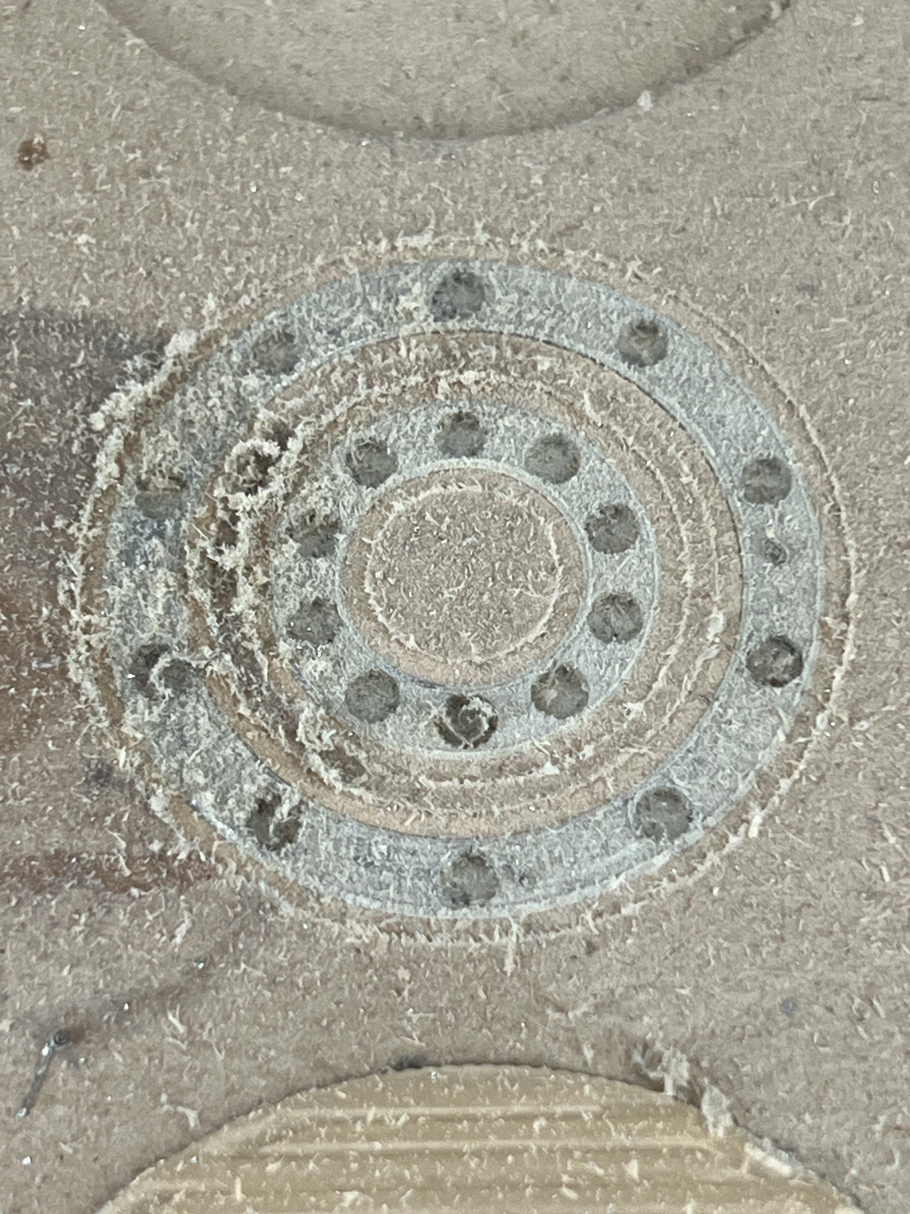

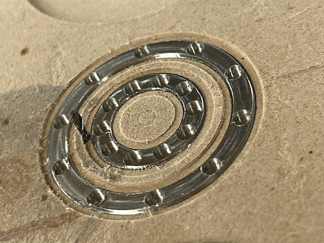

Well I forgot to update but we’re currently boring (40) 3mmX1mm blind holes. ETA is something like 25 minutes.
In switching to the 112 1/16” Endmill I took the opportunity to back off the feeds and speeds by 20% (smaller tools, less wiggle room before breaking tools)

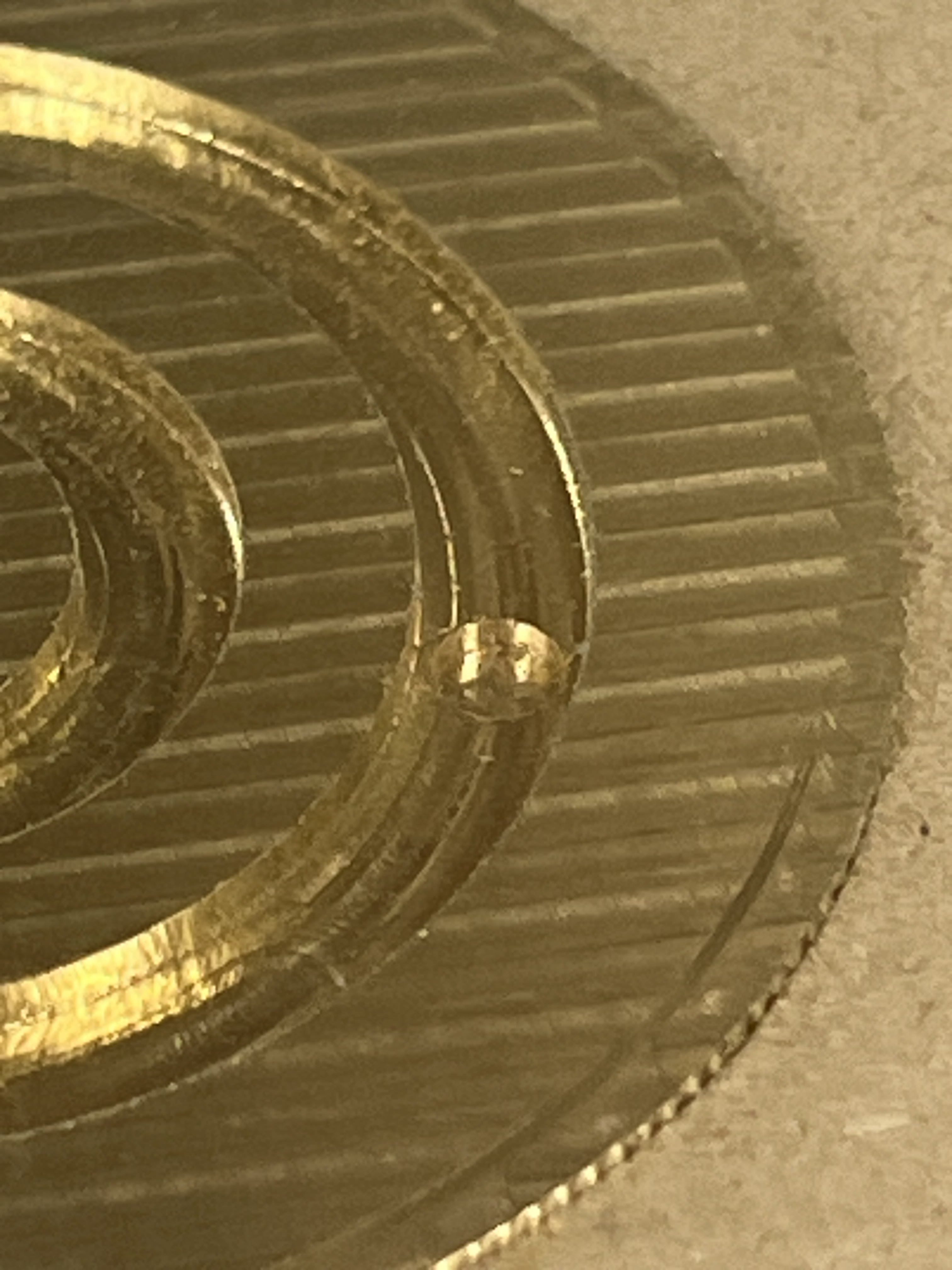

I actually stopped this cut because it was taking so long. Turns out I had set the hole start height at the stock top so it was cutting air for 3/4ths of the depth :person_facepalming:
Luckily that was only a few of the holes.
The cleanup of the earlier tool paths went really well. Unfortunately I think I went too light on the rings cleanup. The negative stock to leave I set ended up just pushing the exceptionally thin remaining wall…essentially forming the remaining material which is neat.
Here’s the first few cuts with the (not yet broken :crossed_fingers: ) .063” Endmill
And unfortunately that’s my time
Not quite there but in the final stretch…so I think I’ll cheat and reset the clock :yum:
Note to self, set the air blast back up :melting_face:
FYI those feeds and speeds are about as conservative as can be if you really want a good surface finish what you want is a new uncoated 3 flute 1/4" endmill 18000 RPM and like 80IPM doing a max .003-.005 DoC finishing cut and what you end up with is a beautiful prismatic looking finish.

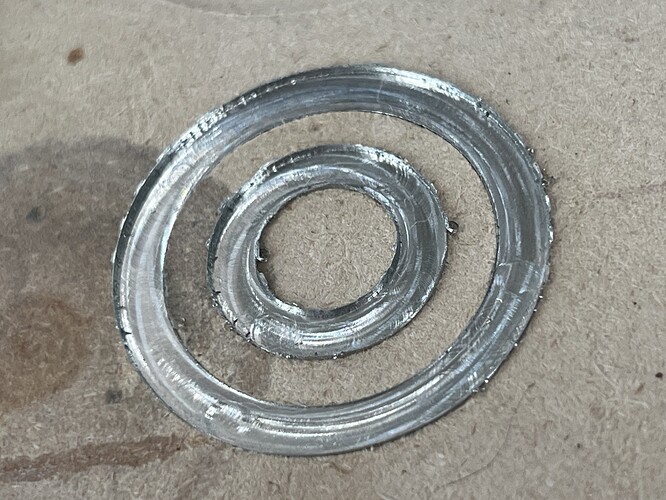

So the walls of the rings were being annoying with the cleanup…then I remembered they weren’t the actual ring dimensions, rather they were the offset ring dimensions for the press fit pocket.
Luckily this didn’t matter as everything was being removed to the same z anyway, there is no relevant geometry in chips :sweat_smile:
And a bit of cleanup
Finally I took the opportunity to offset correctly and take a breath width off the outsides and down by 0.5mm. Essentially just to relieve those corners that will mate with the brass slots.

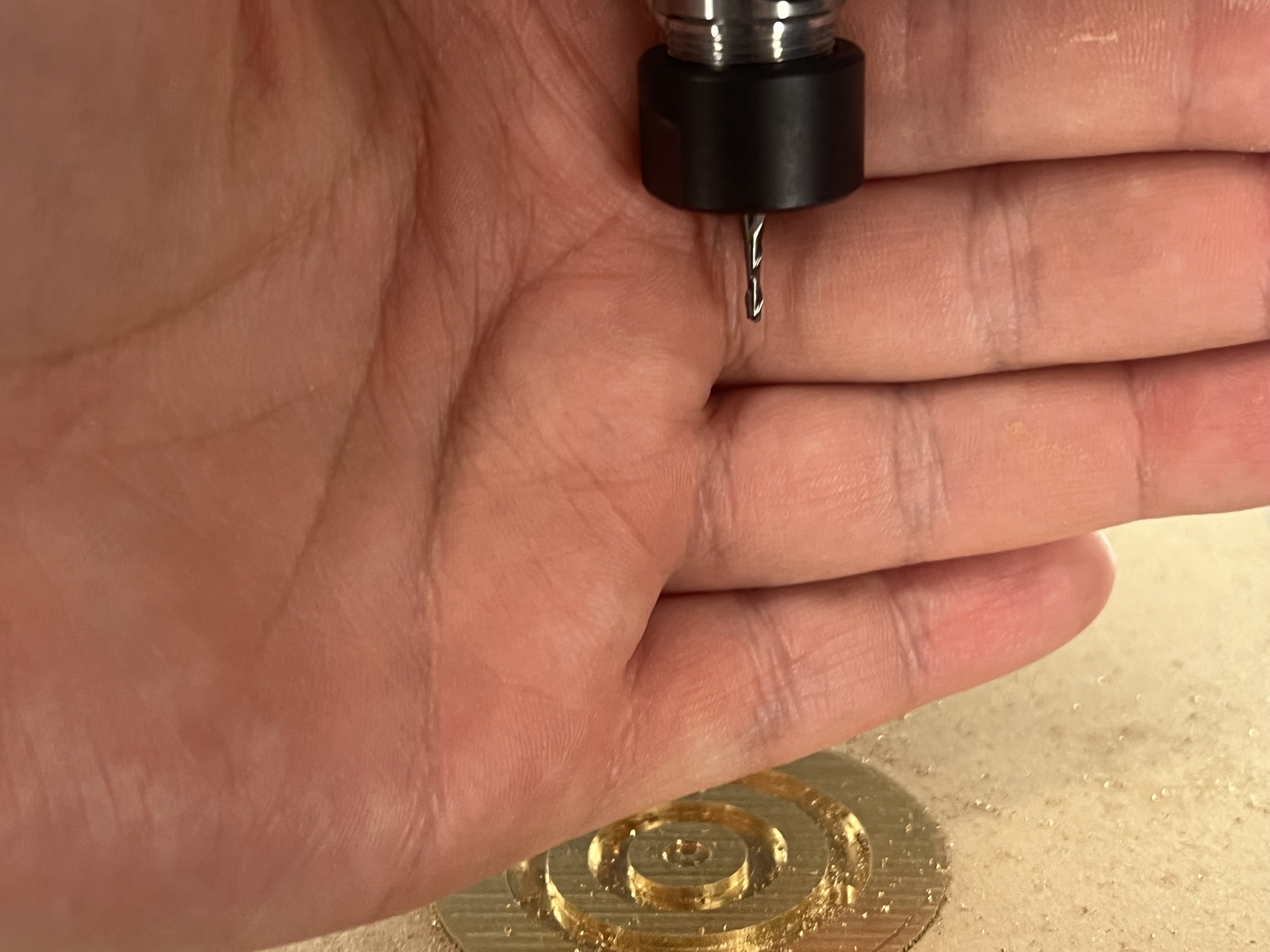

This was a great idea in theory but in practice, it was also a great idea until I made another silly mistake. Is there anything wrong with this picture :thinking:
Literally the last operation on the last toolpath…what are the odds :melting_face:
Fortunately it was a completely benign catastrophic failure, so maybe I’m lucky after all :upside_down_face:
Coulda been me and slapped the estop and watched your 1000$ spindle crash into your 2000$ fixture plate and explode a 50$ 1/8" CVD endmill. Collet, collet nut, fixture plate all looked a little funny after
Silver lining, at least it wasn’t an MCD endmill :laughing:

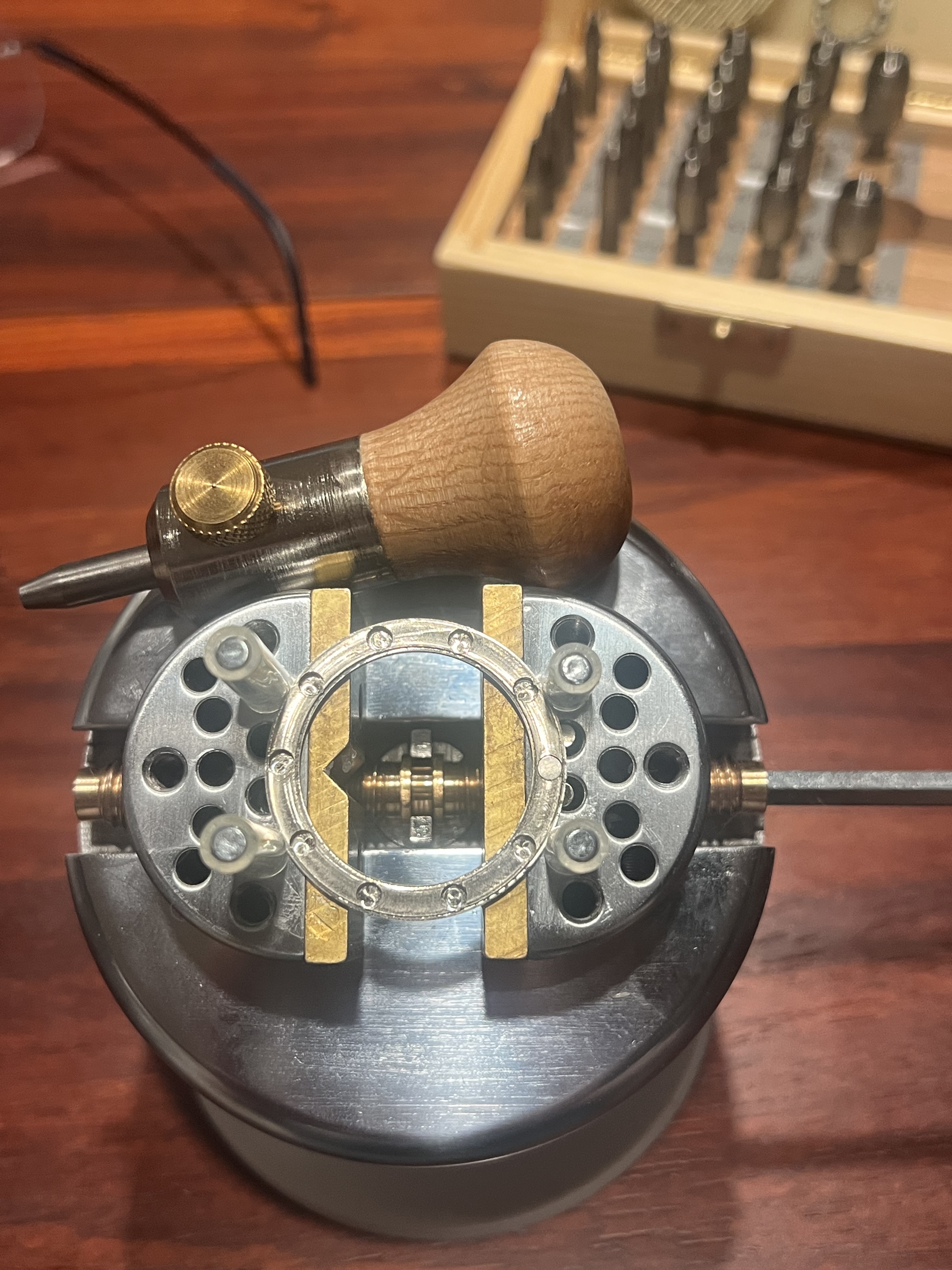

Ha I figured folks would be asleep by now but since you’re up I’ll give you some sneak peeks :grin:

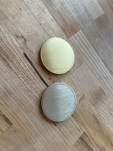

The rest of the write up and lessons learned will be done tomorrow (later today…) so they at least stand a chance of being comprehensible :sweat_smile:
I’m going for something along the lines of maybe…entry level journeymen? Definitely nowhere near master class but I’m better than I was 5 years ago :slightly_smiling_face:
