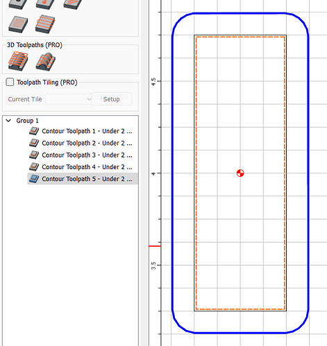

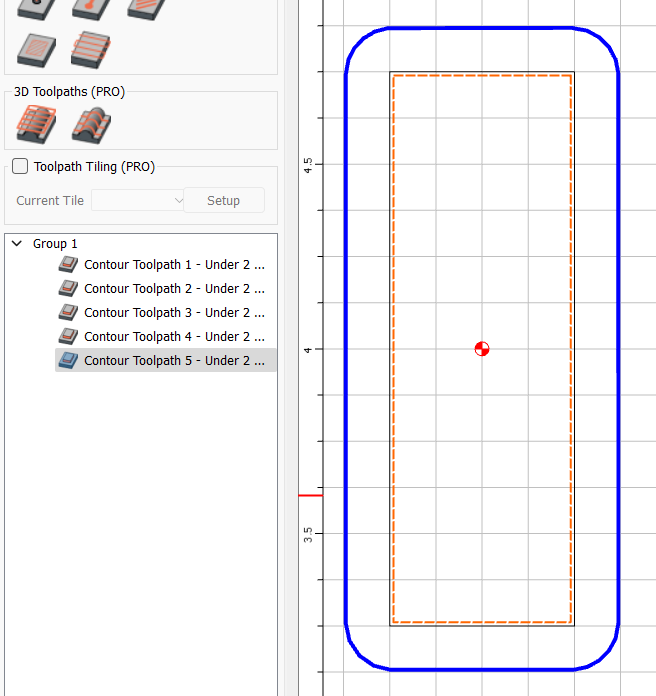

I’m constructing a 5 tier cupcake holder w/a-central support running through the rounds. I’ve found an astra coated 1/4 inch bit slowed to 100 ipm at .040 depth of cut gives a clean square mortise (1.25) I’m a bit stuck though as the through support is approx 28 inches long and the tiers are separated by six inch spacing; that’s a lot of manipulation and the possibility of breaking something is real. So while I’m trying g to sneak up on a difference between mortise and tenon widths that will allow for a snug but workable fit I thought I’d throw it out there.

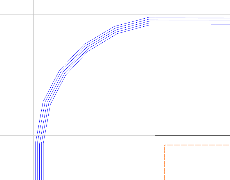

But to sneak up on a dimension, make a series of cuts with different “Stock to Leave” values with a pause to measure or fit, and stop the program when it fits.
I generally find that a slip fit glue joint in most wood is about 0.010". So I would offset the vector for the tenon 0.010" on each side, 0.020" overall dimension. But then create a series of paths that leaves 0.008" to 0.000" stock. Run each path, pause & measure, or fit the other side to it, then continue until you get the fit you want.

I thanks Tod, I get what you’re explaining and it’s helpful for sure. I’ve created confusion though with the terms, I’m not necessarily making a mortise and tenon joint on the machine. Looking to make the through “mortises on the rounds to acclimate the 1.25 inch center support
