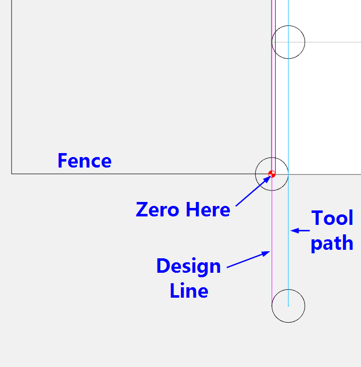

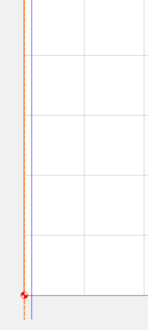

Good morning, or afternoon depending on where you are. I tried what you recommended and it did not work out, I’ll tell you what I did and maybe you can figure out where I went wrong. I drew a straight line on the very edge with my origin in cc. I assigned a 1/4” end mill contour path on the inside. When I ran the machine it was cutting at different paths when coming forward and backward, they were about a 16th difference, any ideas? I think I am overthinking this, but in cc my “material” is to the left of my origin whereas in the real world my fence is to the right of the origin, so when I zeroed I was maybe 1/64th from the right edge of the fence, is that the correct place to zero? Thanks for your help, this is all very new to me and hurts the brain sometimes!
OK, so when you program it, you want a line going up the left edge right on the zero point.
set your depth to the height of your fence, and the depth per pass on the tool to something larger than that depth. (I just set it to 1.0). You’re going to take a really thin cut only on one edge of the fence, so a full depth cut should be OK. It should make one cut. That’s it. No going up & back. You may need to switch inside/left to outside/right. It’s an open vector, so it doesn’t know which side is left or right, and there is no inside/outside. I usually make my line a little bit longer so it starts off the material.
Then when you attach your fence, set the zero about 1/64" from the right edge of the fence. Line up the center of the tool, not the edge of the tool. So the tool will actually move to X0.125, and then straight up Y.
that worked, I really appreciate it!
