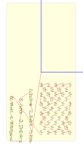

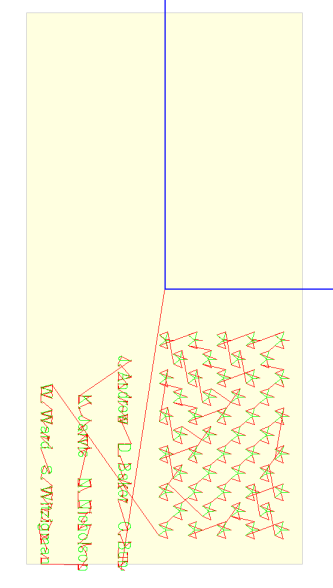

I have a question about my tiling setup. In CC it appears and the simulation shows it how I want it to cut. But in CM the preview always shows the cut portion at the bottom, which offsets everything. What do I have wrong? TIA
If your XY zero for the first operation is in the center, the zero point for the second operation is center/top. (it moves the same distance as the tile height)
