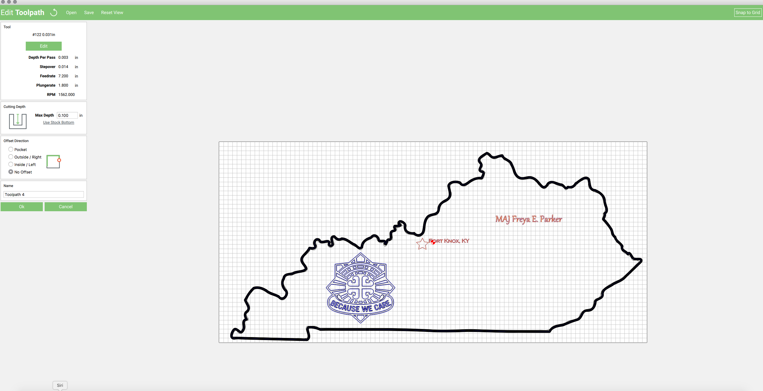

I have a newbie question about cutting times, I have this image that I’m cutting with the .0325 bit. Cutting depth of .01 and it been running for 13 hours and still not complete. Is this normal cutting time or am I doing something wrong?
Yes it is normal when a newbie makes the mistake to use a 1/32 end mill and you are doing something wrong.
What are your feed rate and rpms?
You are simply experiencing a growing pain-and handling it exactly the right way!
What are you cutting and at what rate?
I didn’t change it, it’s automatic from Create. I’m cutting popular
You should be able to profile that piece, v-carve the words and inlay the crest with yellowheart, bloodwood and ebony in an 1 1/2" tops. Please post your design and machining parameters from Carbide create and we can help better.
Please let me know how to speed this up because I have a 2nd one to do and I cant let take another 13+ hours to do.
Use an 1/8" bit at a depth of cut of .1 and a feed rate of 45 inch/min. Even that is conservative but will be a great rate for you.

The defaults are often extremely conservative but I get why that’s the case. The ideal speeds differ for every endmill and every material, so a single chart could never cover every situation especially when people start buying cheap bits from who knows where.
But yeah larger bits can cut deeper and faster, if you only have the 1/32 bit you could try slightly increasing the depth per pass (so there’s fewer passes) and the speed (so each pass takes less time).
Yea I’m working through it trying different speeds and depth per pass to get it right. I got it down to like 30 minutes but trying to perfect it.
