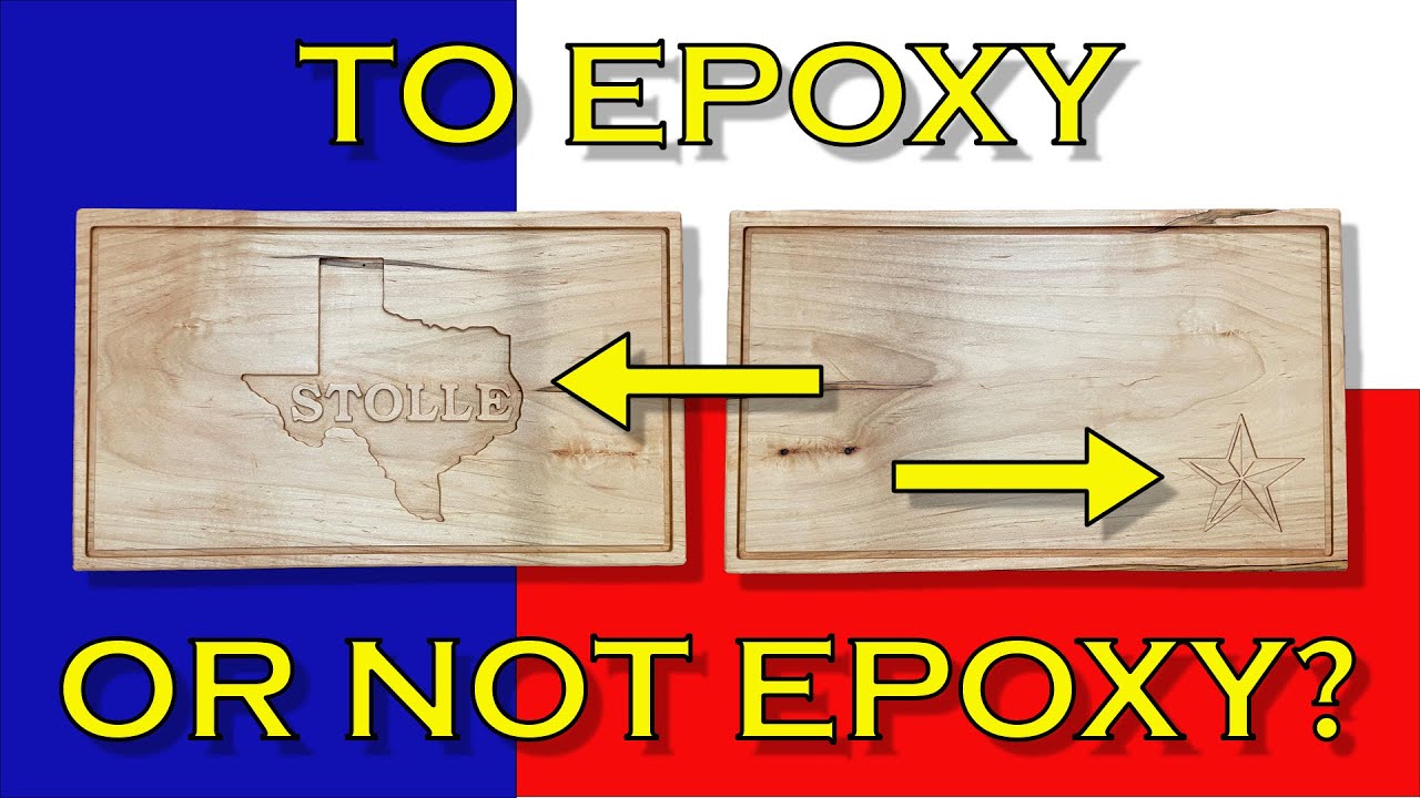

I recently made this cutting board for my brother. I’ve never made a cutting board before, and it’s nothing too fancy, but I think it turned out pretty well. One side is more decorative, and the other side is for cutting. I finished it with cutting board oil and conditioner, which worked out well. My question is: should I have filled it with epoxy? If so, what precautions should be taken (if any) on the cutting side? Thoughts?

First, nicely done!
Re epoxy, my feeling is if I can’t eat it the finishing product is not going on any culinary piece I make.
My $.02.
There are pluses and minus for epoxy on a cutting board.
Plus: You can use color to make your board pop. Epoxy is food safe when cured.
Minus: The epoxy is cut easily and is scared for the life of the board.
Obviously I did not go deeply on the plus and minus of epoxy of a cutting board. Frankly I would not use epoxy on the cutting board side. The purpose of a cutting board is to cut. So the very act it was designed for slowly destroys the cutting board. There are 3 types of cutting boards:

Your board looks like a face grain type so it is most likely to get marked up by the knife. If you use epoxy it will also get marked up.
Likely you already know but be sure to inform the receiver to never put a wooden cutting board in the dishwasher. The dishwasher hot water and drying cycle will destroy a wooden cutting board. Also supply the oil you used on the board so they can renew the finish. If you dont give them the oil with the cutting board it will never get reapplied and your cutting board will end up ugly and hidden in a bottom cabinet. There are several methods to clean a cutting board. You can use a diluted vinegar solution, you can use diluted bleach but that tends to bleach the surface, you can use hydrogen peroxide diluted as well. It is important that the wooden cutting board is sanitized after every use.

Maybe you would want to consider cutting a wood insert for the TX state and “STOLLE” text. Not sure how well or easily the current raised letters would fit through as you position the insert, so you might need to mill those off and create new ones to insert into your insert.
Probably overcomplicates and adds more time than you were planning, but to add some ‘pop’ and have a level surface without epoxy that’s one way.

The big Texas shape is likely not the cutting side. Epoxy would look cool.
The star side would look GREAT if you did an inlay.
Have to agree with the other replies here so far. I’ve done a lot of epoxy and it would be a weak point in such a nicely executed piece.

But if you want to make your cutting board more decorative, carve a design along the edge, outside of the normal cutting area. For Texas, maybe a line of stars to help frame the main cutting area. It would add some color while not affect the usefulness. Besides, every piece you make is just the last piece you made. There is always the next one.
Two simple responses: 1. The customer (my brother) asked for it. 2. Why not? :slight_smile:
This info would’ve probably been helpful when I originally posted my question: Texas was big and centered because my brother wanted one side of the board to be used solely for decoration (it will be side up when not in use) and one side that would actually be used (the star side that has much more usable area).

I do a lot of acrylic “serving/charcuterie” boards, they are not cutting boards and I warn my customers about that. I am sure we all have a plastic cutting board of some sort, they get to looking horrible after awhile. I would not use acrylic on a “cutting” board even though it is completely food safe. As mentioned, it would look great on the back side and then an inlay on the front to fill in the void, unless that is the “juice tray”!
