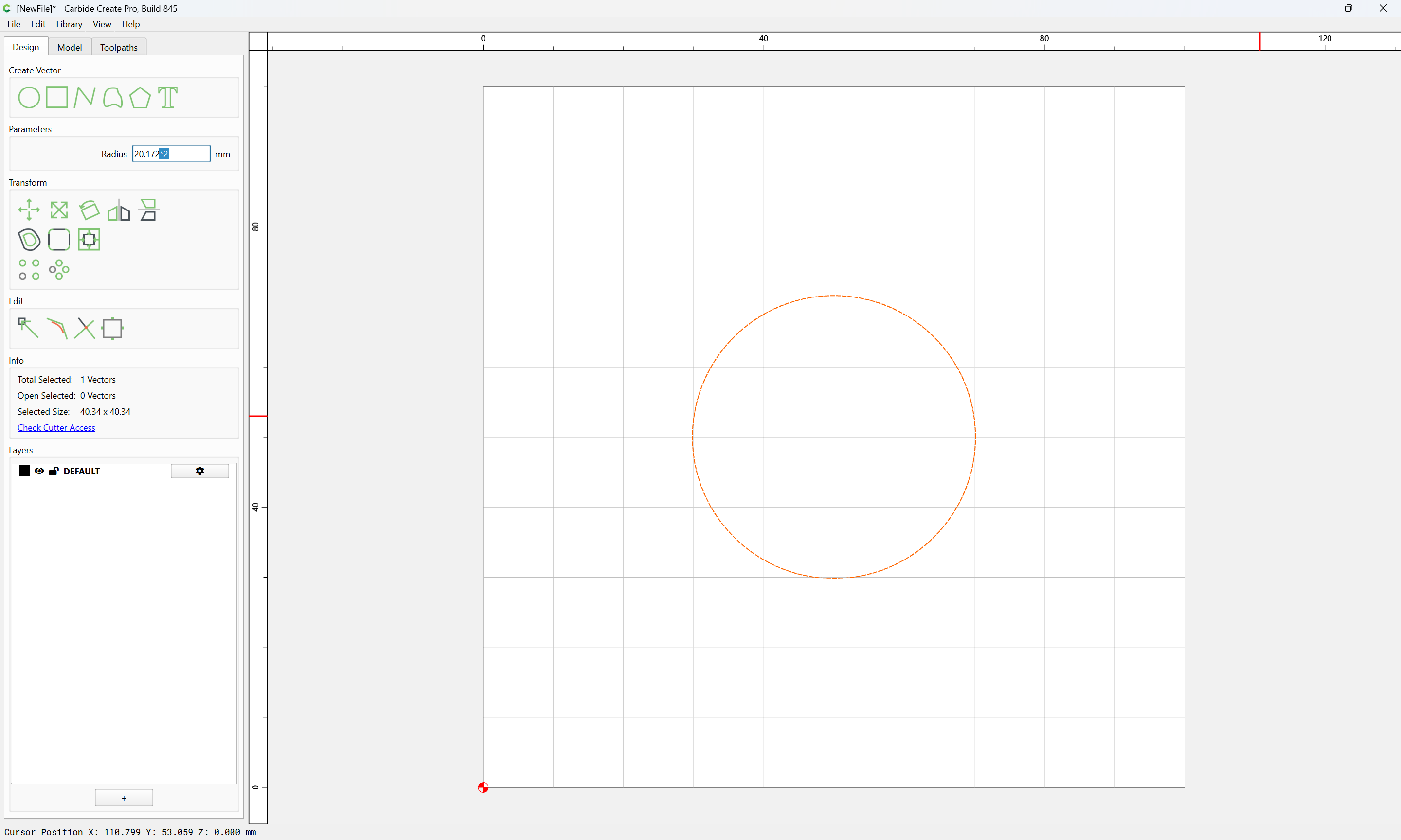

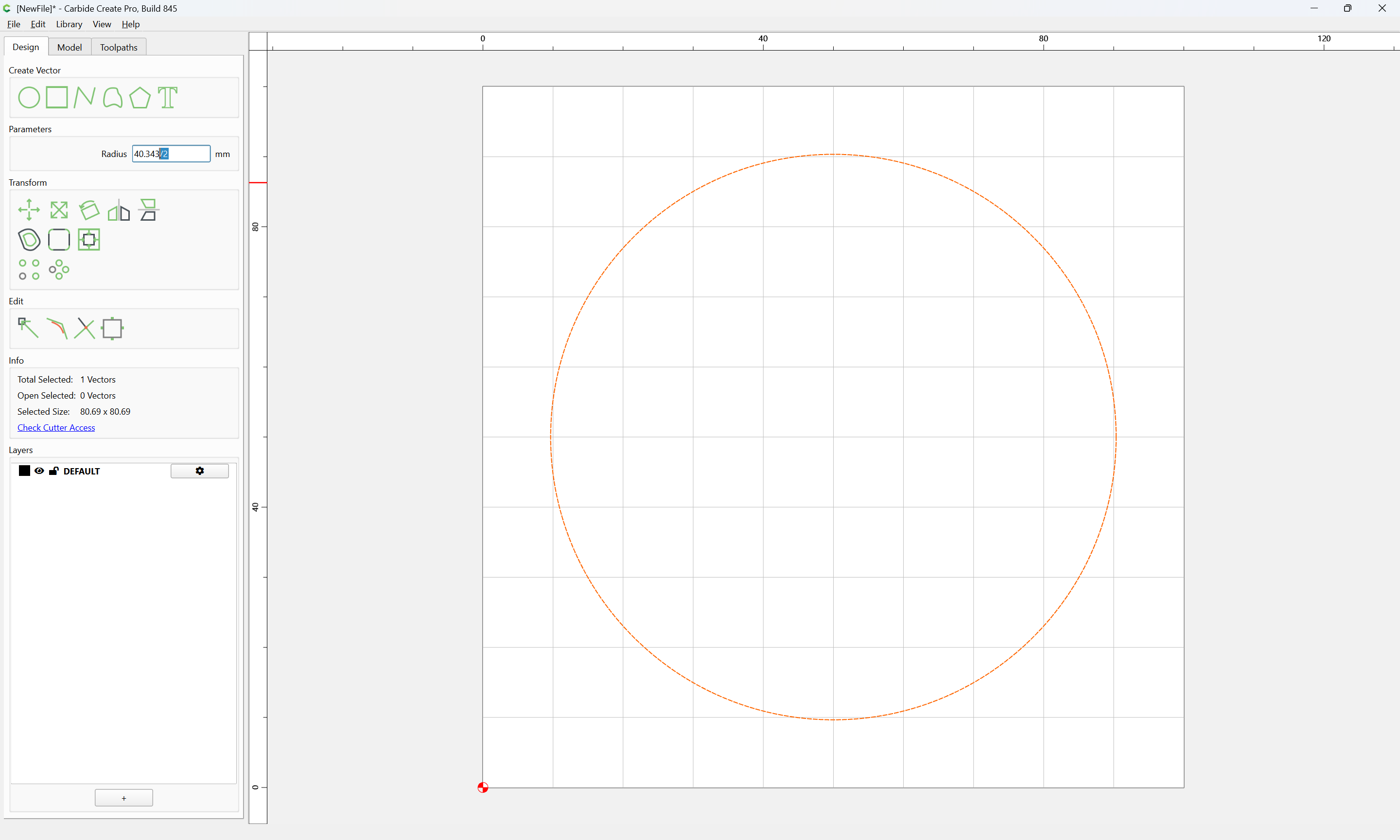

Rather than add a specific control for this, why not let the software do the math for you?
40.344 / 2
20.172 * 2

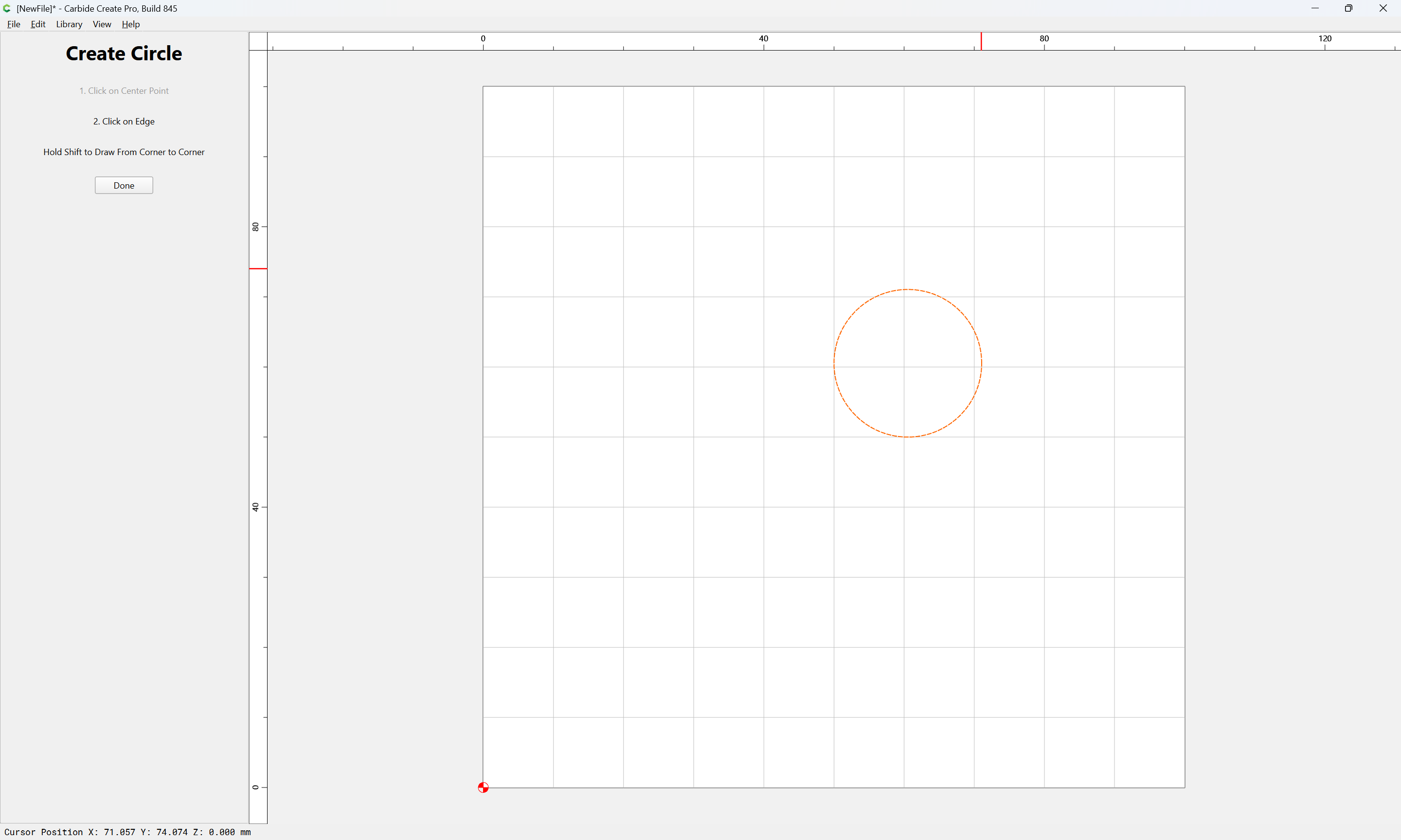

Note that when drawing:
shift will allow drawing using the diameter (after a fashion, it’s the hypotenuse of a right triangle which when doubled makes the square which the circle would be inscribed in)
Ok that’s cool. Didn’t know you could do math inside that text box. Thanks!
