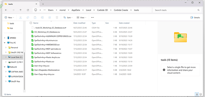

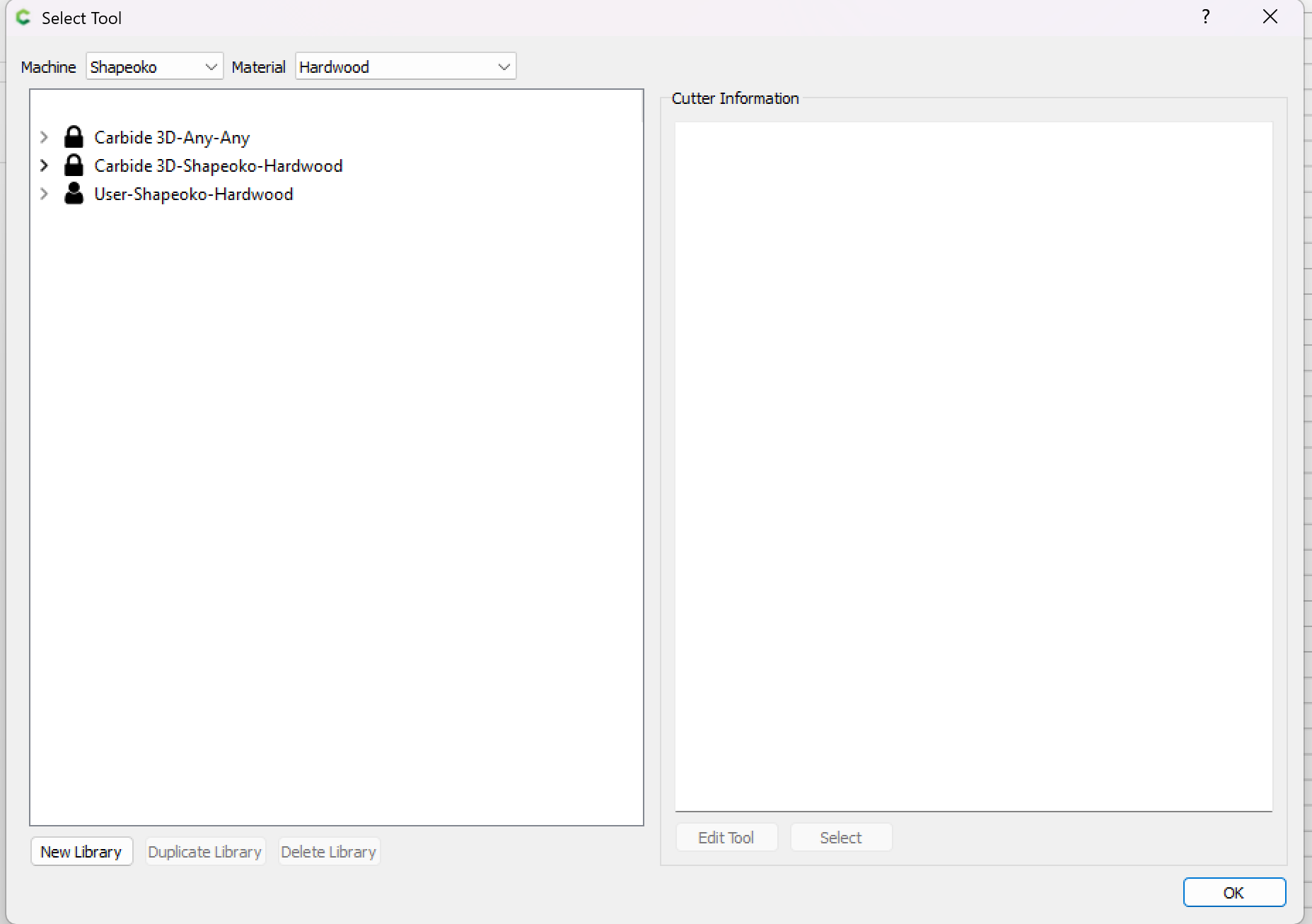

I copied some tool data files into the folder where the tool files should be located. But in CC tool database these tools do not show up.
What do I do wrong?

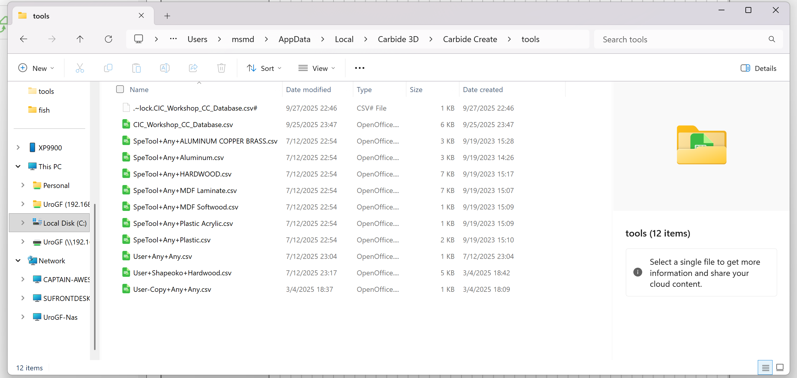

Please post us a screen shot of the folder you did use, so we can see both the directory name and the names of the files.
Note that the files need to be .csv format — if your operating system is configured to hide file extensions, toggle that to show them so as to avoid such issues.
Was CC open when you copied the files into the location? If it was close it and restart CC
yep! That’s it. TY. Again.
