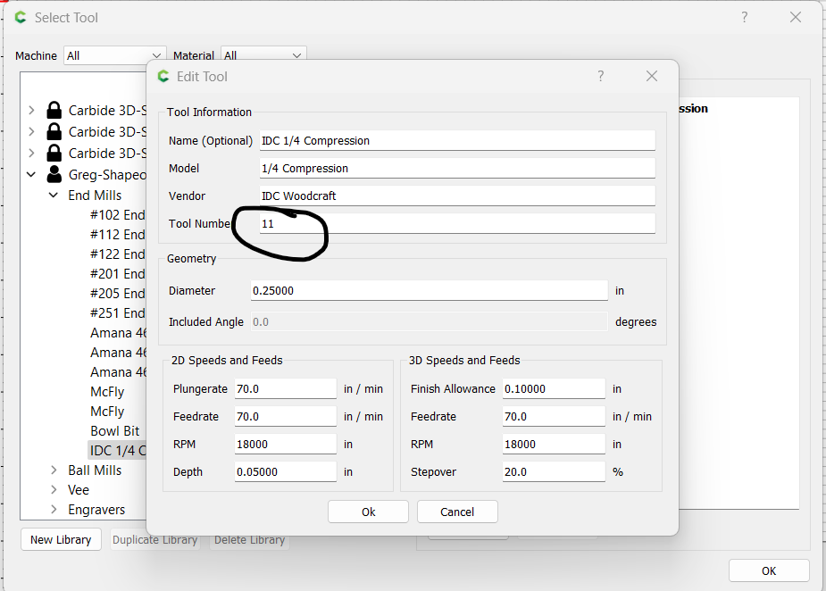

Is there a way to include text with the tool number so it shows up when changing the bits like it does for the pre-programmed bits? Currently it only shows the tool number for newly added bits. But with the bits that come with Carbide Motion it shows the tool number and some text describing the bit.
Please post a screen grab showing how you have defined your tool.
The only thing that shows up through Motion when I have to change a bit is “11” so unless I try and remember all the bit numbers I have to keep a list of tool number by the CNC so I am changing to the correct bit.

And the tool number field only accepts numeric characters which me and for some bits you just have to make something up and try to remember the association. I haven’t found a good solution for the cadence mfg bits other than to use the last digit. Either allow alphanumeric in that filed or sho the number and the name please.

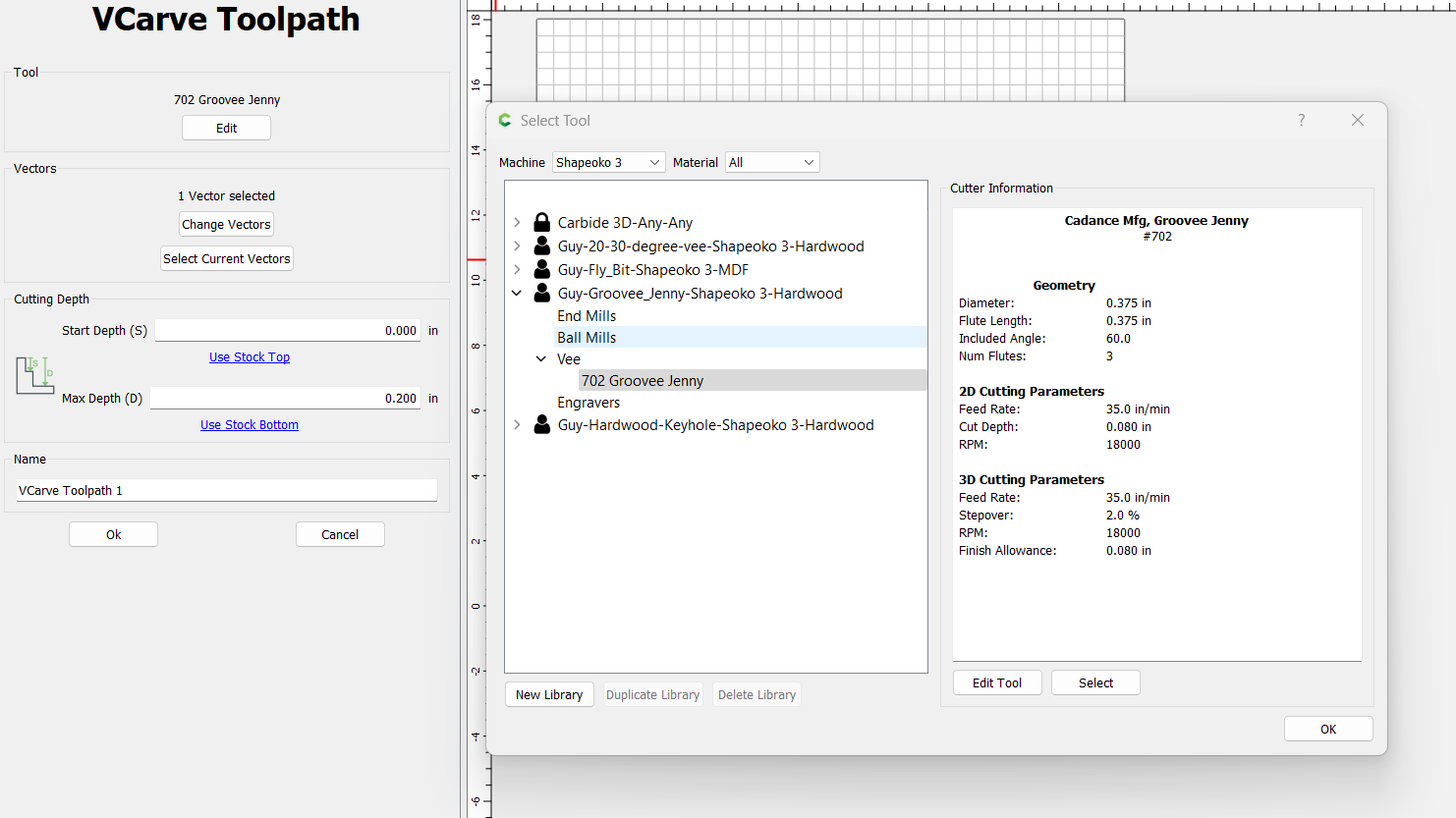

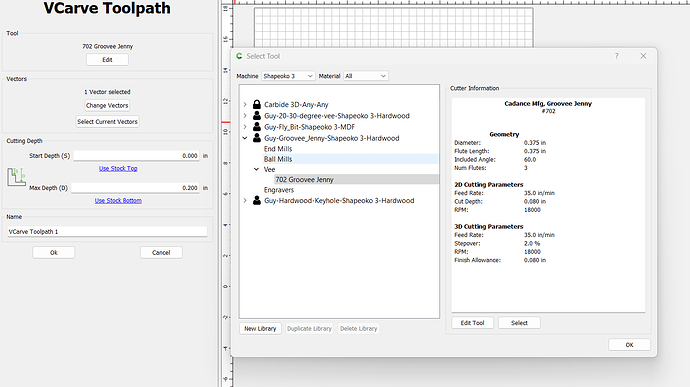

Not sure if this helps but when you edit the tool my custom tools show this for the 60 Down Cut Groovee Jenny.
The reason is because after creating the custom tool I went to the “Help” menu in CC and chose open data directory, then navigate to Carbide Create and then tools. Then choose your custom tool and open it in a spreadsheet. Then modify what you want. When done in the spreadsheet save as a .csv file. Do not allow the spreadsheet to save in its native format because CC cannot read that.
Here is my Groovee Jenny custom tool database.
number vendor model URL name type diameter cornerradius flutelength shaftdiameter angle numflutes stickout coating metric notes machine material plungerate feedrate rpm depth cutpower finishallowance 3dstepover 3dfeedrate 3drpm
702 Cadance Mfg Groovee Jenny 702 Groovee Jenny vee 0.375 0 0.375 0 60 3 1.5 0 20 35 18000 0.08 0.08 2 35 18000
