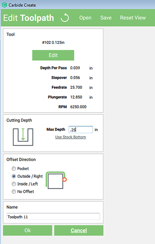

A screenshot of your Tool path settings would be helpful, I suspect you may have .000" as a DOC somewhere?
I tried it again last night. It ran the tool path I re-created and then moved to the next tool path and ran it over and over and over. The SO3 was not frozen, I was able to pause and then quit the project.
The source file started as a DXF I created in DeltaCAD, then imported into CC to create the tool paths. If you’d like the source .DXF or CC .c2d used to create the e g-code just let me know.

Depth per pass is set to .062 and depth of cut is set to .131 so it should only take 3 passes to complete each tool path. Why is it trying to cut so deep?
