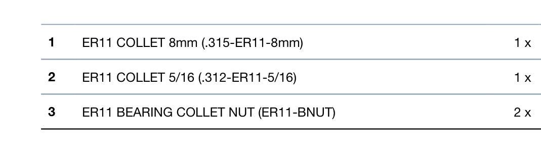

Saki, I believe you have the 65mm spindle with the ER-11 collet (as I do). The largest diameter bit that will fit a ER-11 collet in our spindle is a 5/16th” or 8mm. Even though these will fit they just barely insert past the top of the collet itself required for adequate retention for machining. To use these size bits I purchased separate collet/collet nuts from Maritool, this allows me to use all of the different shank diameters without having to swap out the collet in the collet nut on each tool change.

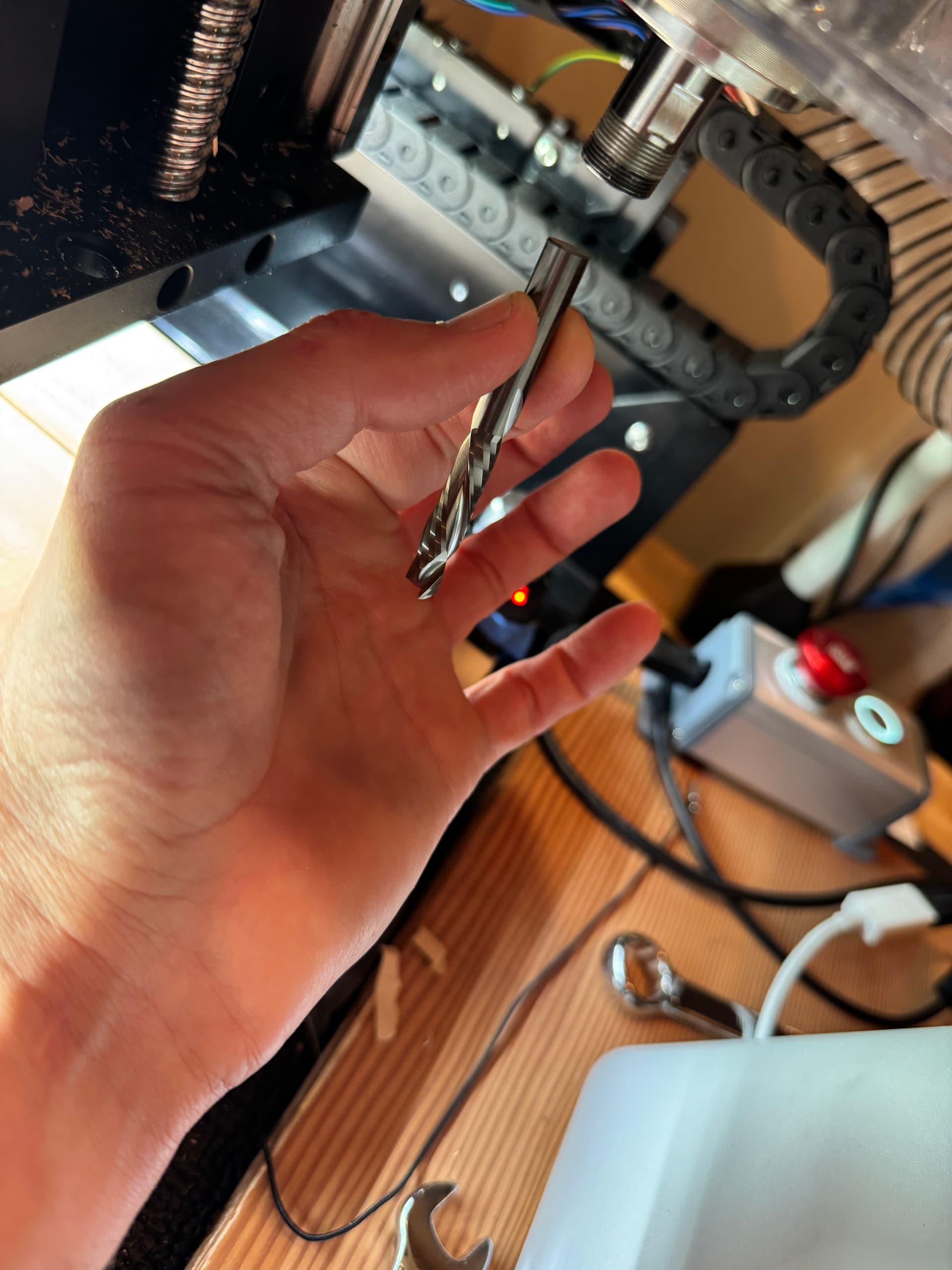

So…I returned the 3/8" diameter bit that was originally mentioned above for rough pocketing (I understand now that the 65mm SpindleI bought six months ago has a smaller shaft) and after reading the follow up posts, I bought the smaller 5/16" collect and nut that was suggested.
I was not going to get this wrong again, so I bought the exact models from Maritool that were linked above, and unfortunately, those also do not seem to fit in the 65mm spindle either.

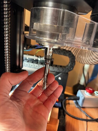

See images attached below - the 5/16" collet is way to large for the mouth of the spindle shaft and the 5/16" bit will only go in the spindle hole the tiniest amount (shown above my thumb - less than 1/2" and only without the collet, which will not go in at all).

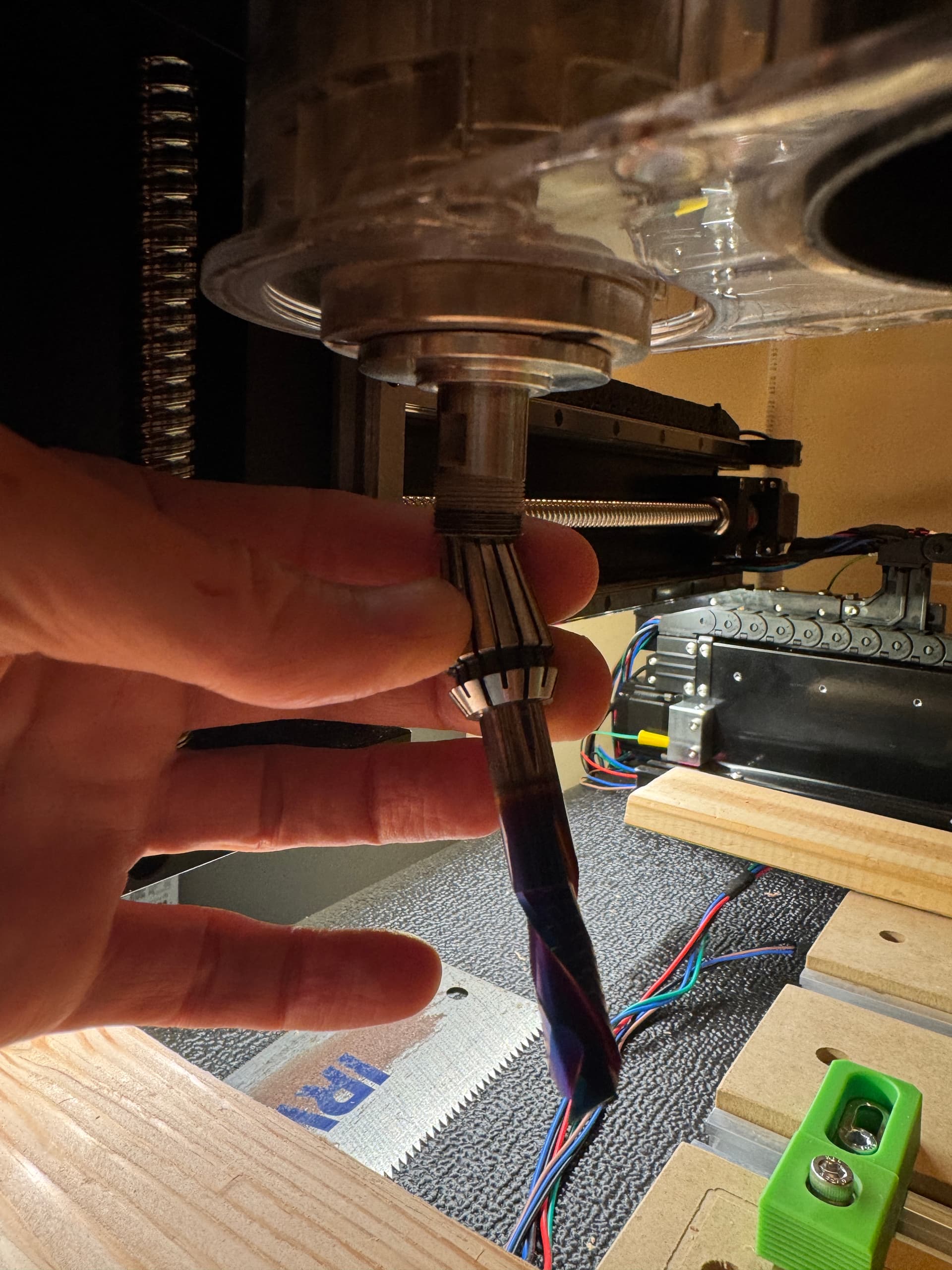

Did you try to seat the collet/nut bit assembly or are you just holding it up and saying it does not work?
If you’re expecting the entire collet to go up into the shaft it does not. If you look at the collet itself it is tapered and the inside diameter is parallel to the bit. The collet wedges the tapered outer diameter into the bit when the collet nut is engaged in the tightening process.
Does not make sense, I have used both successfully on my C3D 65mm version 1 spindle.
@Redlander you nailed it again! I was expecting the 5/16" collect to go up in the hold, but I guess it just needs to have the nut connected and then screws on.
But is it okay that the bit only goes up .45" of the shaft (or .75" with the 5/16" nut included)?
