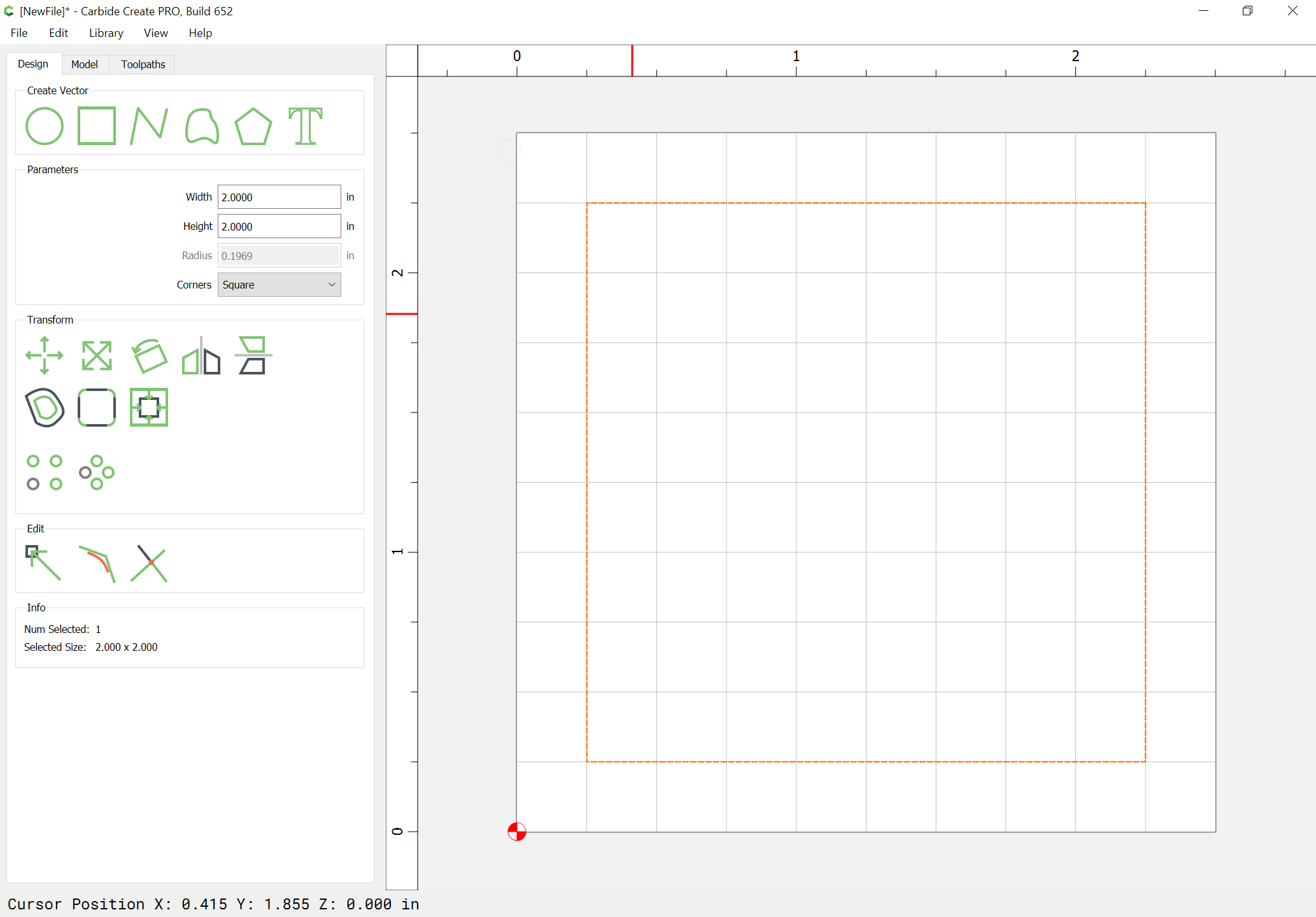

I’m saying if I want to cut out a 2 inch square, I want the edge of the tool to cut a square that is 2.1" on the rough pass and then come in to 2" on the clean pass. I don’t know why this is so hard. I’d assume that’s what carbide’s “step over” would be.

If you have a 2" square:
and if you want an 0.1" roughing clearance then create geometry which is offset by 0.1":
and create additional geometry which is offset from that by endmill diameter plus 10%:
And cut as a pocket down to tab depth:
Then select the original geometry and cut as an outside profile:
Yeah, that’s the only way I can seem to get the results I want is to create an outline and apply two different tool paths. This gets kind of muddy when you have a lot to cut out.

Because there’s no step-over on a contour.
It makes sense that you are looking for this option but unfortunately it’s not there in Carbide Create as yet.
Stepover can’t be applied here since a profile cut is supposed to follow the line directly and so won’t have an opportunity to progressively move closer to the line.
That said, the setting you’re after is something that exists in other product’s profile toolpath options, and looks something like this (in mine):
