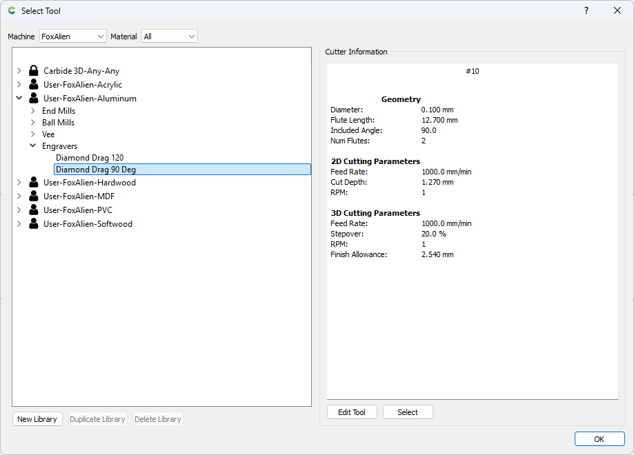

Where did the diamond drag cutter tool definition come from?
I don’t remember where I got the settings but it’s the MC Etcher diamond drag bit. Version 7 and earlier never had a problem with it.
The way the cutter is defined means it covers a large area of the part (you can see it animated in the simulation). That large area means the finish toolpath needs to check for collisions with every part of the cutter, which is a lot of extra math.
You can shorten the flute length, which should reduce the cutter’s overall diameter. That should make it calculate more quickly and probably be more physically accurate, too.

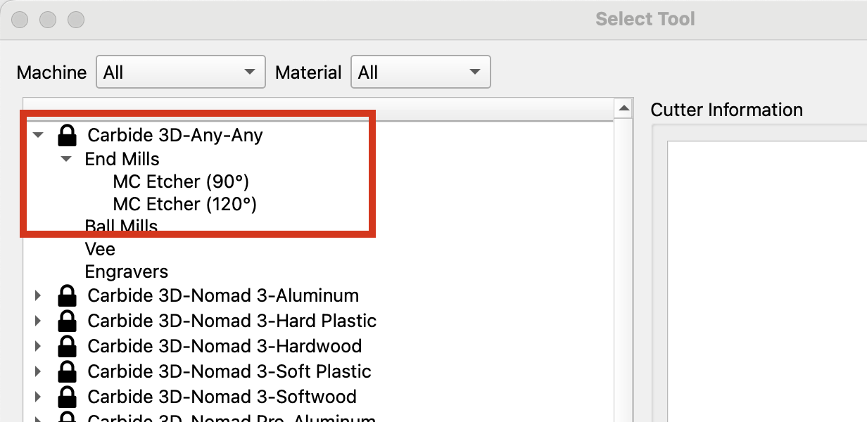

What are the recommended profile settings for the MC Etcher 90 and 120 degree diamond drag bits? I don’t believe I was able to find them when I got them.
That works, thanks! Never thought to look under End Mills for drag bits.
