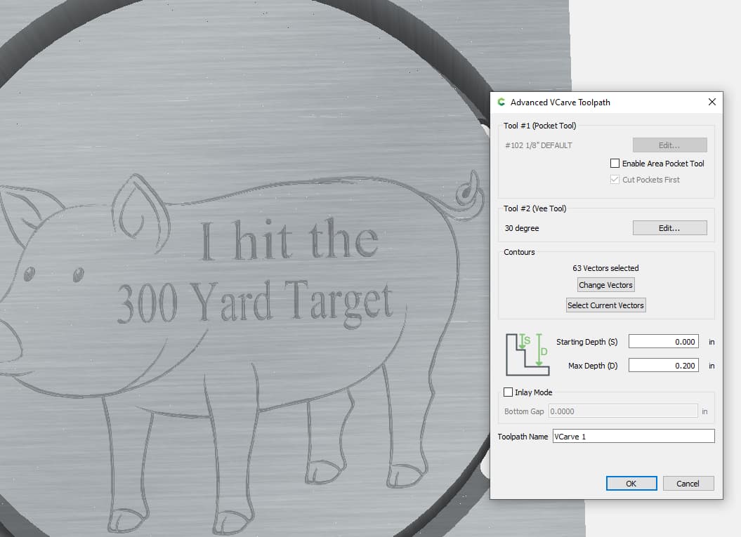

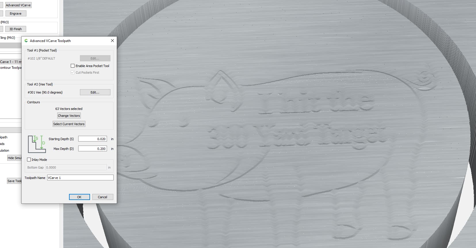

The file has your Z Zero as Top-of-Stock. Are you setting the Z there, or are you setting the Z as the wasteboard?
EDIT - Nevermind, this reversal would actually cause wildly deep plunges, not air cutting.
If you set the Start Depth to .02 up to about .05, you will get a nice carve, if you must use the 90-degree vbit.
If this were my project, I’d use a 30-degree V-bit.
This is with a 90 and a .02 start depth
Here is it with a 30 degree v bit, with 00 start depth.
