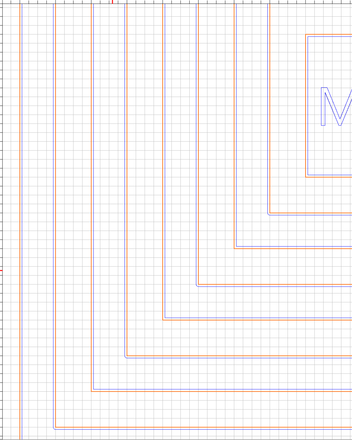

I designed a series of squares 4x4, 6x6, 8x8 and so on in carbide create to be cut into on MDF. The idea was to have perfectly sized and spaced squares for reference. The tool was #102 end mill (1/8") and the max depth was .05".
I selected all the squares at once, chose the Toolpath as contour and offset direction as outside right.. Again, it was one toolpath where all squares are selected so that they would be consistent.

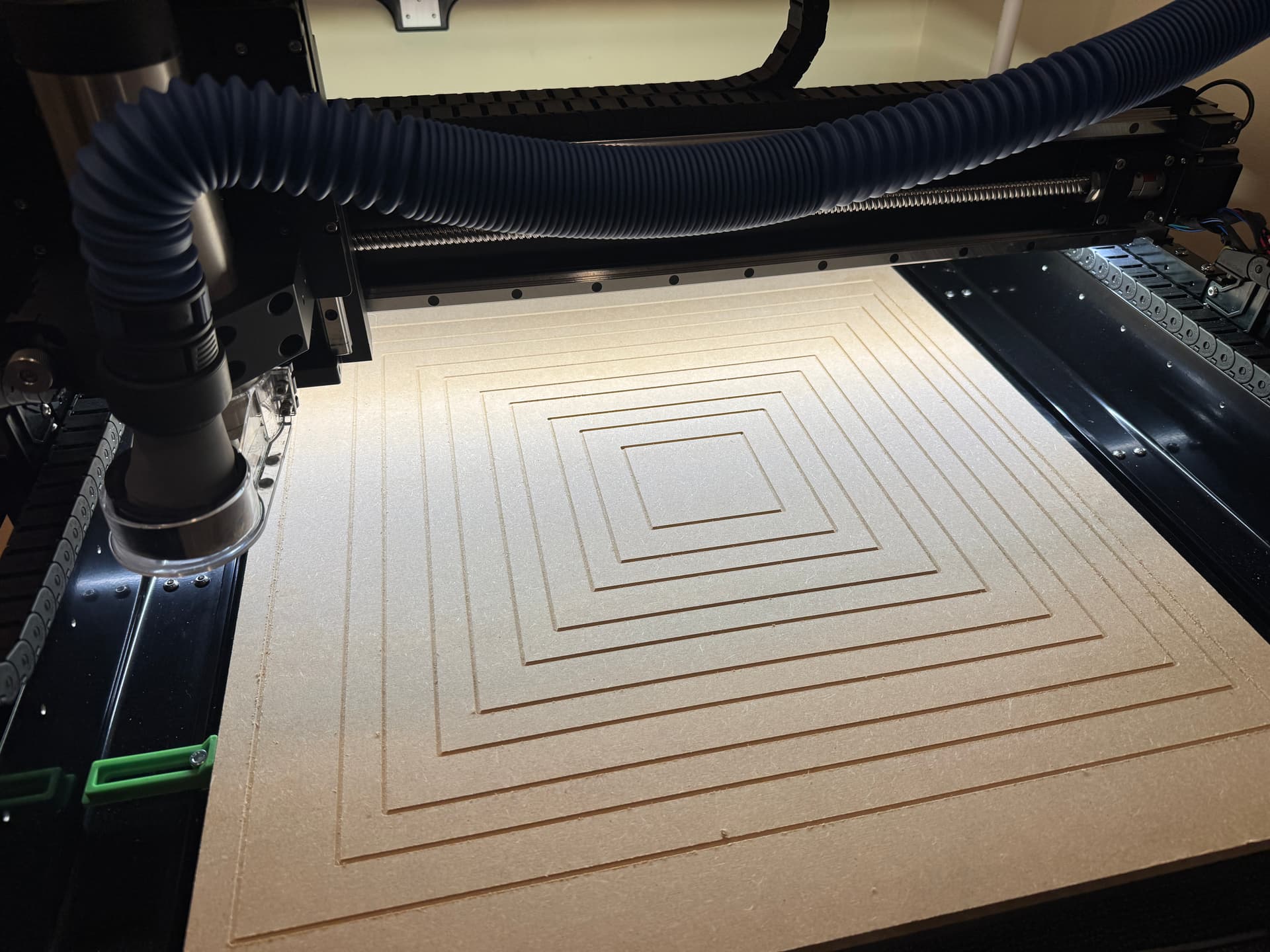

However, when I ran the job, I noticed that the squares were spaced differently and realized that some of the toolpaths, in fact every other square, were actually inside contours (opposite of what I selected)!
This was not expected and does not seem intuitive for design software. Is this a glitch or am I doing something wrong? You can look closely at the file to see what I mean.

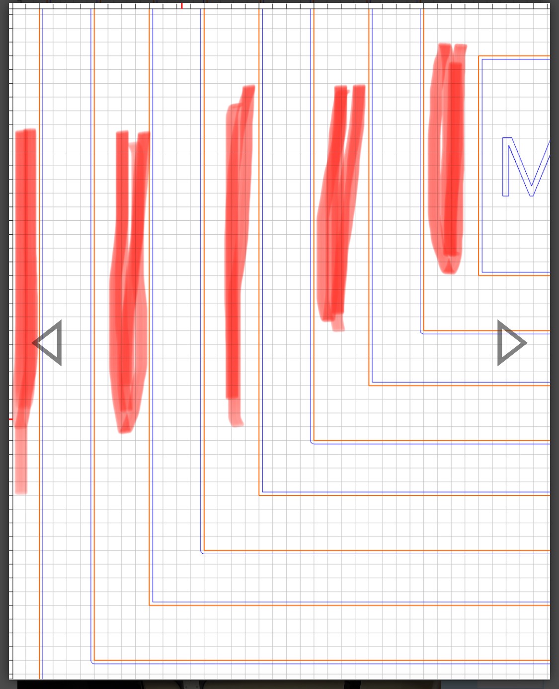

Looks like your tool path is set to cut out separate frames. I highlighted the “frames”. This cuts in the outside of the “frame”. Or, you need to select each line one at a time and choose outside/right” of line.

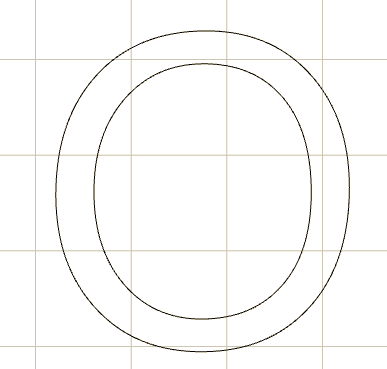

Think of a letter ‘o’. The ‘interior’ of this object is the area between the vectors, so an outside contour can’t be between the vectors.

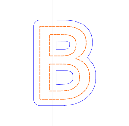

Here’s a really simple example to show why this is the correct way. Imagine cutting nested vectors in the form of text. If you select the entire letter and want to cut “outside” it, obviously the cutter should not cut inside the letter. When you have pairs of vectors, toolpaths will effectively consider them as a single object. Otherwise anytime you want to cut out a letter or something you’d have to un-intuitively create two separate toolpaths.
