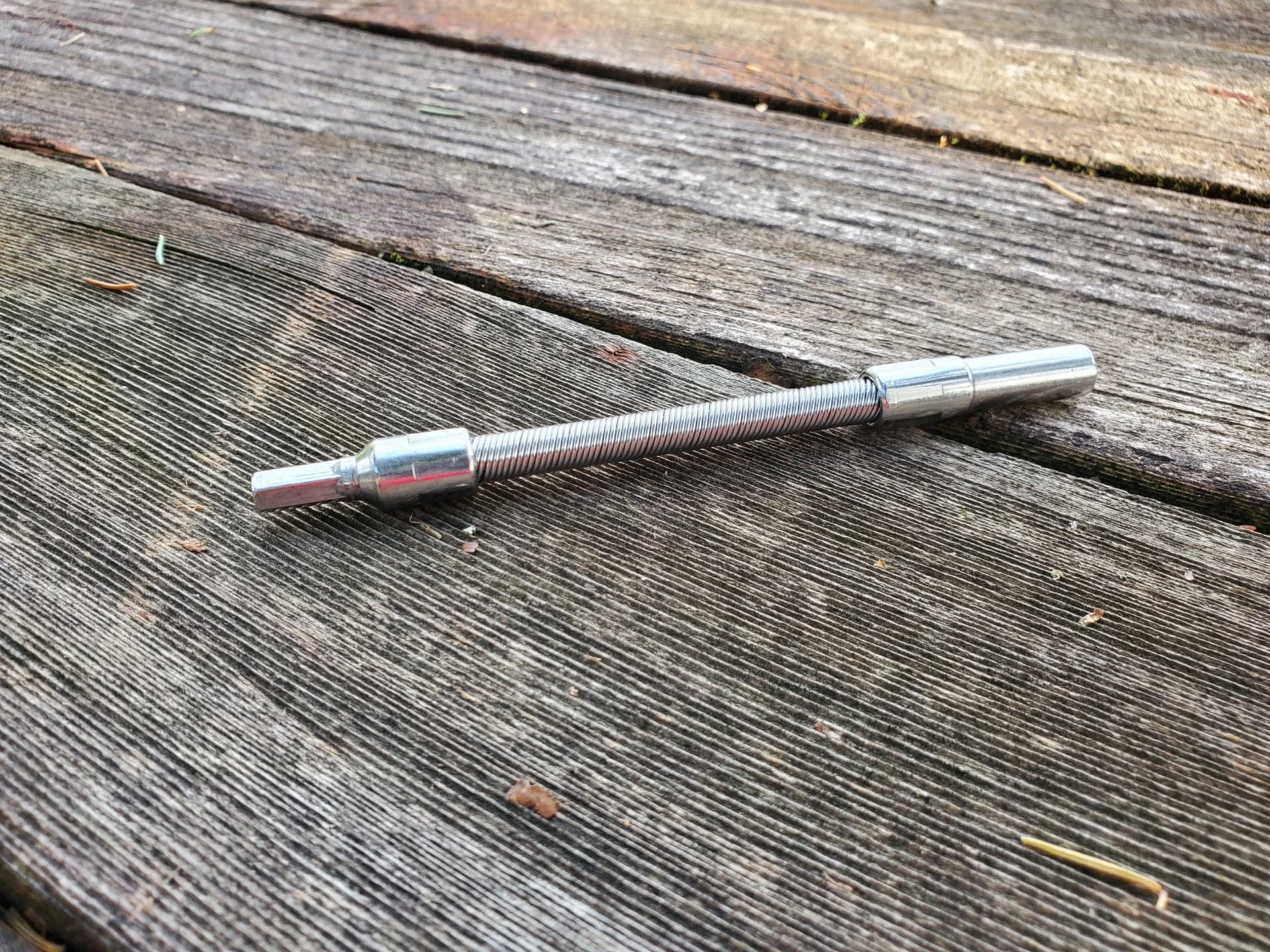

Yeah, there have been a couple of fasteners where I’ve found a flex shaft the best approach:
