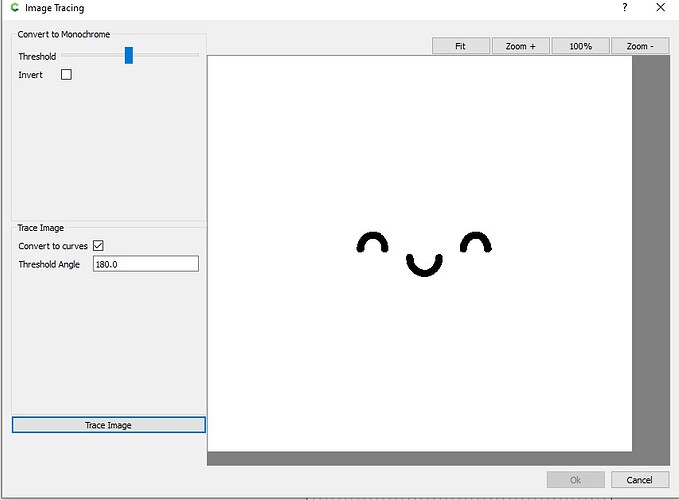

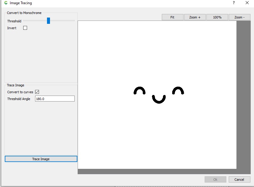

Adjust the threshold. You will likely have to trace several times with different thresholds to get all the parts. Adjust the threshold angle to get smoother curves.
For an example of doing this see:
I believe the Trace option uses the grey scale as a way to find edges.

Carbide Create’s tracing expects a b/w (monochrome) image.

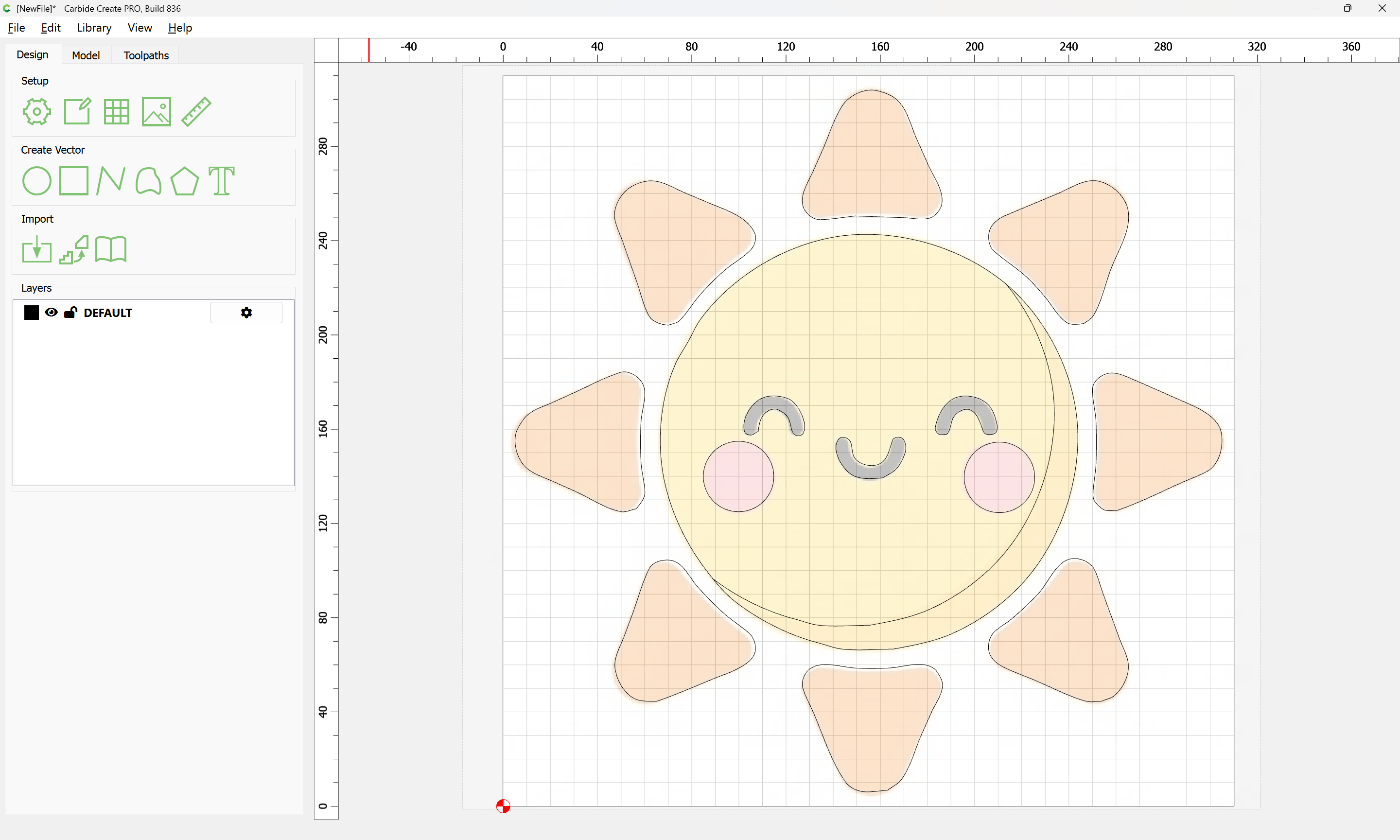

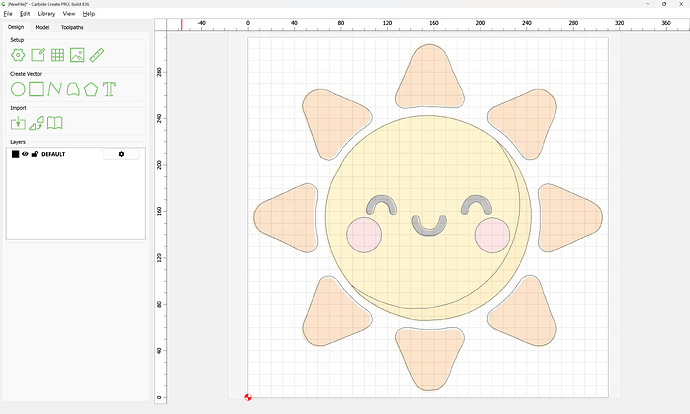

If you trace multiple times adjusting the threshold you get:
Attached as a v8 file:
sun_v8.c2d (224 KB)
which w/ a bit of adjustment should work well.
