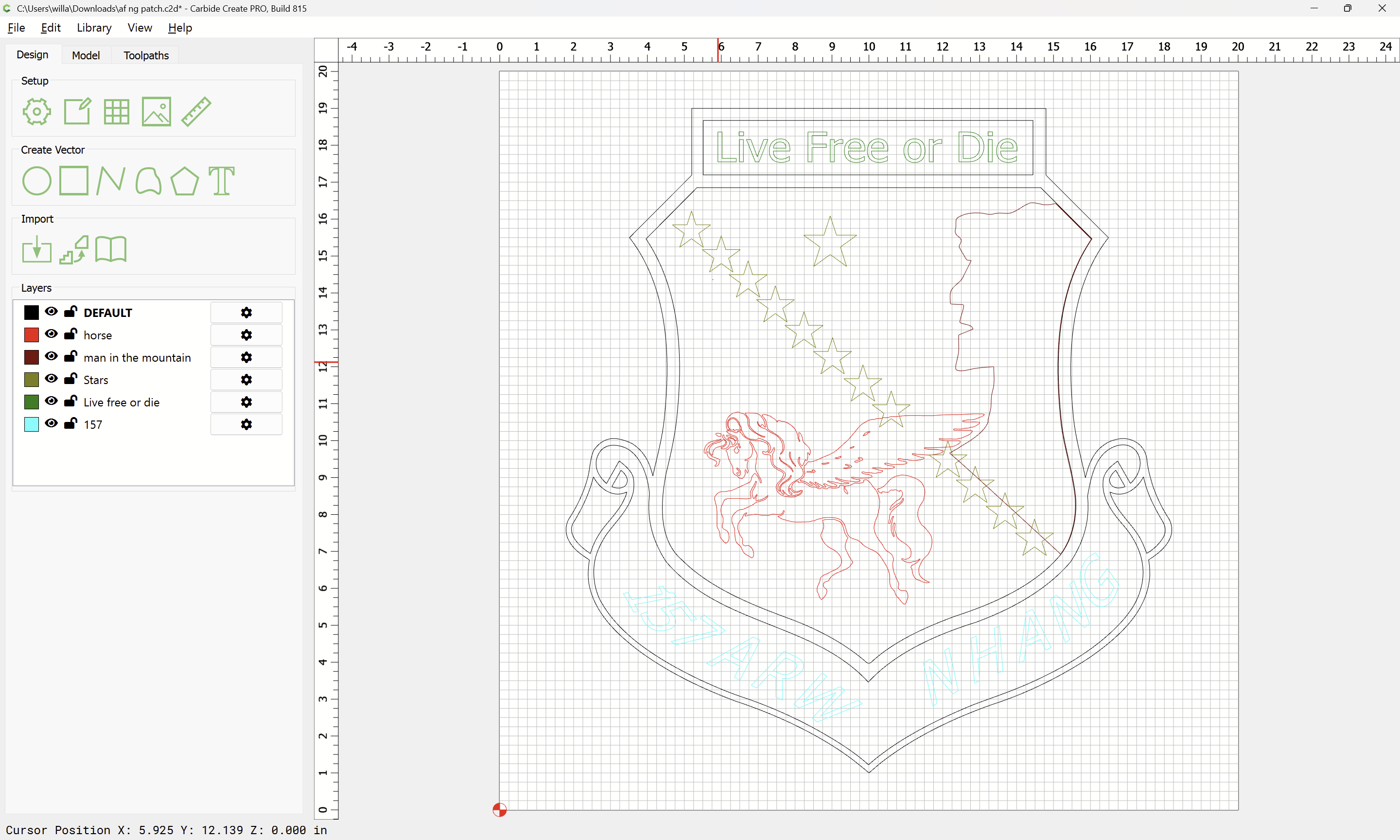

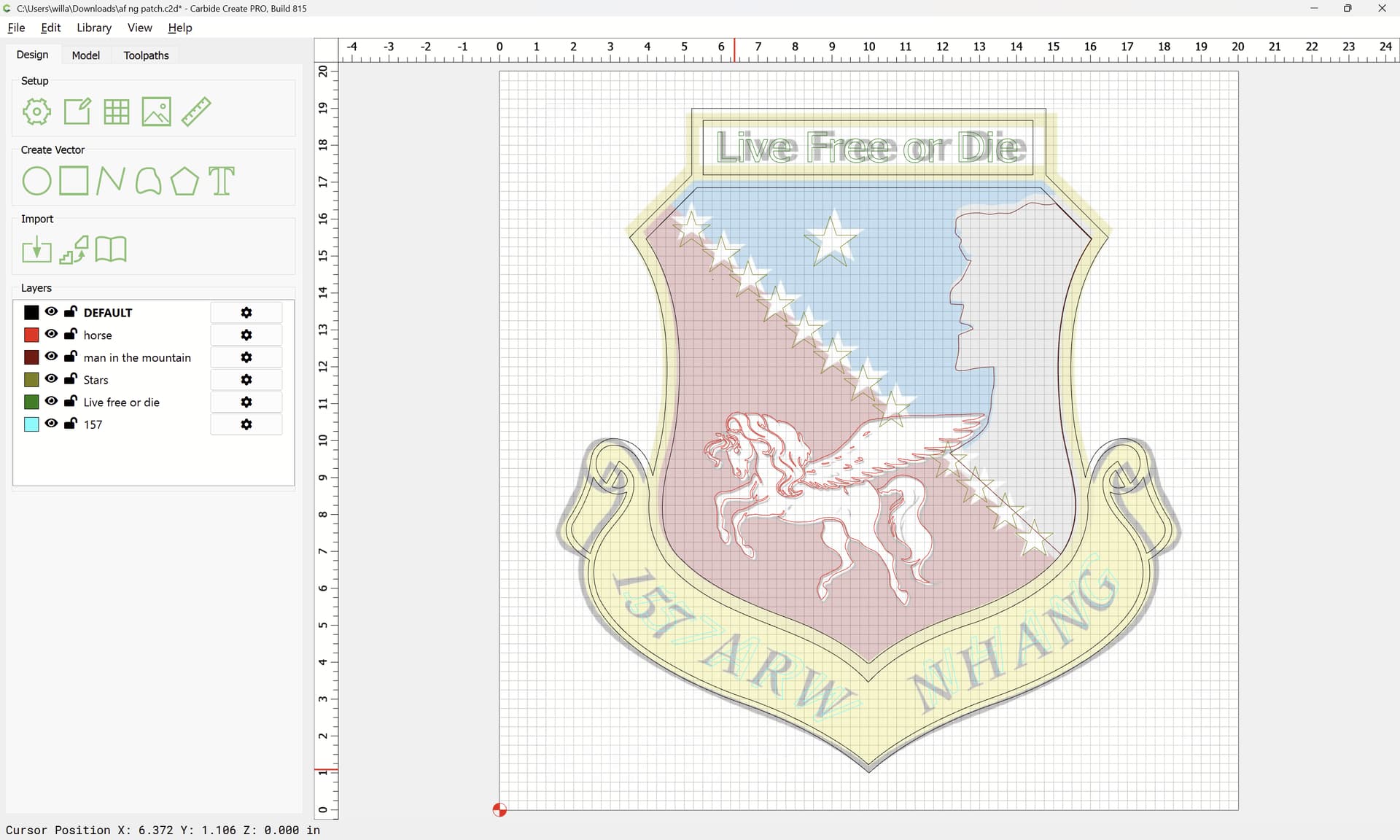

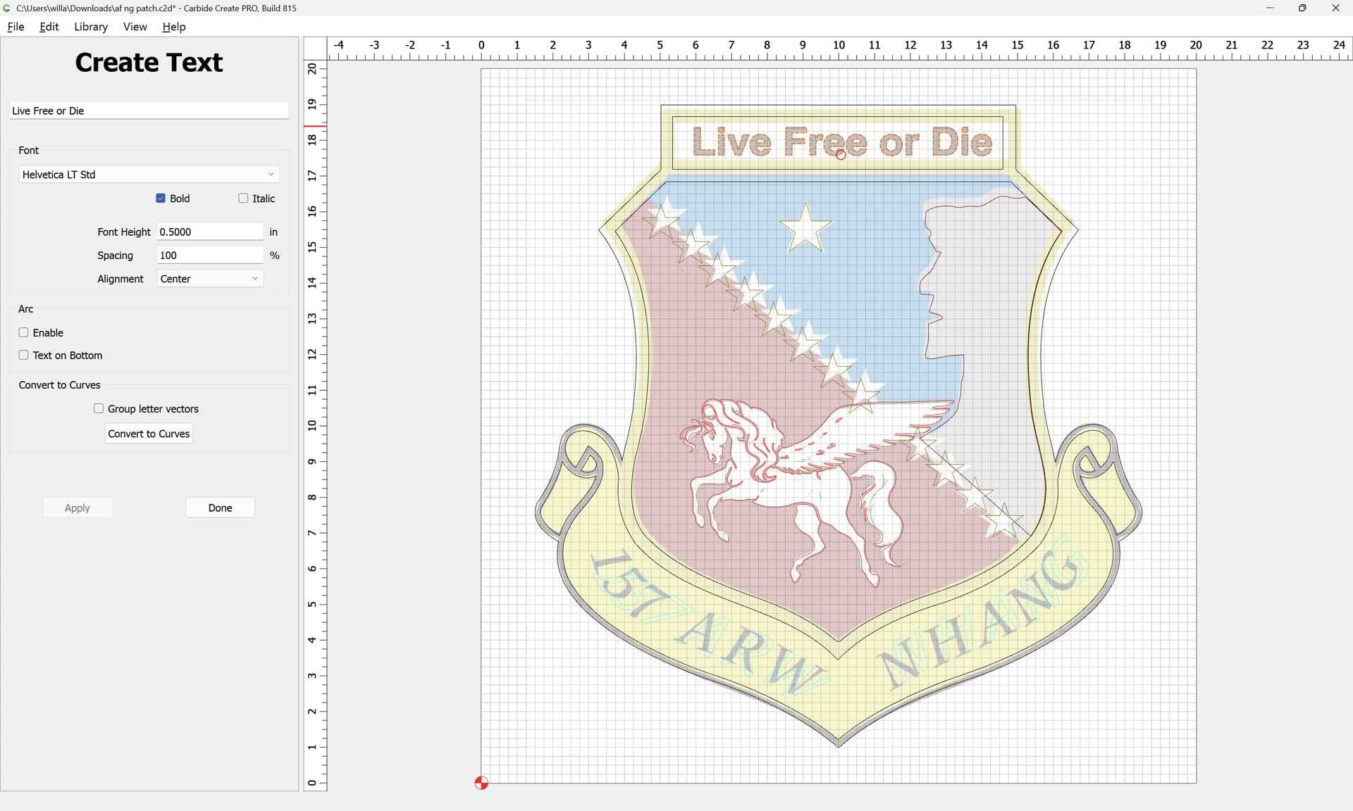

I was approached today by a guy at work and he wants me to make this for him to give as a retirement award. Is there a trick to getting better results from the tracing feature. I have scoured the web trying to find a better image quality but noting seems to be working that great in the trace image. Any help would be greatly appreciated. Thanks
Chris
You might have to separate out colors and trace more than once. Depends on how you plan to cut it & color it.
That looks great, They dont want it colored just outlined from what they said. I will trace this and keep working it till I get a good copy. Thank you again.

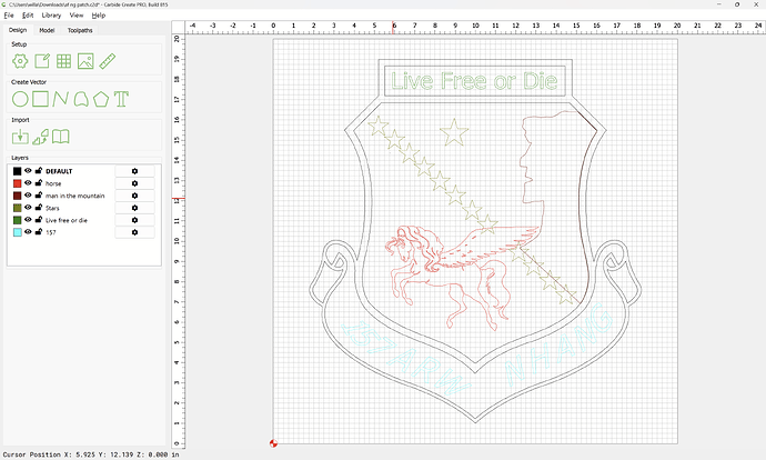

I took your advice and traced it many times and got it just about dialed in. Thanks for that tip. Now off to figure out how to close these open vectors in have. lol

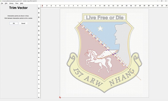

af ng patch.c2d (1.6 MB)

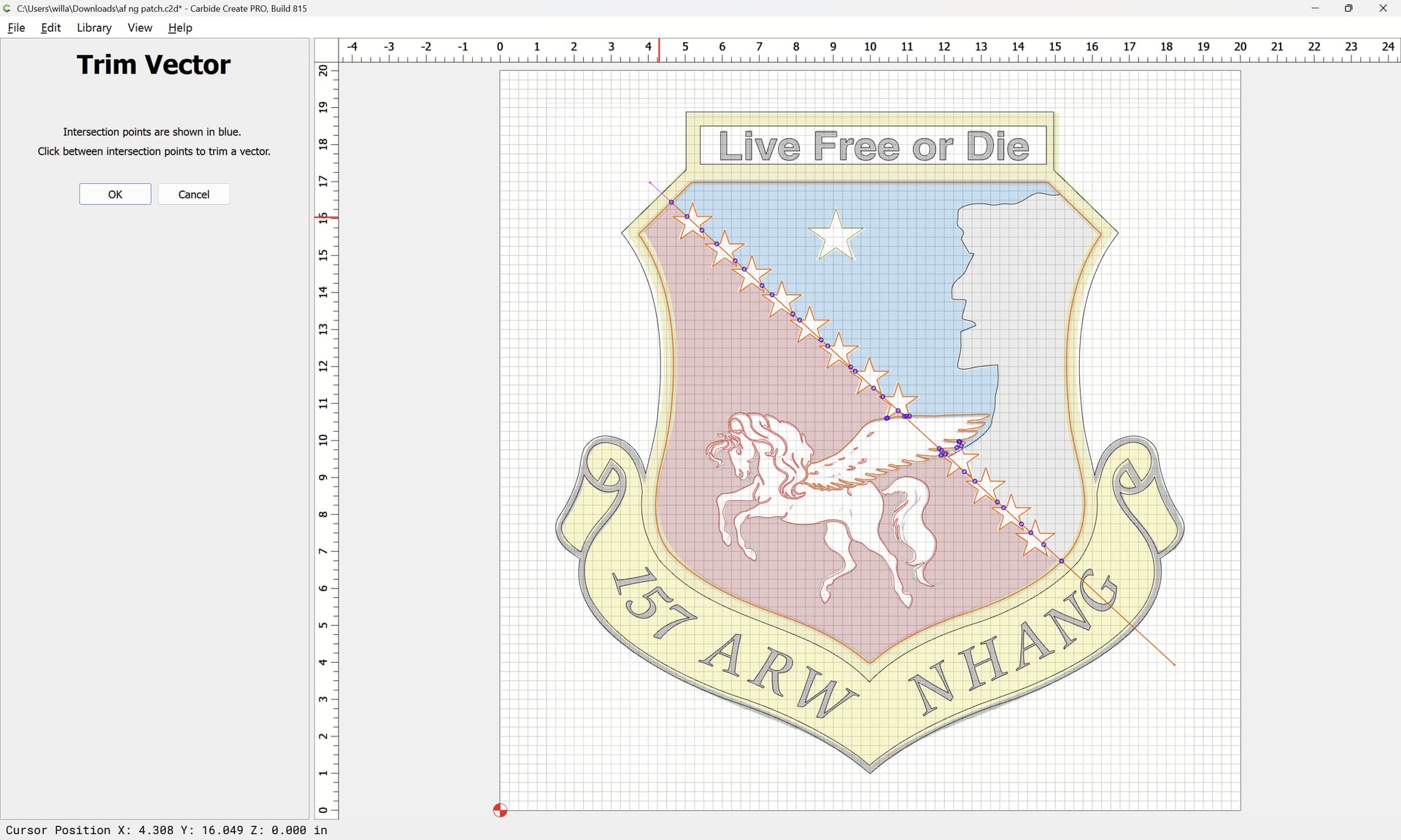

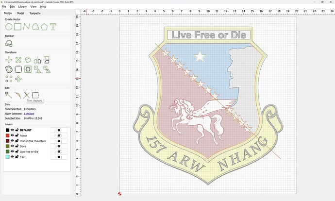

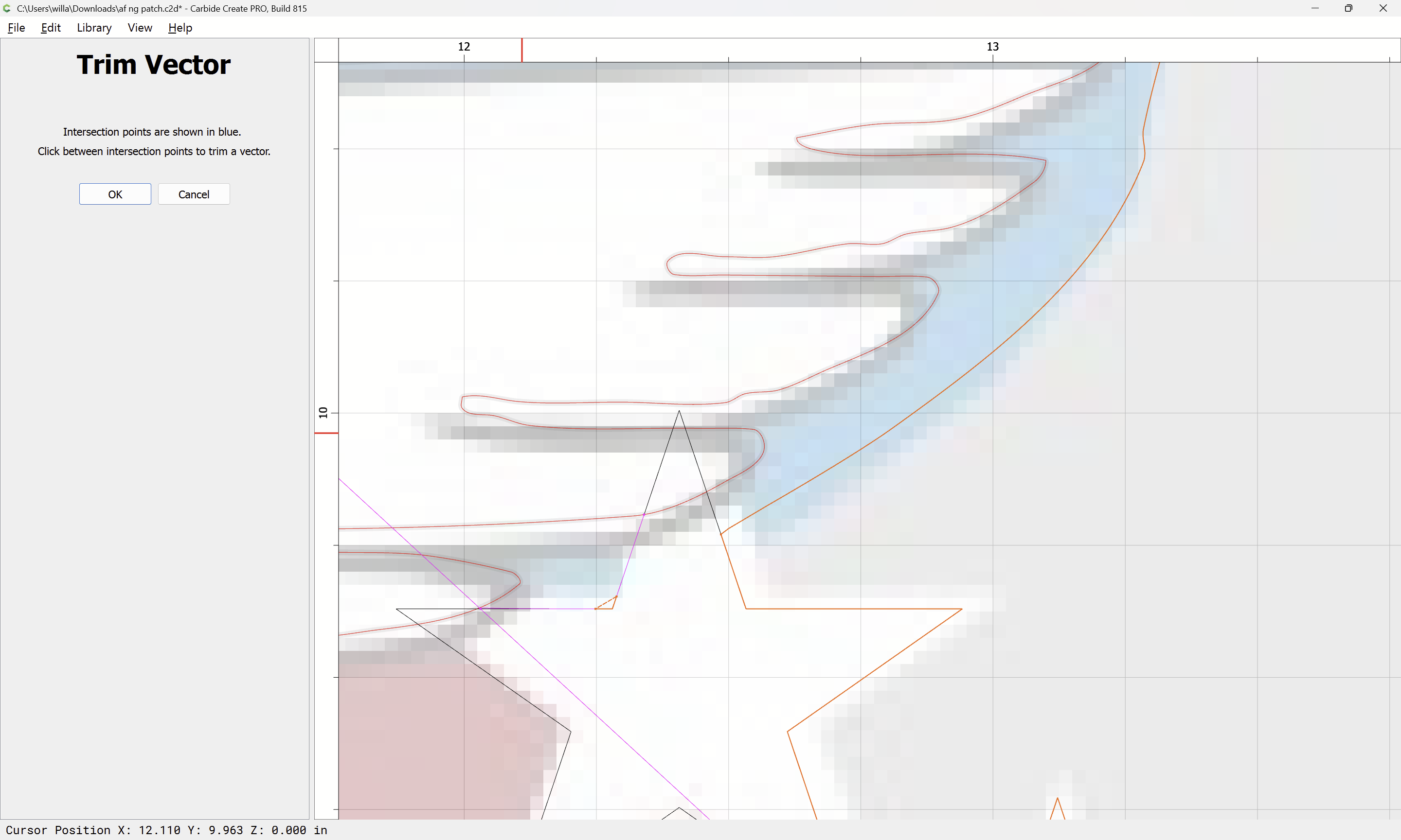

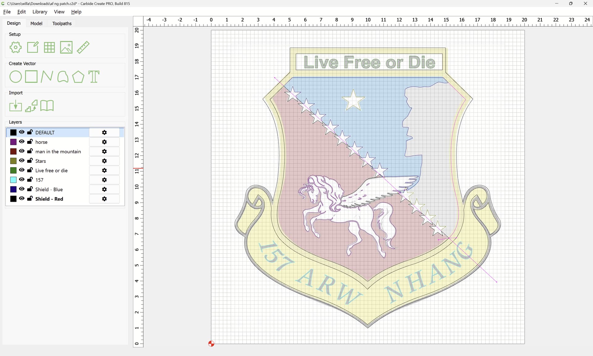

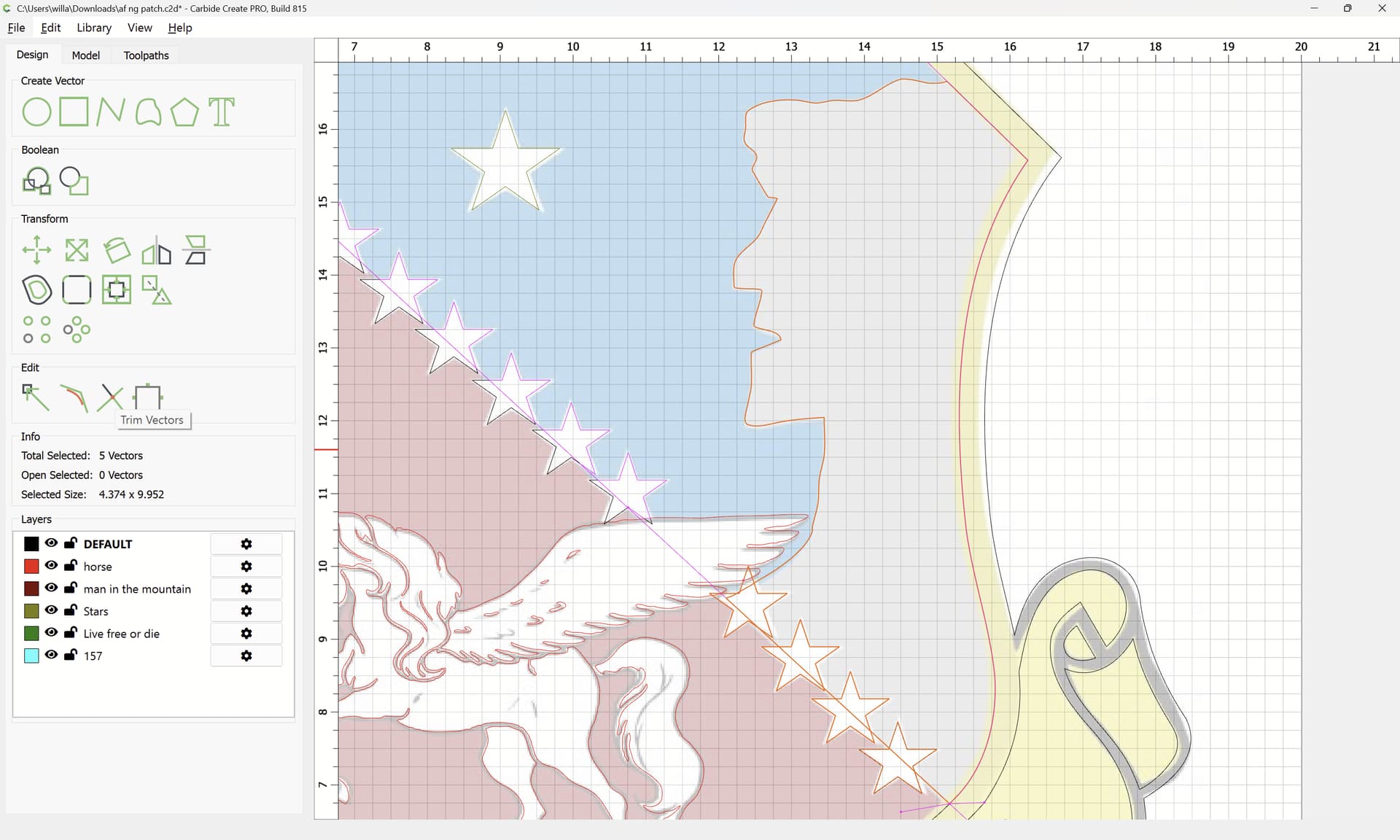

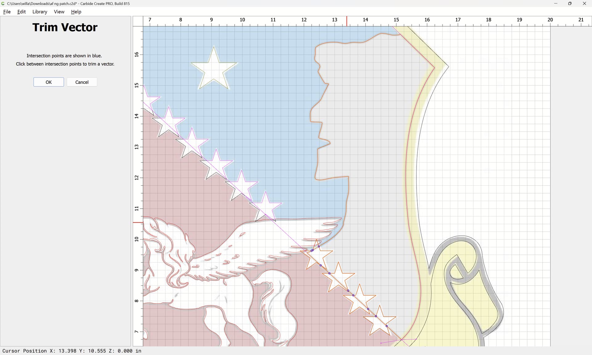

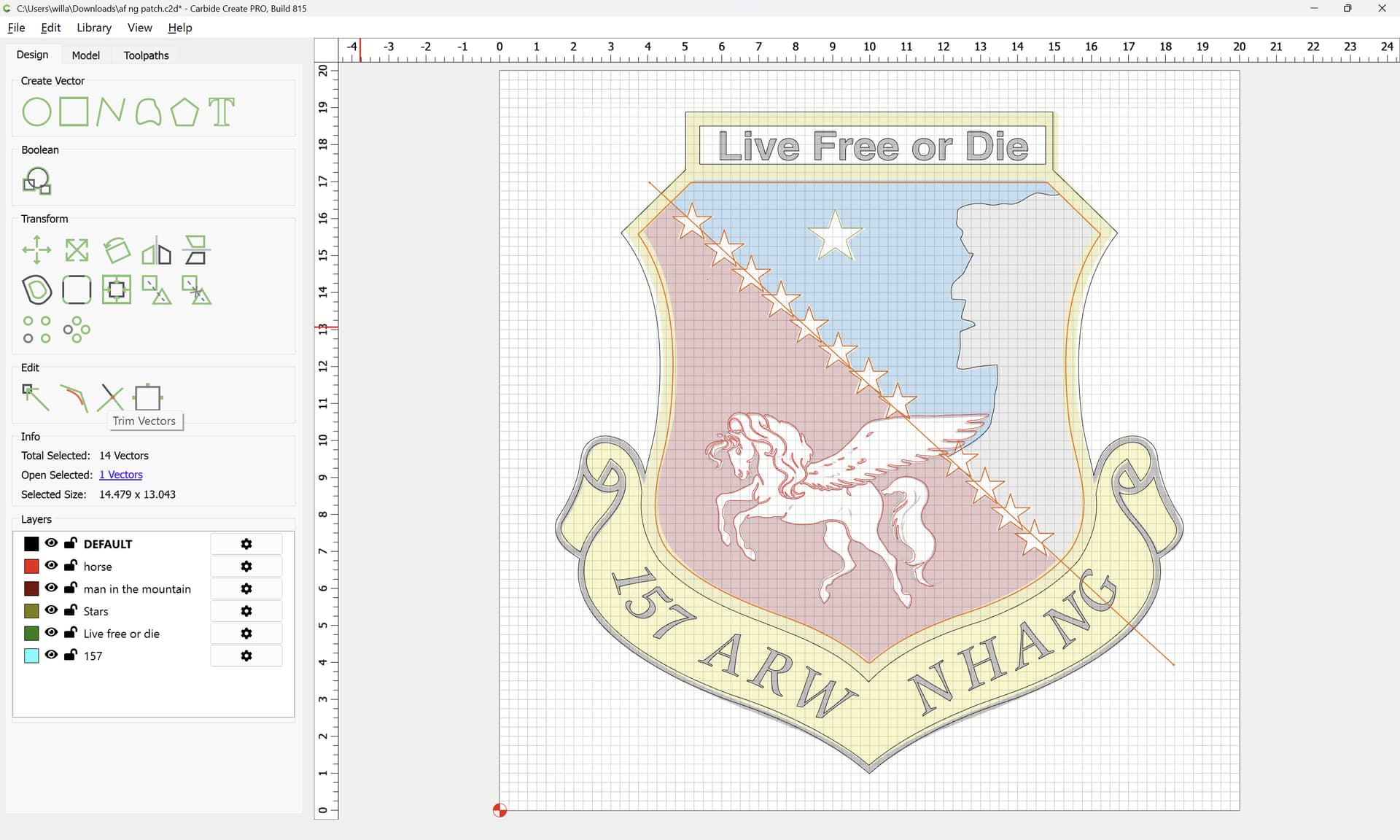

When I go to trim out the stars by trimming vectors the entire man in the mountain and the stars on either side off the pegasus disappear when I go to cut it out. I uploaded the file with zero vectors trimmed. When the pocket it cut out the stars would be cut out.
Also, is there a way to do a this in 1/4 inch bit then 1/8 to cut down the pocketing time? I was reading on here a finish pass would cut down on sanding, would I use the same or different but for that?
thanks,
Chris
trim issue NG patch.c2d (1.7 MB)

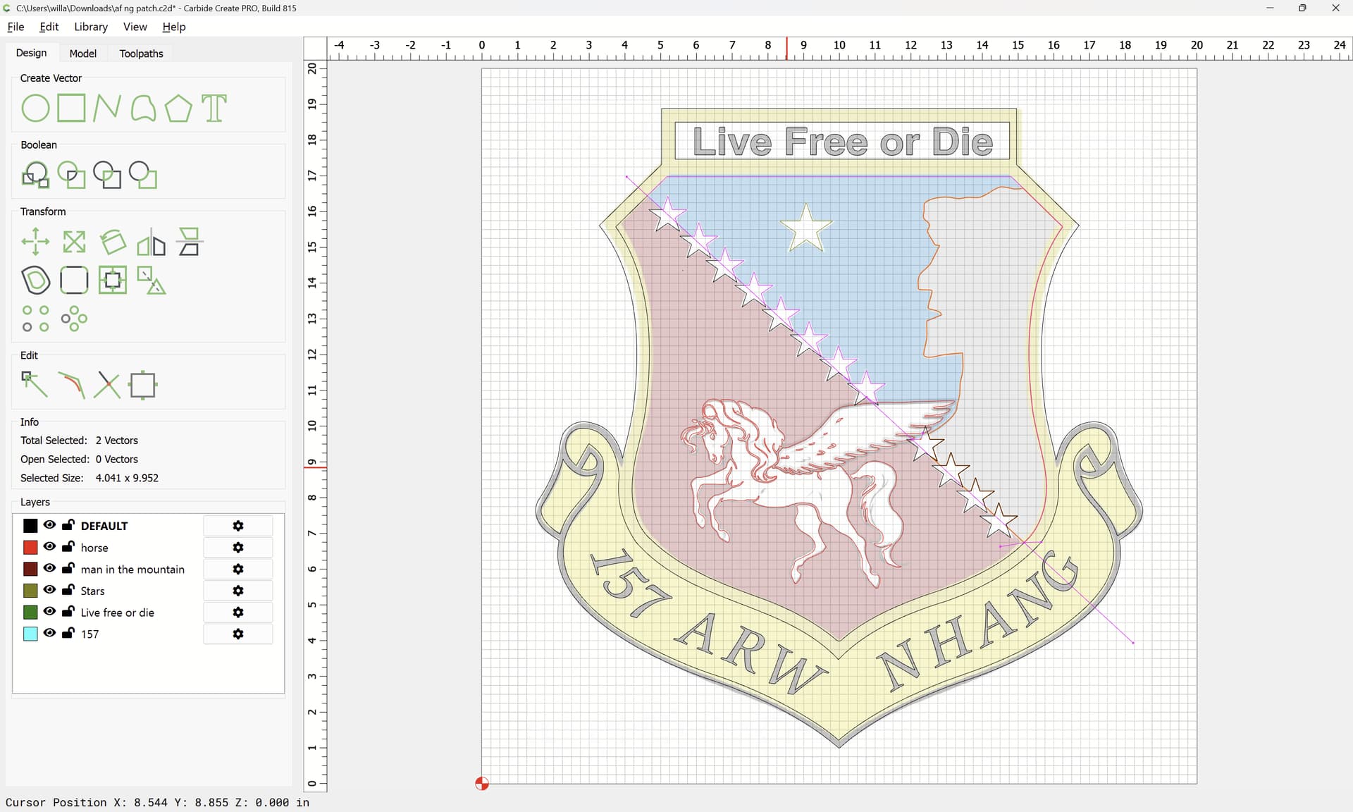

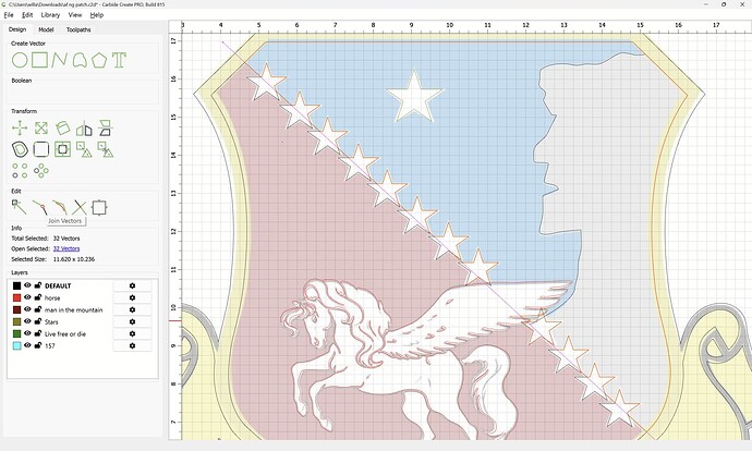

Given the file:
we import the pixel image as a reference, but things don’t quite line up:
How were the vectors created?
Do you have any original file other than the pixel image?
I will upload both files. I traced the image and made the stars and stuff myself.
af ng patch.c2d (1.4 MB)

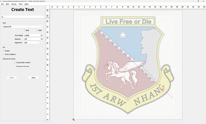

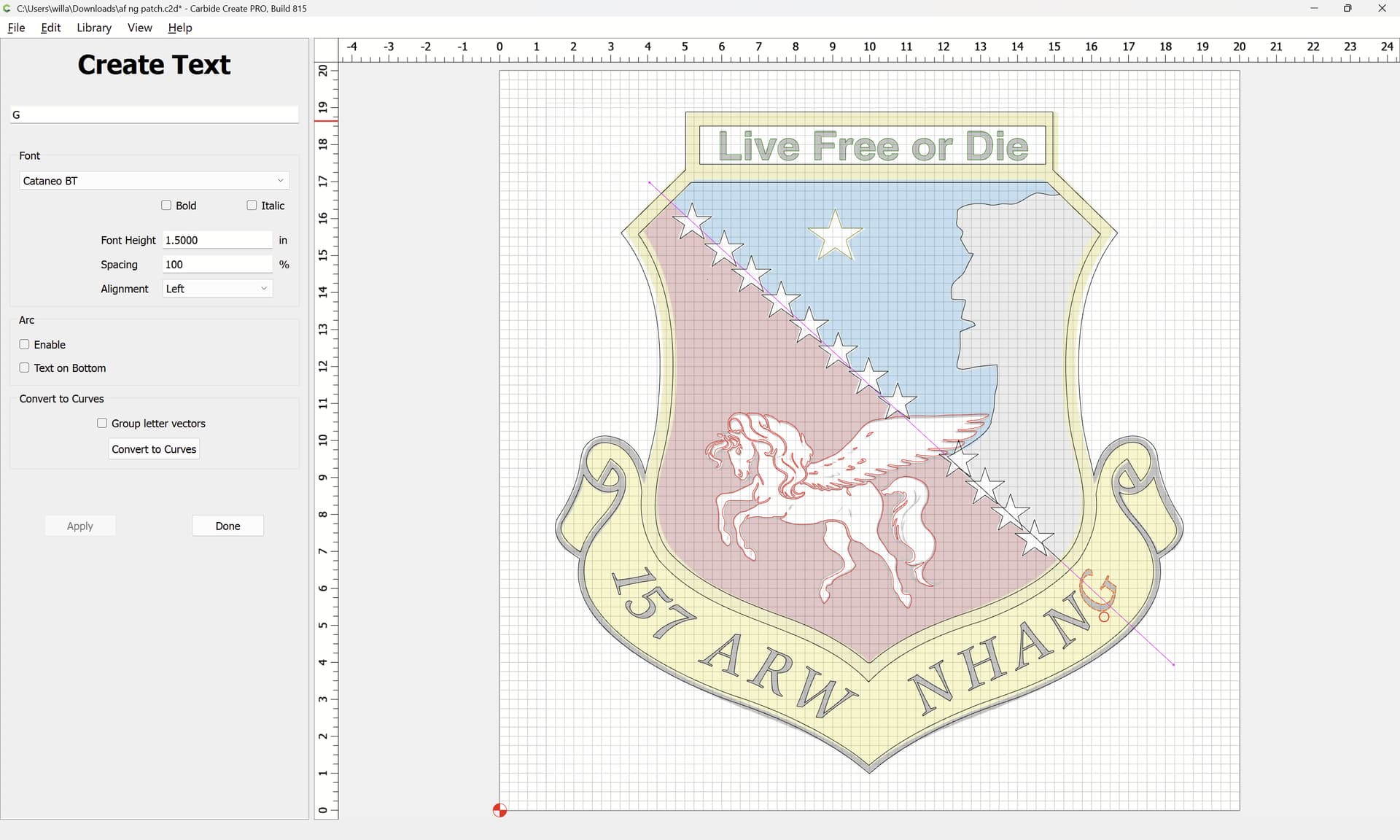

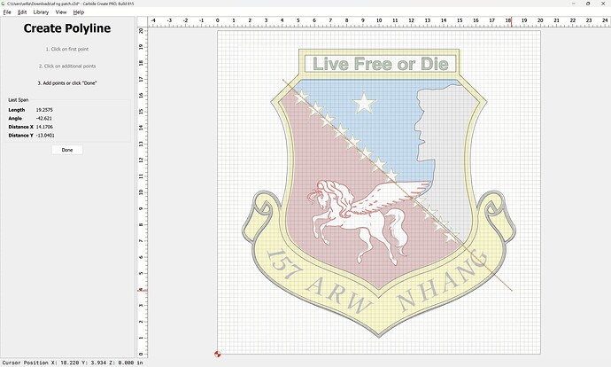

Okay, re-working things to get things lined up, the text should be Helvetica Bold and Palatino or Bernhard Modern (depending on which pixel image on is looking at), re-setting that and adjusting things we get to:

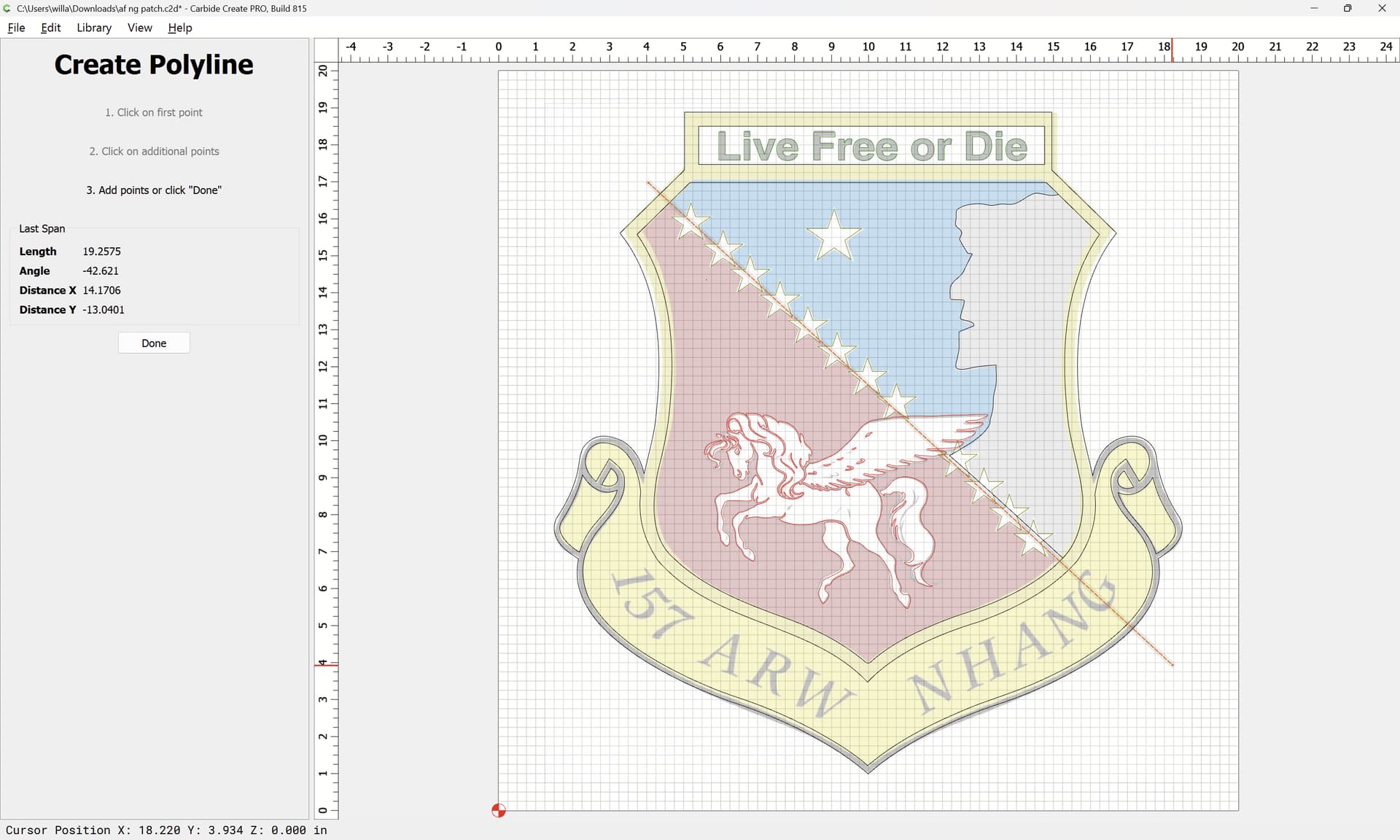

Good to see the line there to align the stars that is what I did, nice to see my train of thought improving with setting up stuff in this program
Or belike Cataneo BT.

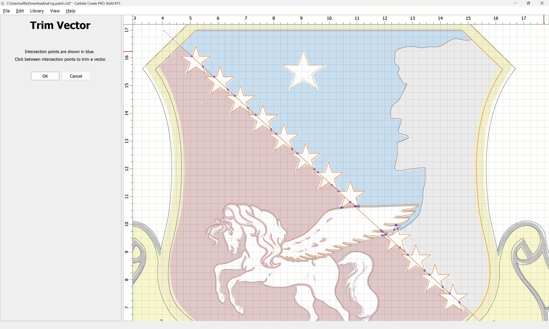

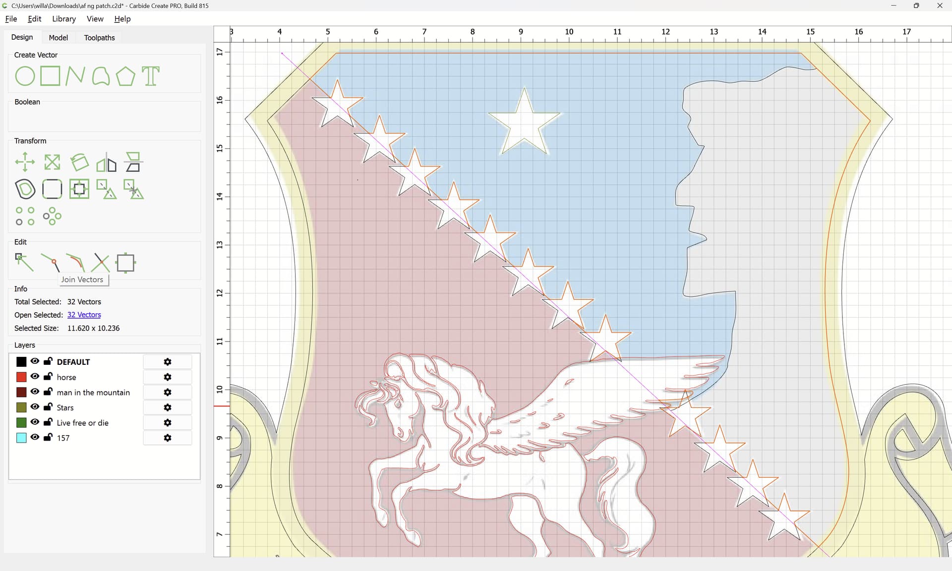

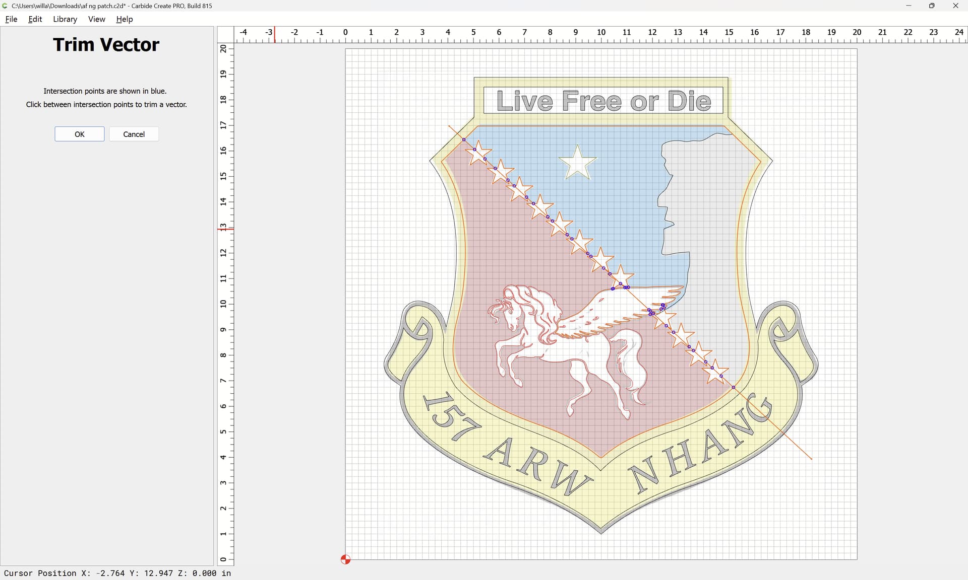

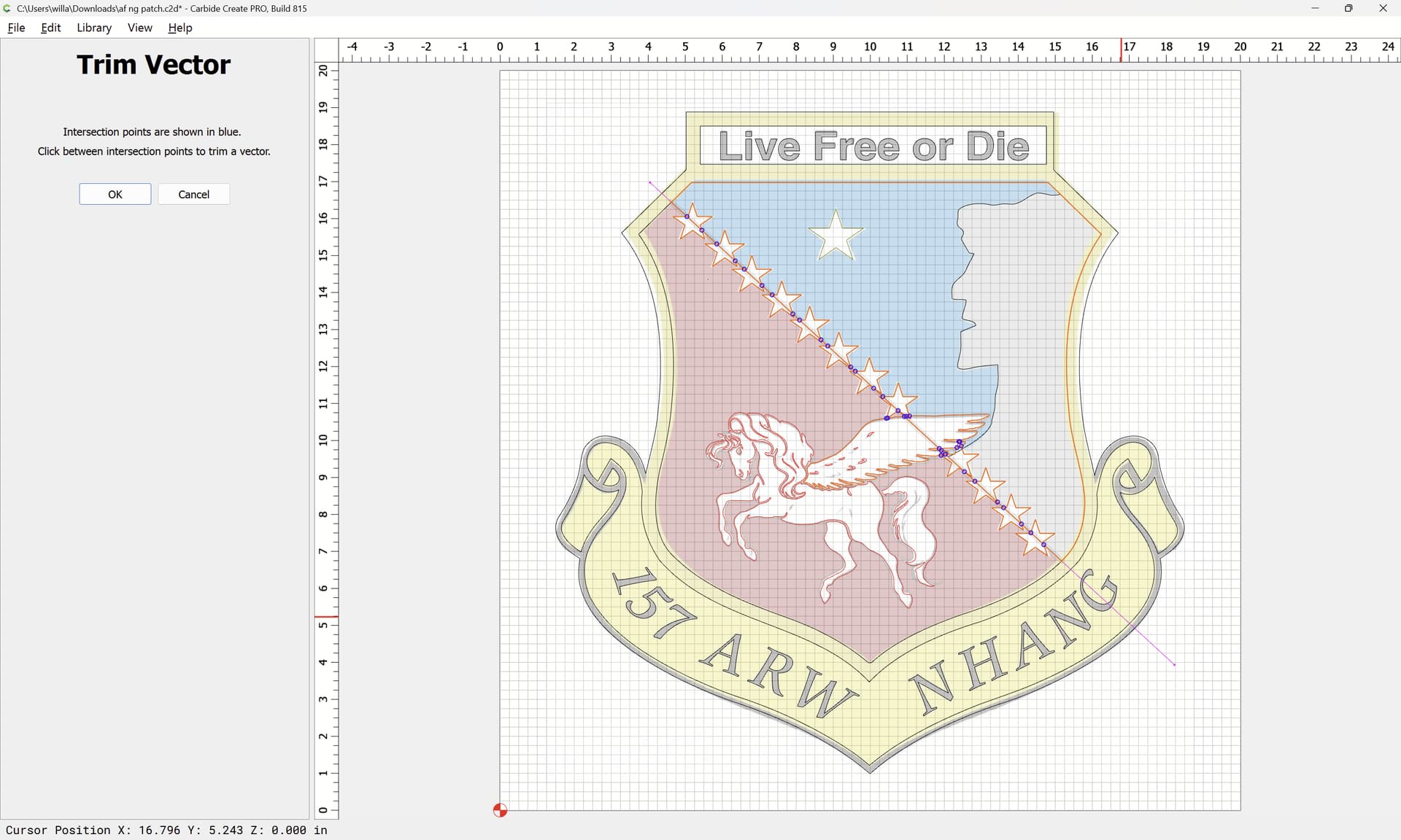

For the shield, it will be necessary to duplicate it and the stars and other geometry which crosses it:
Then use Trim Vectors:
to create the outlines of either the red or the blue side:

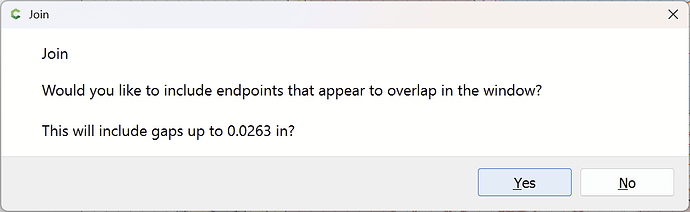

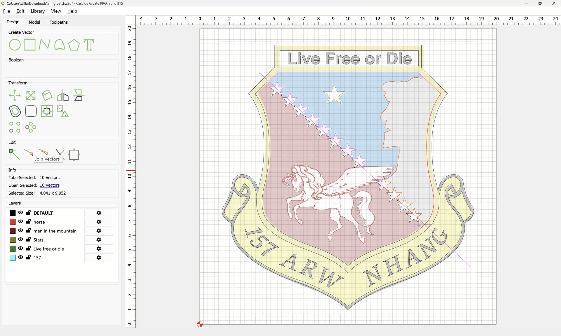

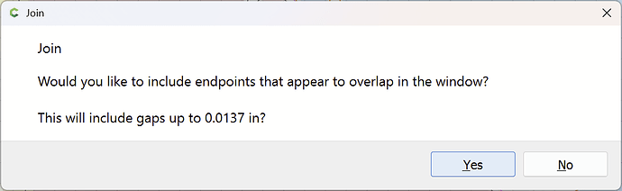

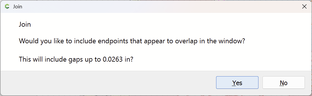

and Join Vectors to close each side:
Yes

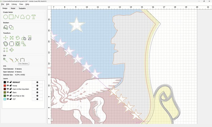

Similarly, for the grey area:
Yes
Eventually one arrives at:
Attached as a v8 file.
The only remaining issue is that the drawing of the horse only captures one outline, when it is drawn as a double-outline (black with white interior) — addressing that is left as an exercise for the reader, as are toolpaths. Multiple colour files are often best addressed as epoxy inlays.

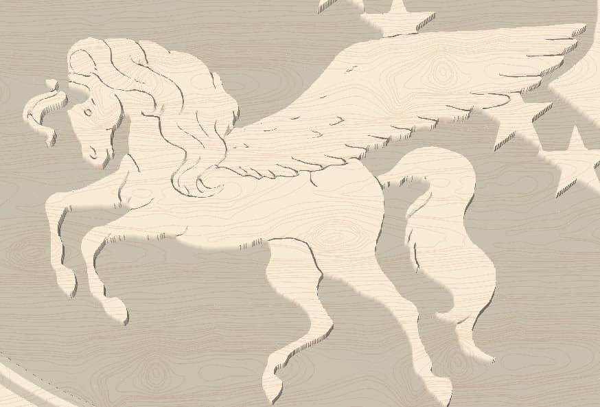

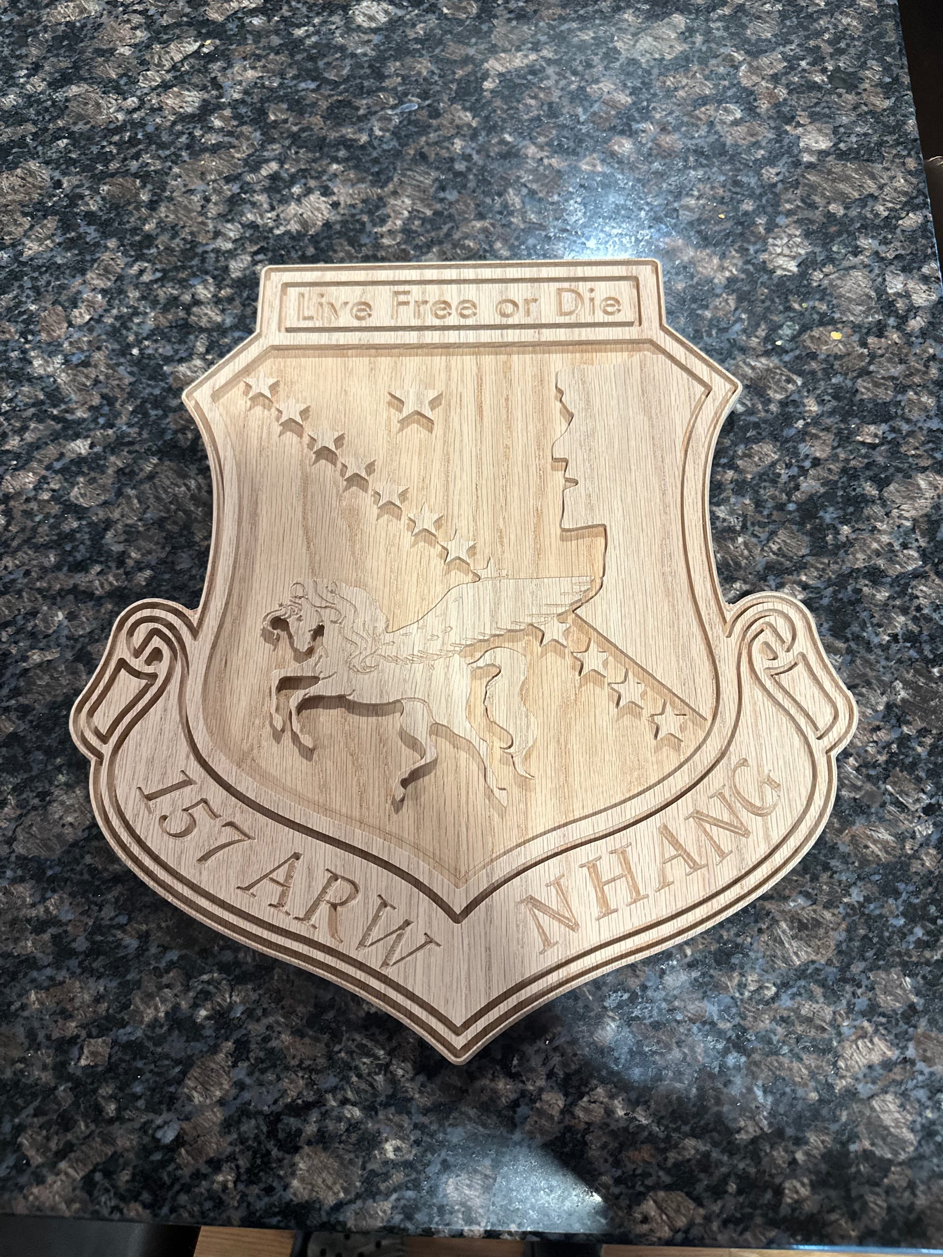

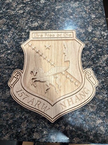

Here it is in the raw… came out good, thanks for yalls help.
