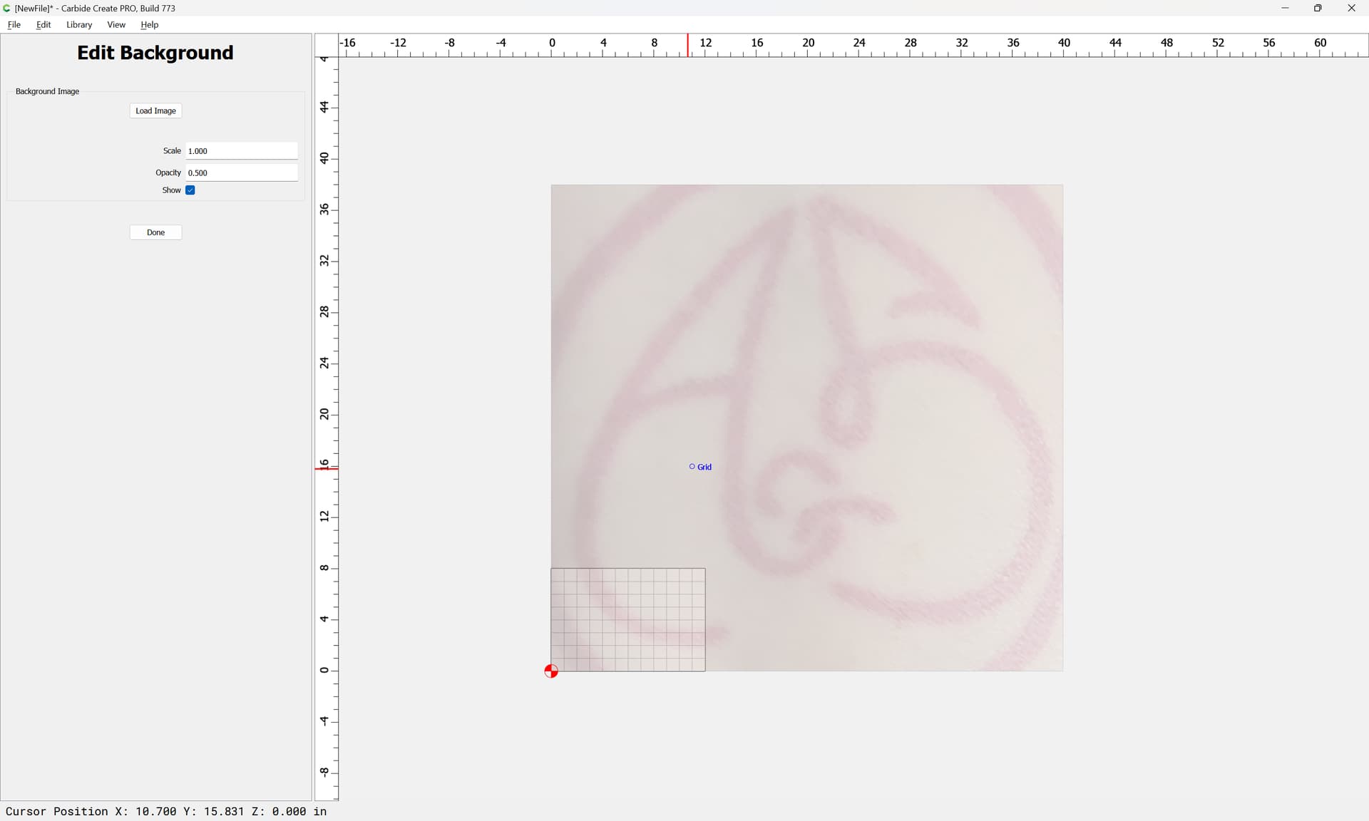

Import the photo as a background image:
and then adjust the stock size to match:

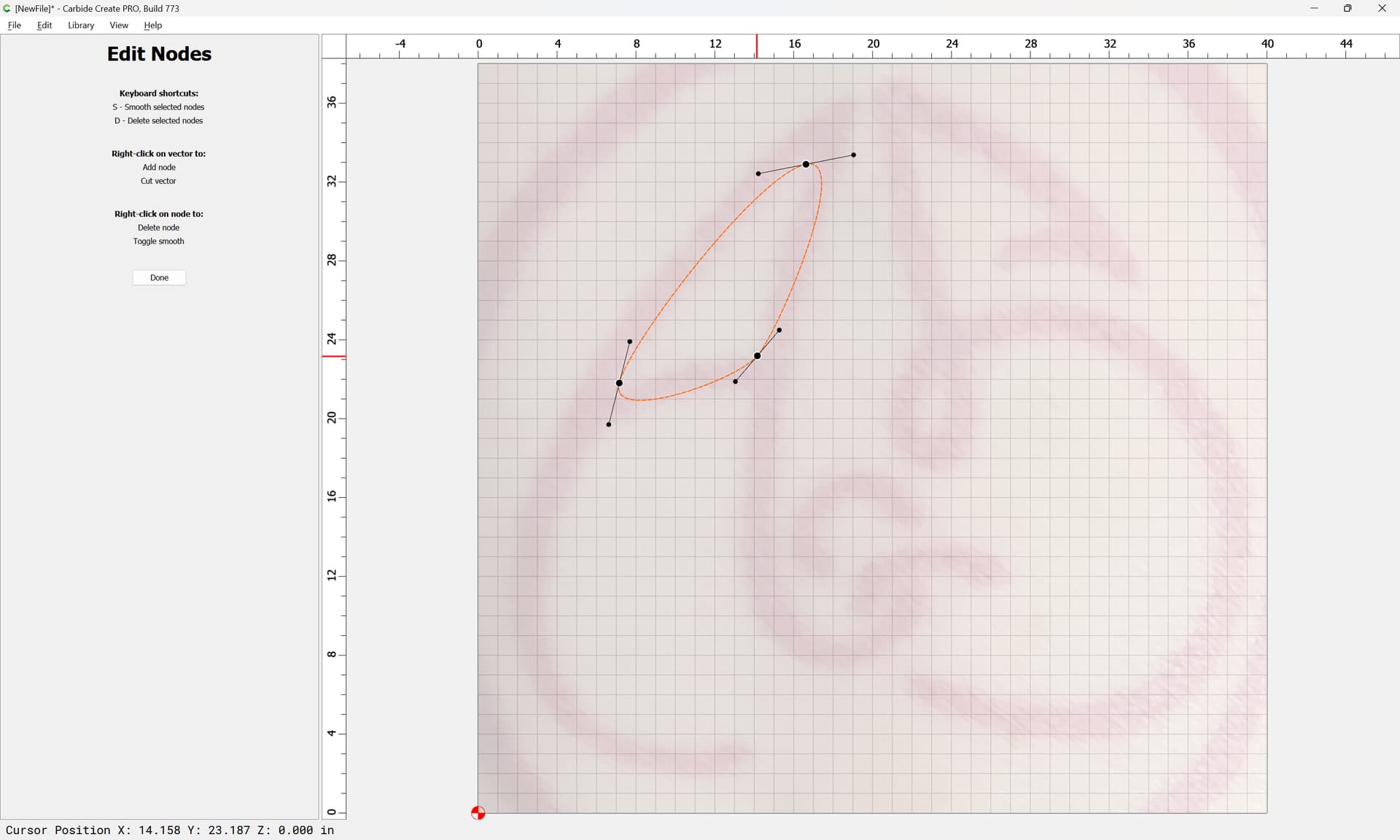

Then use the Curve tool to draw the outlines, or draw points with the polyline tool and then adjust using Node Editing:
Done
Repeat for each shape/outline:
If need be, adjust the Opacity:
until one arrives at:
