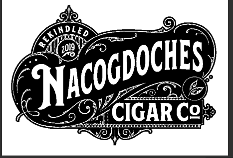

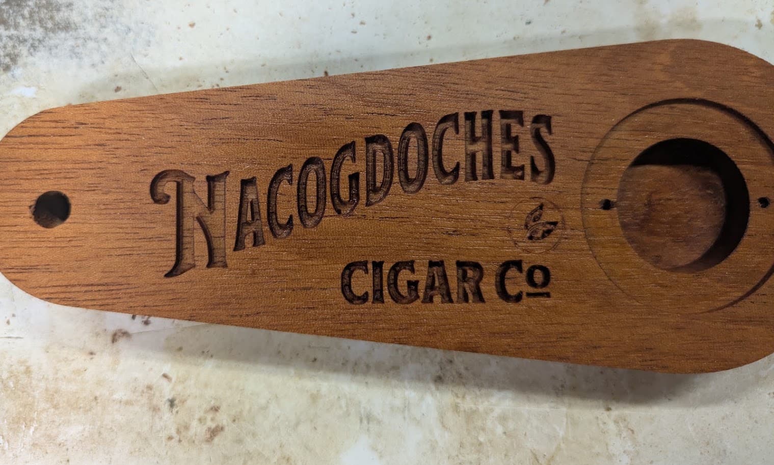

Today I was looking for a logo to put on some bottle openers. I had made a plaque for this company before and had their logo. I did not want all of the logo just the text. I converted the .jpg to .svg and it looked horrible. So I searched the internet for the company and found the same logo but of higher quality. After converting it I just deleted the parts I did not want. The logo was too complicated for the advance vcarve I did.
Here is the converted logo:
nac_cigar_logo_simple

Here is the bottle opener with the partial logo…
