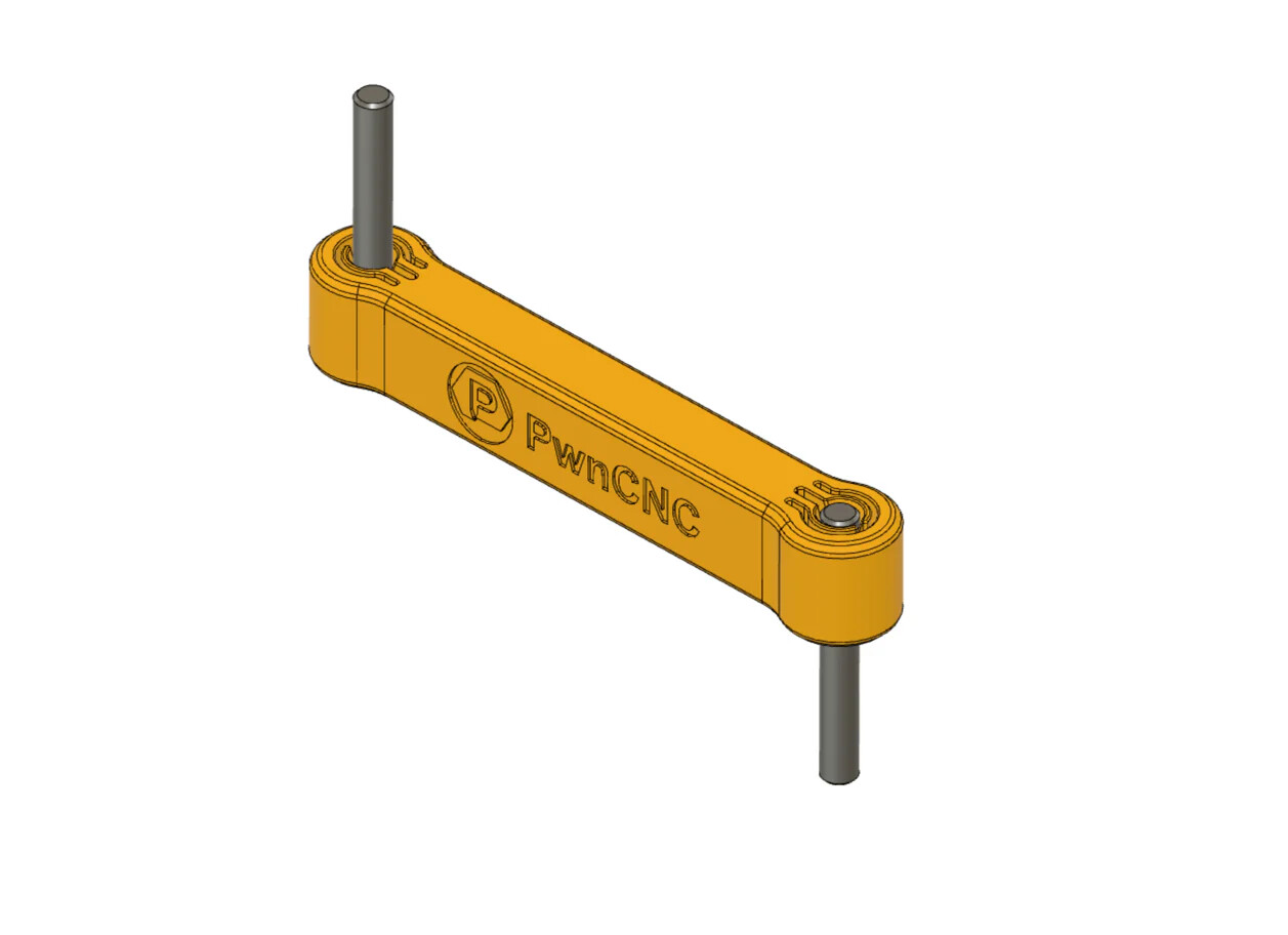

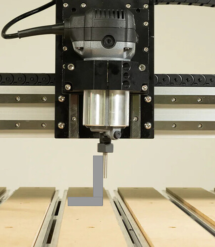

How close are you looking to get? I think you can get it within 0.002" (0.05mm) or better with a drill blank & a master square.

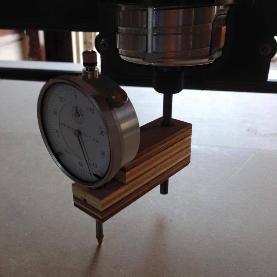

If you’re looking for more accuaracy, a tramming arm or an arm with a dial indicator is common
Super-accurate, first I align the spindle with the Z-axis, then tram the entire Z carriage to the table, rather than just the motor mount.
