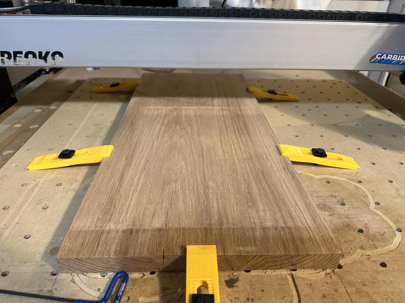

Could you post your .c2d file, step-by-step notes on how you are securing your stock and setting zero relative to it and managing all tool changes and a photo showing an attempt at cutting still in place on the machine with the machine at the zero or a specified offset from that position?

Sorry for the delay. Had made a video of the process and was having an issue getting from my phone to pc. Initially I used bit zero to set xy and z. Then I re-set z zero (paper method) after surfacing to run my file. I re-checked x,y. and z, and they were good. Ran the file (see video)

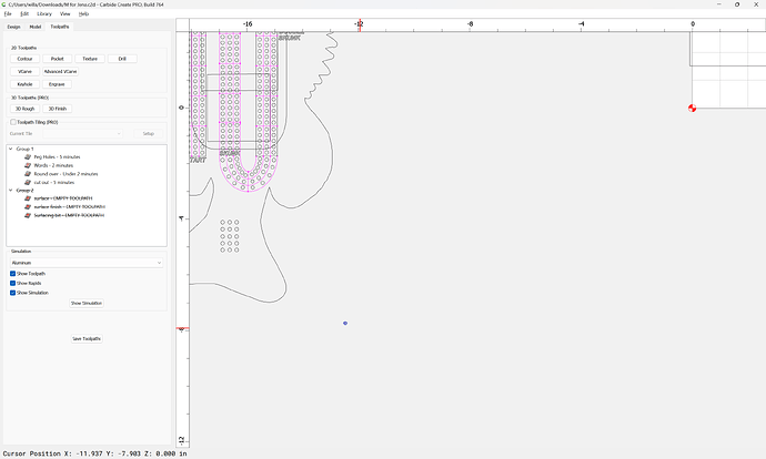

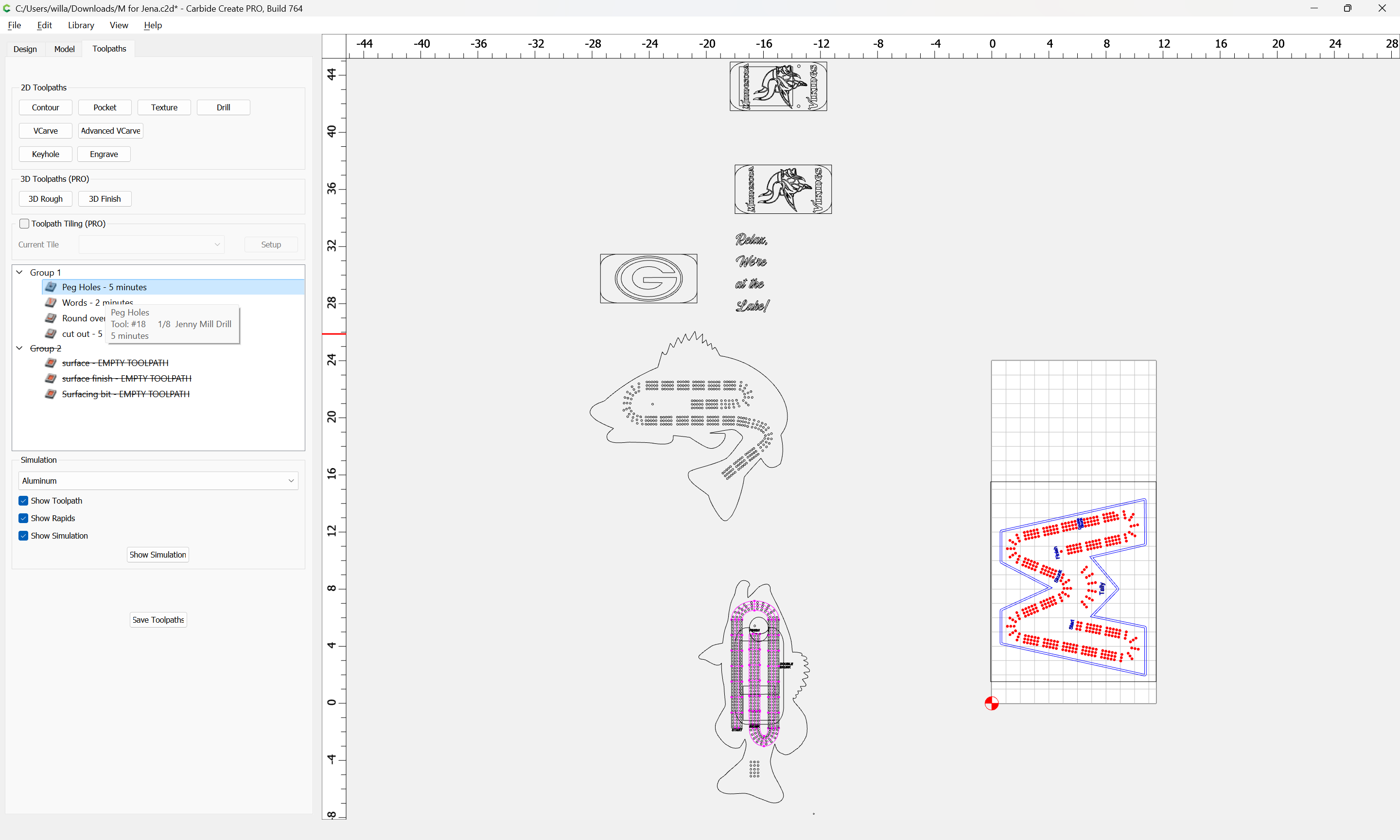

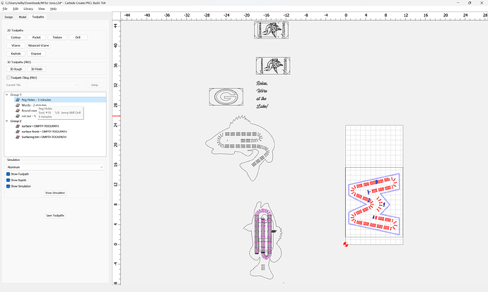

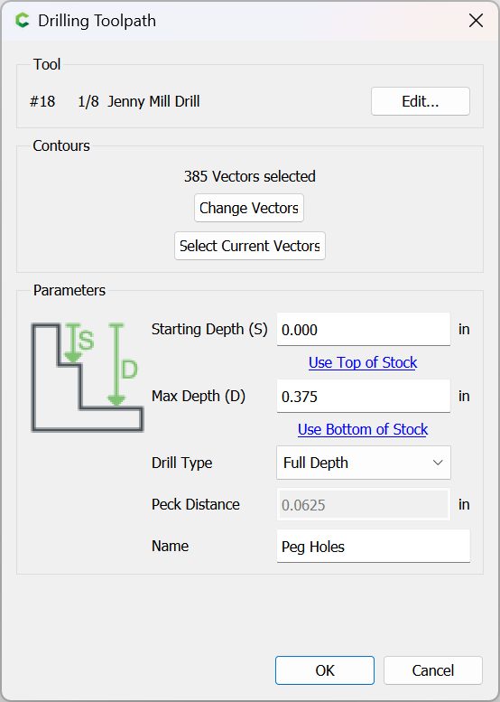

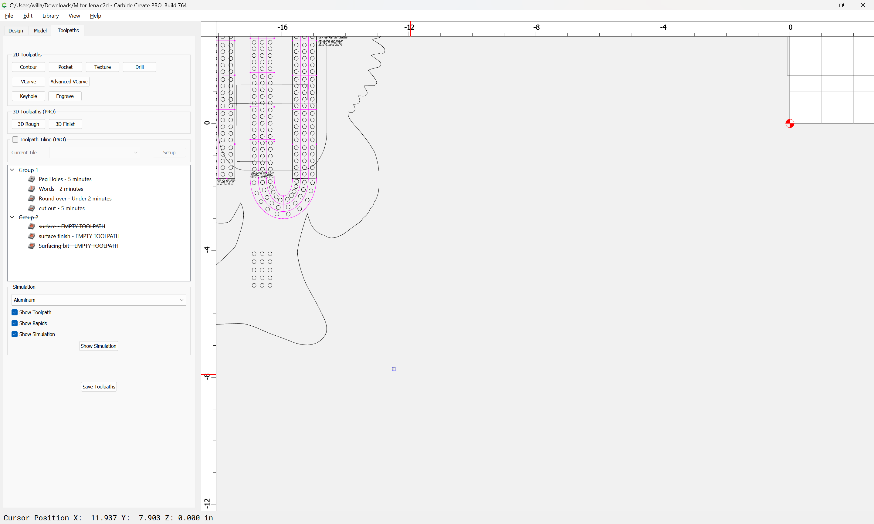

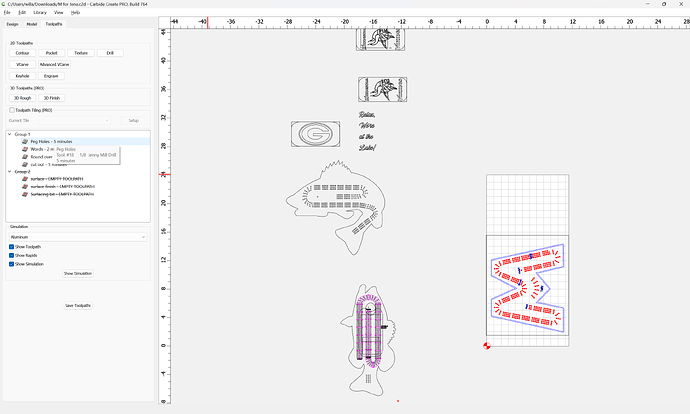

The problem is you have an extra hole associated with the Peg Holes toolpath:

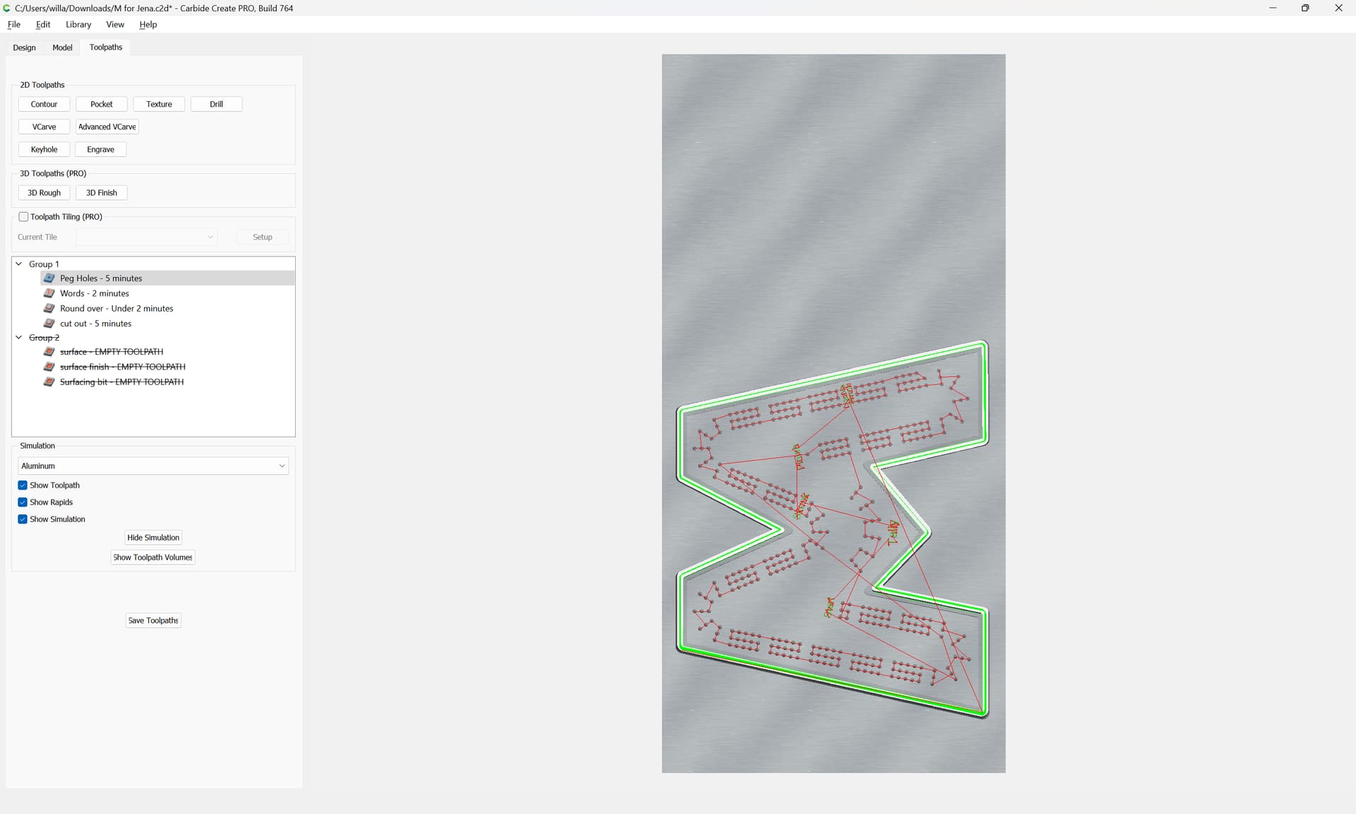

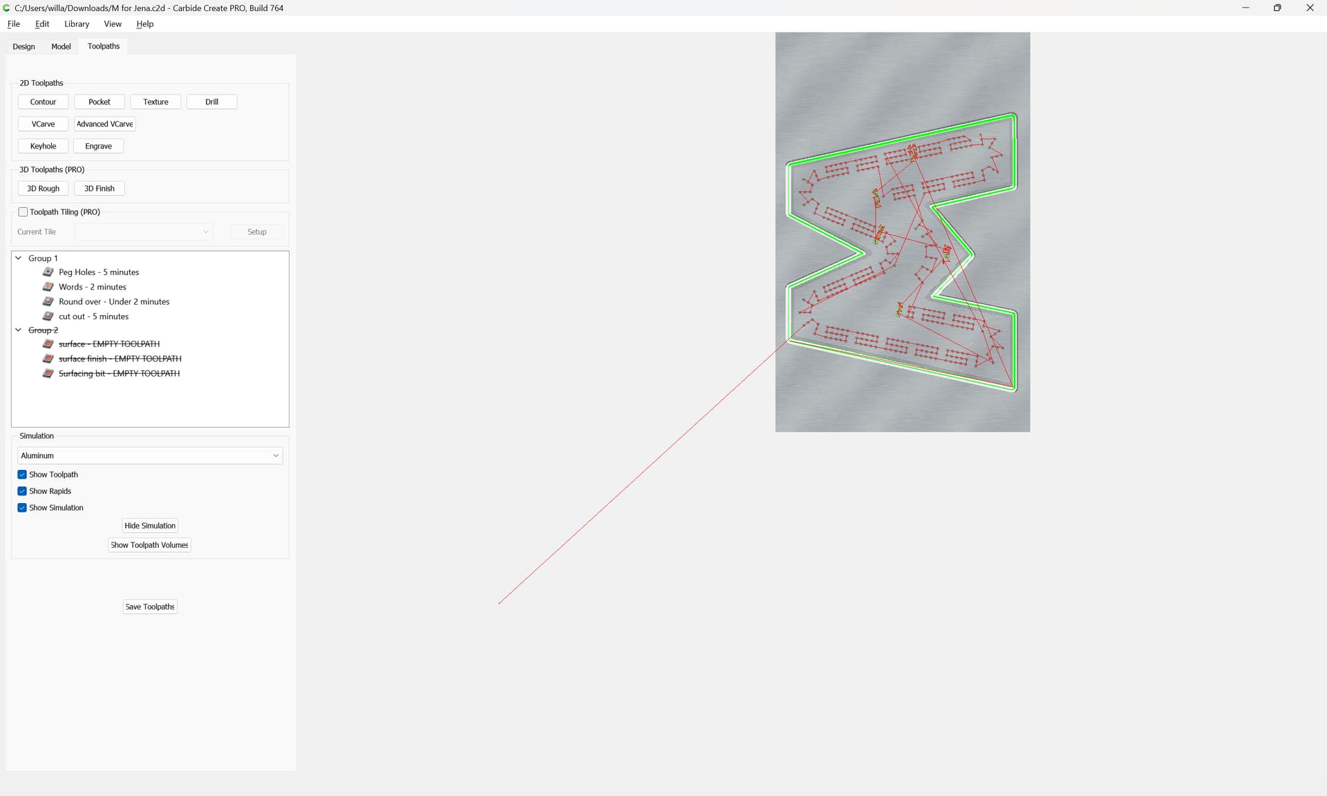

You can see this in the 3D Preview if you Show Rapids:

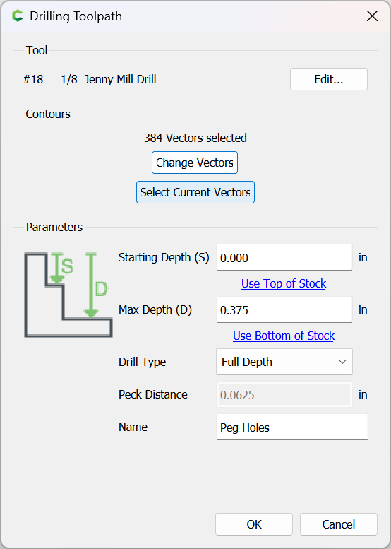

If you delete that geometry, or remove it from being associated with the toolpath:
Then the machine won’t try to cut that:
OMG thank you. This was driving me crazy! And something I would never have thought of. Thanks again!
Edit: that stray fella apparently was left behind… found its proper spot and corrected. :slight_smile:
