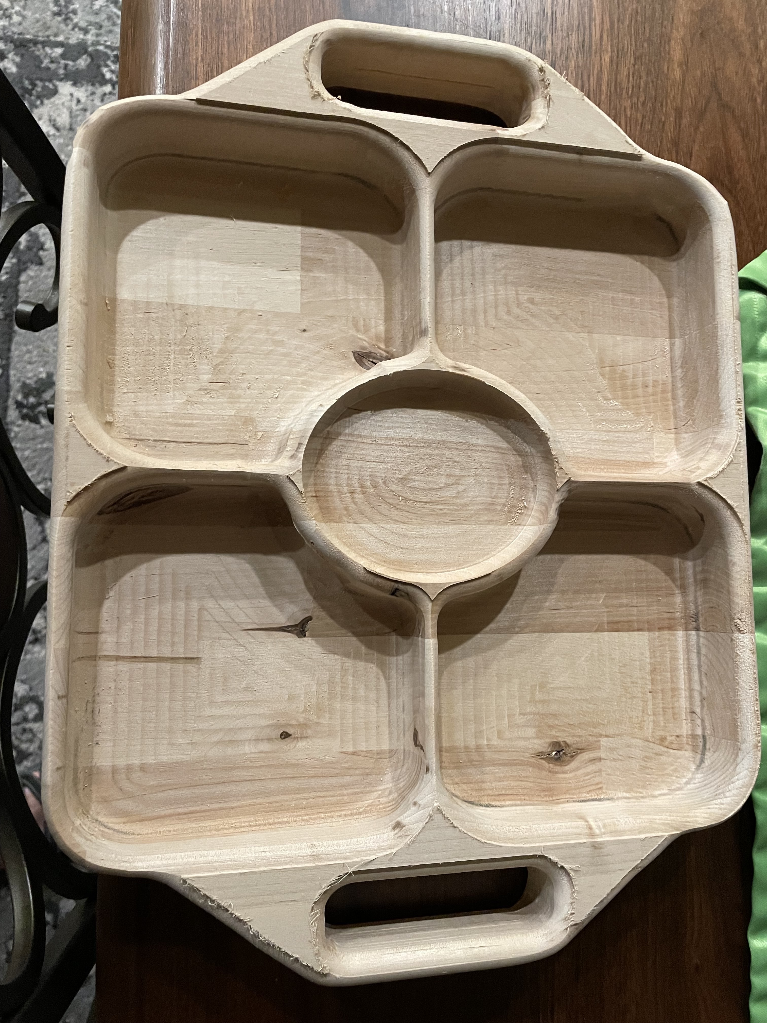

I got my first tray completed. After resolving the depth plunge issue the only residual issue is that the router overheats (I’m guessing) and shits off after about 15 minutes
Your tray turned out well! I would suggest maybe a finishing pass with a tighter step-over to clean up the bottom of the pockets and save some sanding time. Glad to hear the retract height was the issue.
