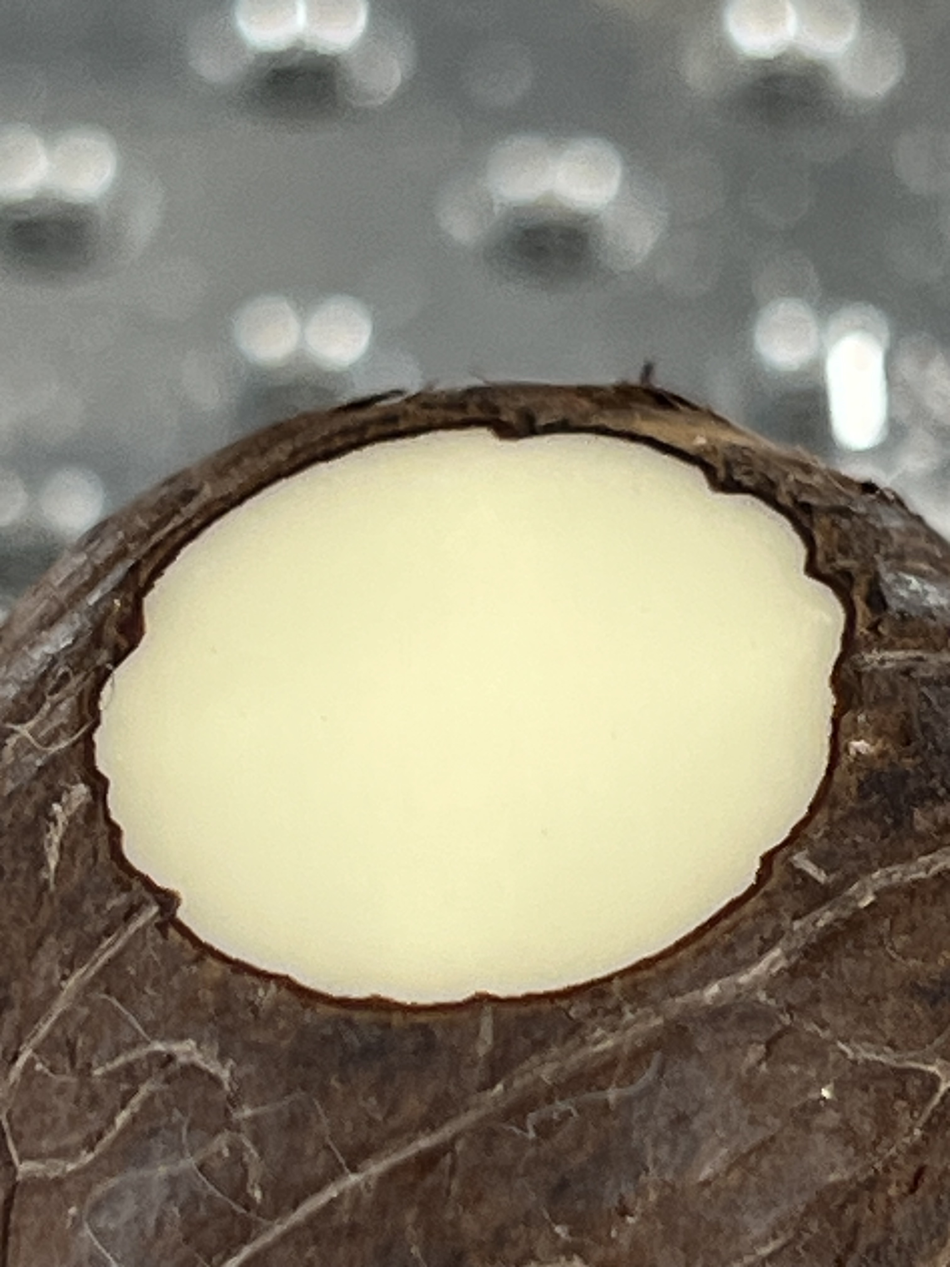

Today I want to mill some vegetable ivory.
Any recommendations on where to start in terms of feeds/speeds? I’m thinking treating it like delrin or a hard wood might be a fine jumping off point :man_shrugging:

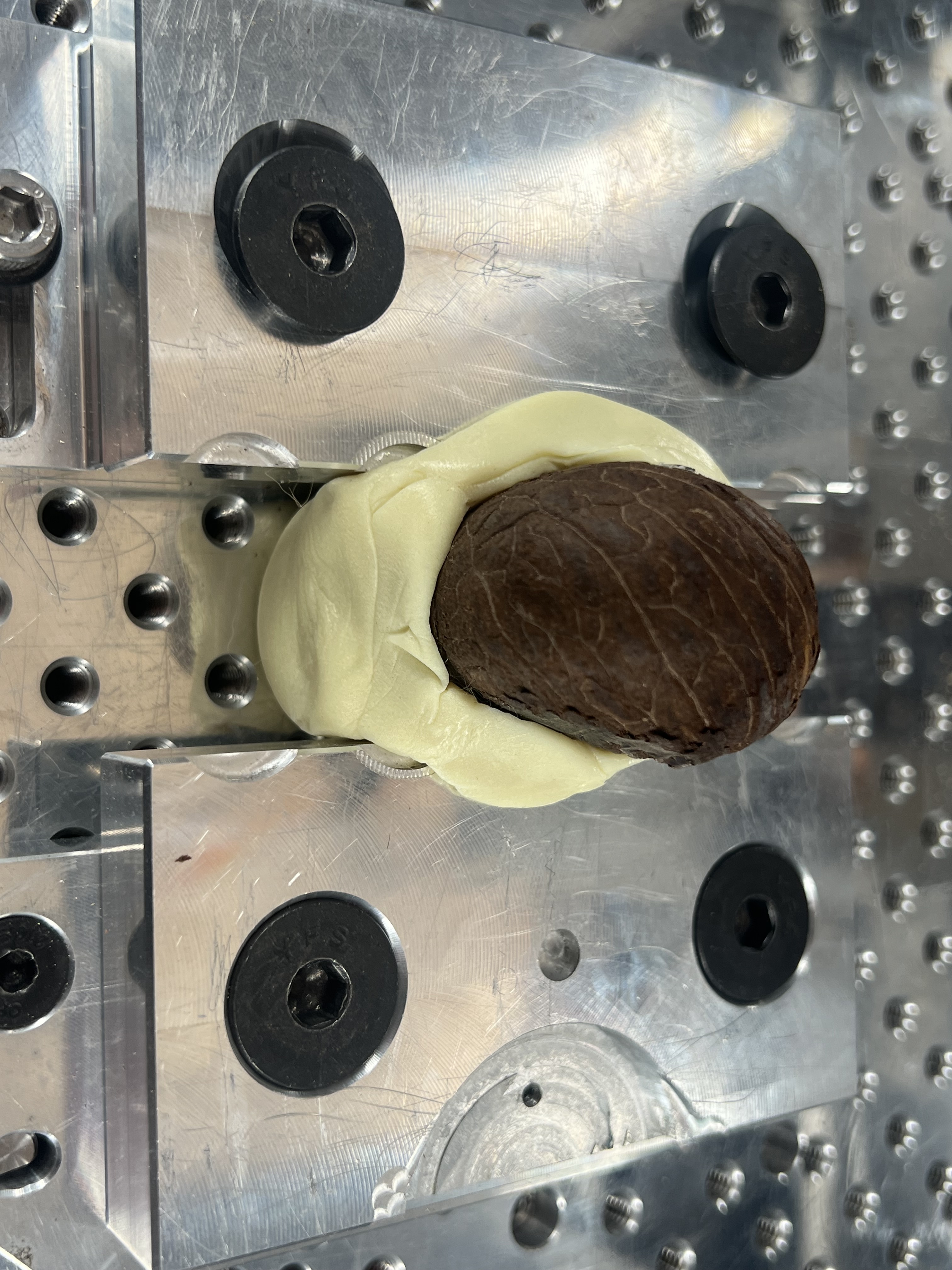

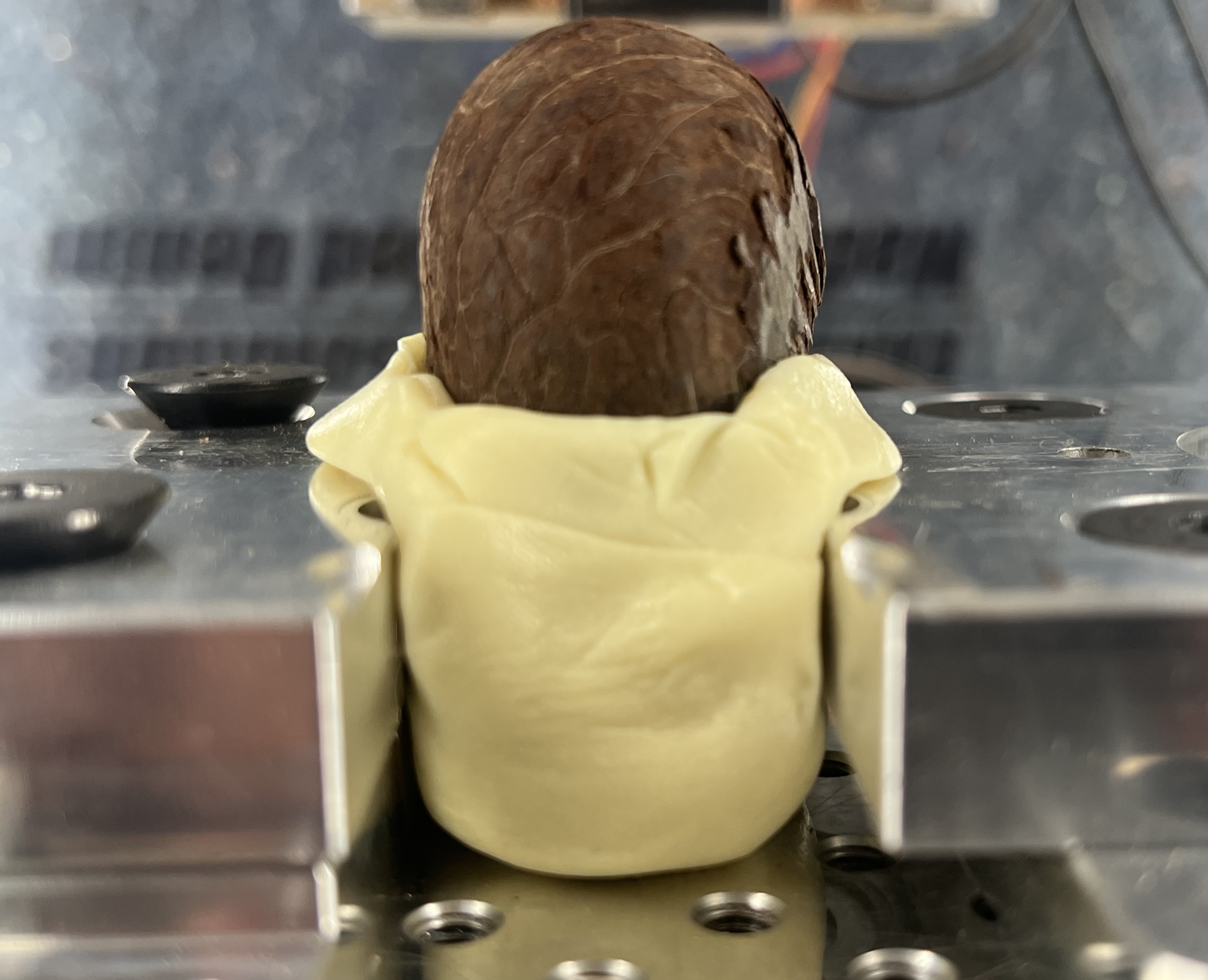

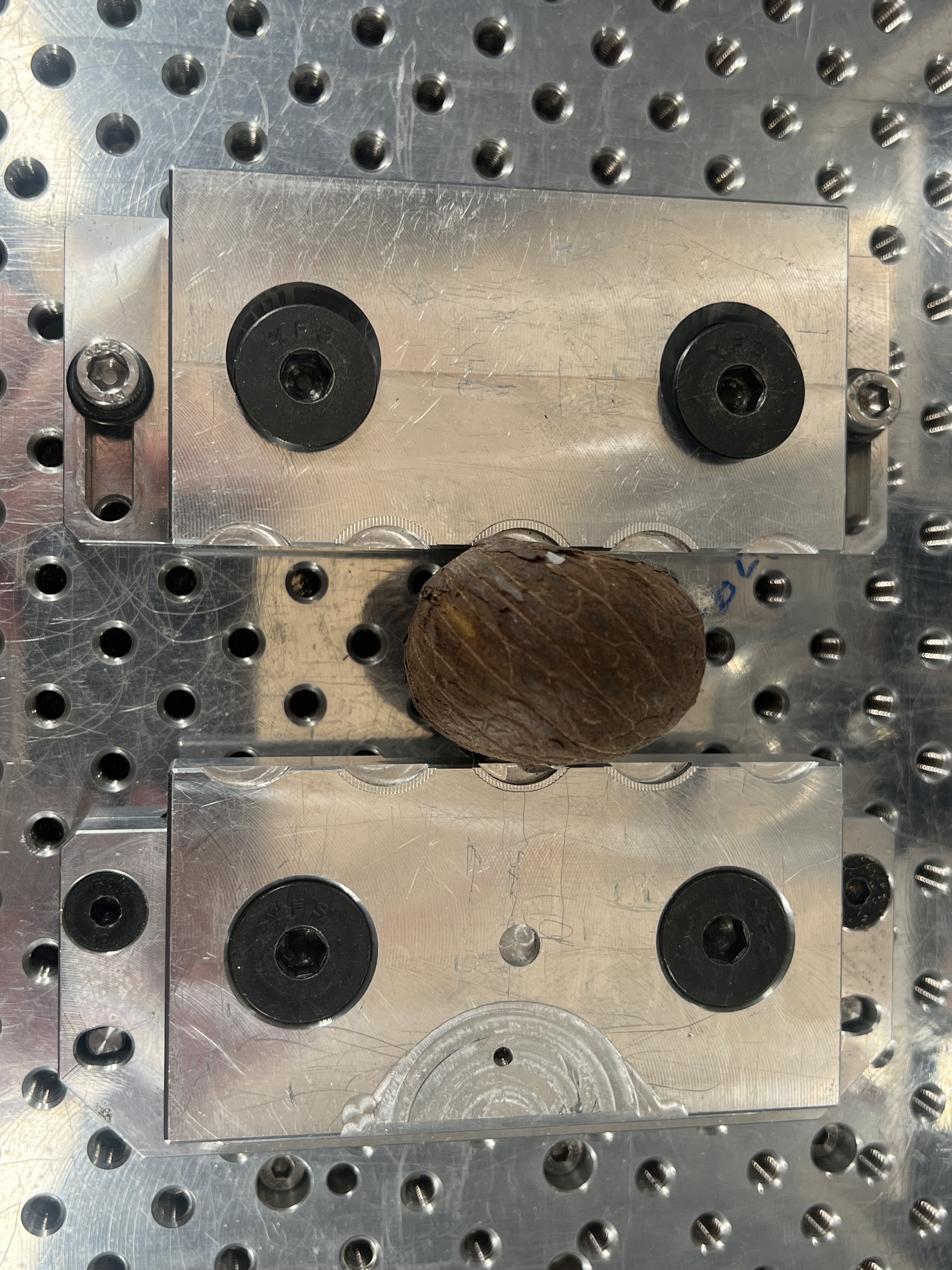

Workholding should be fun, I’ve got some “Jett Sett Ballistic” to try. It is a thermoplastic with a working temp around 170f
Jett Sett basic is slightly pliable when fully cooled but the “ballistic” variant is Kevlar reinforced to give it some exceptional rigidity.
If it seems to work well, I’ll likely make some custom soft jaws with a thick layer of the stuff. Heat it up, close the jaws around the object, let it cool, give it a little extra torque. Should make for some awesome “instant” soft jaws that will be perfect for holding organic shapes…that’s the plan anyway.

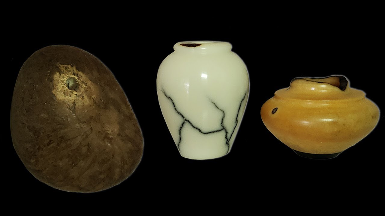

I’ve turned tagua on a lathe and didn’t really notice anything unusual about it. It cut well and sanded and finished easily. Never tried it on the CNC, but it makes a great inlay material. I’d probably bandsaw it into slices and then glue it down for milling treating it like a dense hardwood.

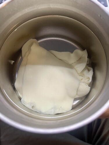

Ok the Jett sett ballistic is a crazy cool material. It does harden to an exceptionally rigid form.
Fun fact, I’m pretty sure I had an entire mask of this stuff to keep my head stationary during radiation therapy. It’s laid out in a thin mesh and formed around the person in-situ then outfitted with clamps to keep things fully constrained and highly repeatable.
(So…the exact same application I am using for this nut. Wonder where I got the idea :stuck_out_tongue_winking_eye: )

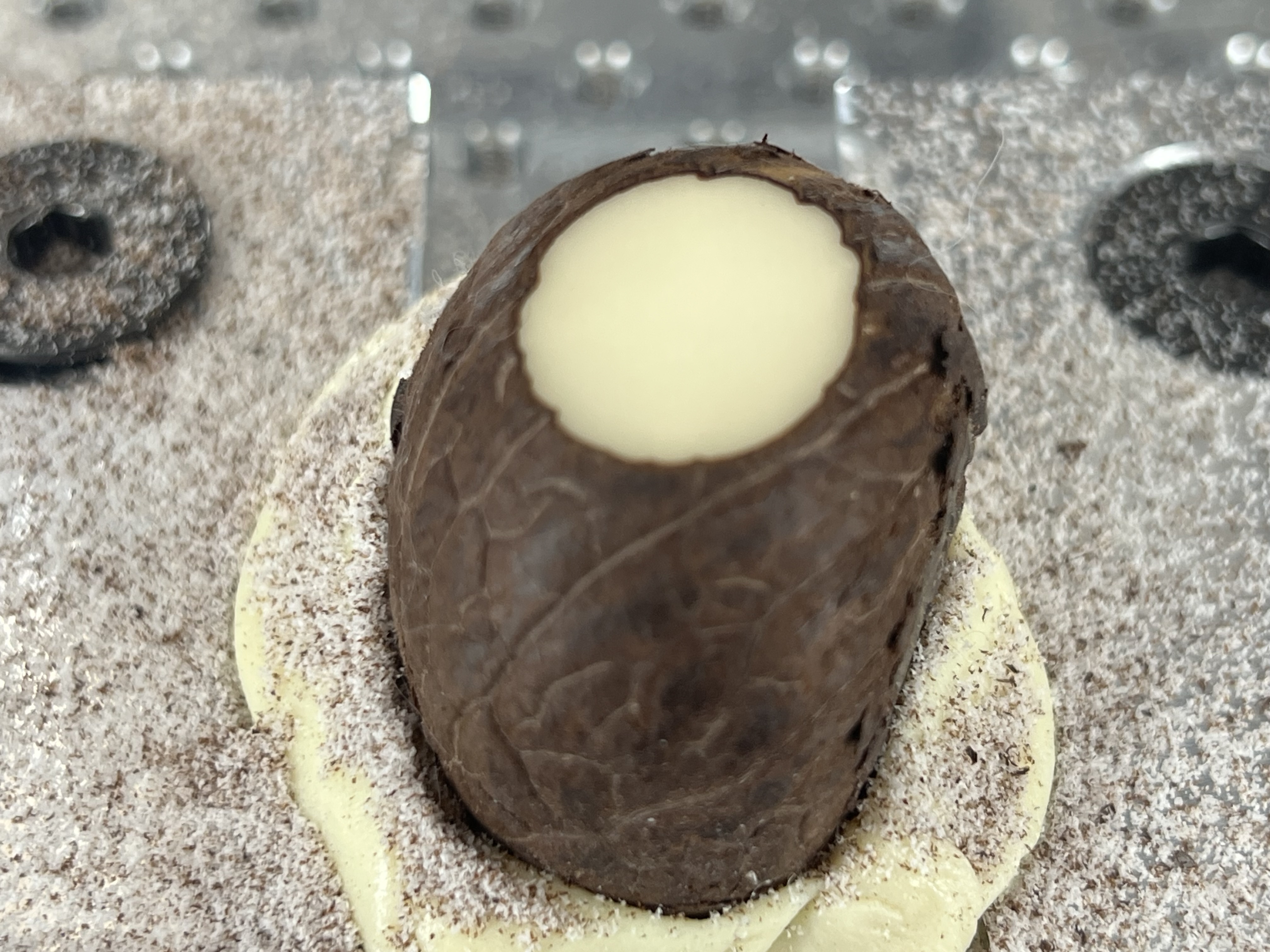

I’ve just got this all ready to go. I am going to flatten it in a few stepdowns, then do a3d carve on that plane. Then I can release the entire nut and slice off the 3d bit.
At that point it might make sense to just super glue the rest of the material instead of bothering with the thermoplastic…we’ll see.

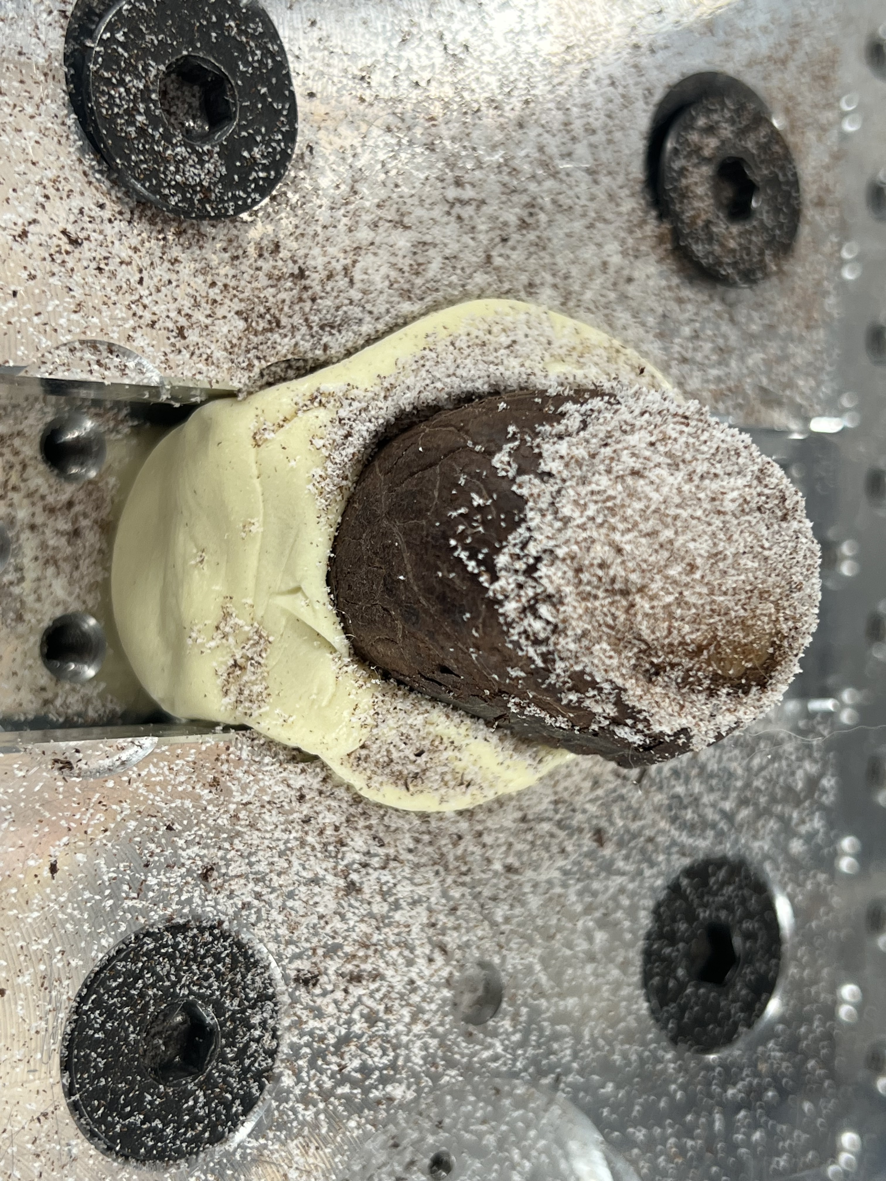

Mills beautifully, the work holding is rock solid, my wife wants little ivory bee zipper pulls for all of her dresses…so apparently I’ll be getting good with this stuff.

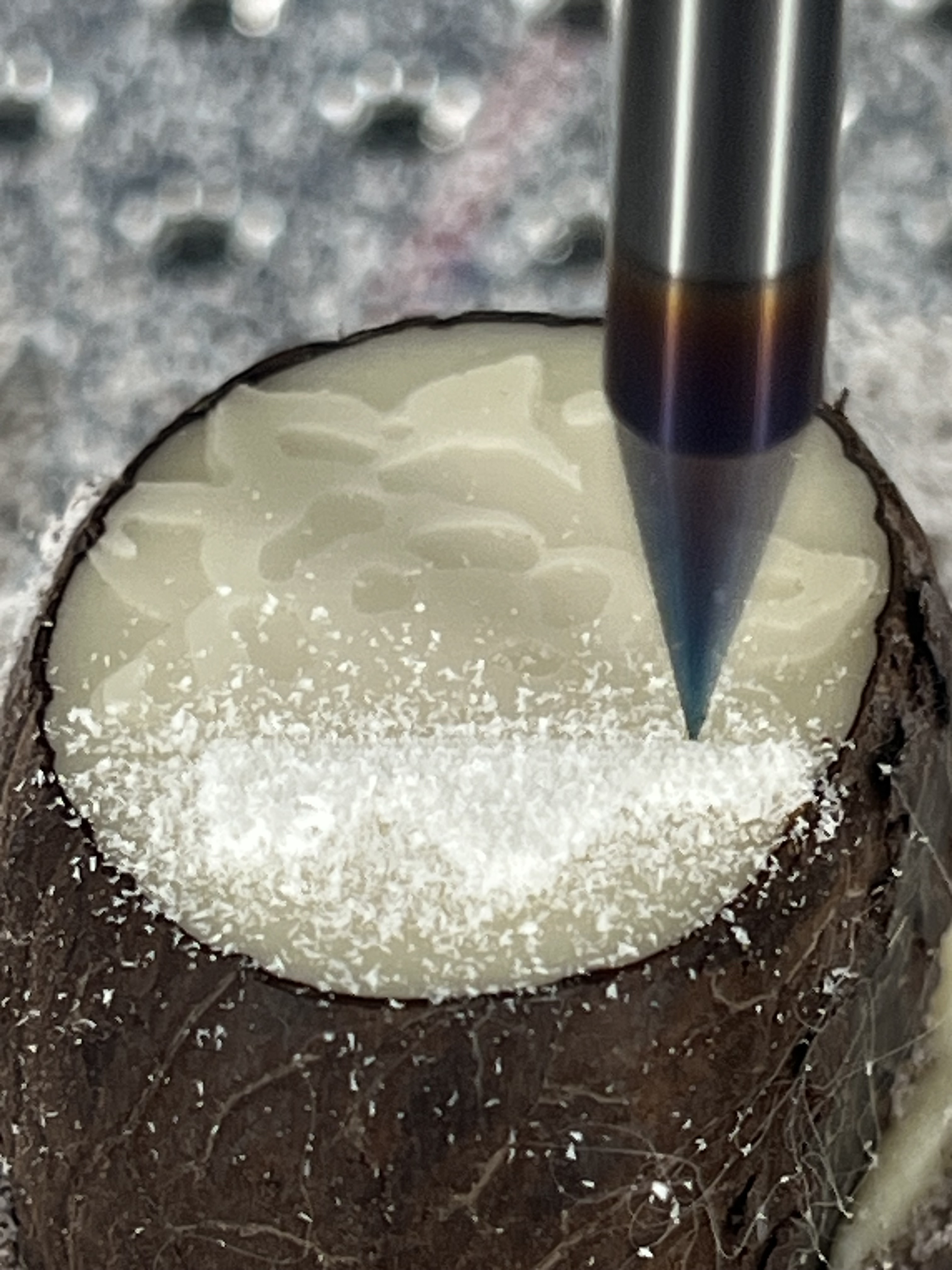

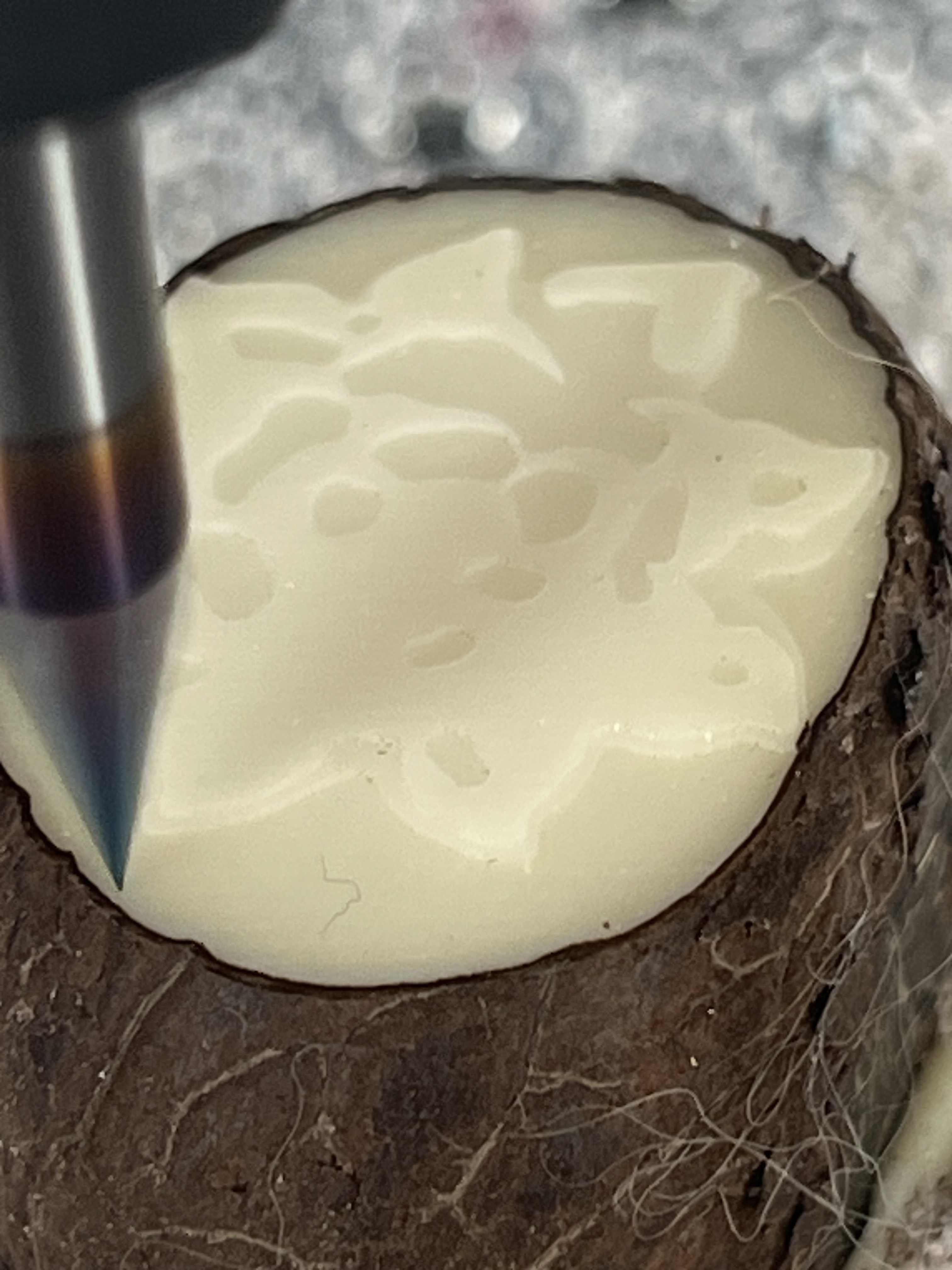

Another quick update: traditional square endmills seem to cut much more cleanly than v bit. Though I suppose that shouldn’t be a surprise.
I’ll be getting some really small ball nose endmills to see how they compare and how much detail I can get without post processing as a result.
Roughing was done with a 1mm two flute and left exceptionally clean cuts

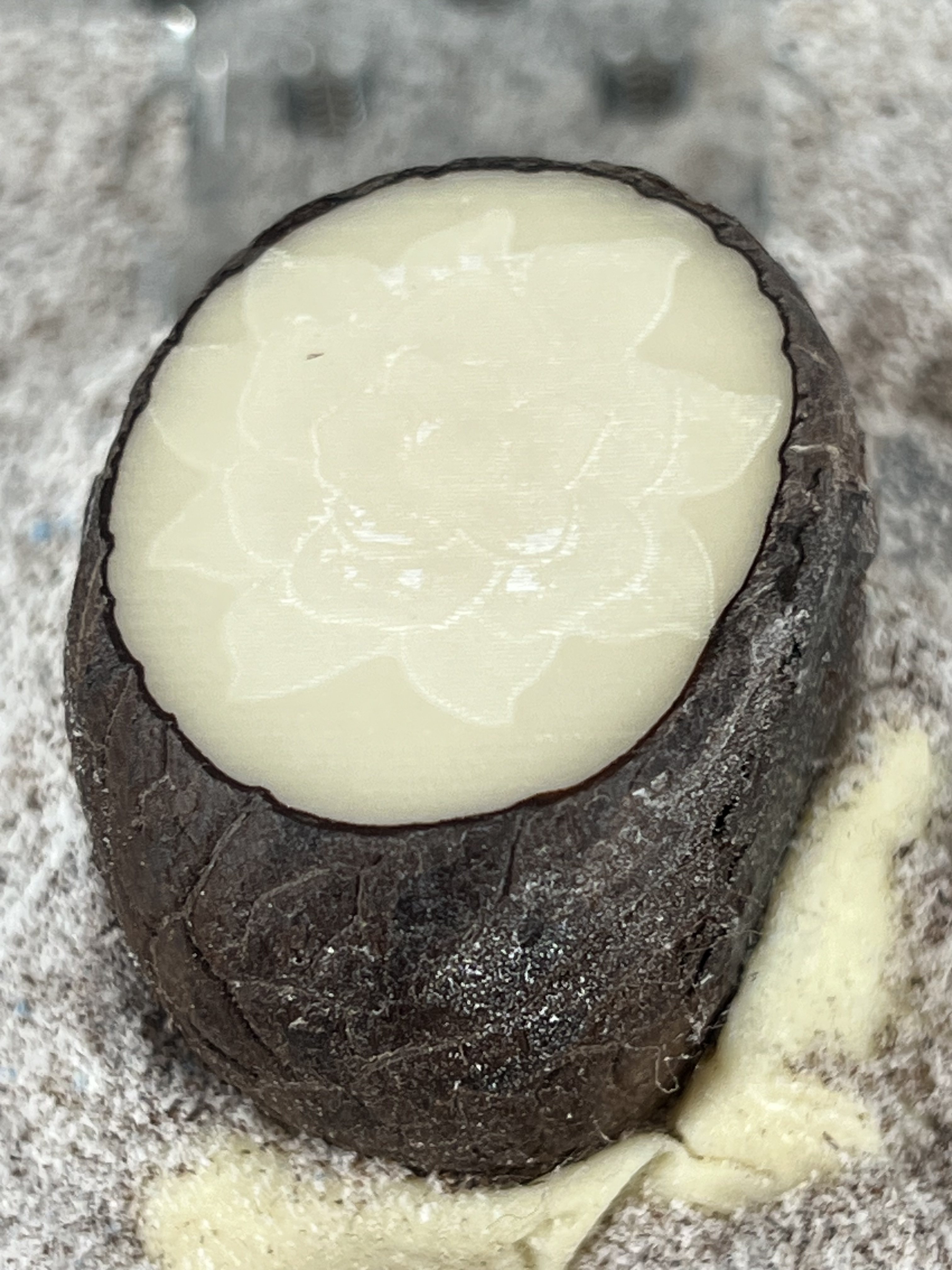

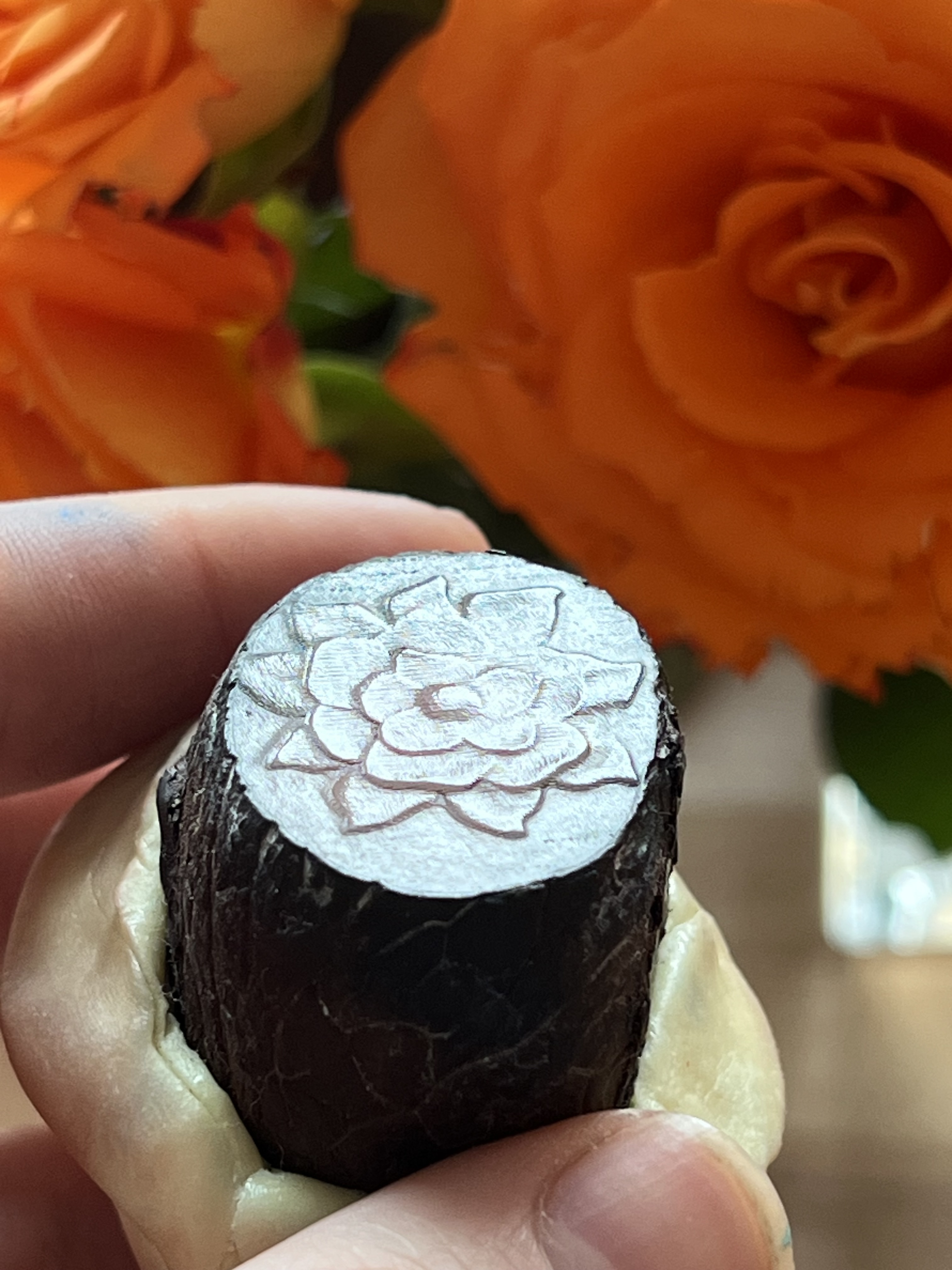

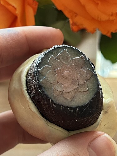

Then finishing was done with a v-bit of .005in tip diameter. This was pretty ugly and rough without post processing. Though most of it came out pretty clean after something like a firm nylon brush broke away all the fuzzies.
Little bit of clean up

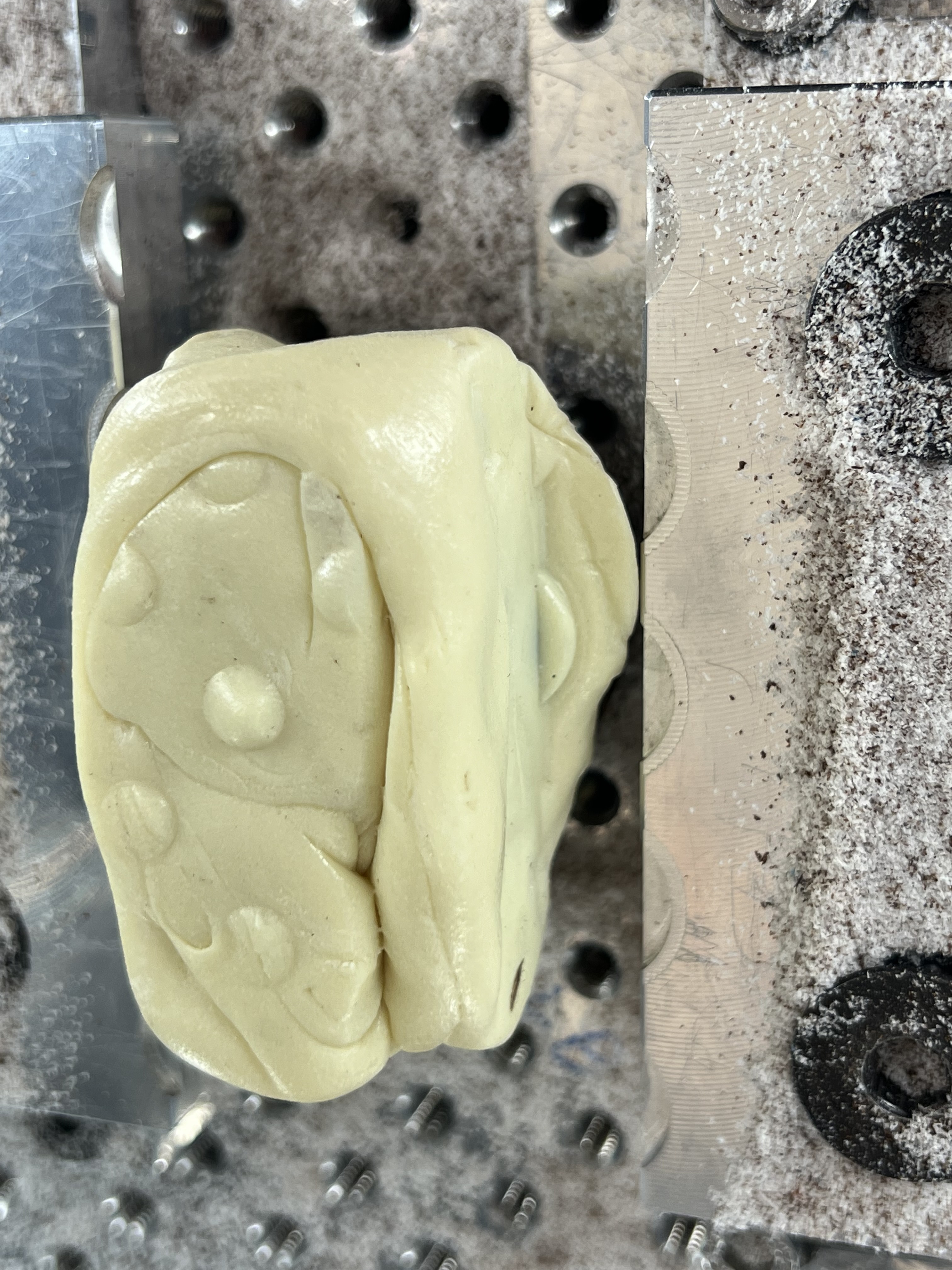

Cool thing about this work holding is that it should be pretty darn repeatable even when fully removed and reinserted. The many different geometries picked up by the Jett sett should give it an awful lot to locate on. (Bottom side of plastic holder)

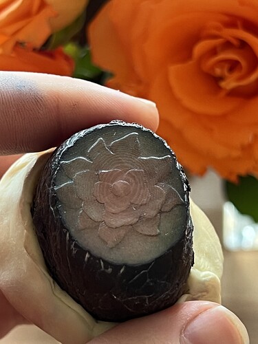

I am truly awful when it comes to dye. I figured I might as well see if alcohol inks do anything interesting…I think there’s something here with some discipline and practice.
And if you hit the light right, you can see what I’m assuming are the equivalent of wood rings which is neat:
