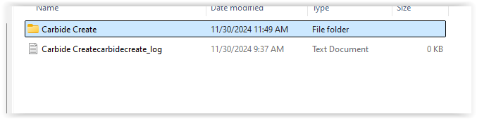

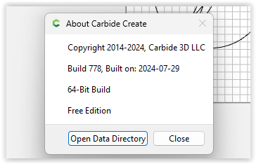

Do “About” (in Windows it’s Help | About, Mac OS Carbide Create | About) then click on the “Open Data Directory” button and go into the Carbide Create directory thus revealed and delete the license.txt file, then restart Carbide Create.
There is no license file.
