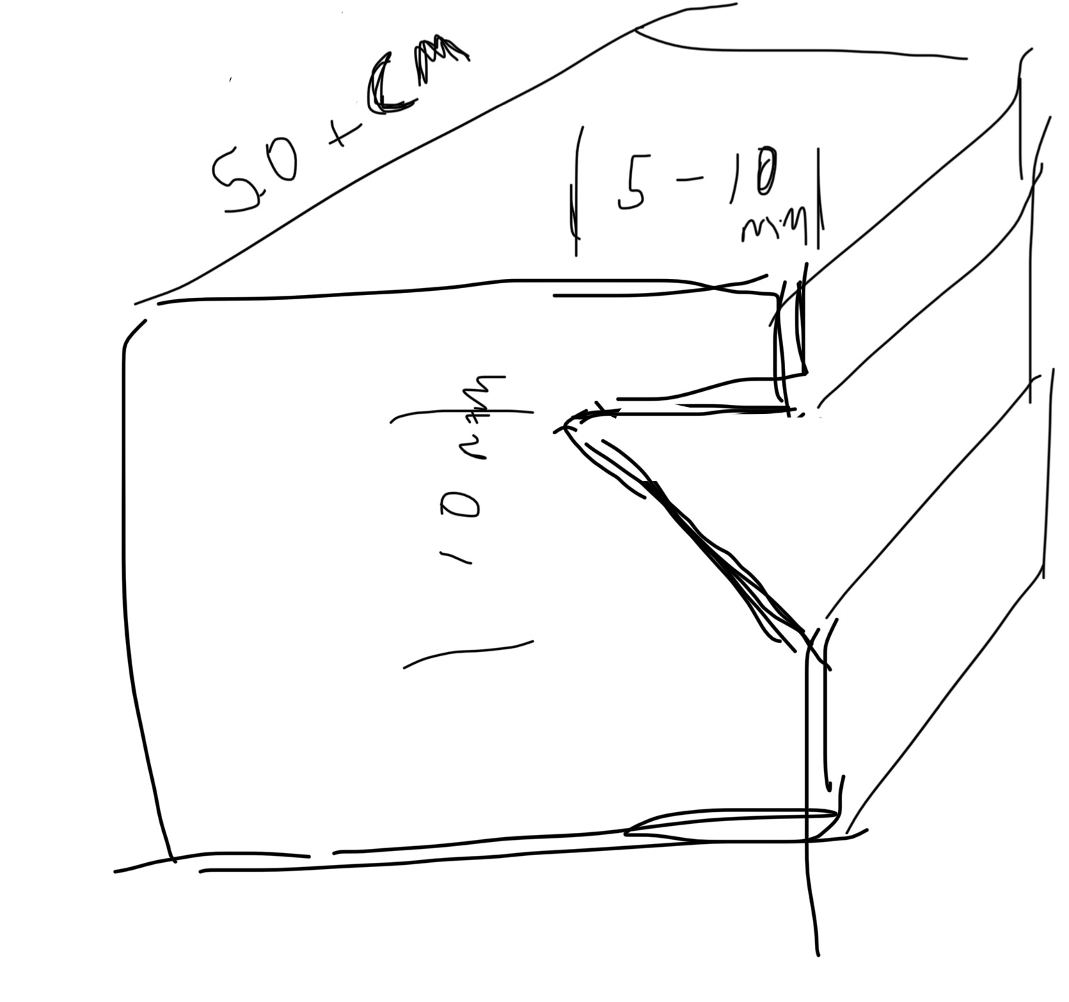

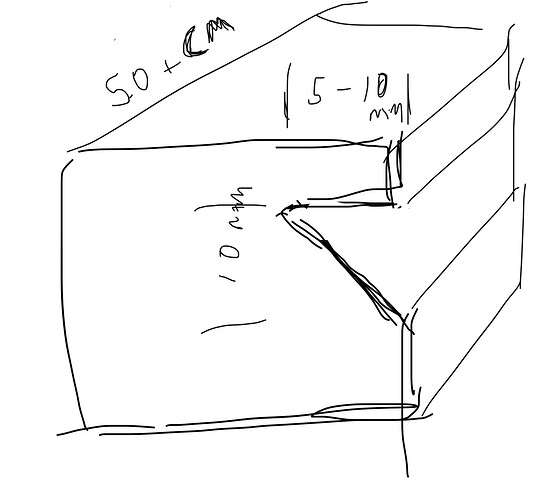

Triangular slot cutting

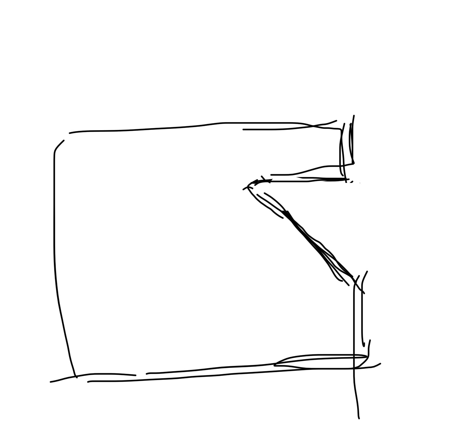

Trying to cut a triangular slot like picture
Is there a type of champher bit or something I can move into the cut over several passes? I just can’t find a bit that says it will cut this profile. Just need 5-10 mm deep.
In wood…

How long does this need to be?
In what material?
Does it need to move in, then out? Or is it a straight cut?
Could you annotate your drawing with dimensions?

For less exotic tooling, if you can rotate your part you could do this in two setups. The first being a slot, essentially providing relief for the second operation.
Second up would be tilting the workpiece and finishing the cut with a chamfering bit or something similar.
There’s also a question of how accurate to the profile it has to be. If the angle could terminate in a square or ball profile instead of a sharp corner, you could just use bog standard tooling and step mill the angled plane.

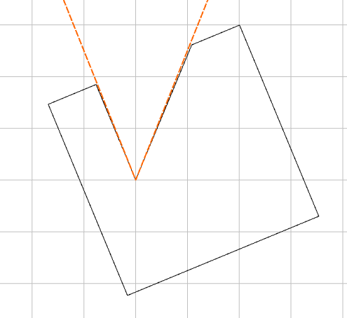

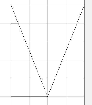

if you rotate this work and hold it 112.5 degrees anti clockwise from how it is drawn above, you can use a regular vee cutter. These are readily available with a 45 degree angle.
I’m liking Jason’s idea. No new tools, only a bit more complicated setup.

thats kinda my idea. sliding it in .05 inch at a time…
Angling the stock to use a matching angle cutter is a really good idea. it would also make it much easier to approach in passes lowering z and measuring if the width and depth of the slot are critical.
To potentially make the cut sideways with a typical 45deg cutter (90deg included angle), it would need to also have a cutting edge on the top edge. Otherwise, it’s like trying to cut half a T-Slot on an edge sideways with a McFly. It can probably be done but not ideal.
Whichever bit is used, the angle will also determine the other geometry. If you want a 45 degree angle cut 10mm tall at its widest, it will also be 10 mm across the width because the 45deg triangle is half of a square.

Just to circle back. I’ve cut a bunch of angled blocks on the Table saw, and used them as jigs to set the project in on the Shapeoko table. so this is definitely the way to go.
There is a lot more “jig making” on the shapeoko than i thought I would be doing, but in the end it can do some stuff that the rest of the tools in the shop can’t. Thanks everyone for the excelent ideas.
