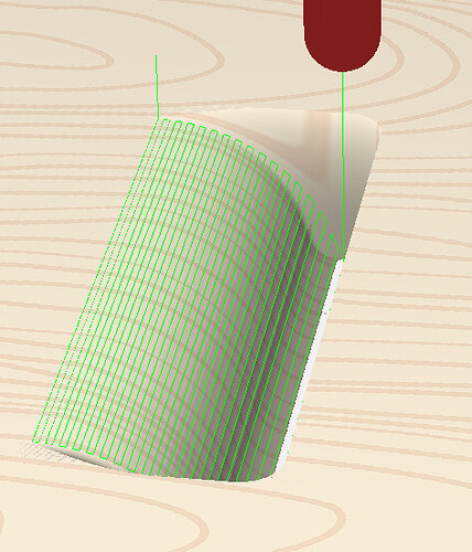

Model it like this
Rough it with a 1/8" end mill. Depth per cut about 0.010"
Finish with a 1/8" ball mill, stepover less than 0.010"
The ball mill won’t go past the bottom of the workpiece, so to clean up that bottom edge make the workpiece 1/16" taller than needed, and add a 1/16" base to the model.
