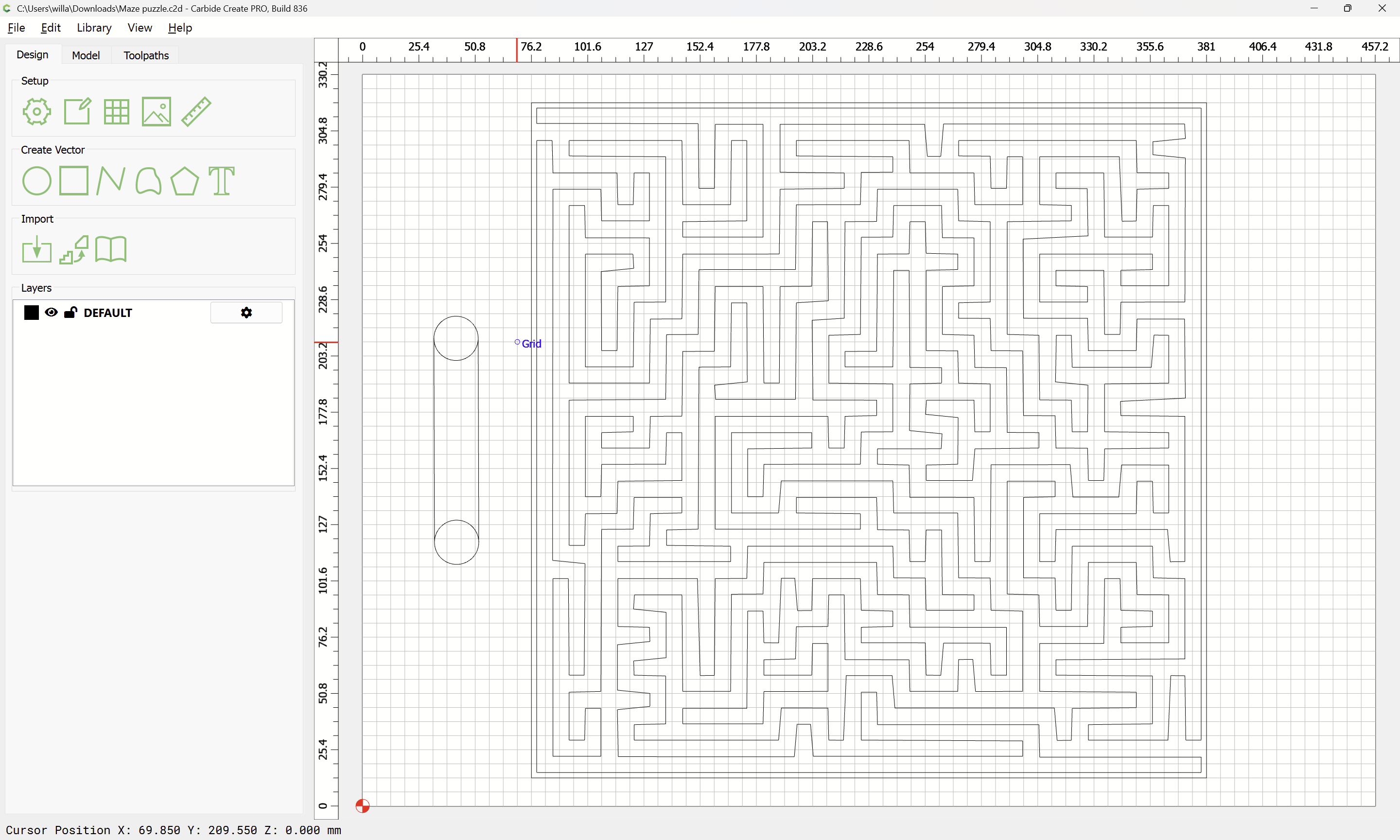

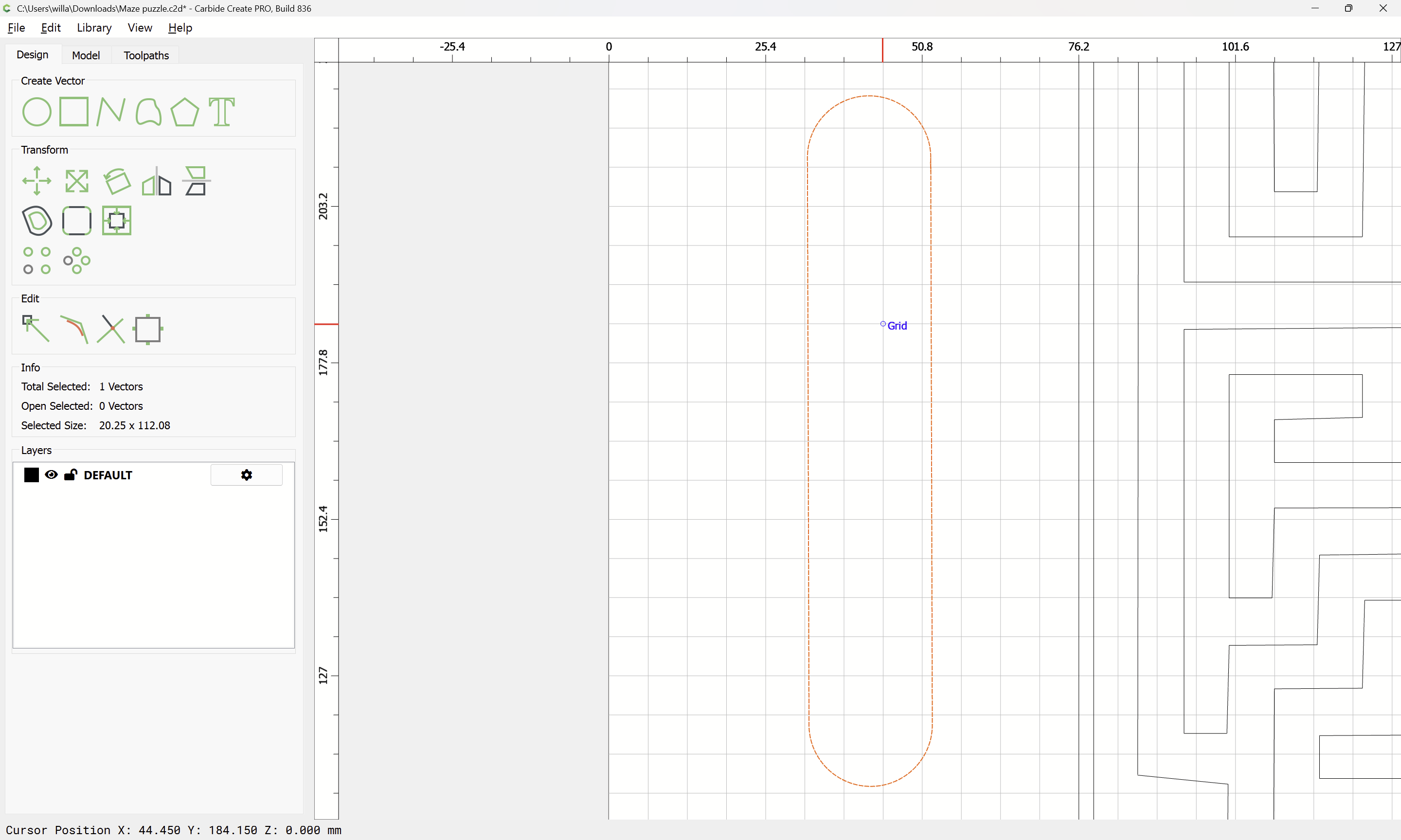

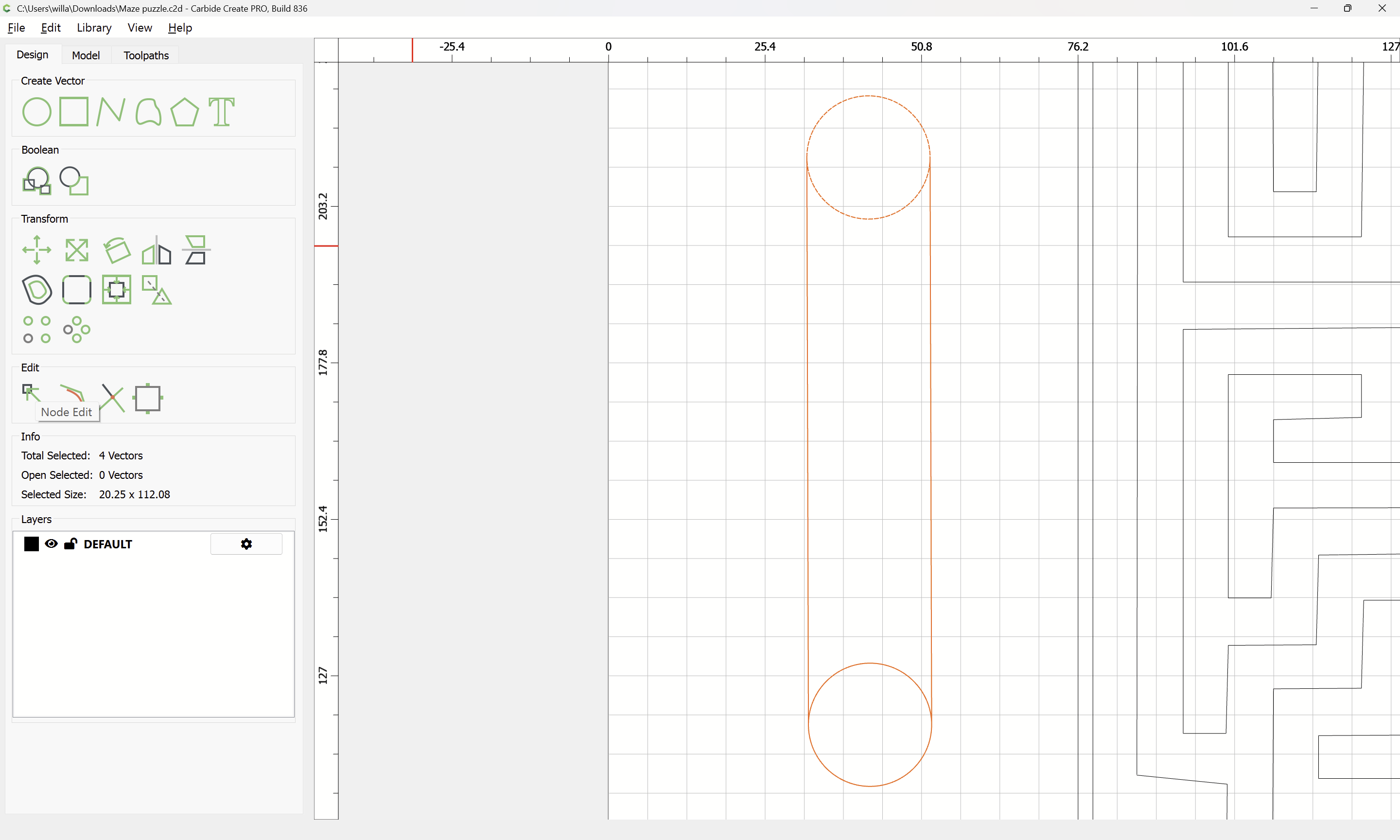

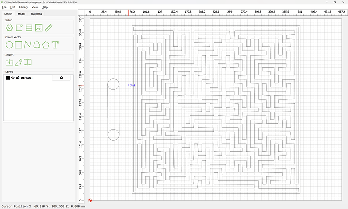

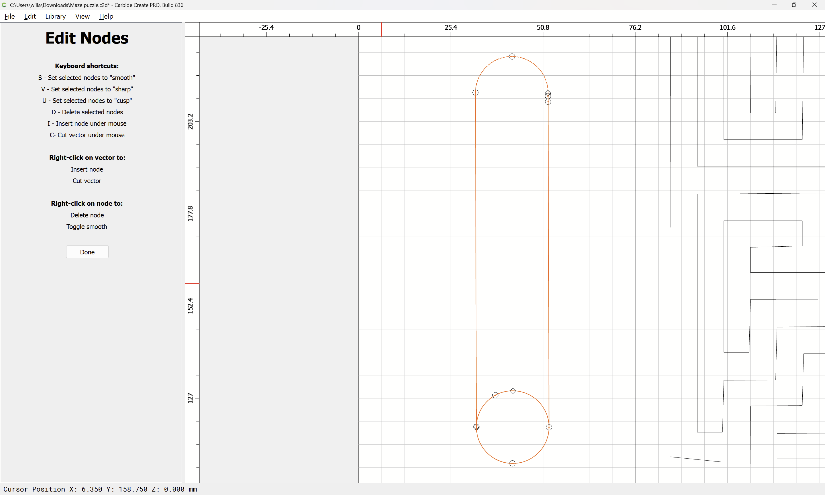

I am attempting to create a cut through handle(s). I thought I could just create a couple of circles, draw lines to join the tangent of each circle, join vectors and then trim the parts of the circle that I do not want. I guess it is easier said than done. I can’t seem to get the sections that I want to trim correctly so I am raising my hand for some help. File is attached. I want to trim the semicircles that are on the ‘inside’ of the handle. Thanks in advance.
Maze puzzle.c2d (128 KB)

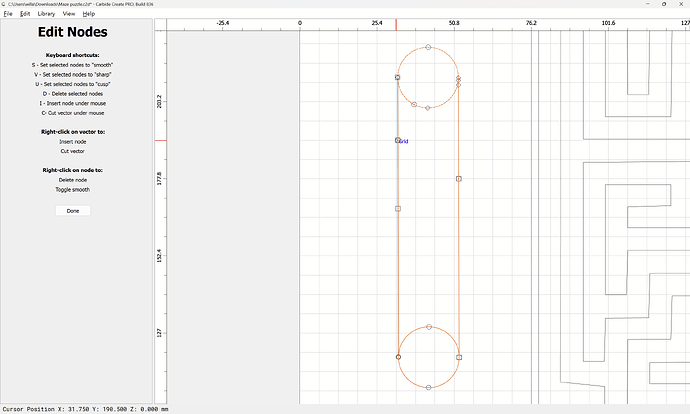

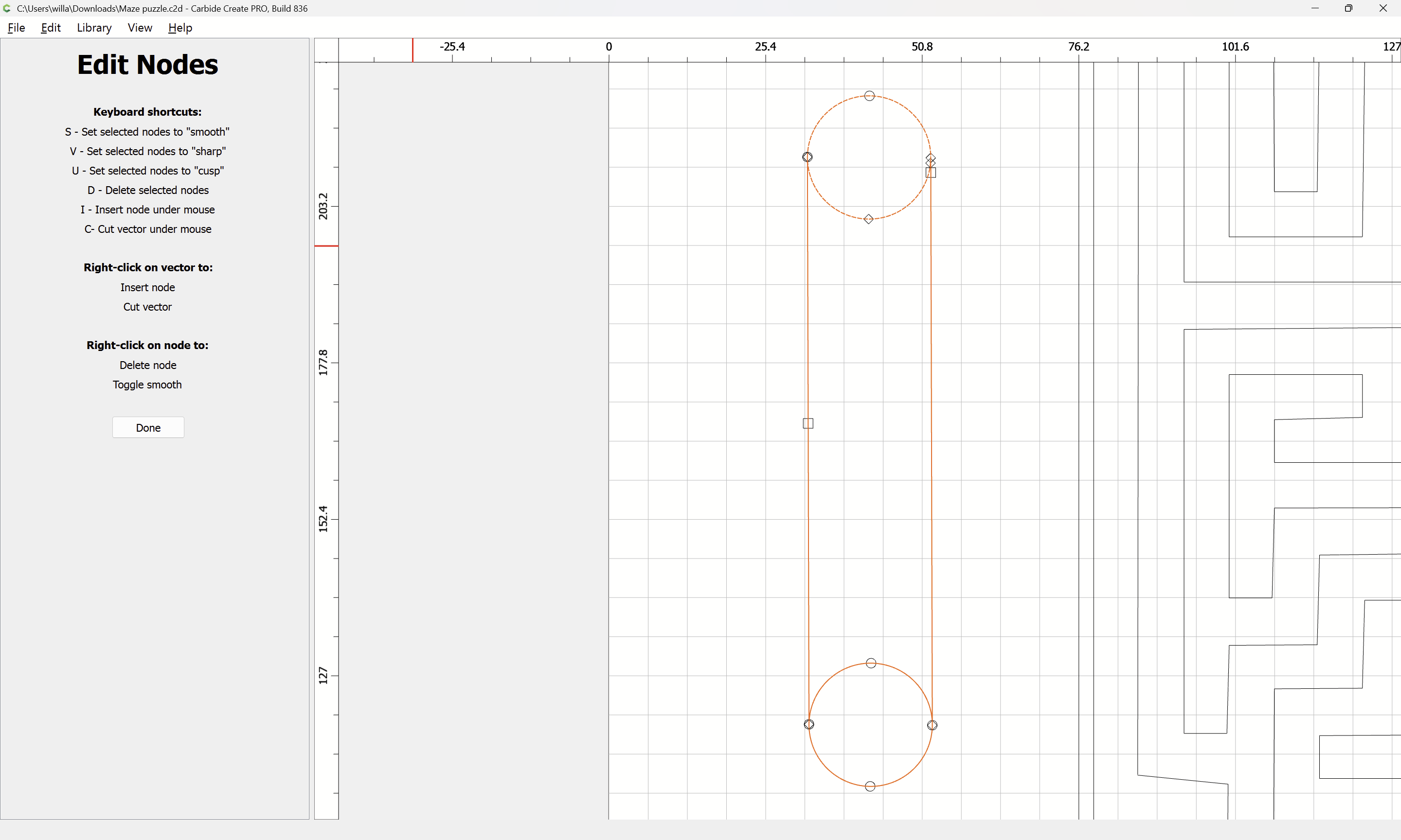

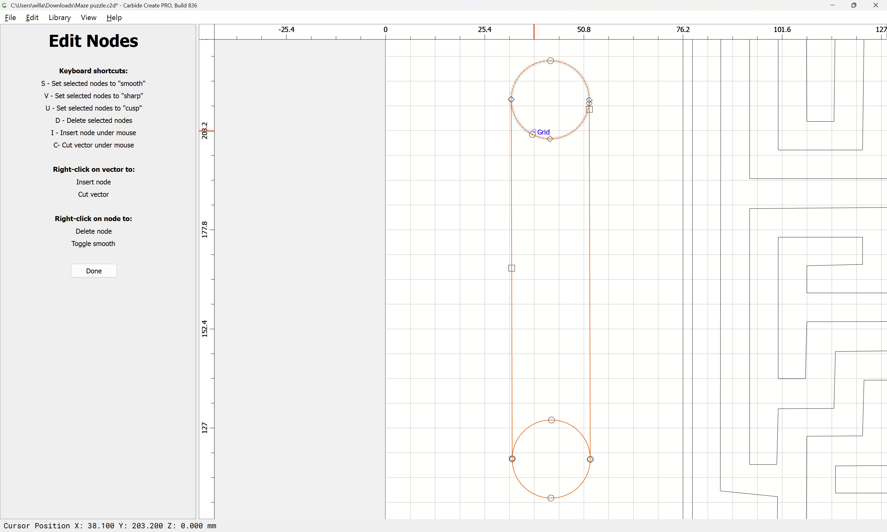

Given your file:

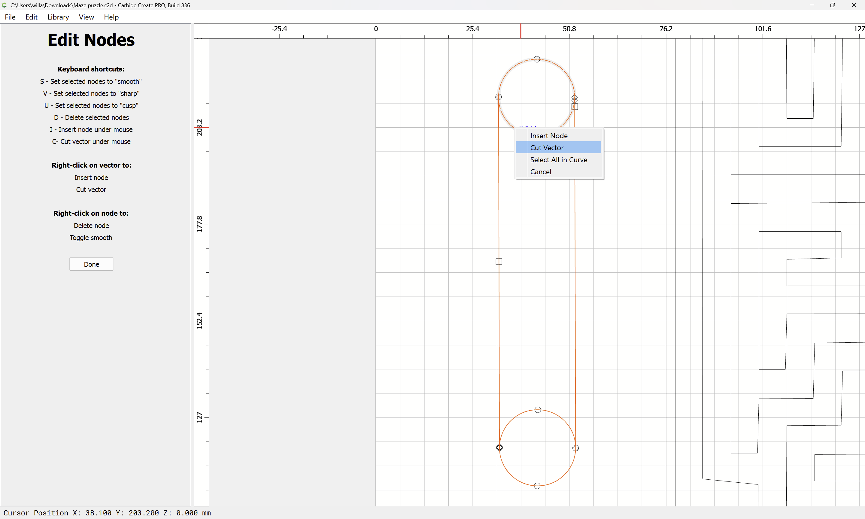

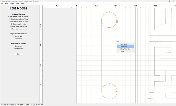

and the fact that the side elements seem to be closed, probably the easiest thing thing to do is to use Node Editing:

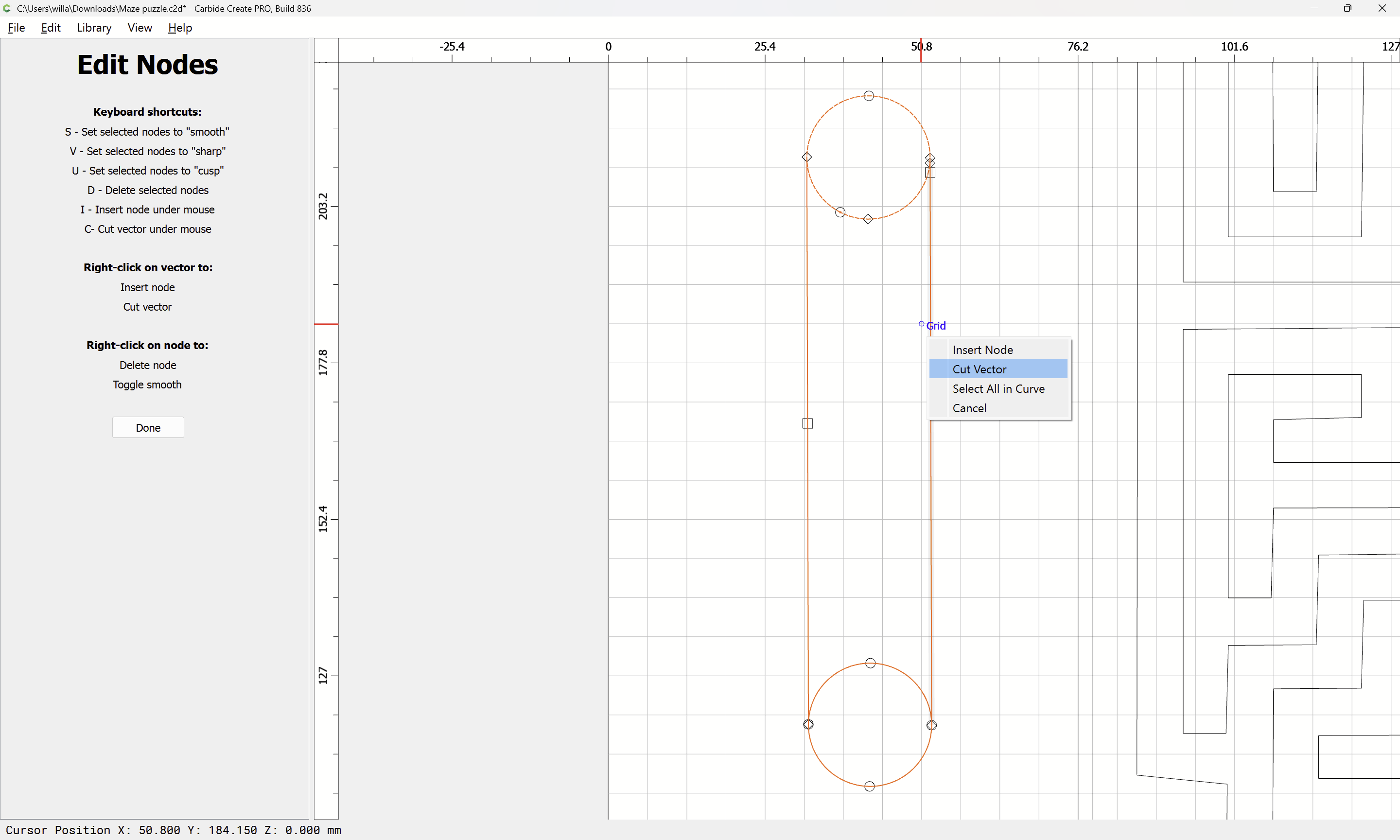

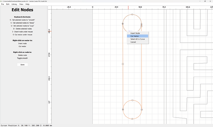

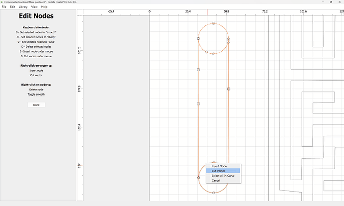

then right-click and cut each vector open:

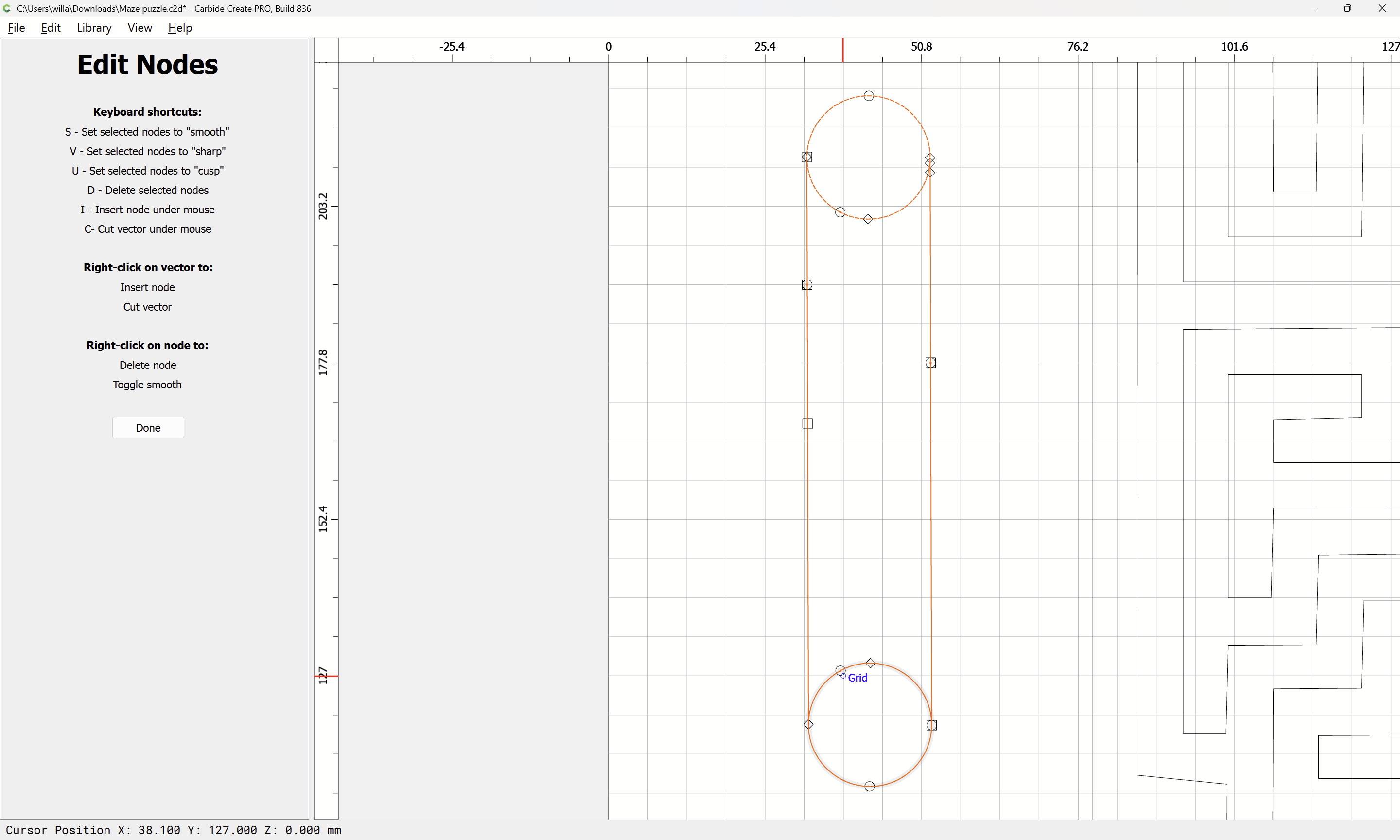

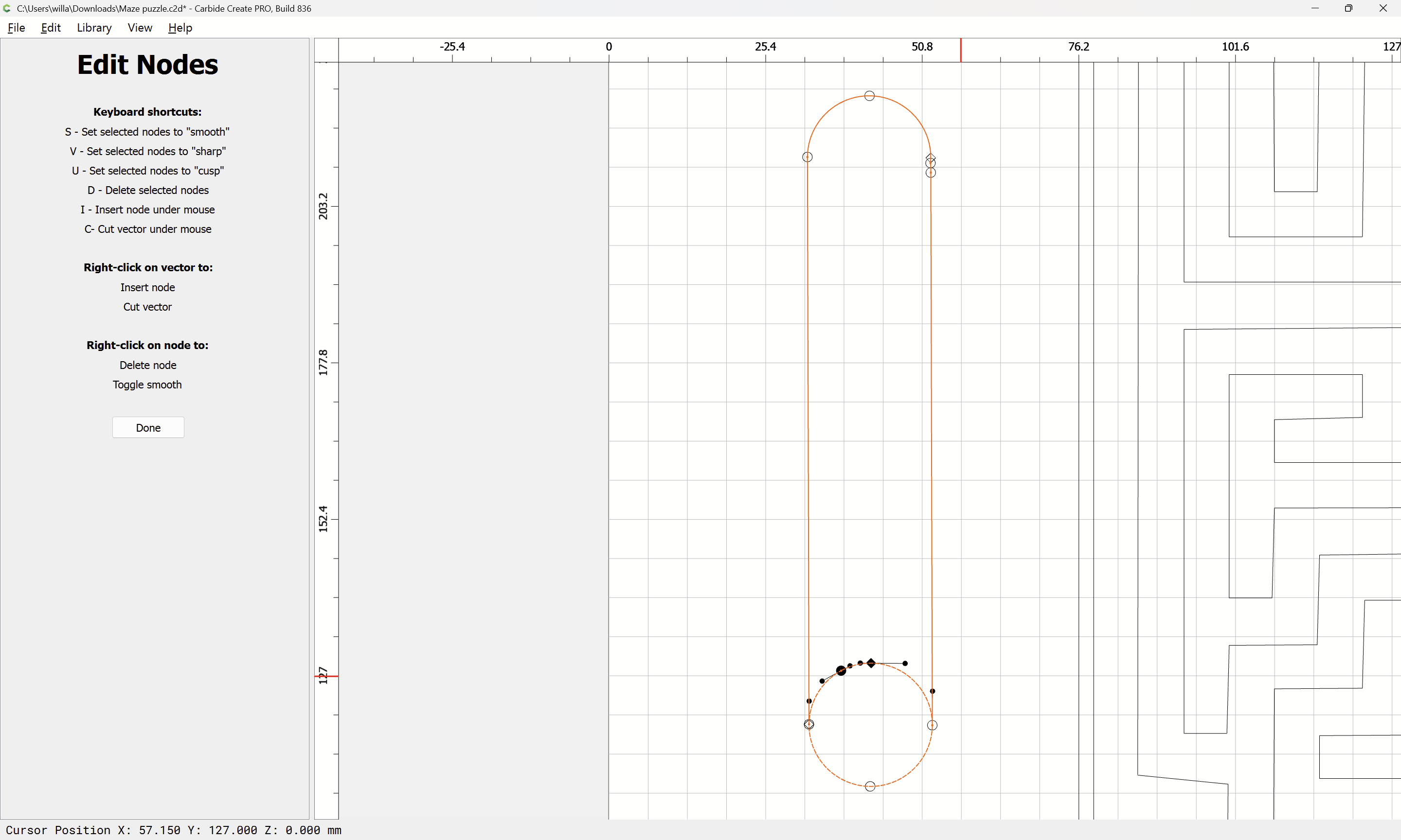

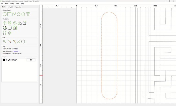

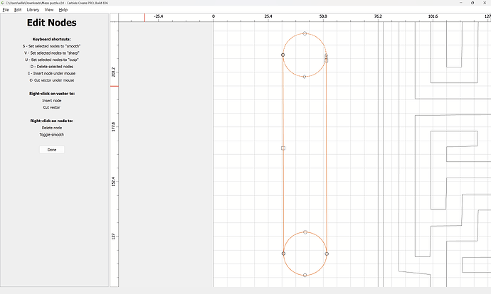

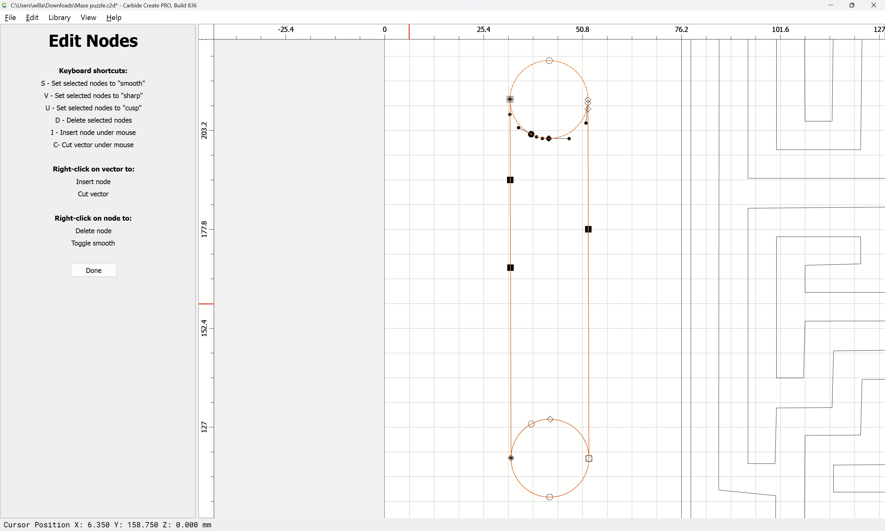

Then select the unnecessary nodes:
d to delete:

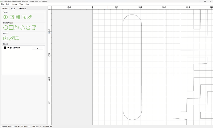

d

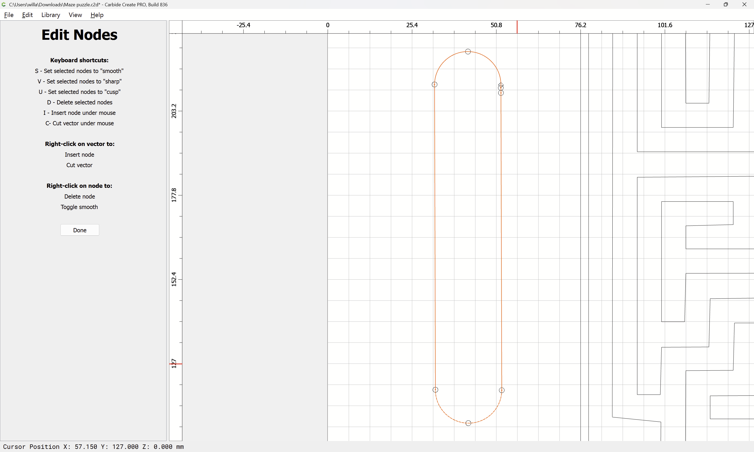

Done

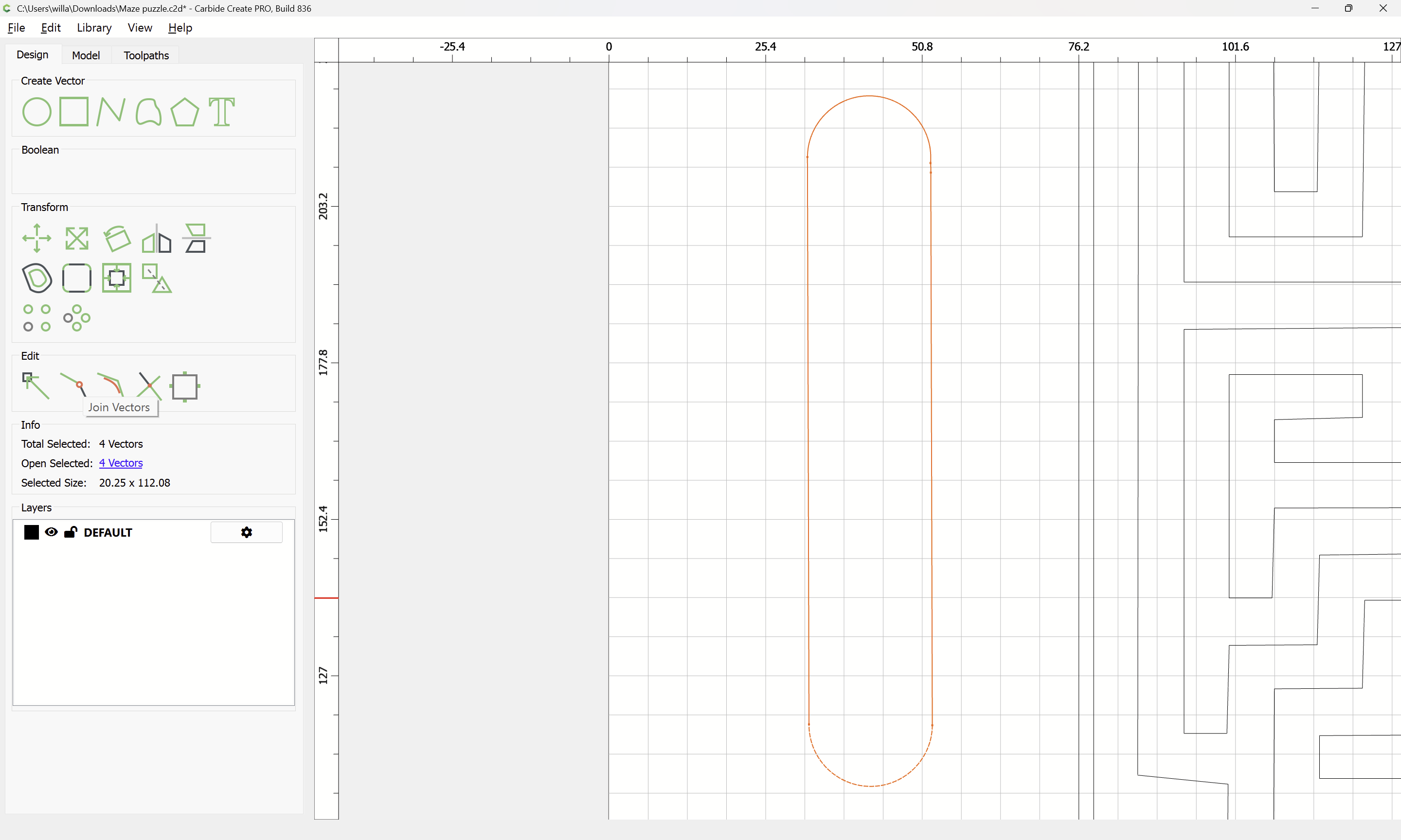

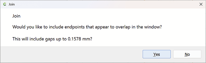

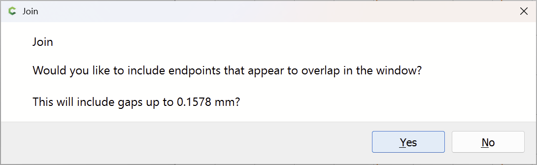

Join Vectors
Yes

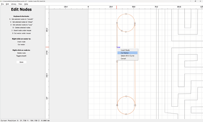

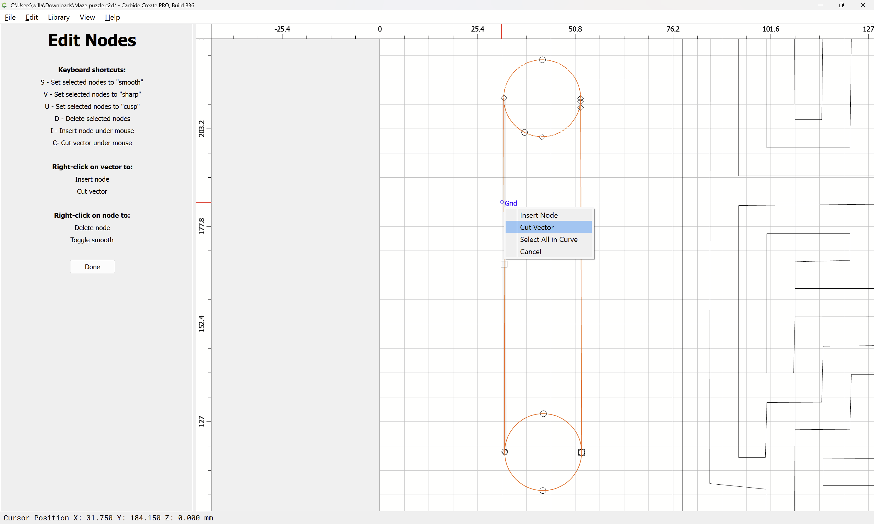

If need be, repeat:
Attached as a v8 file.

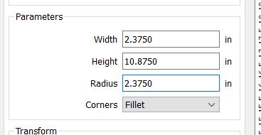

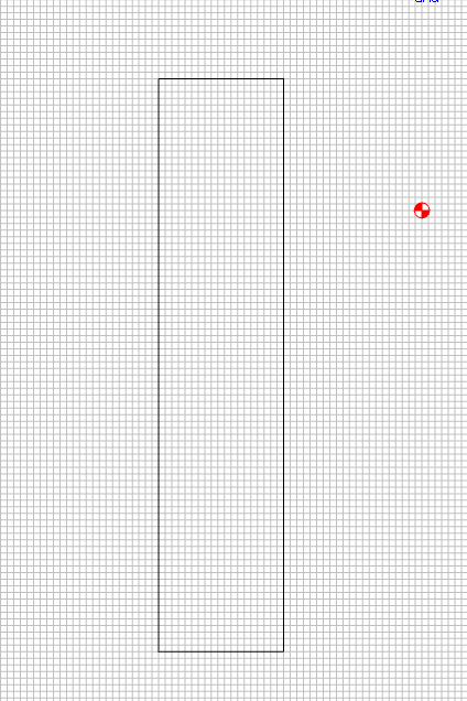

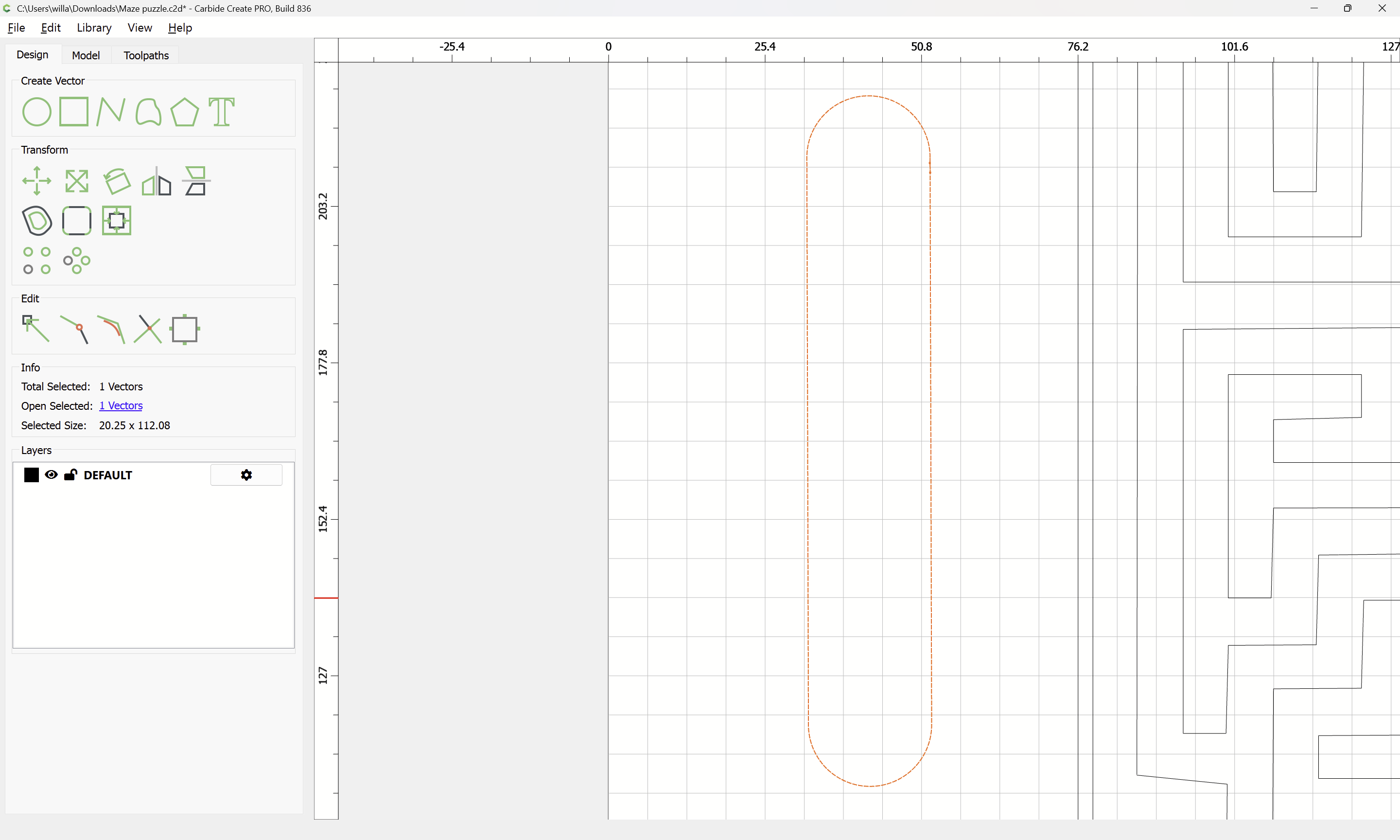

I suppose…but if it were me, I’d start with a rectangle:
Then select Corners = Fillet and Radius = anything greater than 1/2 the width of the rectangle (in my case 2.375)
Not sure if that’s the same result…but it seems pretty similar.
Thanks @WillAdams.
@GJM Thanks Gary, I like your recommendation much better than my original attempt. I appreciate your suggestion.
