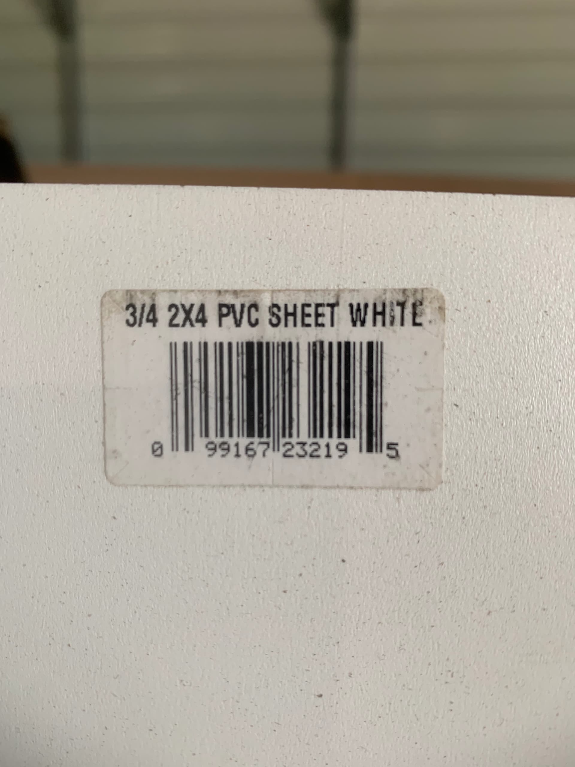

I cut a piece of plastic board from HD from a sheet of 2’x4’x.75”. 48”Lx4”W. The cut some T-nut holes with a countersink for mounting to the T track on the Left Y axis. This was mounted up against the inner left Y axis rail. This was done to ensure consistent placement if it had to be removed. Once this was mounted tight against the left Y axis rail I cut it parallel with the rail. This is used for my tiling reference when tile operations are used.
I then made a rectangle toolpath 48” in length and 4” in width. I used a 1” diameter fly cutter, this allowed me to cut a .5” wide from centerline (no offset on cut) of the spindle. This allowed me to reach over to the left even farther when the cut was made to ensure a full 48.5” between this rail and the Bitsetter. I have found variations of up to a .25” in sheet goods from different sources. This has allowed me to keep the bitsetter installed so far and which increases efficiency of the entire process for projects.

As soon as I cut the poplar fence I realized my mistake for having to remove the fence and the need to make another and reference it off the Y rail. The second was for the potential moisture movement and the actual distance between the bitsetter and fence which was less than 48 & 1/8”. I needed more clearance, which forced me to figure out how to cut the fence farther over yet knowing the X axis was already all the way to the left. So the only way to get farther over was to use a larger diameter bit to machine in place.

What kind of plastic did you use? Do you have an S5Pro? If so, do you mind sharing your project files? If you do something with inserts for clamps and graduation marks, that would be great too. I’m still learning and honestly I’m still trying to understand how people get so accurate with their machines. I honestly feel like I’m so adhoc with my machine. It took me forever to get a working surfacing toolpath working for instance, I just check changing numbers until I got something that worked. But I often see other people setup and get it right right off the bat. Let alone people who barely cut into their waste board, which I’ve been able to get achieve a few times but still don’t quite understand how…
It was from Home Depot, 3/4" thick and 2x4 feet sheet. It was in the woo/trim area with the paneling. As for the files they are on the computer with the cnc, I’ll get them posted tonight and let you know. Yes, I have the S5Pro 4x4 with the 65mm version 1 spindle with the ER-11 collet.
