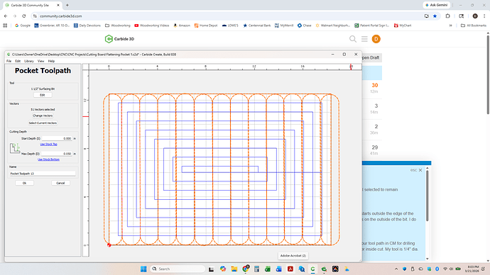

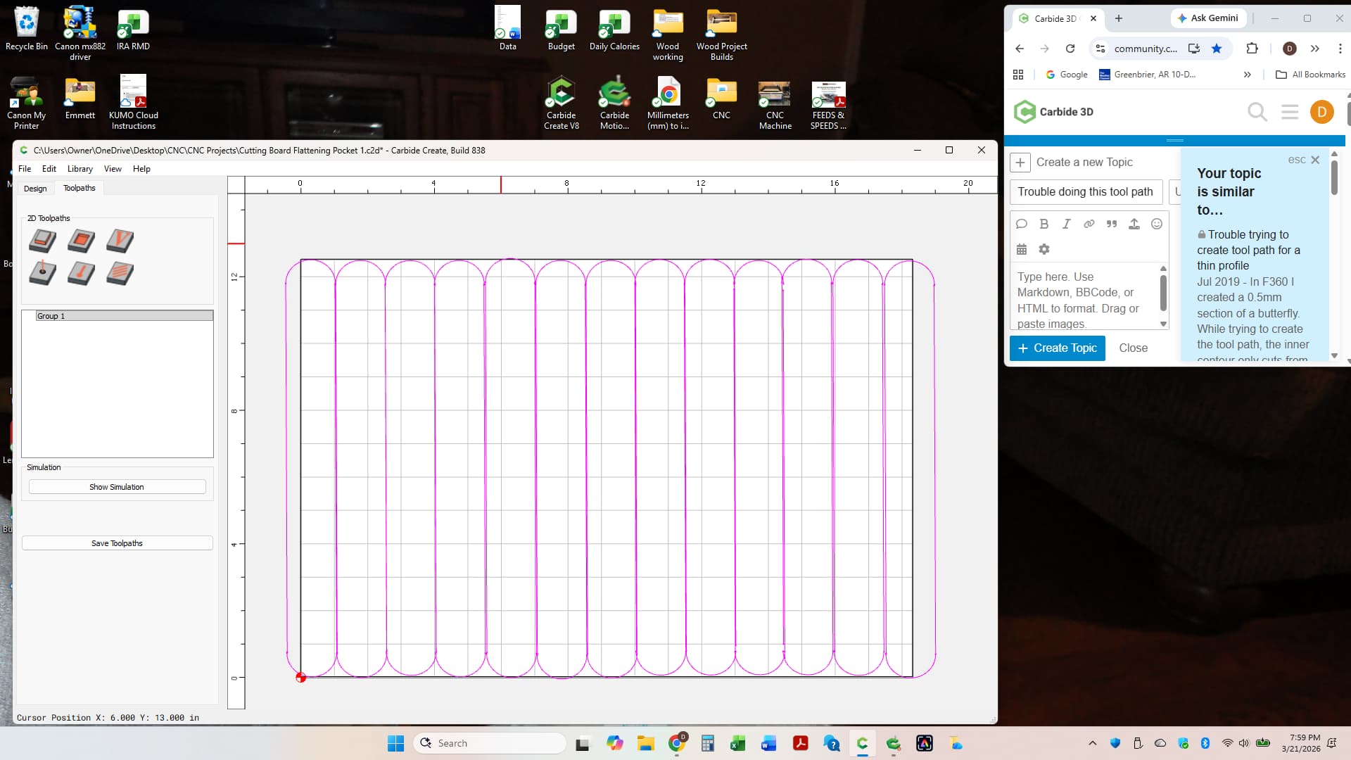

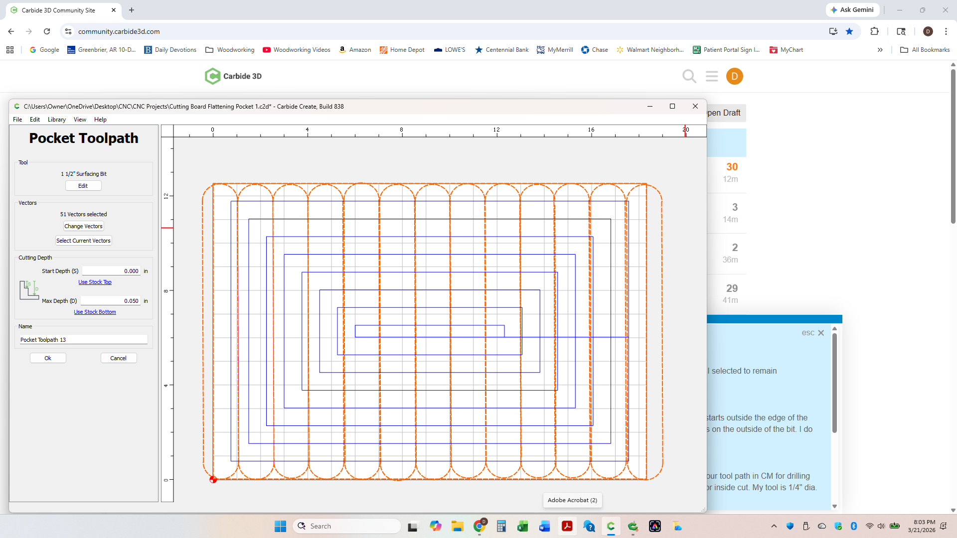

I made my tool path like this to flatten my board with a surfacing bit but when I select Pocket tool path I get this image|690x388 then this
and it starts the cut in the center. My set up is 4" (total) wider than my stock and 1" (total) higher . than my height. I’m stumped

When you select a bunch of individual vectors that overlap for pocketing, it basically does a boolean unite to create the region to be machined. If you want to design your own path & have it follow it, clean up the vectors & join them into one vector, then use the contour with no offset path.
Thanks Tod, I finally watched Kevin enough on “how to flatten a board” had to pause and rewind a bunch, he goes fast !! I added width (2" both ends) to my actual board size to allow the 1 1/2" cutter to clear the board before starting the next cut, but didn’t clear the end where I zeroed. Should I decrease the X&Y axis setting on that end by the amount I want to over travel but keep my zero axes the same when I set zero. The cutter over travels the opposite end of the board looks like twice as much as the overtravel I set up (4")
@david1952 If you zero X/Y at the center of the material the toolpath should overlap the sides of the material by the correct amount.
Thank You, makes sense, been at this starting on my 4th week and learning more everyday. This is a great site to ask questions and learn.
If you’re zeroing to the lower left corner, just type in 1.0 instead of hitting “Zero X”
You could also just make the vector/toolpath longer & leave the stock at nominal size.
