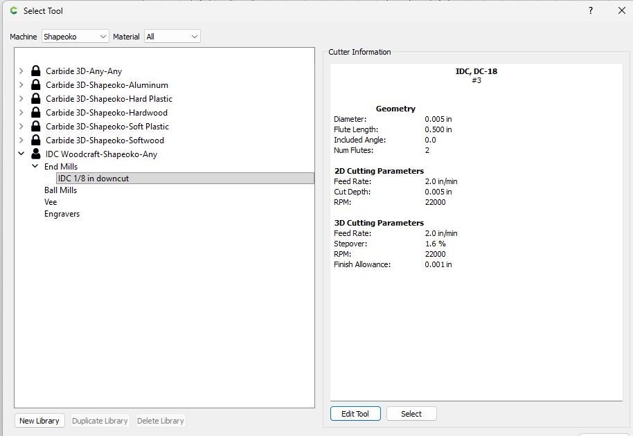

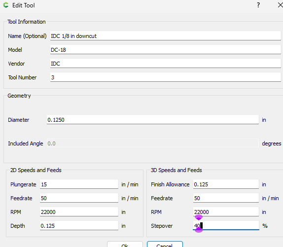

I am trying to enter an IDC bit but when I hit ‘OK’ the data gets changed. The first screenshot is what is entered, the second is what it gets changed to after hitting OK. I have made numerous attempts with the same results. Any suggestions?
Please try the new beta:
at:
which has the fix:
Removed the expression evaluator for the Edit Tool window to fix the errors if the document and tool units are different.
Thanks, problem solved
