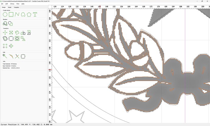

I am trying to create the plaque below:
I am almost done but having issues creating the 3d carve of the wreath around the star.
I am using round add and it looks like:
Any Suggestions on how to make it look like the wreath?
Thanks
David

Cardbide Create File attached
AdelaNamePlate3.c2d (1.6 MB)
This is a matter of figure-ground reversal — you will need to remove the outer geometry from the selection:
by ungrouping:
and shift-clicking on it to remove it from the selection:
This will then allow modeling the leaves and so-forth rather than their borders:
Thank You!!! I will give it a try.
Worked Beautifully. Thanks Again!!
