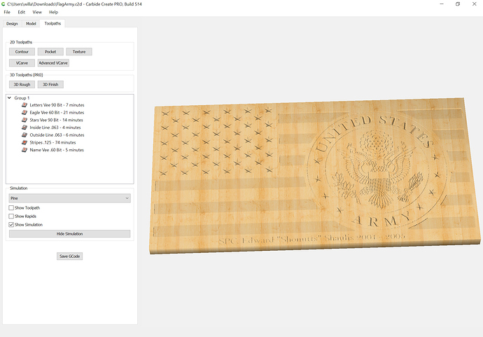

Hey guys. So I’ve been using an old version of Carbide Create for a while now. I finally replaced my old 60 and 90 degree cutters and tried to add them into my old software with no luck, I had to upgrade to V5. So I read some tutorials on how to add new tools on the new software, and have everything updated correctly. Now I’ve completely ruined 2 projects (American flags) and can’t figure out why. The stars on the flag are all rounded, and the crest that was meant to be carved is barely recognizable. Yes, I definitely reset Z with every bit change, and I’ve triple checked my cutting width and flute length. Anybody have any ideas? Is this a common problem with the V5 software? Any help will be greatly appreciated, thanks guys.

One notable thing is Z origin must be set to top for V carving to preview correctly — post the file?
FlagArmy.c2d (1.7 MB)
Here is the file that I’ve been working on.
The file setup and 3D preview seem fine:

I suspect Z zero set too low. How are you setting it?

I am setting zero using the probe from carbide 3d. I’ve checked the depth on the stripes cut with the .125 and they are spot on. So I would think that if it were an issue with setting zero, the end mills would be off as well

If things worked well when you Zeroed XYZ, and cut the stripes, that confirms that bitzero is working well.
When you ran second file and Zeroed Z-axis for new V-Bit, is there any chance set the bitzero on the corner, as opposed to on surface, and did a Z-only probe?
Doing that would leave your zero point 3mm lower than expected, and carve 3mm deeper than expected.

You could try measuring the furthest out point on a star, and see how deep it is (where the tip of V-bit carved) In theory, that should be almost flush with the surface. It will give you an idea how much you’re out and where to look
I fiddled with your c2d file to see how to create something that matches your physical result.
This is what you get if your v-bit starts 0.1" too low.
Speculation: Since the v-bit is very pointy, perhaps it’s put a small dint in the (presumably older model) bitzero over time… perhaps not 2mm worth, but something that makes v-bits start too deep?
edit: or the vbit is blunt at the tip… or a combination of the bitzero and bluntness.
Wow, that looks exactly like it. Thanks for all of the effort from everybody. I think its time to retire the old touch probe
