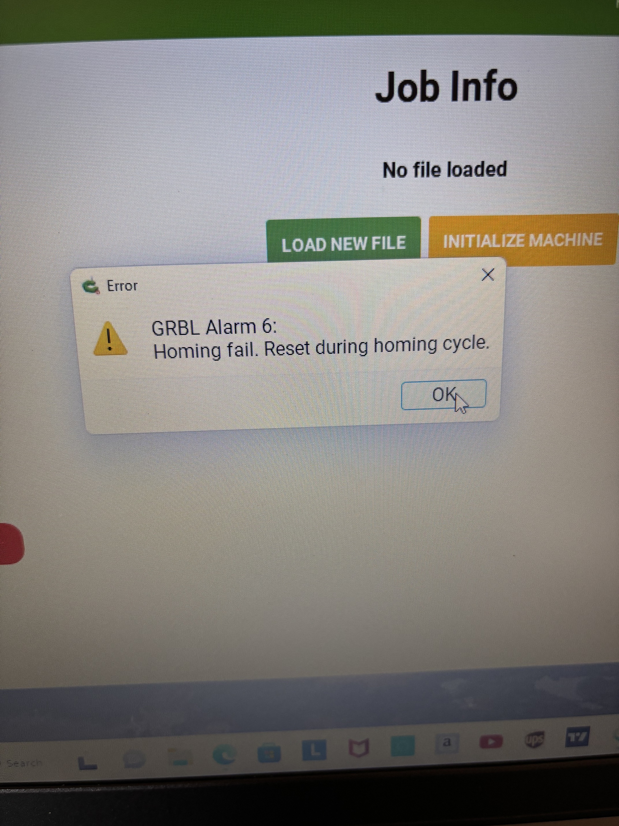

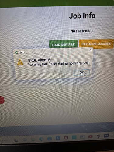

Does anyone have any idea how to fix these?
The Carbide 3D documentation offers a potential solution.
https://carbide3d.com/hub/docs/troubleshooting-homing/
"HM006 is equivalent to GRBL Alarm 6, meaning that the machine’s controller reset itself in the middle of the homing process. This should never happen in everyday use.
The best course of action is to restart the machine and redo the initialization process in Carbide Motion. If the problem persists, it’s likely a bad electronics module, but the support team can help you troubleshoot to verify that."
but if that doesn’t work, reaching out to their support team is likely the next step.
