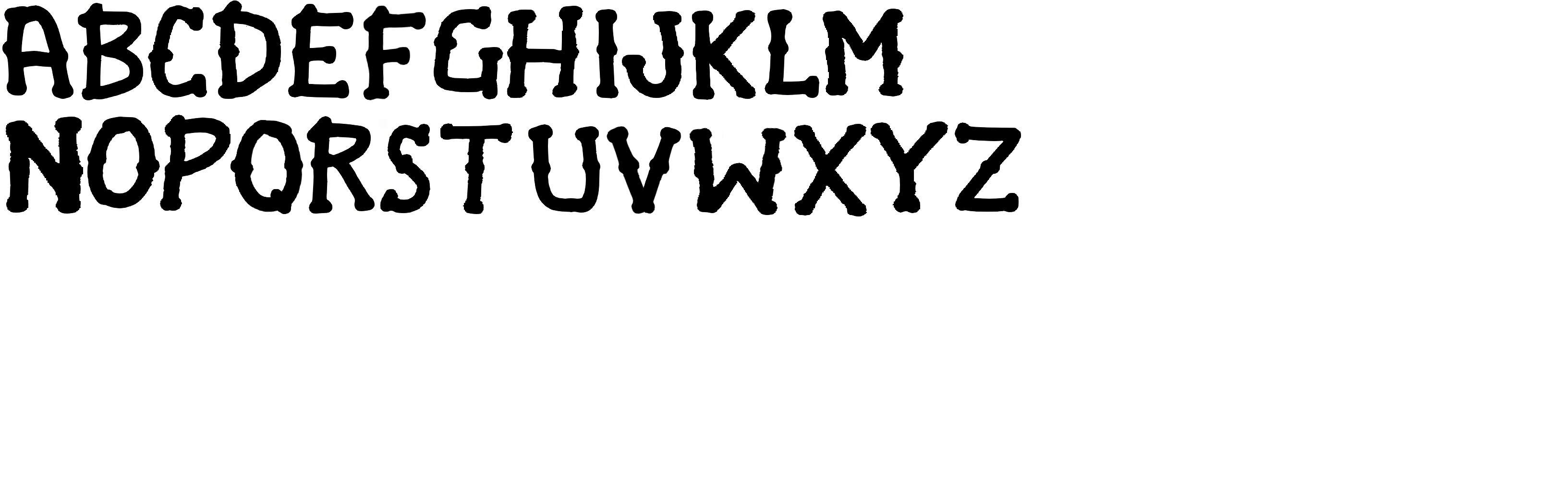

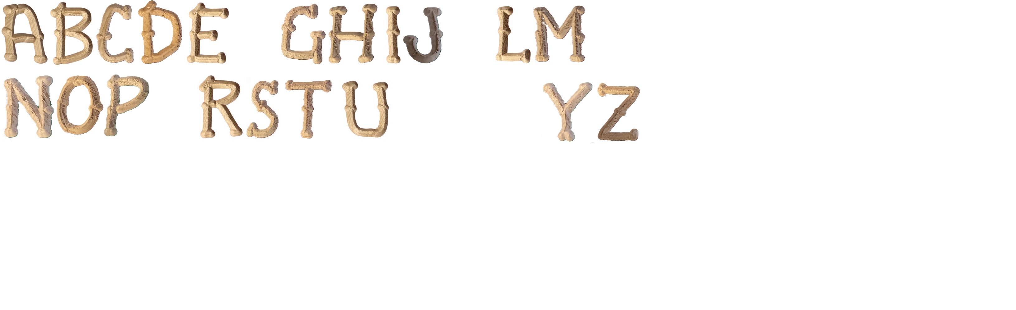

Trying to dup old sign style
There are a few fonts that are close, but not exact. LDJ Friend Font, Passing Stranger, …

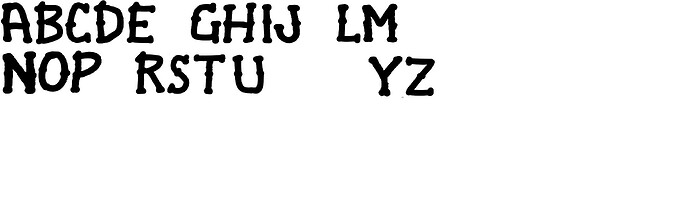

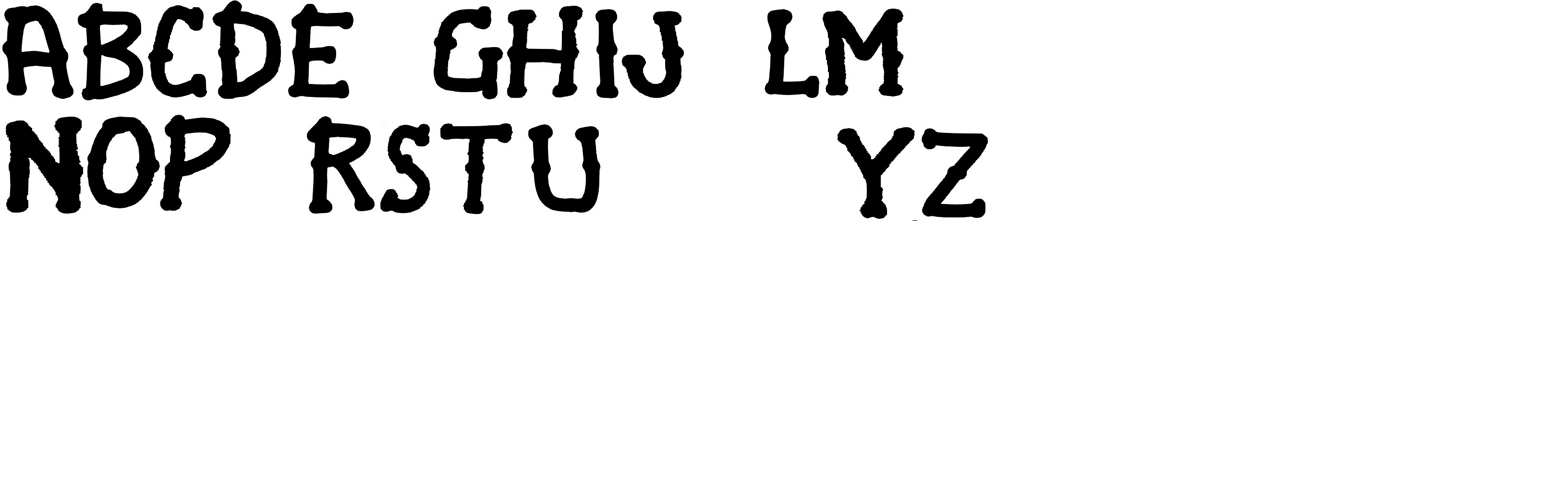

@WillAdams you think you could create missing letters? this is all i got. I was also informed i need to make another one for inlaws
I don’t see why not.
F is just E with the bottom stroke deleted, Q is O with an additional stroke. &c.

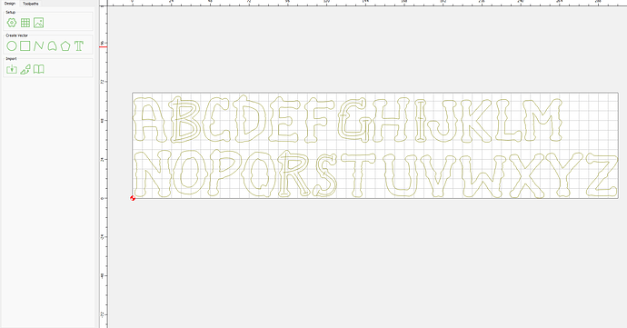

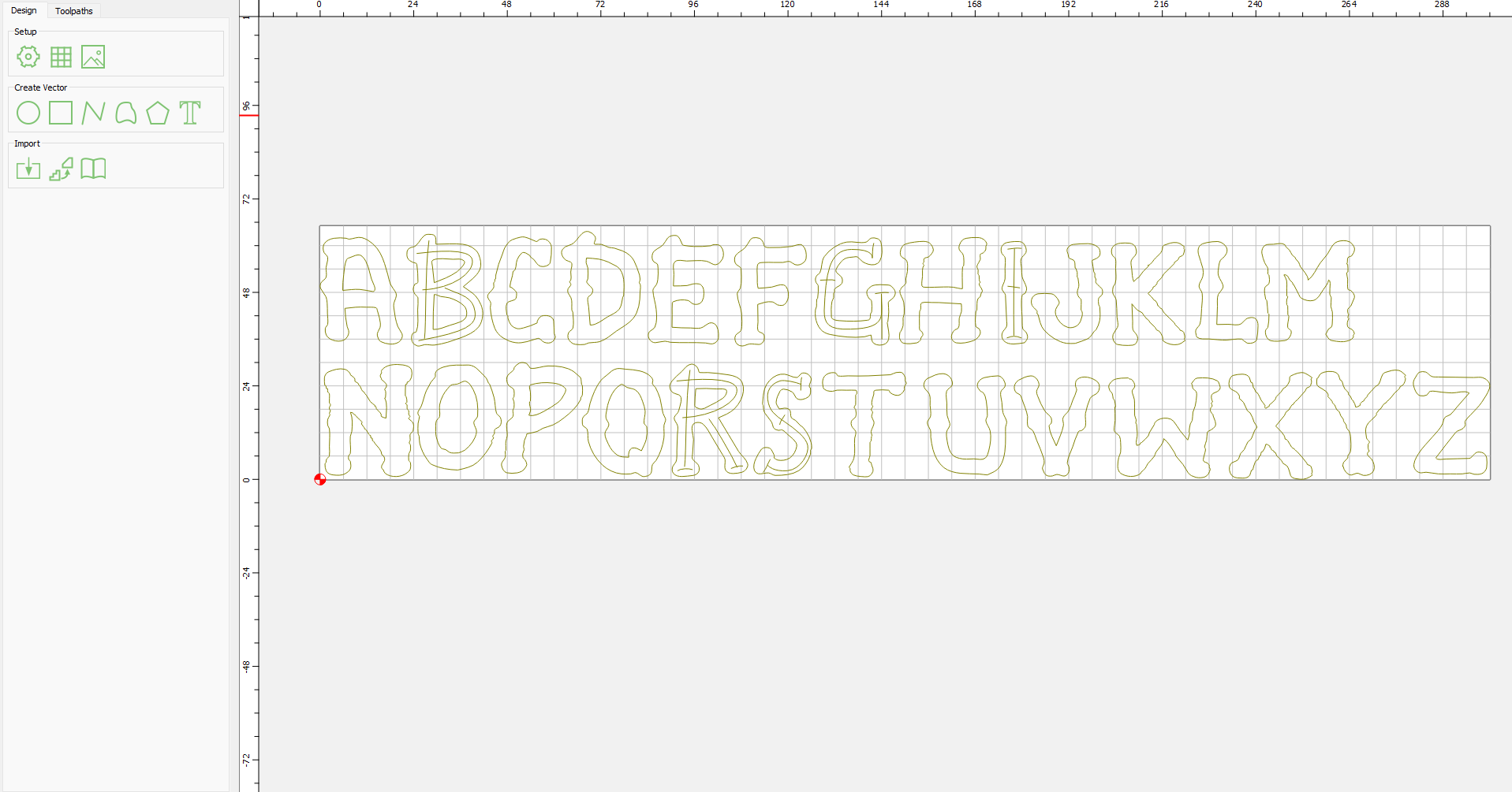

ok created missing letters.

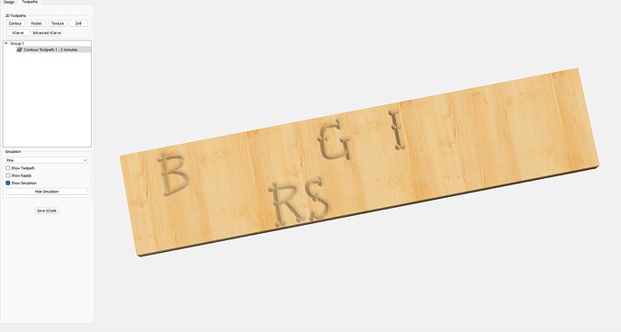

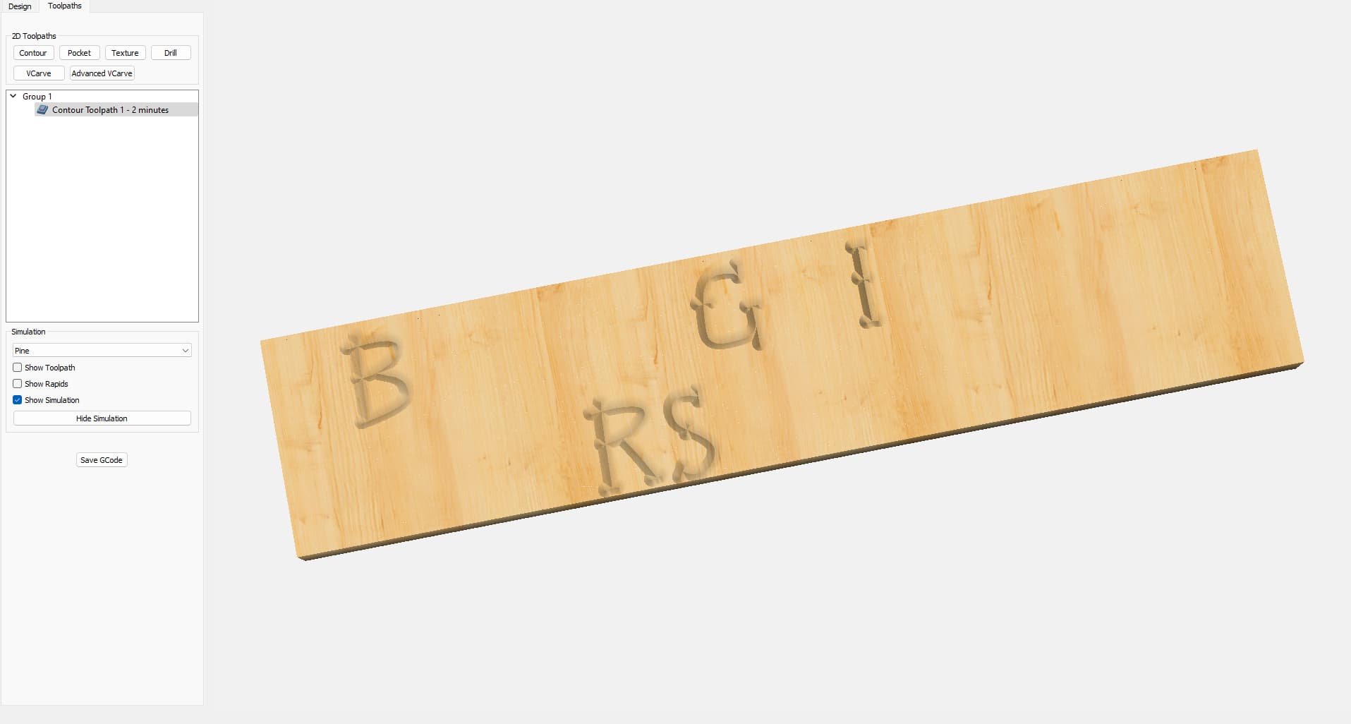

here is where im at with tool paths. i cant seem to create a curve clean enough…
full alphabet.c2d (639.4 KB)
As shown above, one workable approach is to draw the central channel and the crossing geometries and then assign No Offset Contour toolpaths.

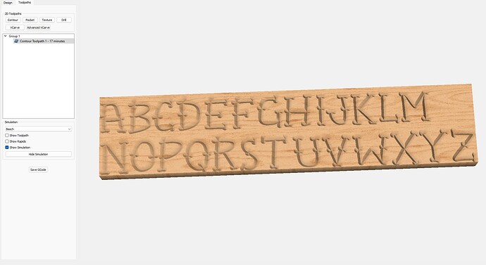

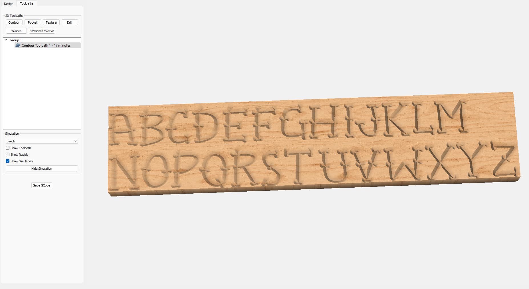

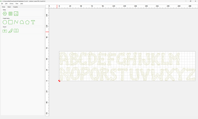

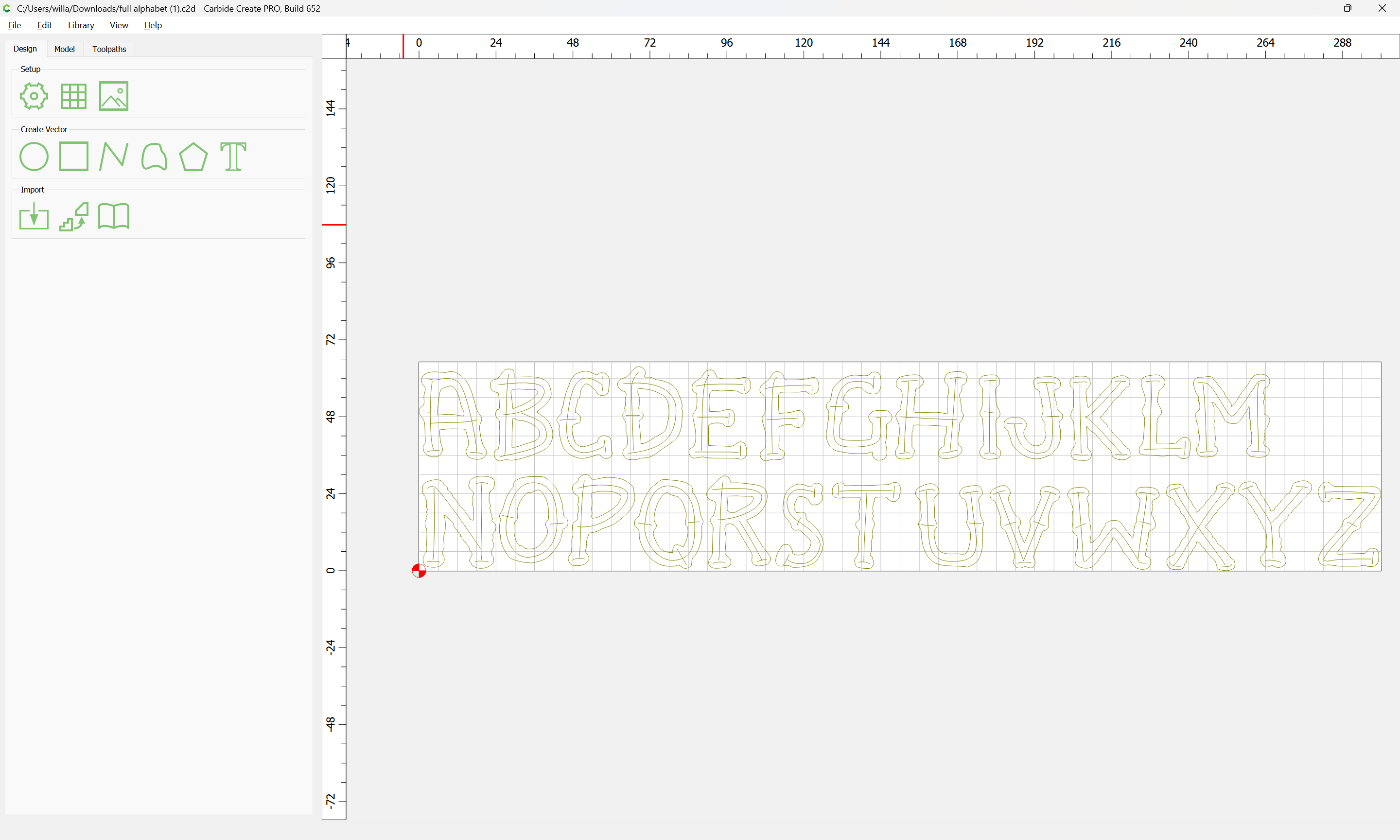

Ok @WillAdams here is my attempt please let the grasshopper know how he did. :slightly_smiling_face:
full alphabet.c2d (834.5 KB)
Looks great!
If you see anything that needs adjusting so it looks better please feel free to supply changes. I hope someone down the road finds it useful if they have to match same style like I did and this could save them some time.
