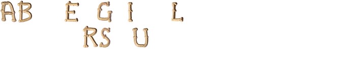

Trying to dup old sign style
i created new name from images of other names but not having any luck with tool paths to create same look. anyone willing to give me tips? including photos and design

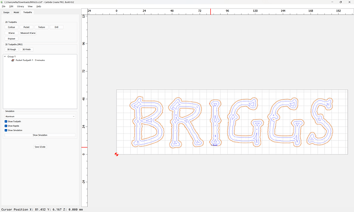

That appears to be a ‘park sign’ style. Letters cut into the wood with a ball mill the same size or just a bit smaller than the narrowest width of the letters. Depth set to 1/2 of the tool dia. or a bit less.

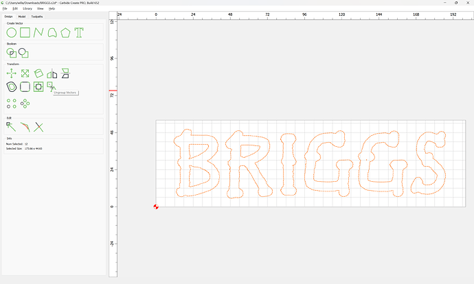

The auto-traced scan could use some cleaning up:
A 1/8" tool will fit:
Except for where the scan needs to be cleaned up:
Ungroup and select only the problem part:
and delete it:
to get:
which previews as:

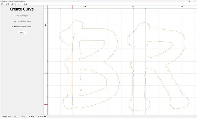

That said, this sort of design/lettering is easily done in a Vector drawing tool which will create outlines from a path, or one could do it directly in Carbide Create using No Offset Contour toolpaths (so long as one wasn’t cutting too deeply):
Open in v7, re-save, then open in v8, put the original geometry on a background layer and lock it:
Because Carbide Create wants to Snap to Nodes:
it will be necessary to zoom in enough to keep that from interfering.
(Note that this will be much easier using a stylus, and easier still in a program which allows directly drawing with a stylus, rather than using the rather technical Bézier curve tool)
Click-hold to place the begin point:
drag-release to place the off-curve node:
click-hold to place the end-point:
drag-release to place a symmetrical off-curve node to the off-curve node which will affect the shape of the curve:
Done
If desired, go into Node Edit mode to adjust:
Repeat for each other stroke:
clicking “Done” at the end of each:

Note that it is possible to alt drag an off-curve node so as to create an asymmetric off-curve node placement:

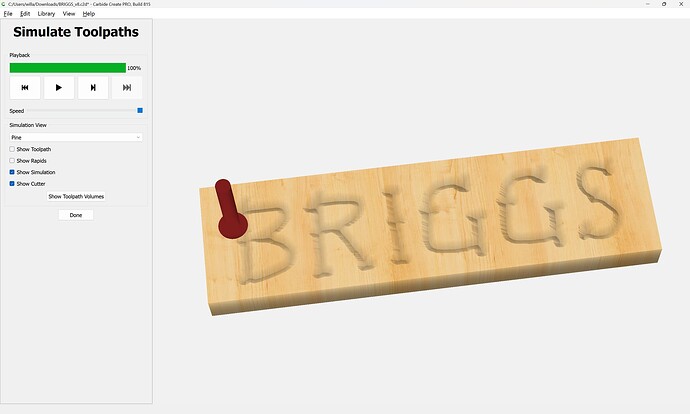

Repeat this process until you arrive at:

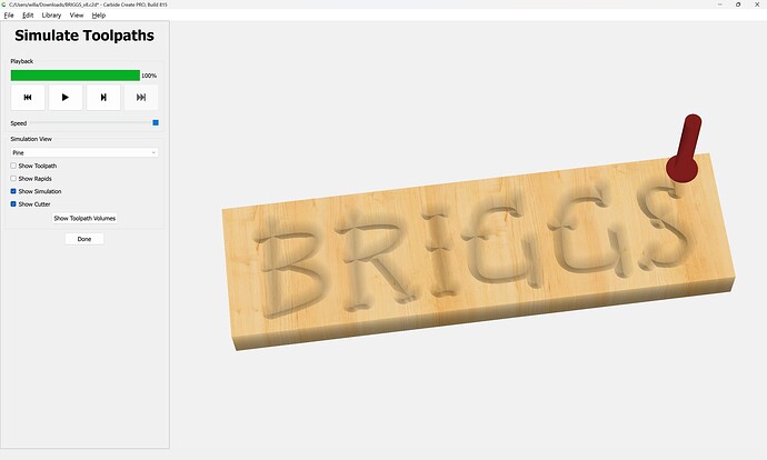

Then assign a No-Offset Contour toolpath to a reasonable depth:
which previews as:
attached as a v8 file.

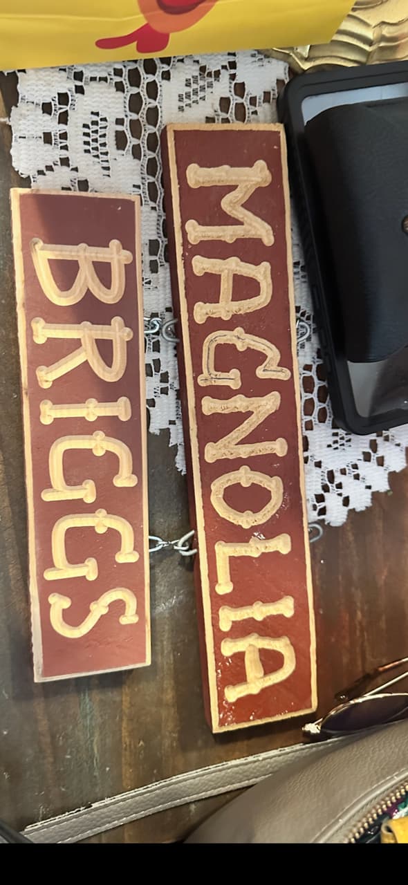

@WillAdams you sir are amazing! The original signs are rough but seem to be done with some sort of v-bit? Here is a closeup of original lettering. You absolutely nailed it though by drawing inside I think I could now produce a perfect replica of originals.
In that case, using a V tool at an appropriate depth should work:
FWIW, it looks like the originals were done free-handed (note the differences in the _E_s) or w/ a templating system which had alternates for frequently repeated letters, or some other technique to induce variation.
for sure by hand and a stencil perhaps? this is perfect and my son-in-laws mother will be very happy!
