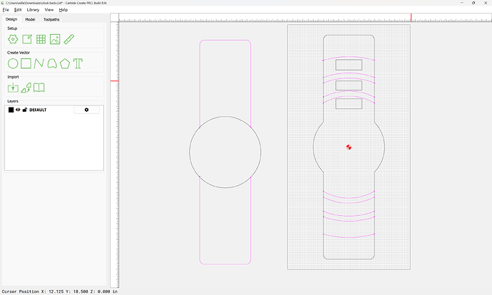

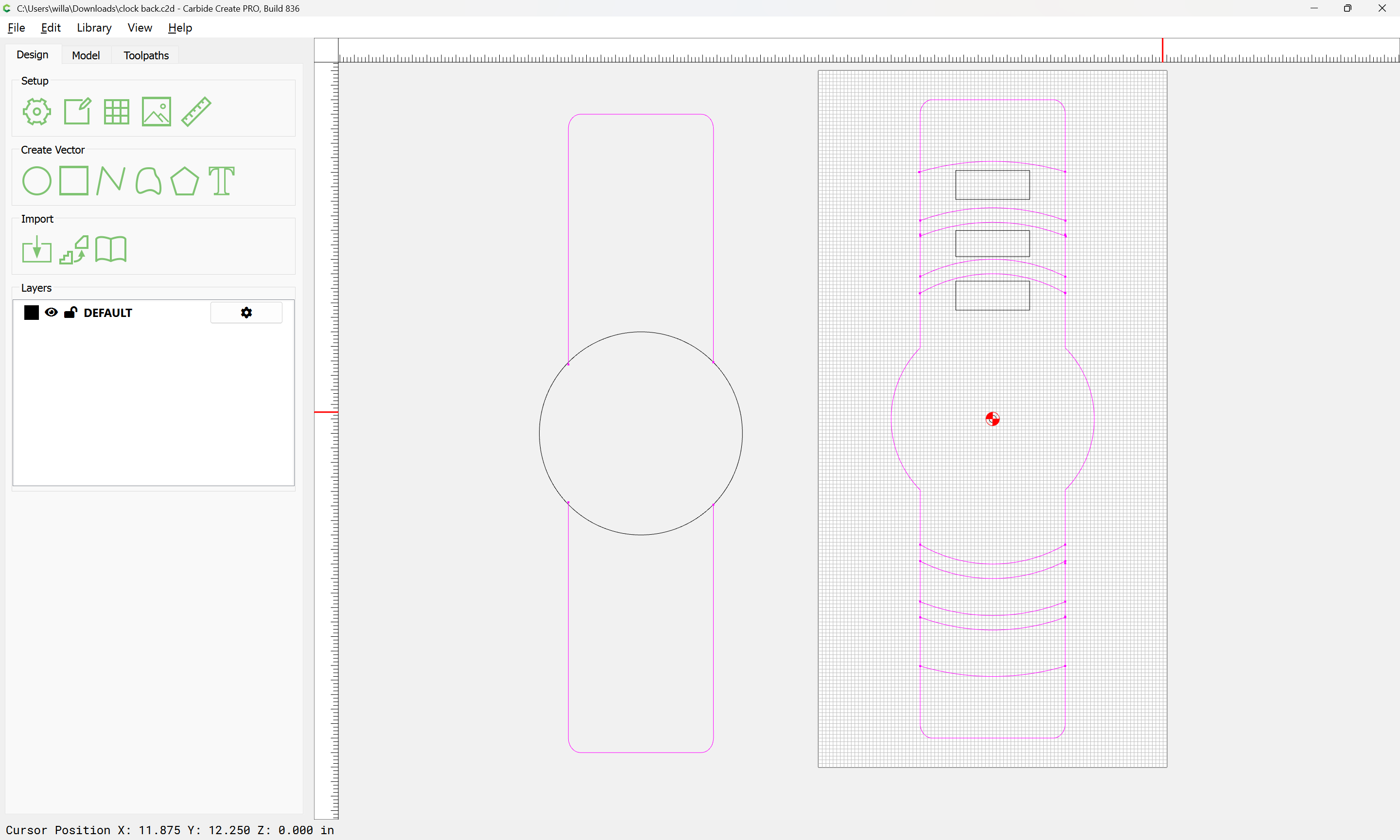

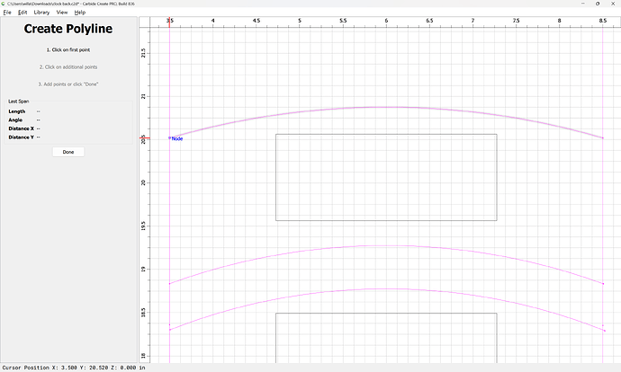

as requested on support…

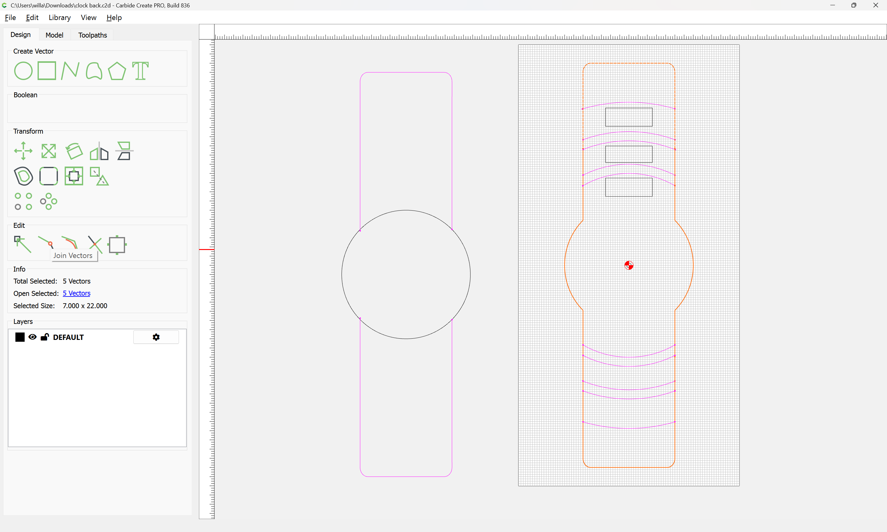

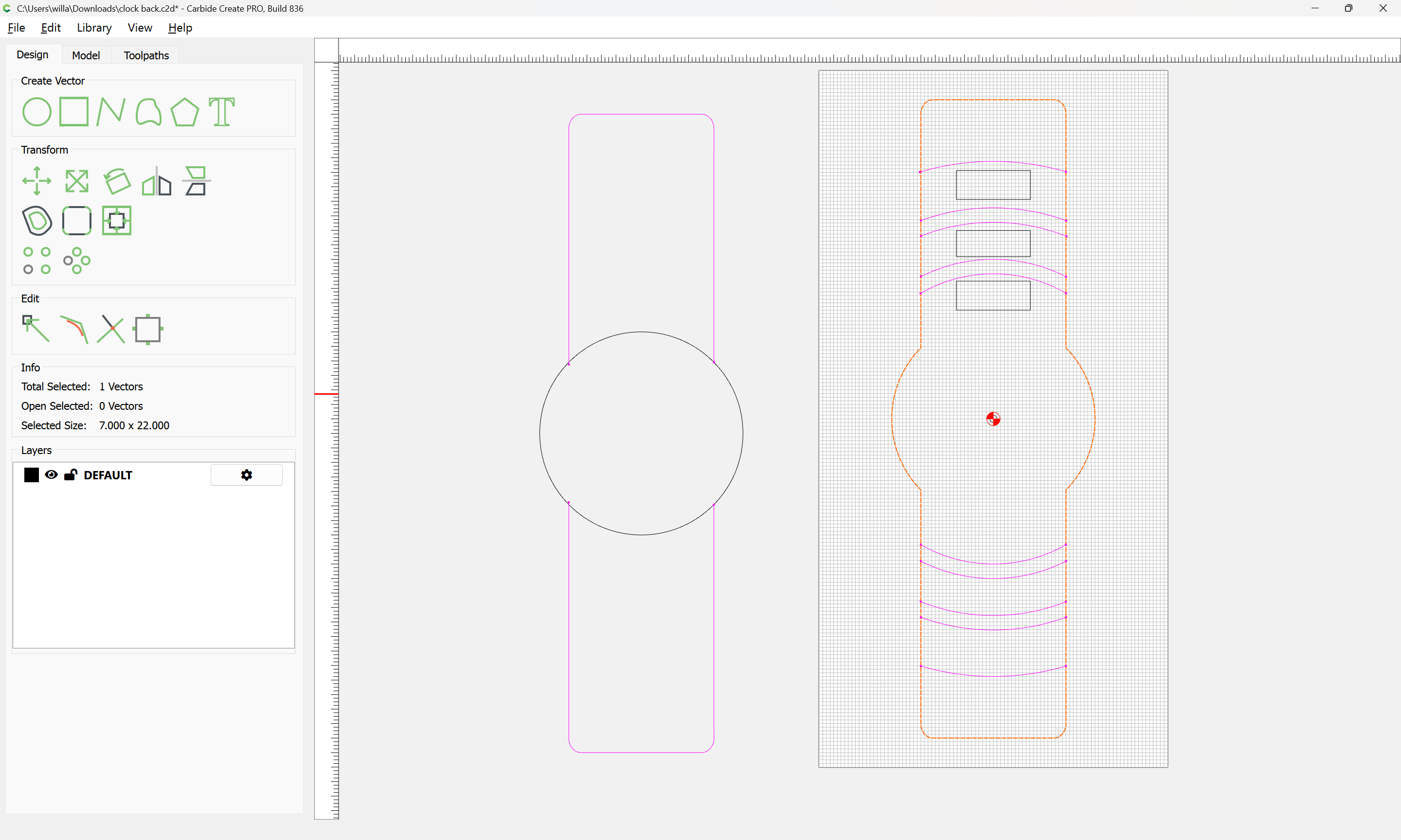

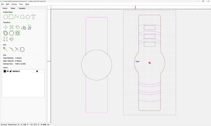

So I tried join vectors, i also tried duplicating and not working…

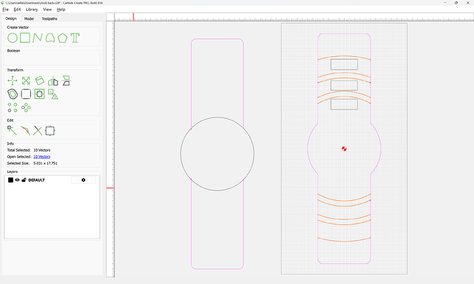

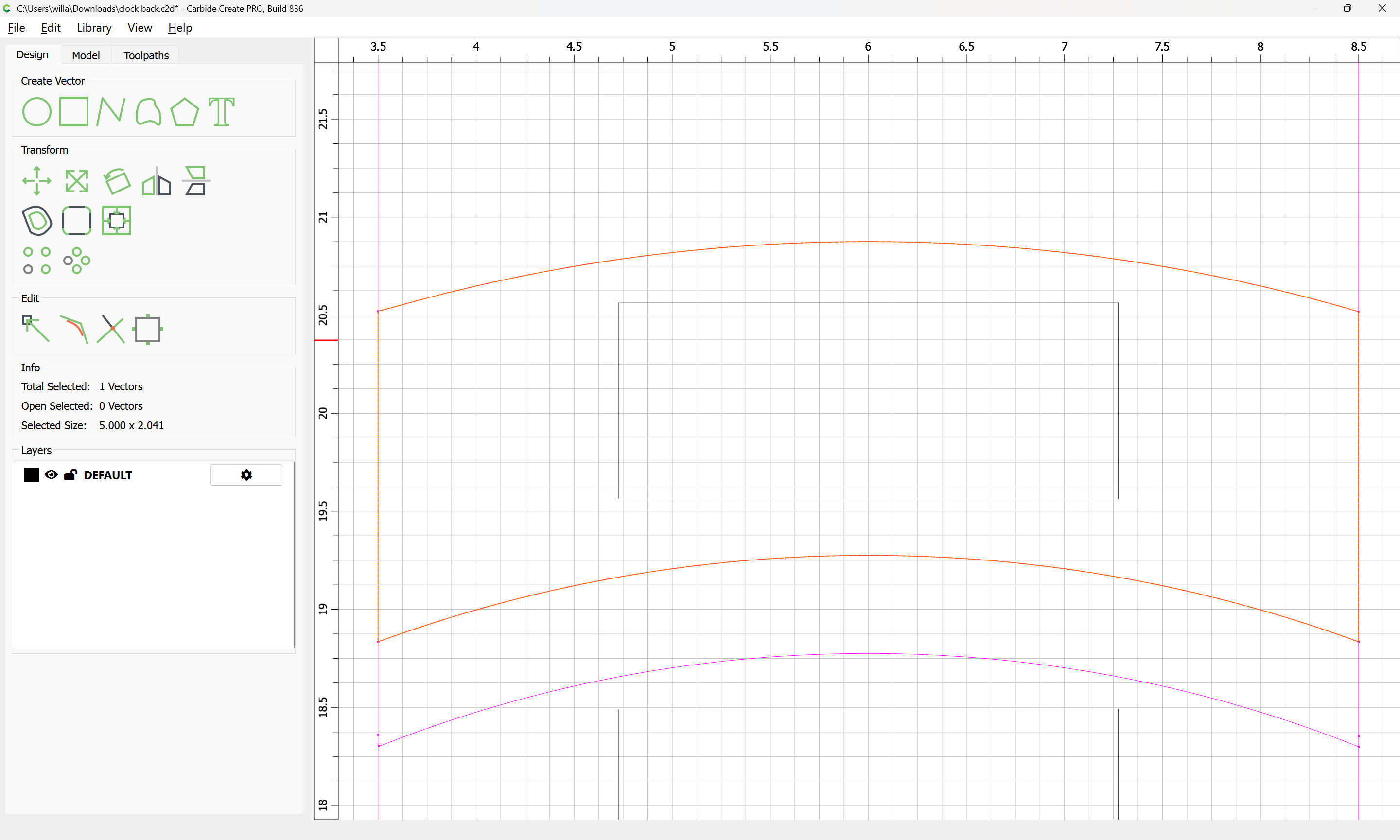

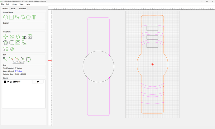

If one selects the outer regions:
Then they should join so as to make the outer perimeter:
Yes
If one wants discrete sections for each, then that will require some additional geometry and steps…
WillAdams
(William Adams (Carbide 3D))
2

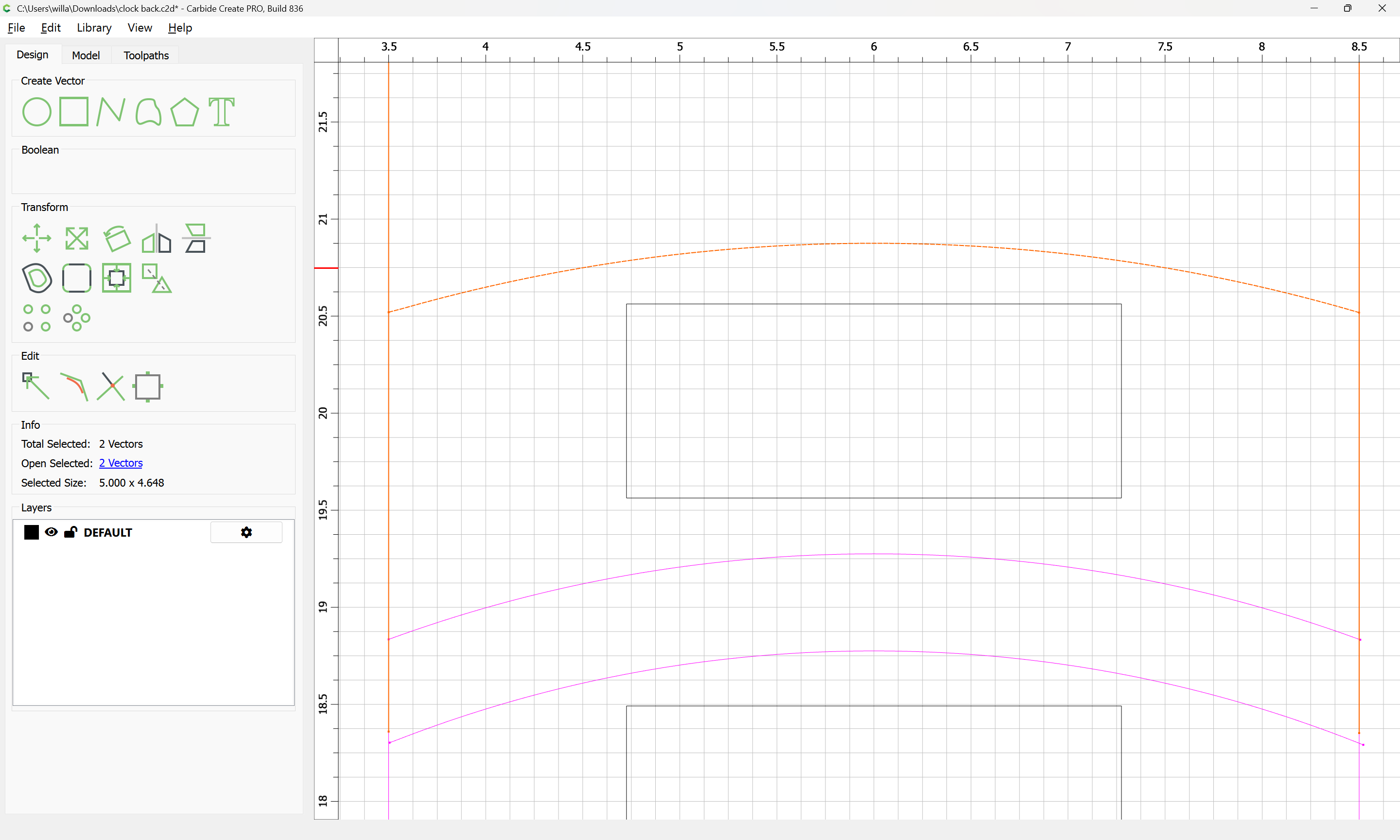

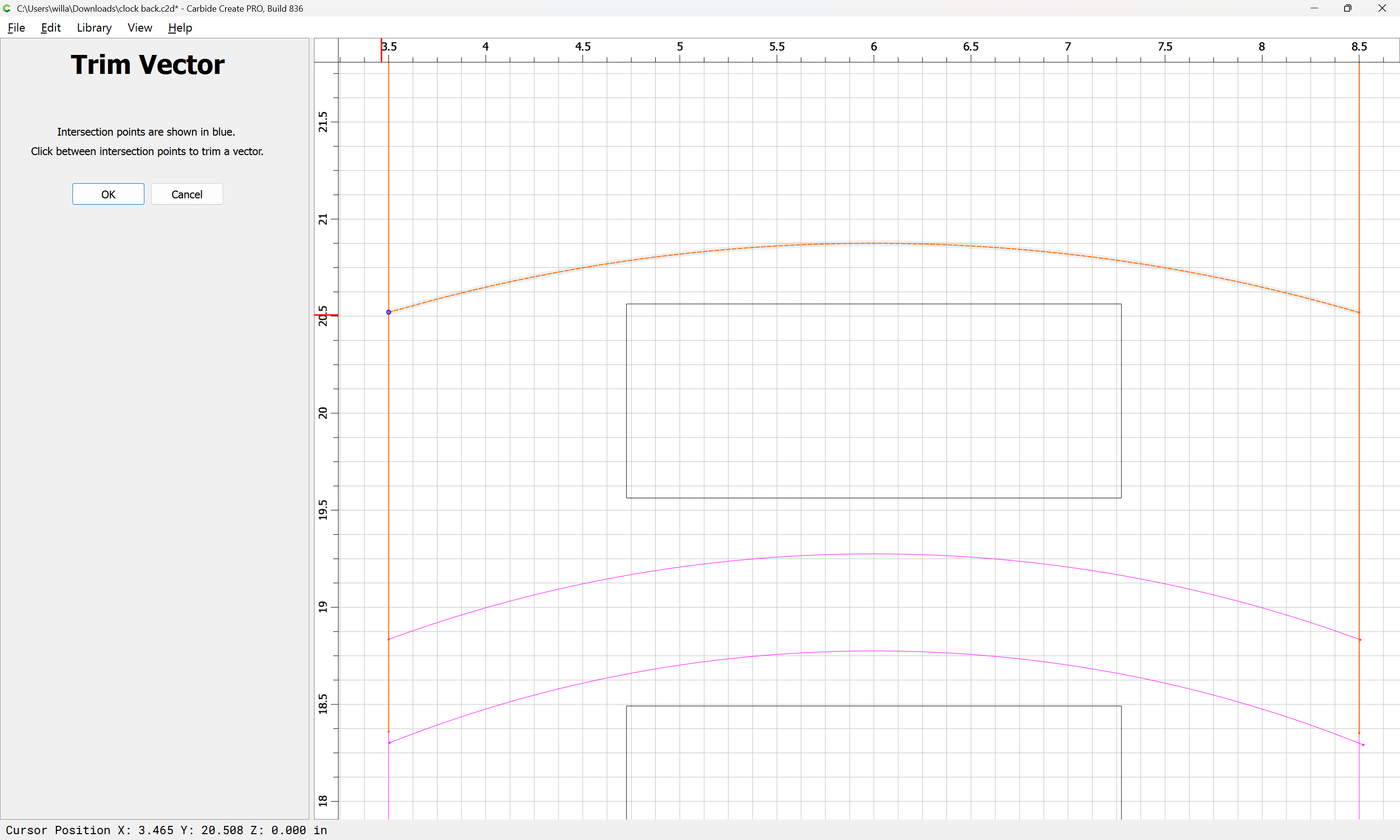

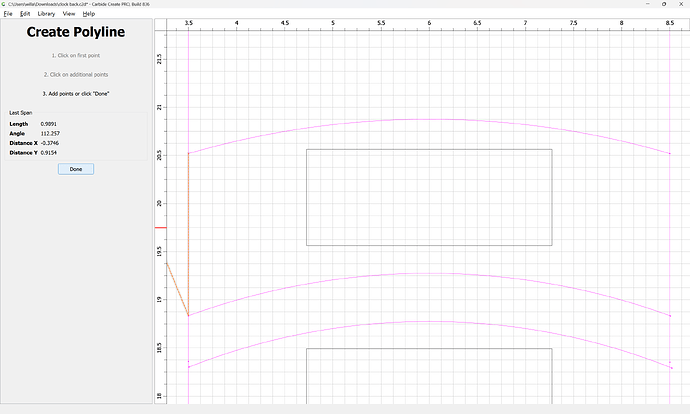

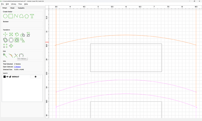

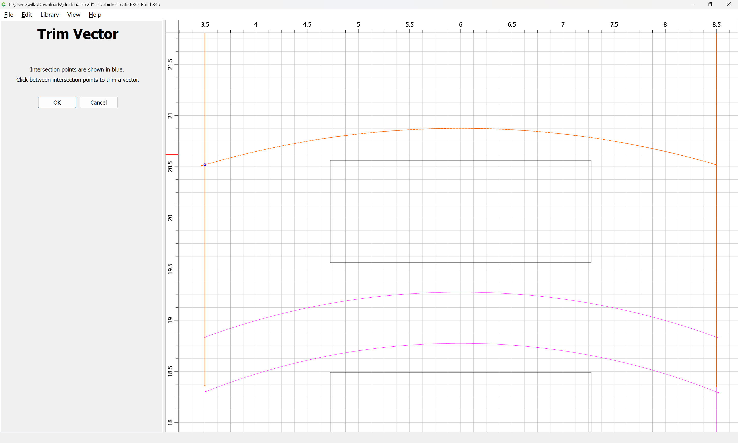

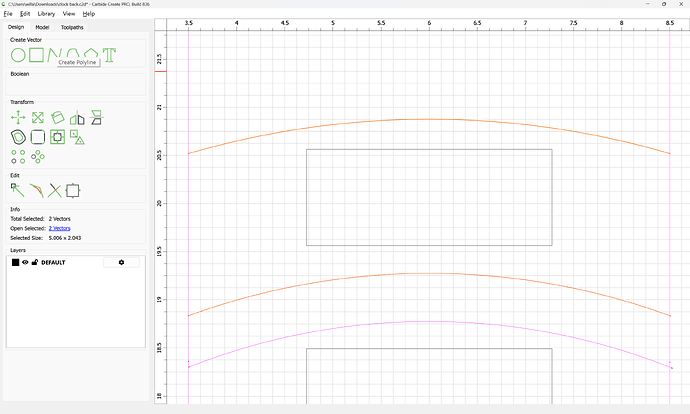

The first concern is that some of the curved sections extend too far:

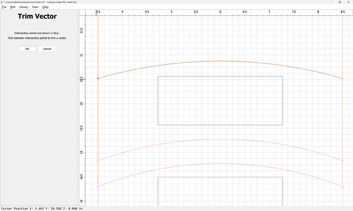

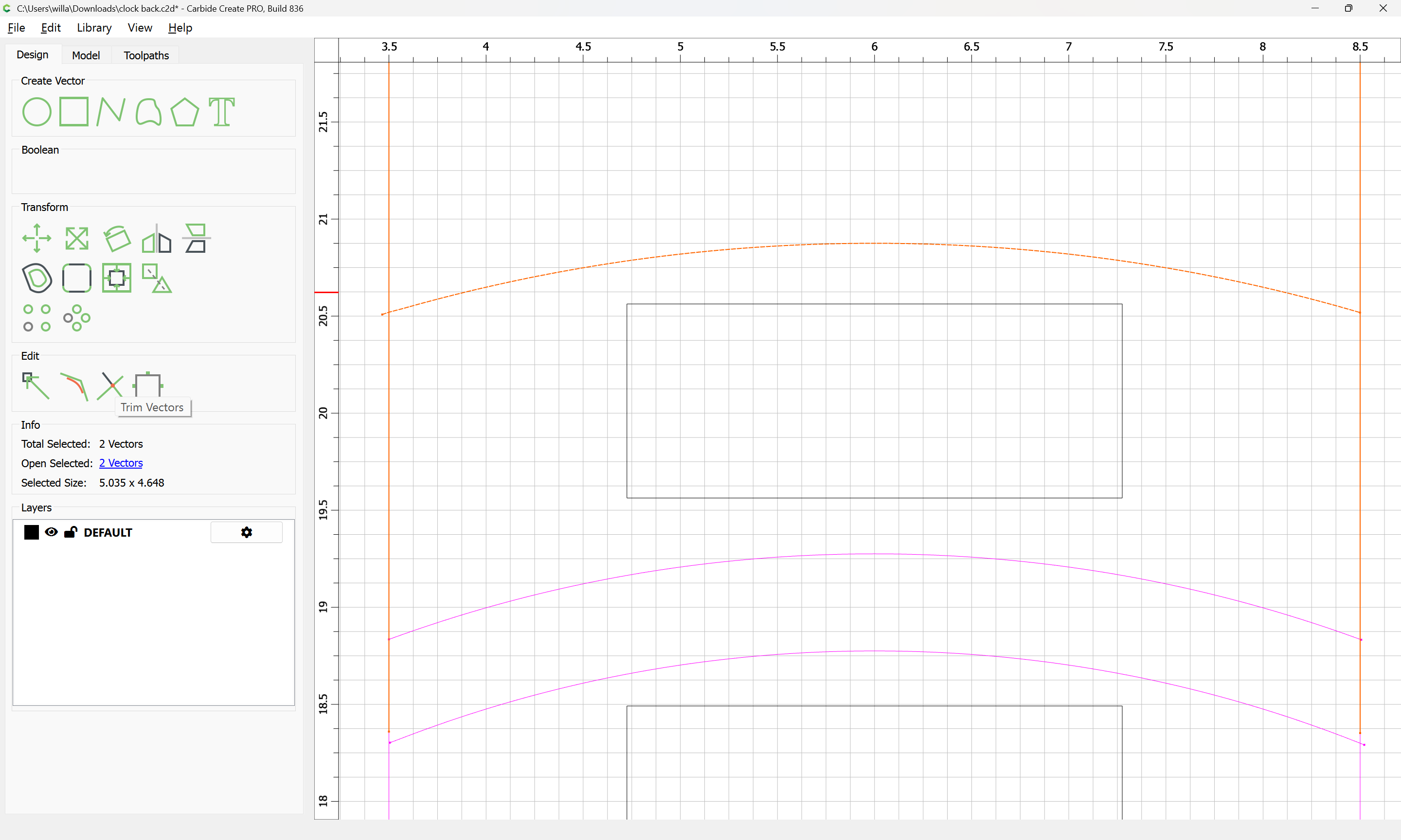

Select the errant bits and a piece of geometry which defines the desired extent:

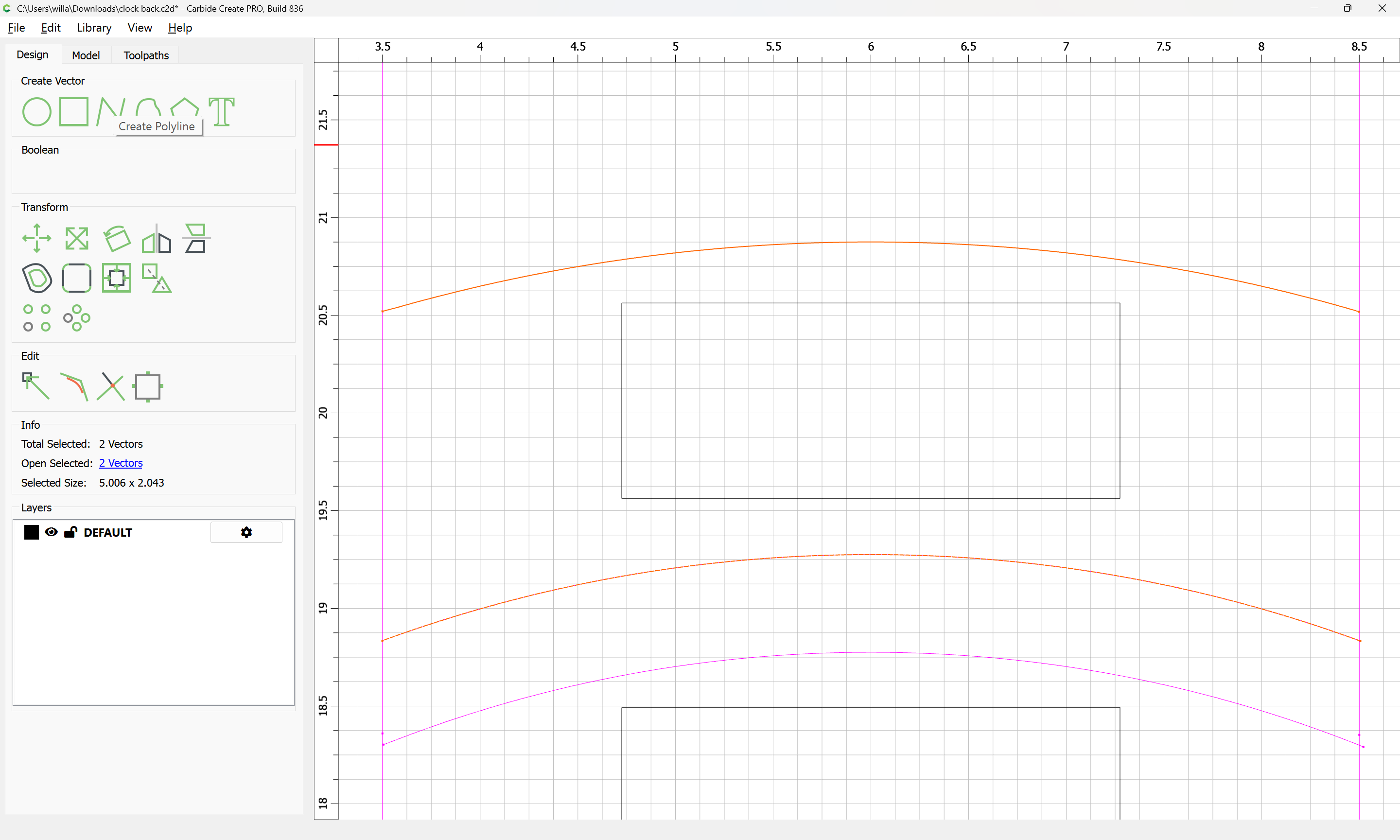

and then use Trim Vectors to remove what is not wanted:
OK

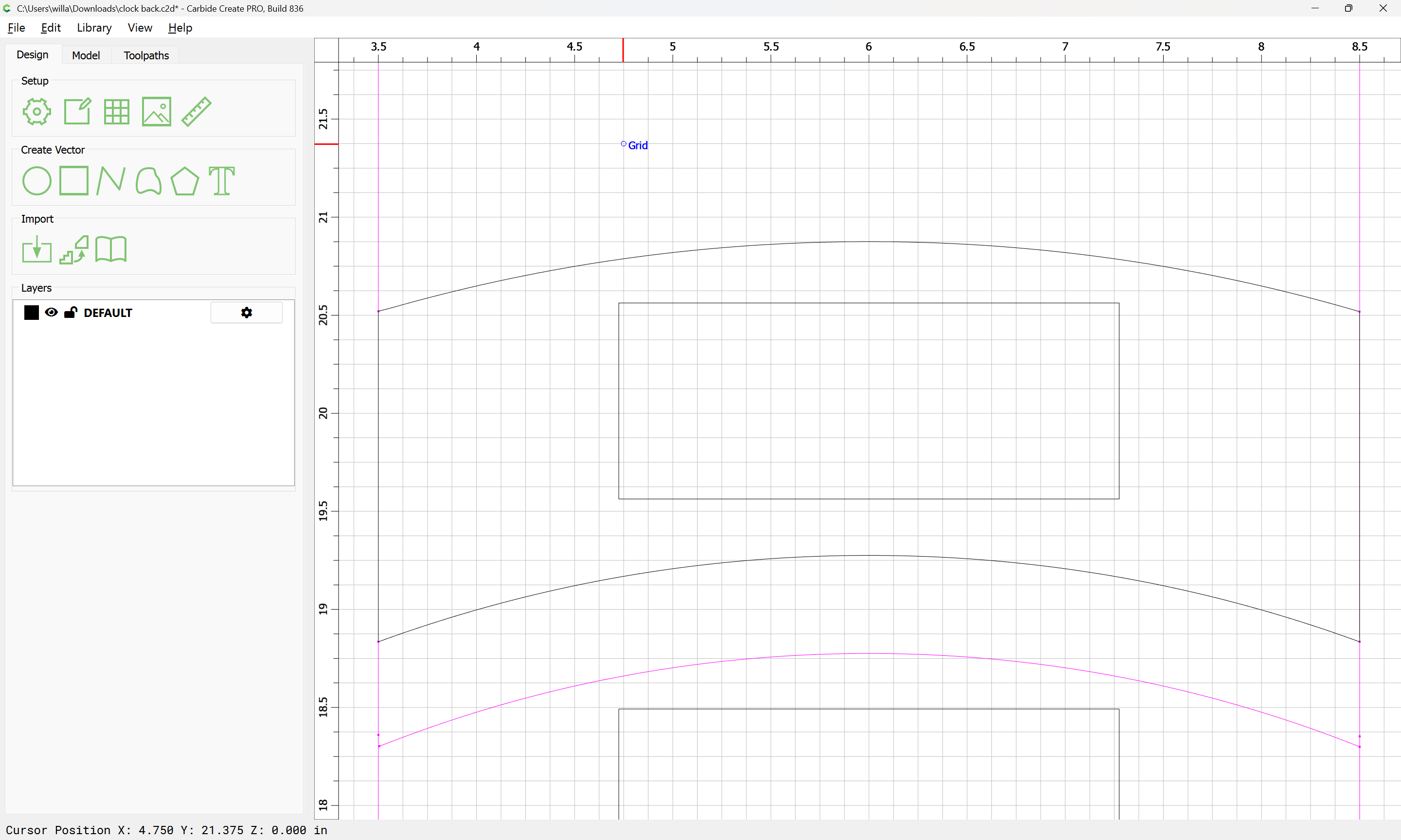

Repeat as needed.

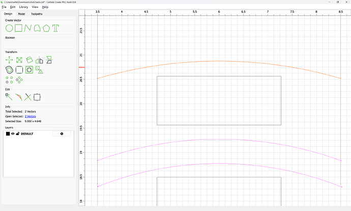

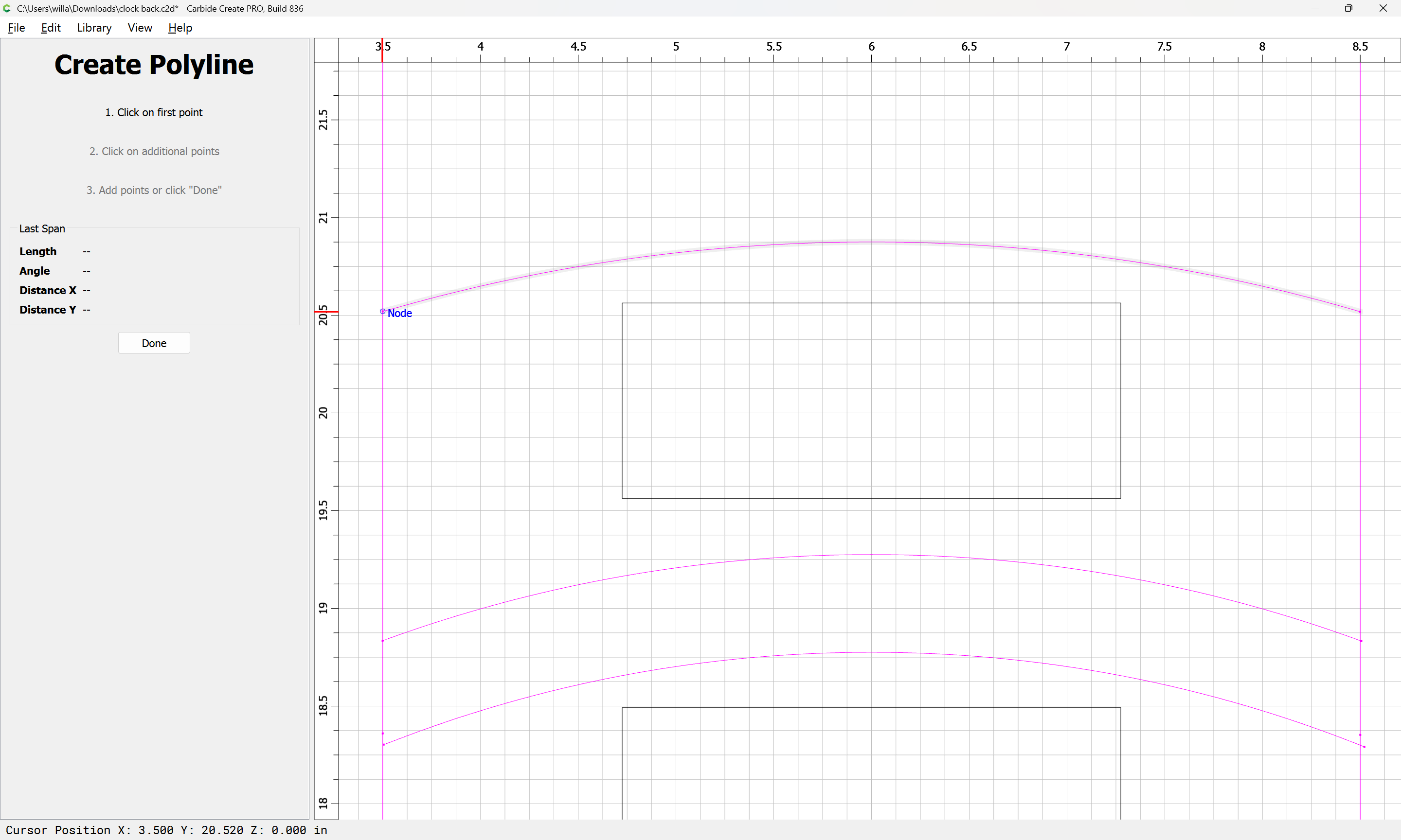

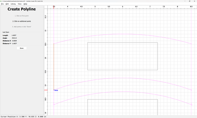

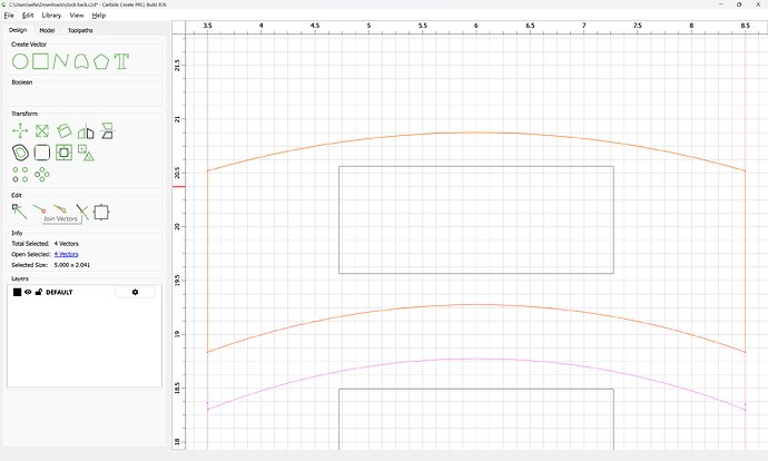

Since having discrete sections will require doubled-up geometry, duplicate all the curved sections:

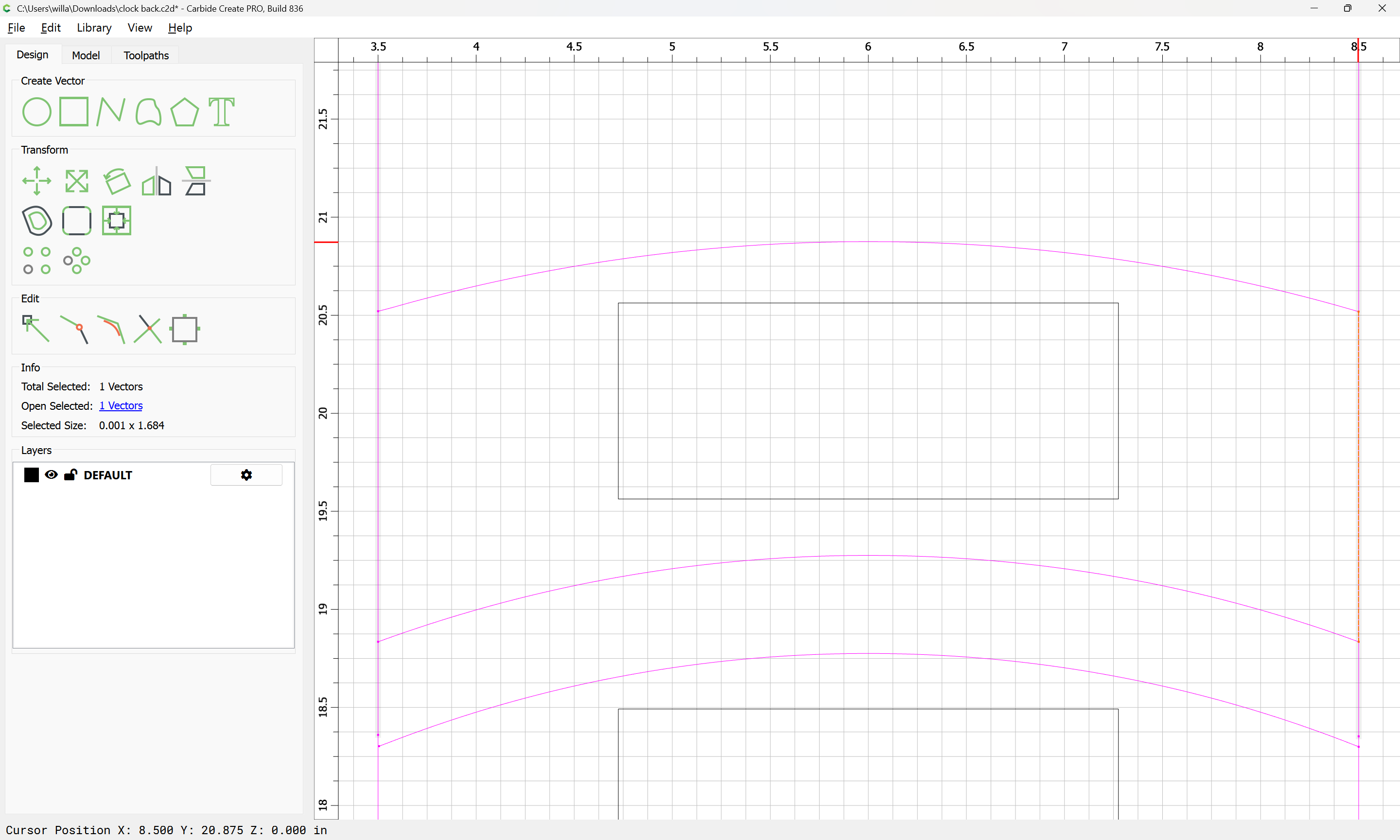

It is then possible to use the Polyline tool to draw in each edge:

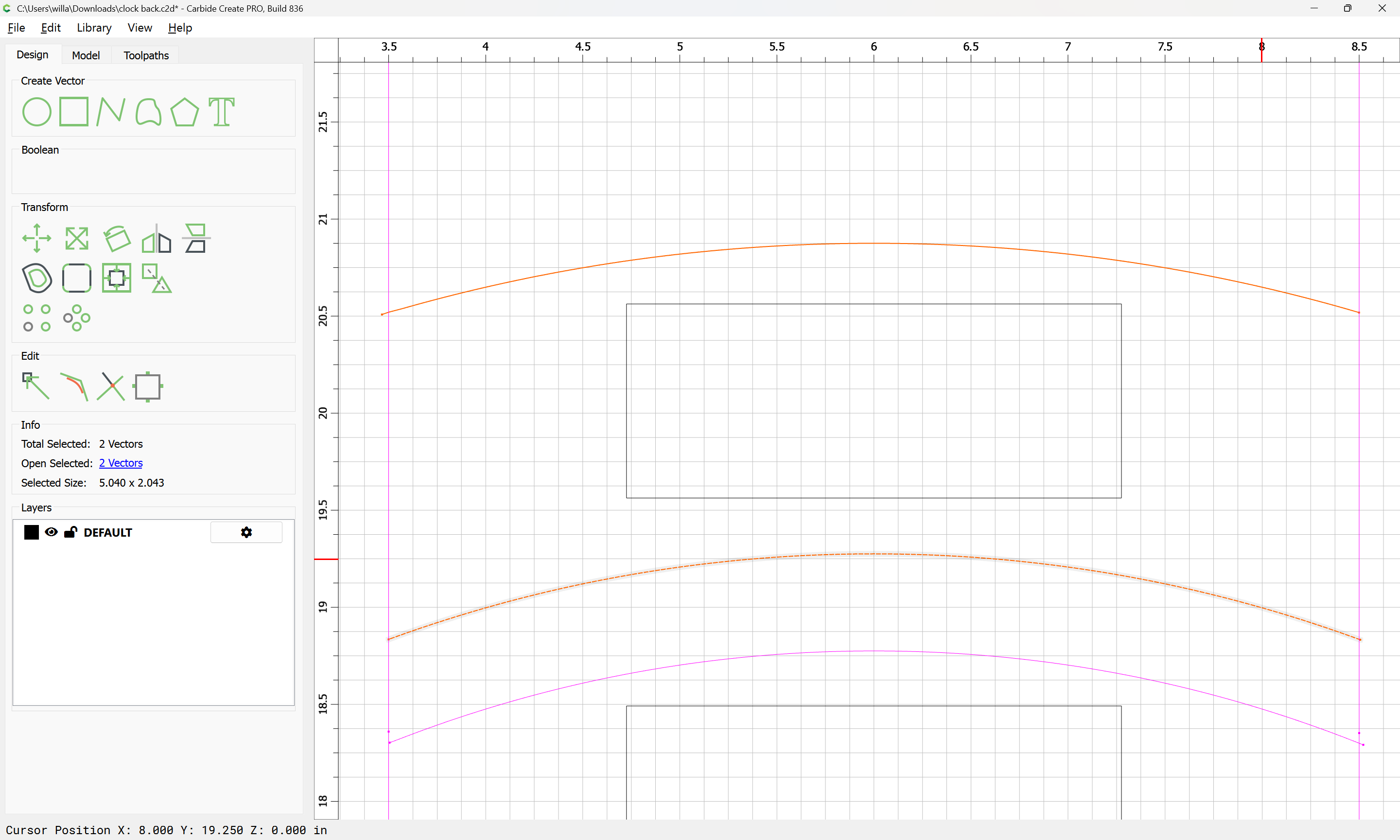

Done

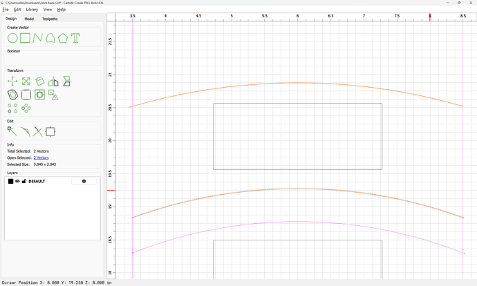

Repeat for the other side:

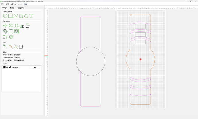

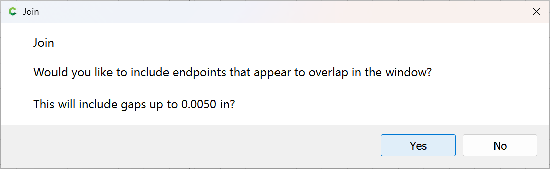

Then select the four elements:
and use Join Vectors to close:
Yes
Repeat for other sections as desired.
