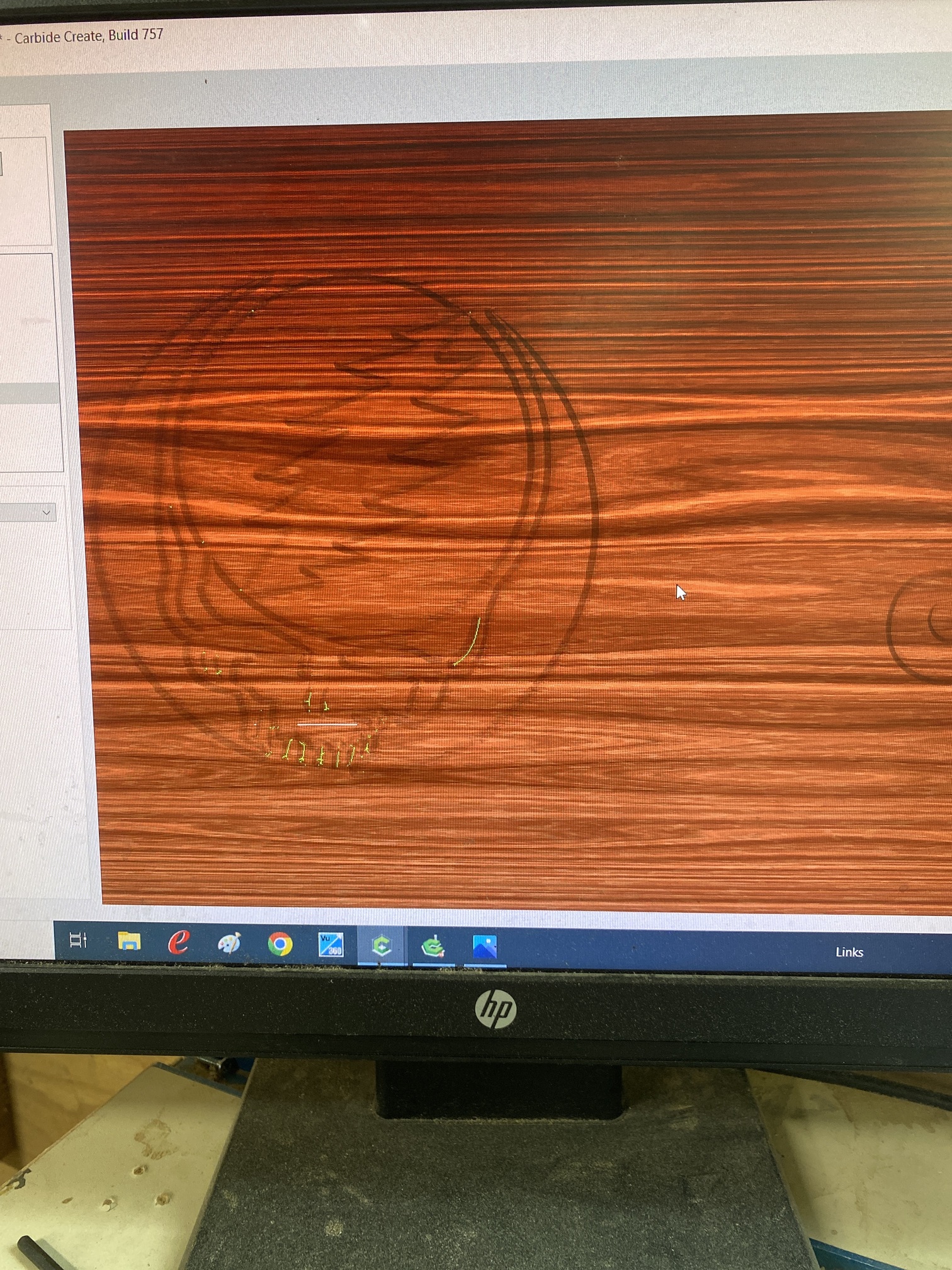

Trying to make a clean up pass
I am trying to have my machine go over my detail work with a light cut.
I set my depth of cut to just a little below the depth of cut.
I am trying to see if it will work in the simulator.
For some reason I can’t see a lot of the lines for the toolpath
Like in this pic. Anyone know how to see the paths more clearly?
I use the Pine preview, and the darkness scales based on thickness, so if you make the Stock thickness just barely thicker than your deepest cut you will get more contrast.
Also, reducing the stock size to match the area you wish to examine and positioning it there will help with increasing the detail.
